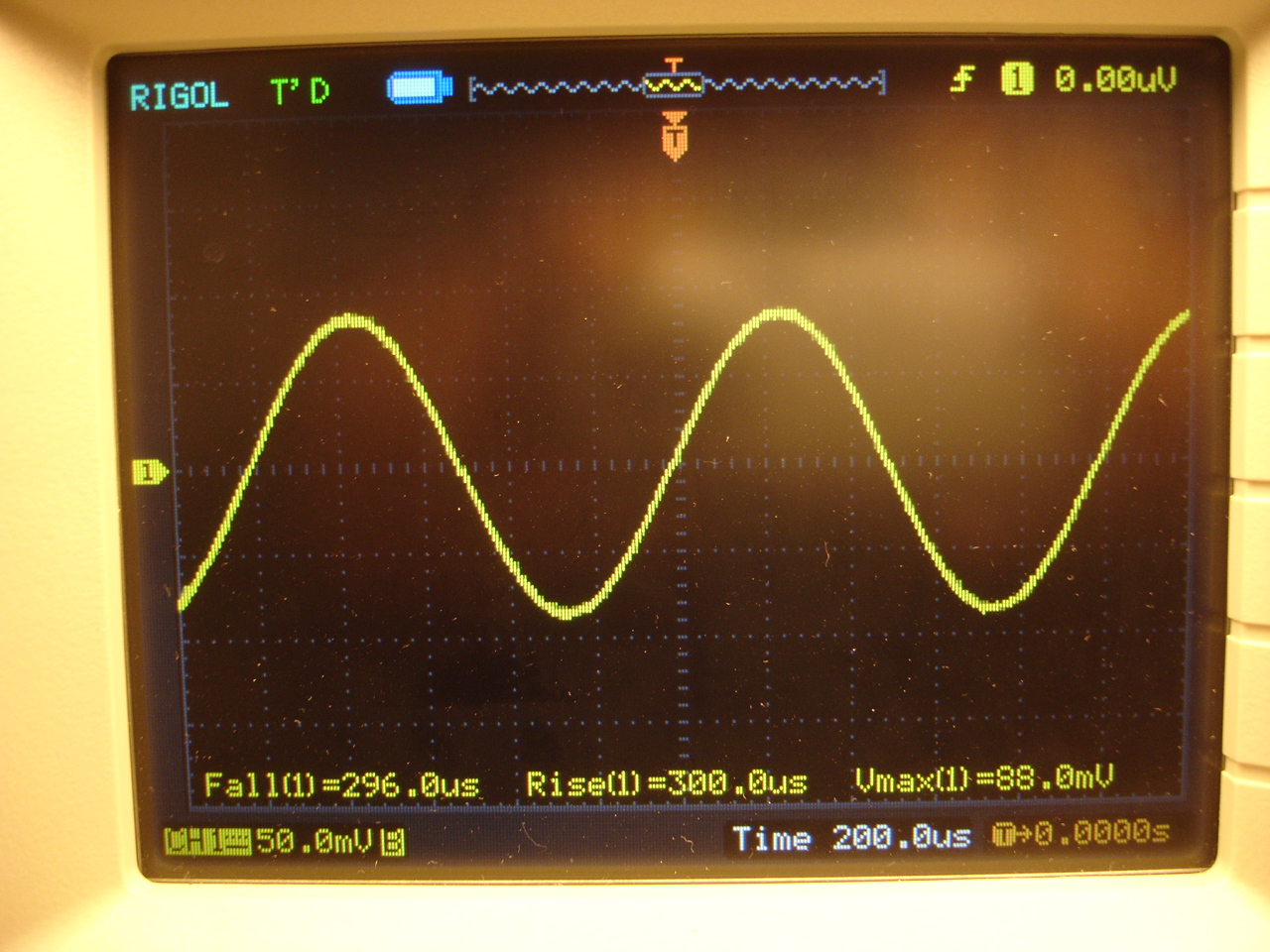

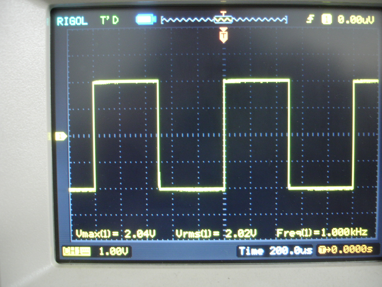

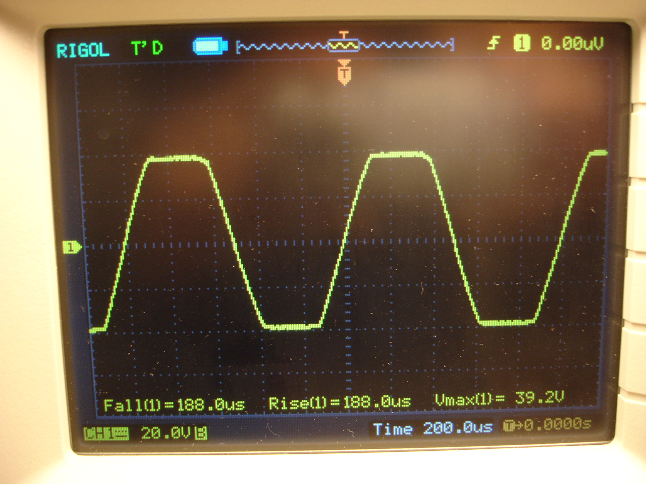

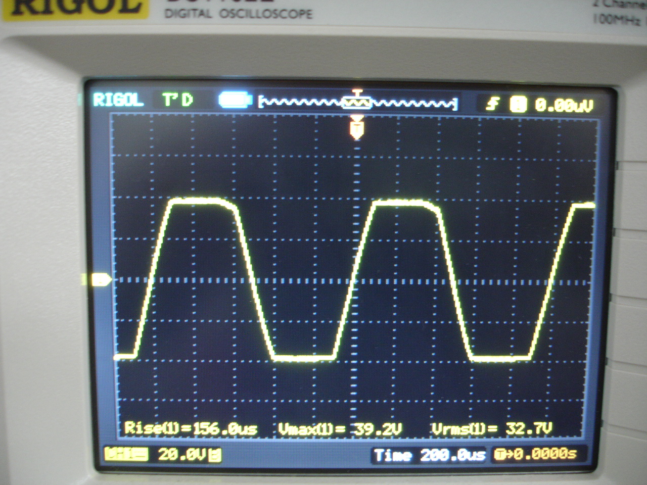

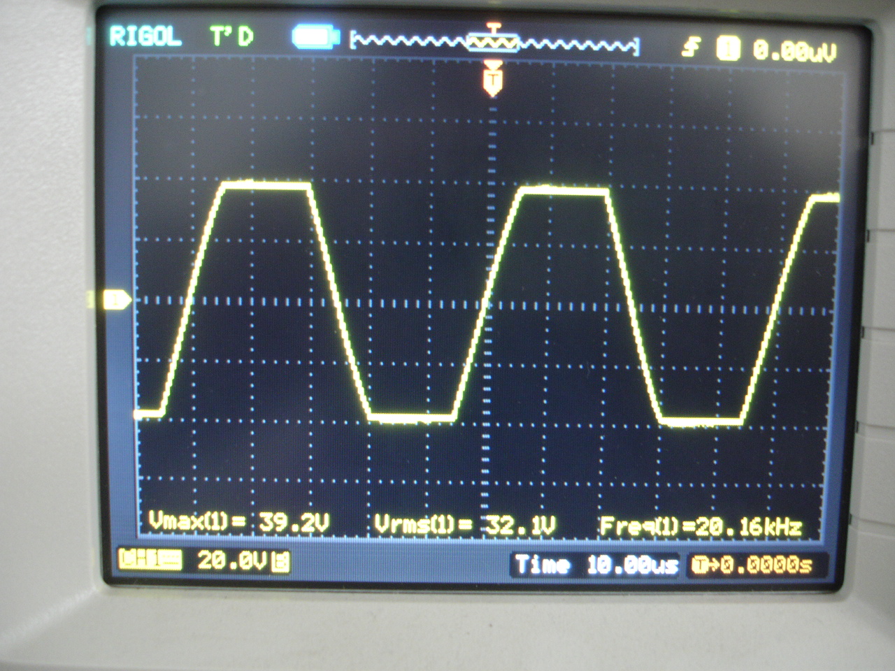

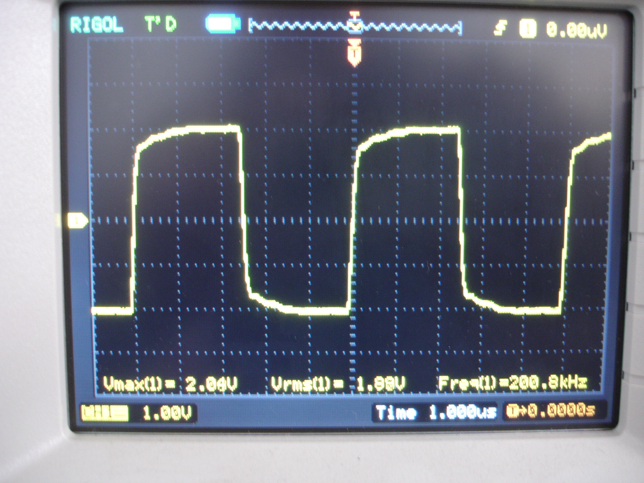

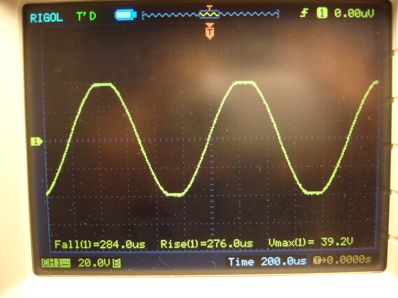

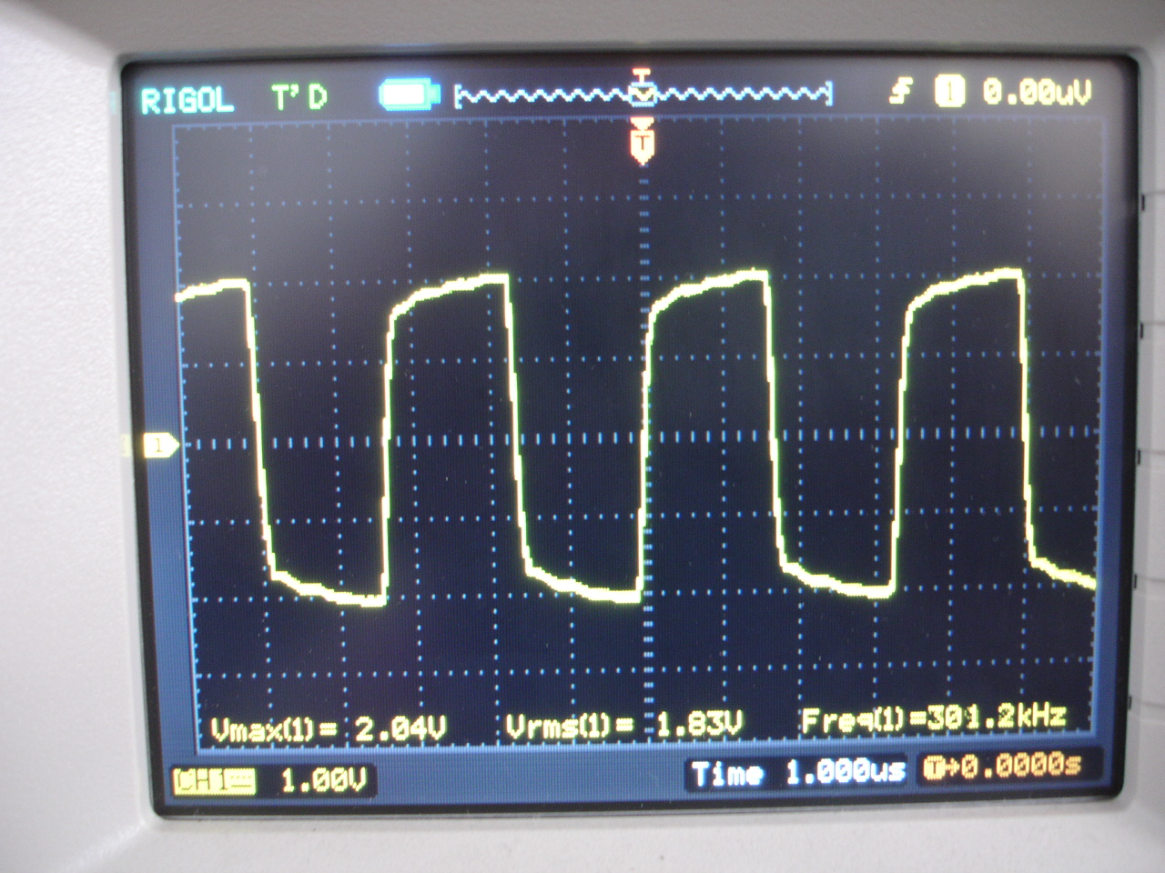

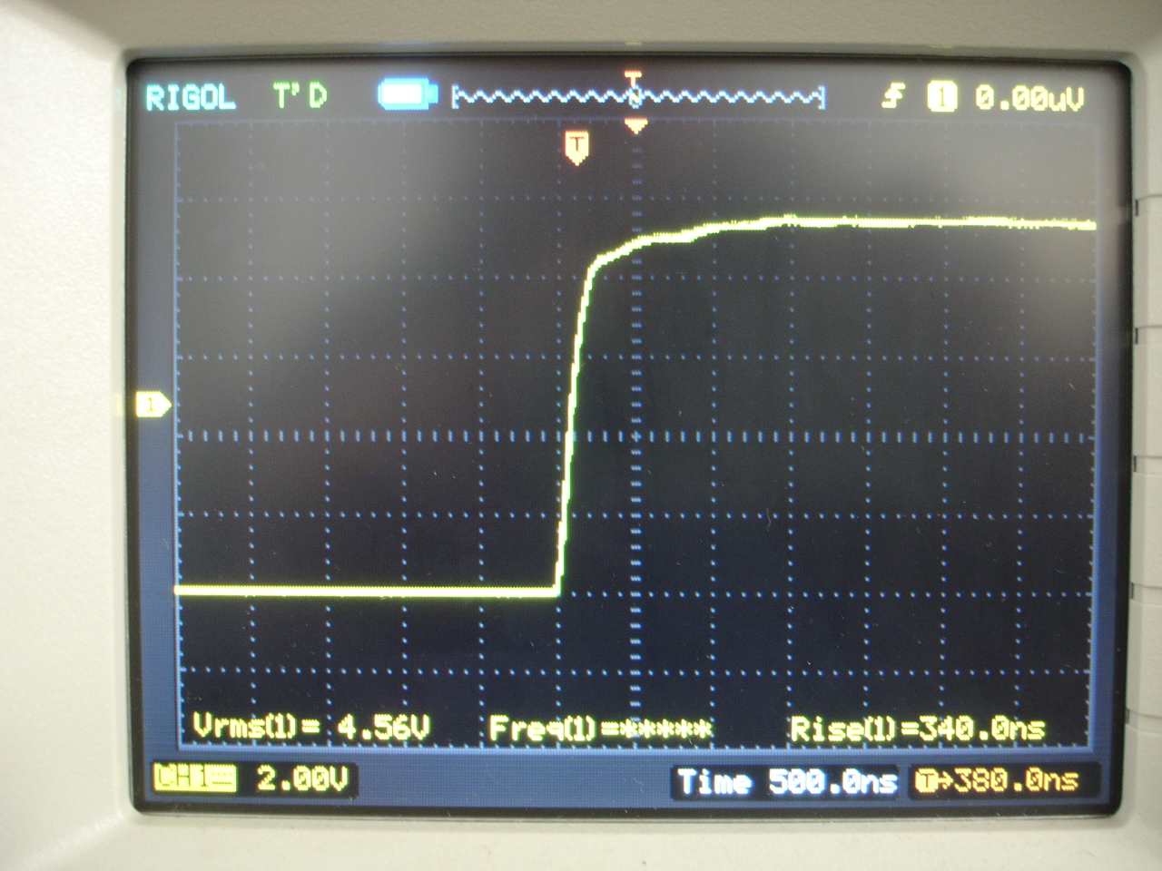

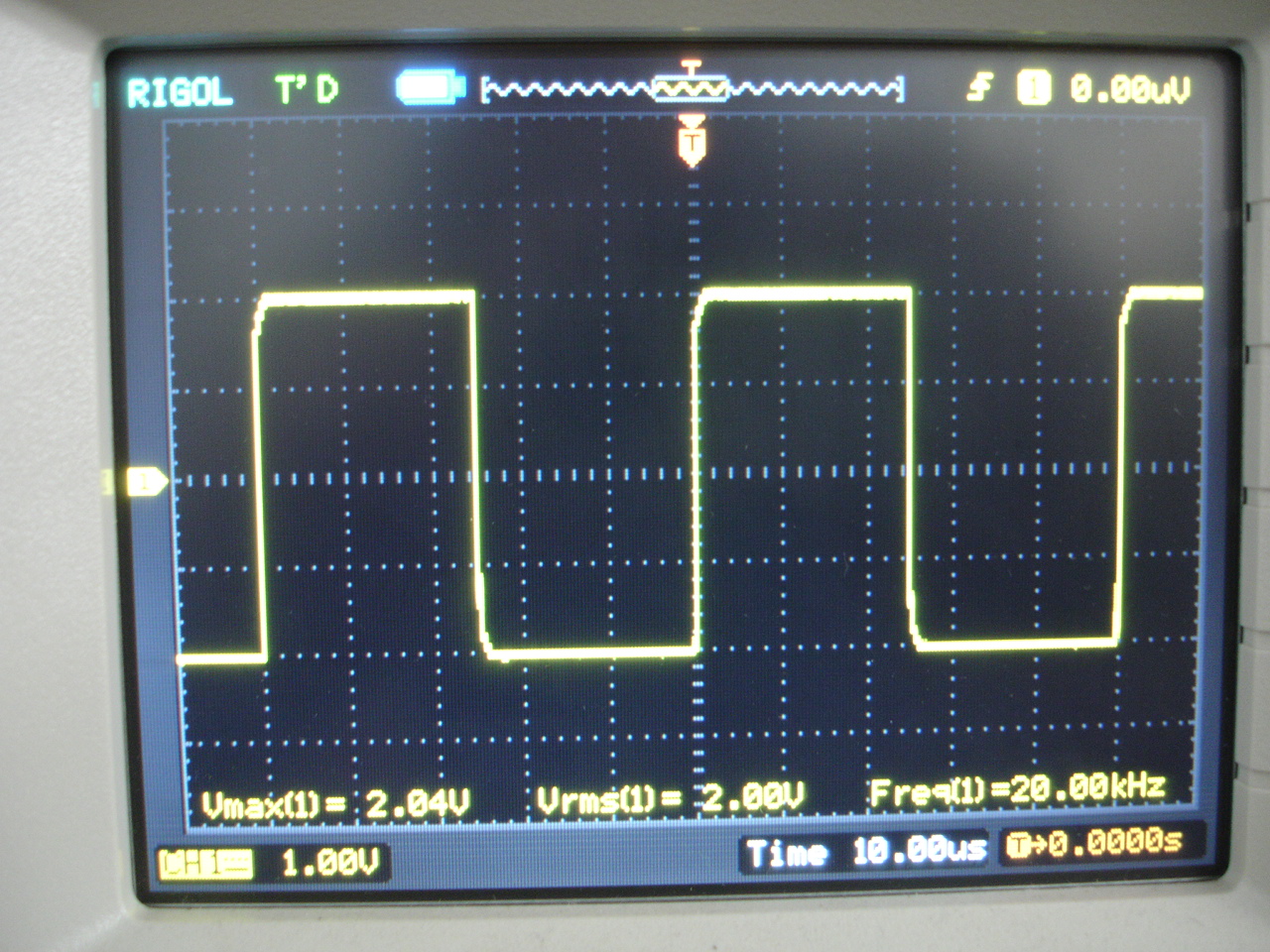

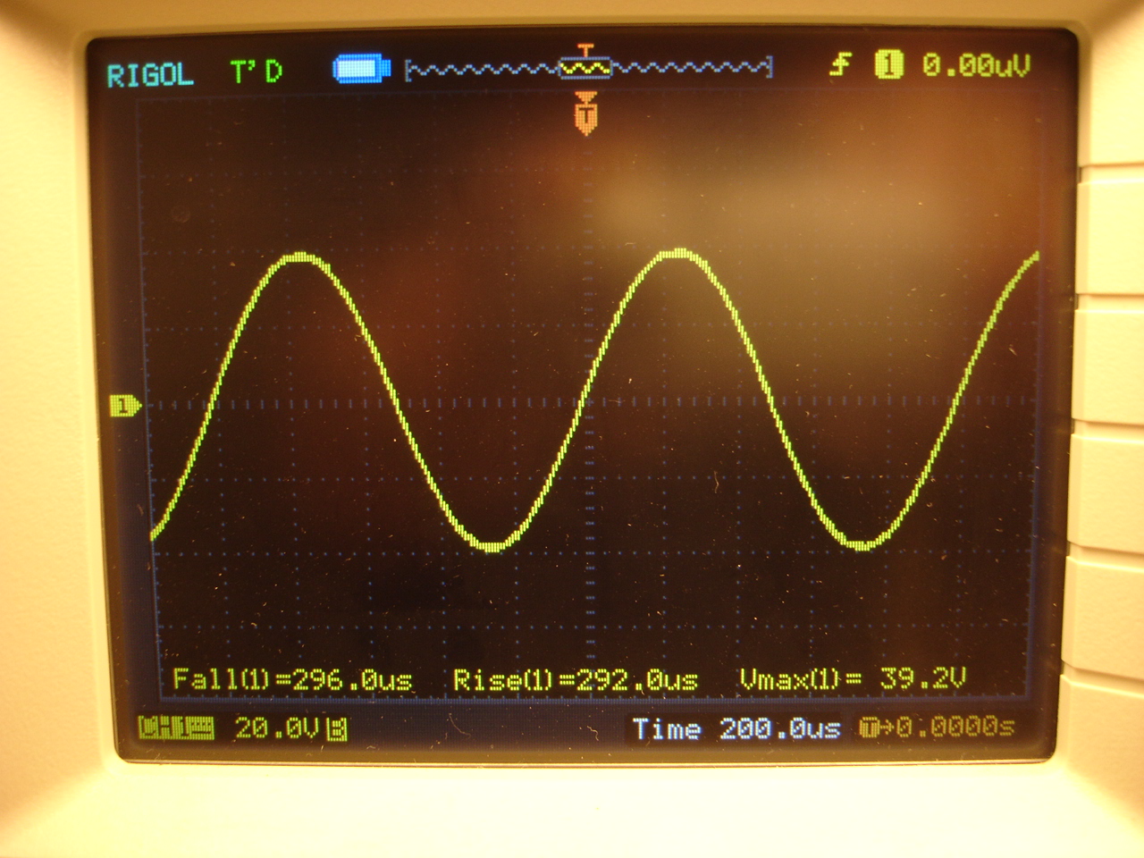

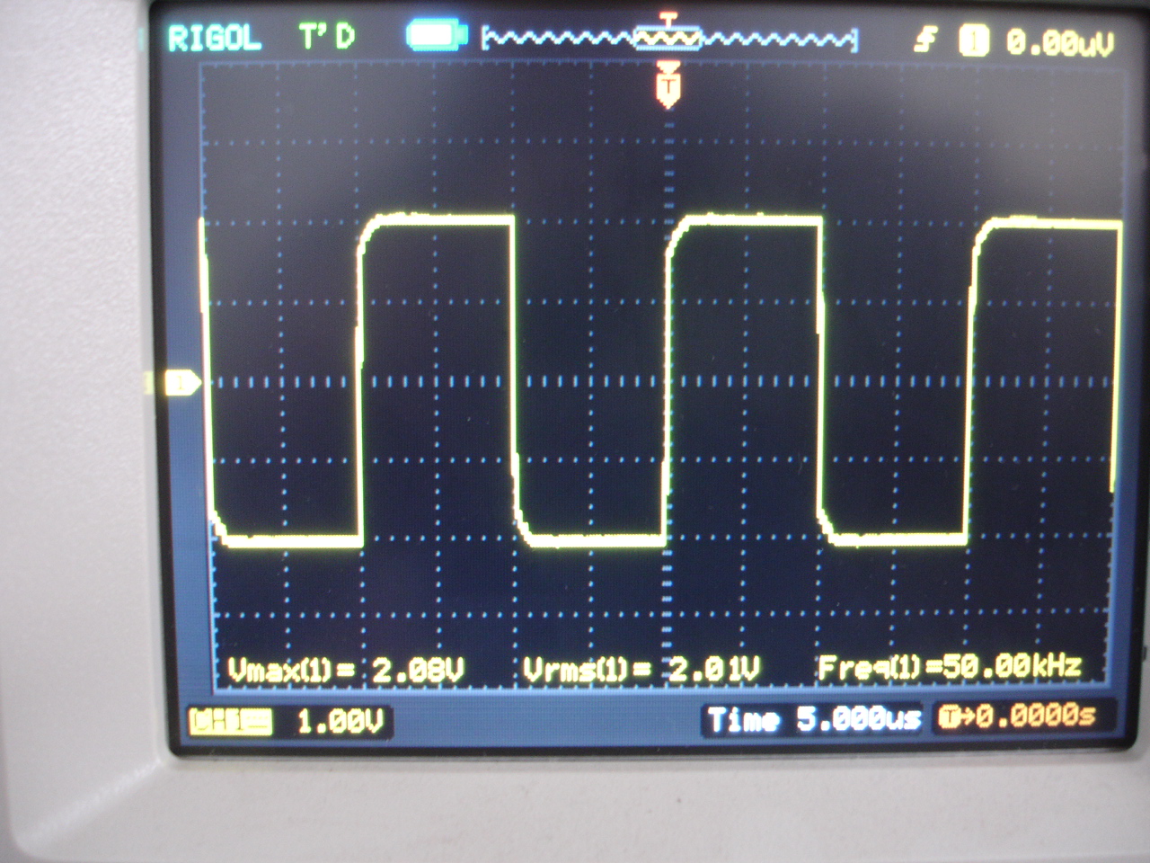

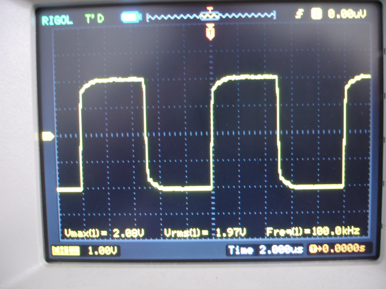

It's time for measurements
Please read on screens
Kypton-C V1.0
+/-50V
Idle cur.=70mA
Offset =1-2mV
All measurements on 7R dummy load.
Scopes prob at ampifier out (behind the coil)
Kypton-C V1.0
+/-50V
Idle cur.=70mA
Offset =1-2mV

Excellent , not only did your static voltage readings match within mV's
but your clipping and squarewave tests match exactly , as well.
I just had to know whether the "self clamping" nature of the Baxandall
(super pair) was real. It IS !
Good servo action , too (1-2mv). It should sound superb and be very
reliable. 🙂

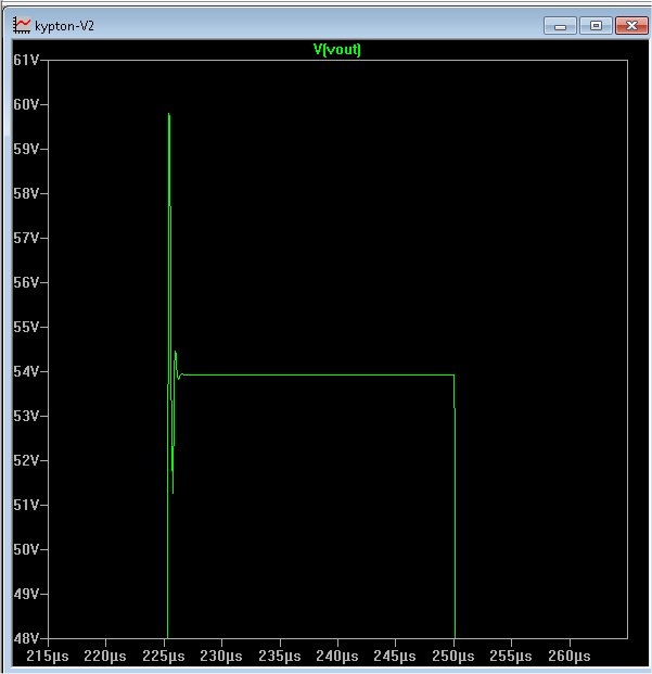

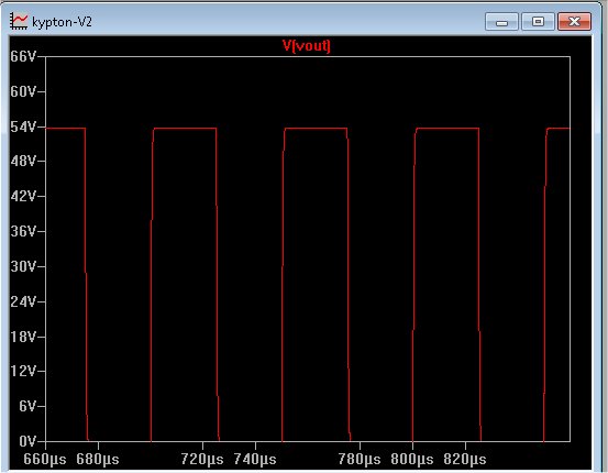

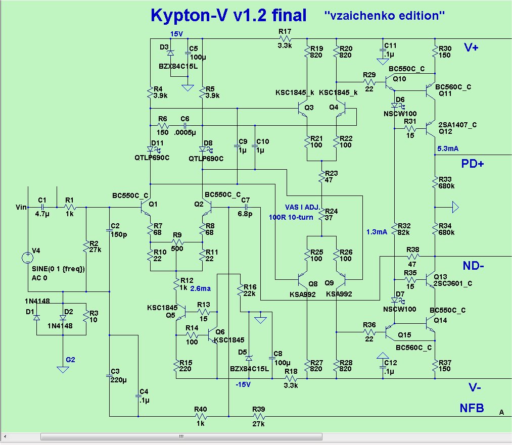

"V" is next - another "supperpair"
I went with your 2'nd stage for the "V" "vzaichenko edition" (Below 1). 😉
Thank you , brother !
As far as speed , I "throttled" it at 150V/uS. Why ? (below 2).
This topology has the gain margin extension at 20-40K ... massive gain.
But this gain makes for good ringing ... that "dip" in the phase response
(20k-100k)correlates to the amp "choking" on them squarewaves.
Cordell used the same local feedback (R38/C7) in his HEC paper
to tame the beast.
So , the tradeoff is 12ppm 20K ,150V slew , and a 1mhz unity gain point.
But , I have 90+ db phase margin (really rock solid) and
it "eats" square waves (below 3 - with 6.8p C7).
OS

I deliberately did not answer the previous question, but I agree with your choice 😉
Local feedback is a cool solution. In my hybrid I've got the unity gain point at 1.5MHz and the "dip" in phase response is rather light, so I have left it "as is".

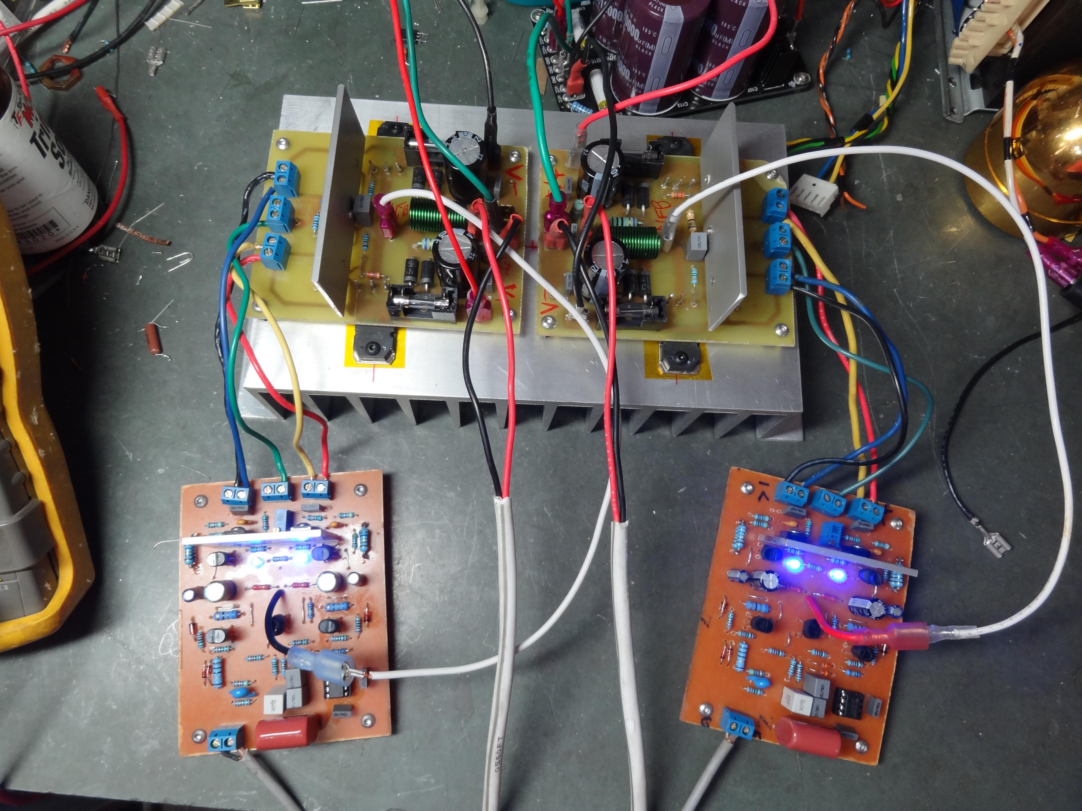

Almost worth slugging it out and finding what's wrong. This is weird. I'm still a firm believer in breaking it down into smaller sections and zeroing in that way. That's why I suggested lifting legs on R14 & 17.
Hey Jeff,
Good advice. I lifted R14 and R17 and disconnected the NFB but still had 34V on the emmitters of Q1&Q2. That could only mean one thing. Somehow the rail was getting onto the NFB. So I scoured the foil side again and I found a solder bridge the size of hair between the pad for R4 and the positive rail trace going to Q2. A little scratch with a probe tip and wa-la fixed. I put everything back together and It has been playing sweet music for a couple hours now. Sounds lovely. I have it playing through my Mini OPS right now. When I get a chance to hook it up to a slewmaster OPS I will attach the scope and get some shots of it playing square waves for your enjoyment. 😀
Hey Jeff,
Good to hear! My theory of breaking things down into sections when troubleshooting applies to just about anything. I hate just blindly throwing parts at it. It also forces you to learn the operation of everything quickly too.😀

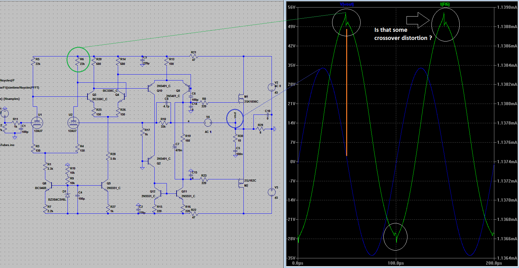

Sory for small offtpic. I would be very happy If You will can help me a bit.
I am trying to do my first hybrid and i do not know how to ged rid of the crossover distortions spikes (I am not sure about it) in the input stage. There seems to be nothing bad happening in output stage but two front LTP currents arent looking good.
*.asc file is in zip.
Big thanks.
Peter
