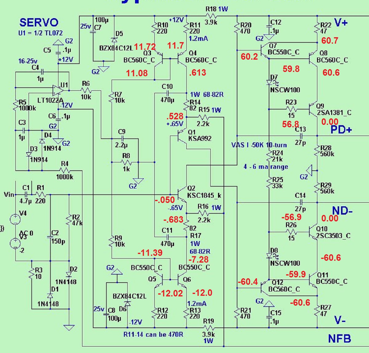

Hi Jeff,
Good, that's what I used. I have attached a schematic with voltages. I'm not sure what is going on but hopefully one of you can see the issue. I have checked all of the devices and they are all correct and oriented properly.
BTW, this is hooked up to a small OPS so the NFB is connected to that.

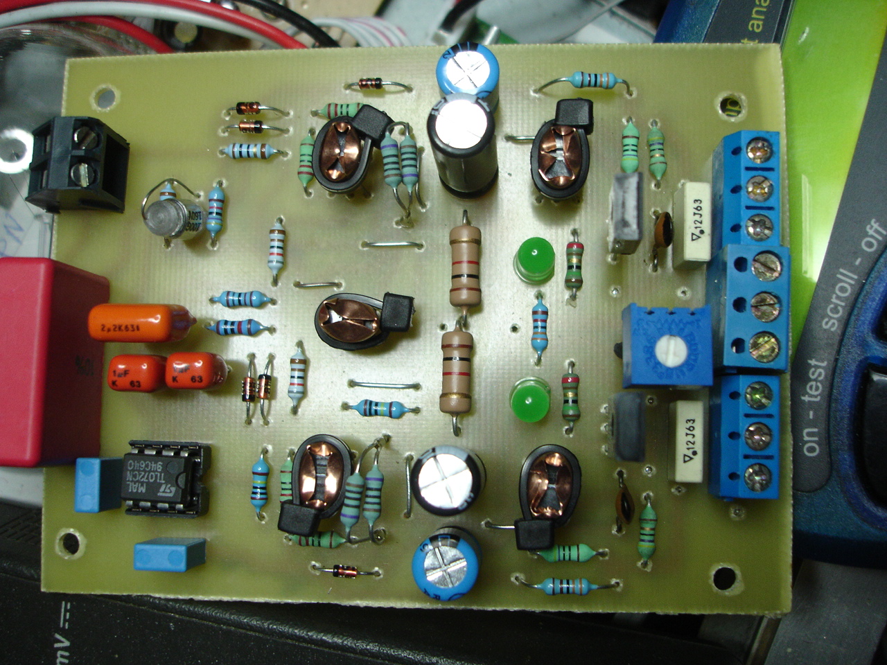

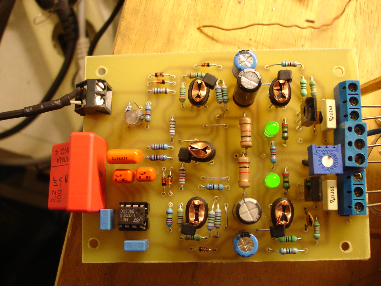

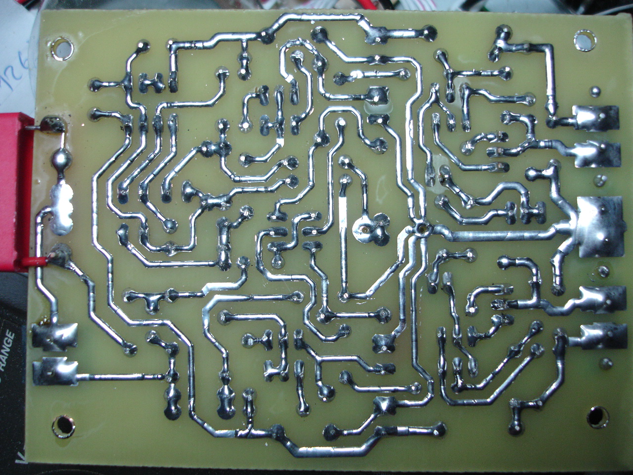

Some photos and measurements.
So then is yours working? I will check mine against yours.
Which BOM did you use? My resistors match the schematic you posted.
Thanks, Terry
Hi Terry ,yes mine is working.Just now i see that OS has change the zip.file R14,17 values are 68-82R,so i will change these values for lower VAS current.So then is yours working? I will check mine against yours.
Thanks, Terry
Q5 ,Q6 in your board is on cut off. You haven't any voltage dropping at emiter resistors R12,13

Looks to me like Q9 & Q10 may be swapped or the outputs are shorted together.
DOH! I just found the issue. I feel silly. On the screen shot, it shows the heatsink attached to the top of the transistor. I didn't pay attention to where the base pin was located. Let me flip those and get back to you. However, now the heatsink won't fit because the trimpot is in the way.

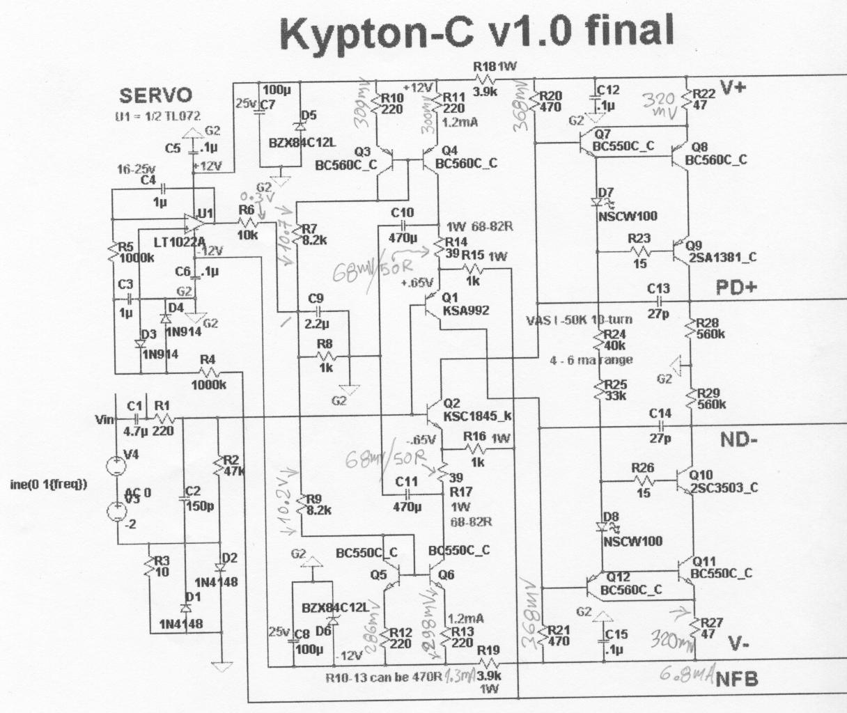

R10-13 (220R or 470R) will not affect idle current.
The feedback network (R14 -17)
can be 2.2k/82R or 1k / 39R.
With 1K/39R , increased current feedback needs more static bias current from the mirrors (R7 and R9) ... decrease to 8.2k.
If you don't have large resistors, R14-17 can also be 2.7k/100R . This
combo will work with R7/R9 at 10K , also.
To measure VAS current , calculate voltage drop across R25 ....subtract
from main VAS emitter R (R22 or R 27).

The "middle" values (82R/2.2K) seem to be the best compromise between
a cool resistor and sufficient low THD.
100R/2.7k = 12ppm
82R/2.2k = 8ppm
39R/1K = 5ppm
@ 1V input - 20K

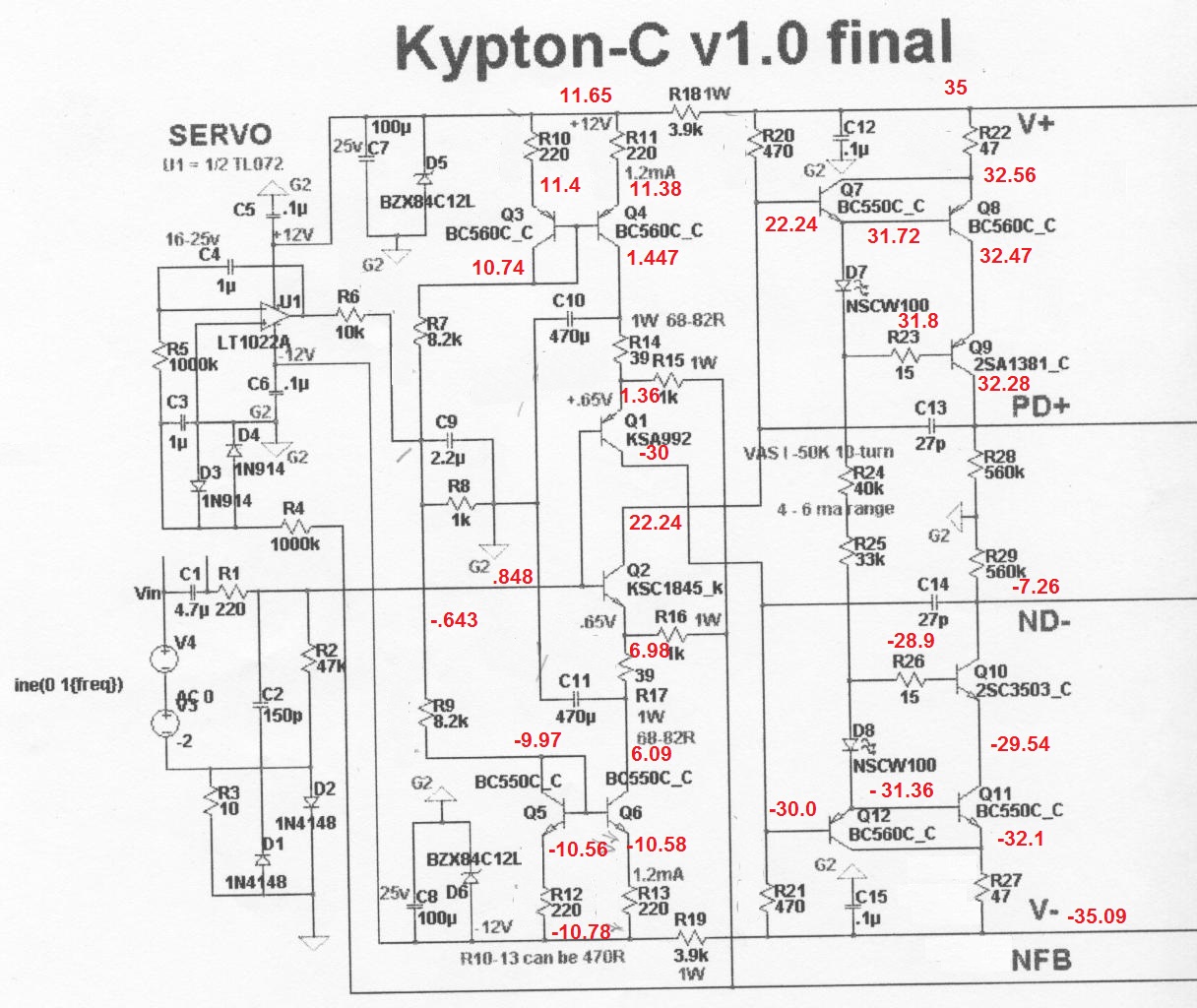

I got the one board working fine but the second one is giving me fits. I've noted the voltages on a schematic. I tested at +-35V because Q2 and the VAS devices are running very hot. NFB is tied to PD and ND through two 470R resistors so I can measure bias.
I have replaced Q2, Q7 & Q9. I've also checked every resistor and checked for shorts. Maybe a clue, D7 Doesn't light until I switch off power.
Hopefully one of you eagle eyes can spot the problem.
Thanks, Terry
Thanks, Terry
Thanks, Terry
Are you sure D7 isn't installed backwards?
Yes I checked it with a 3v supply and a resistor. The weird thing is it lights about two seconds after I switch off the power and stays on until the PSU has drained down.
