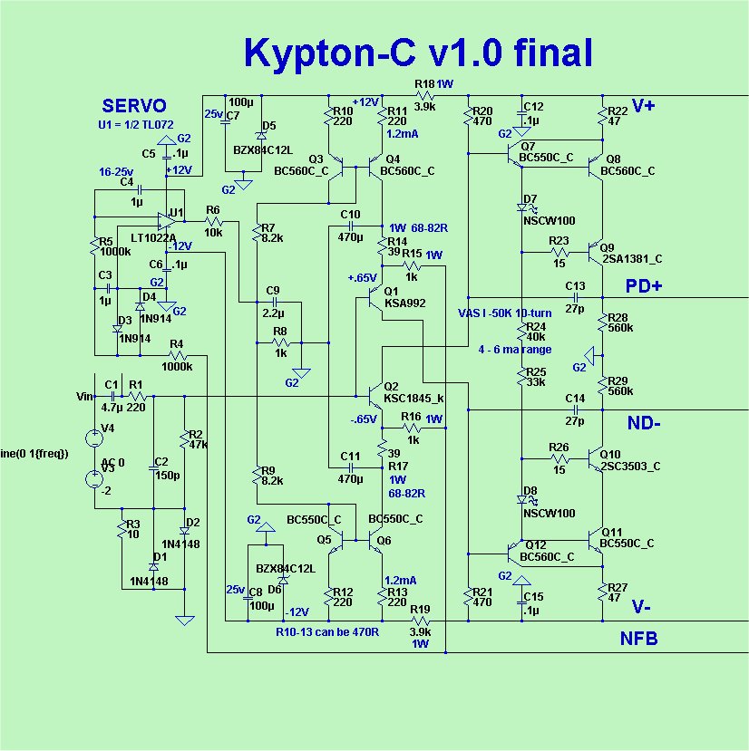

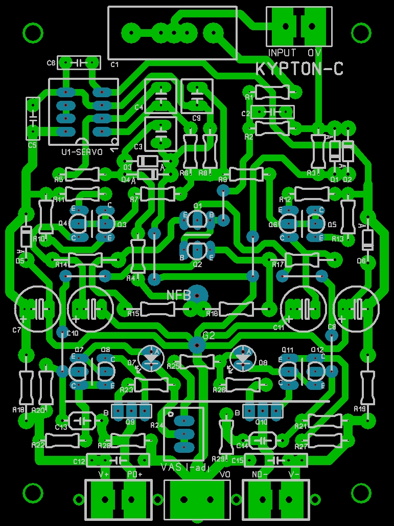

Hi. Thimios,
The circuit is right but the part numbers don't match.
R24 on the plan is R25 on the schematic
The trimmer is R24
The R27 to the left of the trimmer is R23
Also check the foil. There is a link missing on one of the small transistors.

"The R27 to the left of the trimmer is R23"
No Terry,isn't R23.It is R28 ,from the collector of Q9 to GND.(according to schematic).
The other resistor to the right of the trimmer is R29 from collector of Q10 to the GND.
The resistor R24(PCB artwork) is the R25 on the schematic.

Sorry, I wrote that from memory. My bad. I got it right when I installed them.

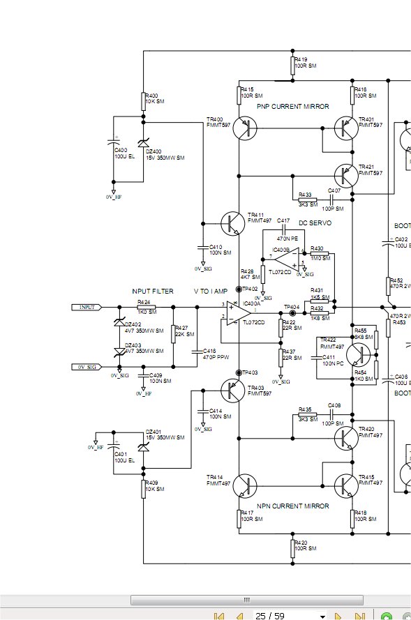

Mark Alexander like ? (Current mirrors on the power pins of the OPA ?)The last one (IPS) I will do is a CFA/VFA IC hybrid "eyesee". The
current feedback node is the output of a op-amp ! 2 feedback loops ...
one VFA (the op-amps local FB) and the op-amp- I/V convertor (discrete
current FB).

I fixed them all ... The schema HAS to be right (simulation would not work).
The art work was in error (below -fixed) Q12 - R21 had a missing bridge -
was that what was seen ??
Even as this IPS gets stellar performance "as is" ....
You can increase the current in the feedback network (R14/15 -R16/17
39R - 1K) plus increase the current mirror I (R7 +R9 - 8.2k ... 1.4ma).
for 1-2ppm @ 20k. (below 2).
Kypton C is very "friendly" to "tweaks" !!

That's the one ... also , there is the Arcam-A32 (below).

I can't see the difference ,is this a different pcb?I fixed them all ... The schema HAS to be right (simulation would not work).

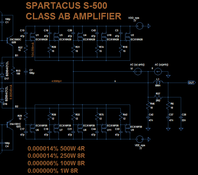

Alrighty then, a bit of Spartacus for you then 🙂 Who needs bulky class A when you can have a powerful AB with a distortion profile lower than about what any class A pushes out!?
kgrlee: note C28, the gateway to unconditional stability 🙂
Edit: It may disappoint some, but yes, Spartacus is a VFA.
The missing bridge was under the silk. I was wondering how I missed that.I fixed them all ... The schema HAS to be right (simulation would not work).
No, It is fixed ... (same as before)updated labels + Q12 bridge.
