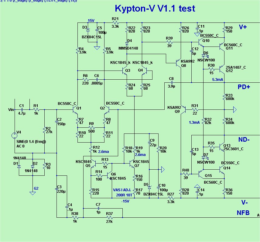

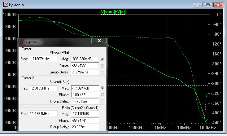

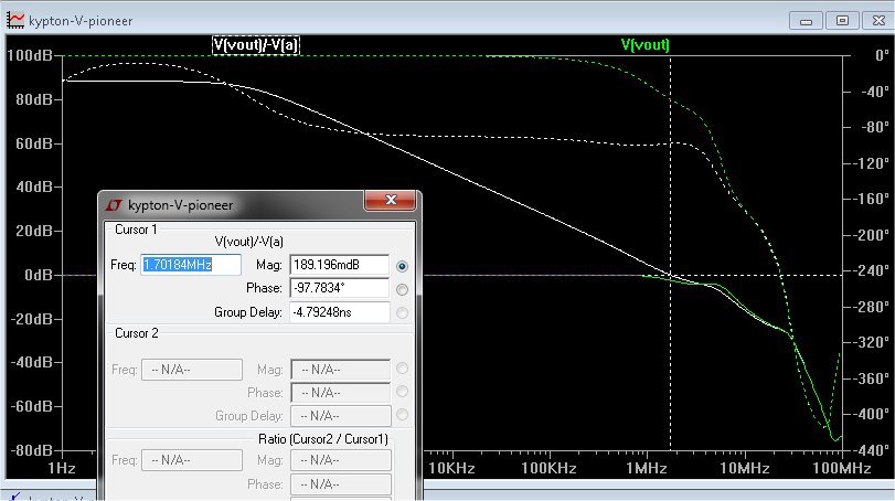

Yes , I see your lead/lag. You need very little (150p/6.8p)
You do understand that the tubes (or the pioneer FET first ltp) have much
lower gain than the BJT's.
(below 1) .. I compromised with a 2 stage LTP driving a level shifted
baxandall/ hawksford VAS.
For the BJT first stage I used 150R/.001u,which got me down to <2mhz unity gain.
I had too much gain margin at 20-30K ... so I took lead comp. right off
the VAS output -C11 (. I finally "tamed" the gain 😀 . (below 2).
Even "tamed", I still have 15db margin at 20k - 4ppm (below 3).
Using c11 lead , I saw no effect using local miller around the baxandall's.
Your tube IPS is cool !😎 The tubes essentially take the place of the FET's
in my previously posted sansui hybrid front end.
PS- another aspect of this IPS is it's 200V+ slew. It's CFA fast !
OS

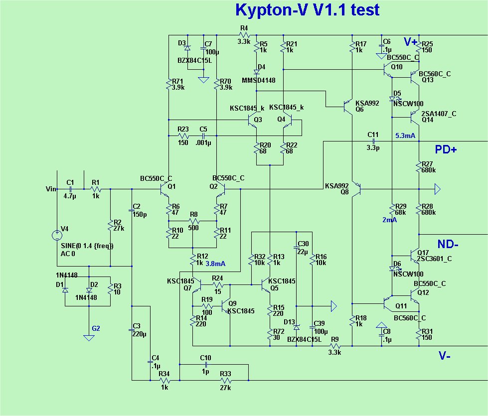

I like this one !
Schema+asc below.
Should not build the same stuff again and again. Different is good
OS
Like GLA?
Finally, you make GLA IPS 😎
A very cool way of folding from the 2-nd LTP to push-pull VAS, "mirroring down" the left shoulder
5pF Miller is also cool 🙂

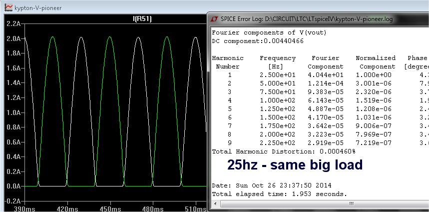

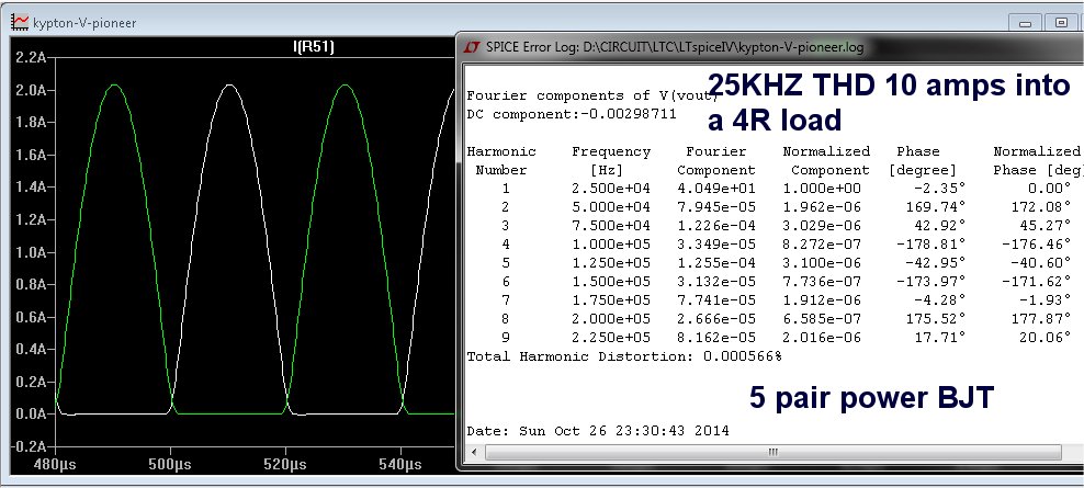

Yes , we are on the "right track' .... and yes .. Bimo - the GLA 😎 .
This GLA is way more stable.
GLA had no current sources 🙁 , a "bombed out" 3 transistor level shifter
VAS. GLA (original) actually used FET's as 1st stage.

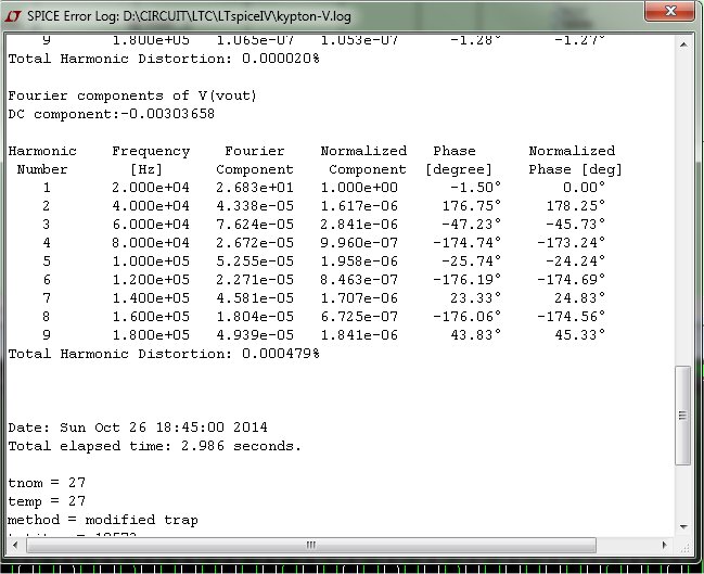

Vzaichenko's description of the OLG sounds right. My BJT is 25db/25db/40db
(1st/2nd/VAS) - 90db total. I had to reduce VAS gain (150R Re's).
I also tried your symmetric TMC compensation. No real improvements to
this BJT version.
Below 1/2/3 ... best I can do 🙄
4 ppm 25hz 200w , drops to sub ppm 1K-10K ... back to 5ppm at 25K (4R).
I used 2.2 -2.7p for that "cool" miller and lead.
Time for a board ...😀
OS

I've tried most of these compensation schemes and came to a pretty simple
conclusion - you basically trade phase margin for OLG.
TMC when optimized seems to trade phase margin early, say around 10kHz,
and then you get it back later.
Even for a fairly simple circuit, with TMC you can get the simulated
distortion down to ridiculously low levels (0.000006% / 1 ohm / 30V pk /
1kHz) but there's always a phase margin trade off somewhere.

That what they did with the original sansui "GLA" (Z5900).
Only 7 transistors in the input stage /VAS. They "cranked" it up to 120db
OLG ... and it had dubious phase margin like this.
They then added a huge 47pF lead cap back from the output to increase
that margin at unity gain.
This allowed that 7 device amp (2 ltp + 2ltp + 3 VAS) to have .002-005%.
All the "economical" old Japanese VFA amps in the 80's used this trick.
With more parts (CCS's + cascoded VAS's), you can get that same performance with far less gain (90db).
Still , I had to sacrifice sub PPM THD for margin. .5ppm to 5ppm was the price ,
but I like having almost 90 degree margin at unity gain - no one
will yell at me for causing more "magic smoke" in the world. 😀

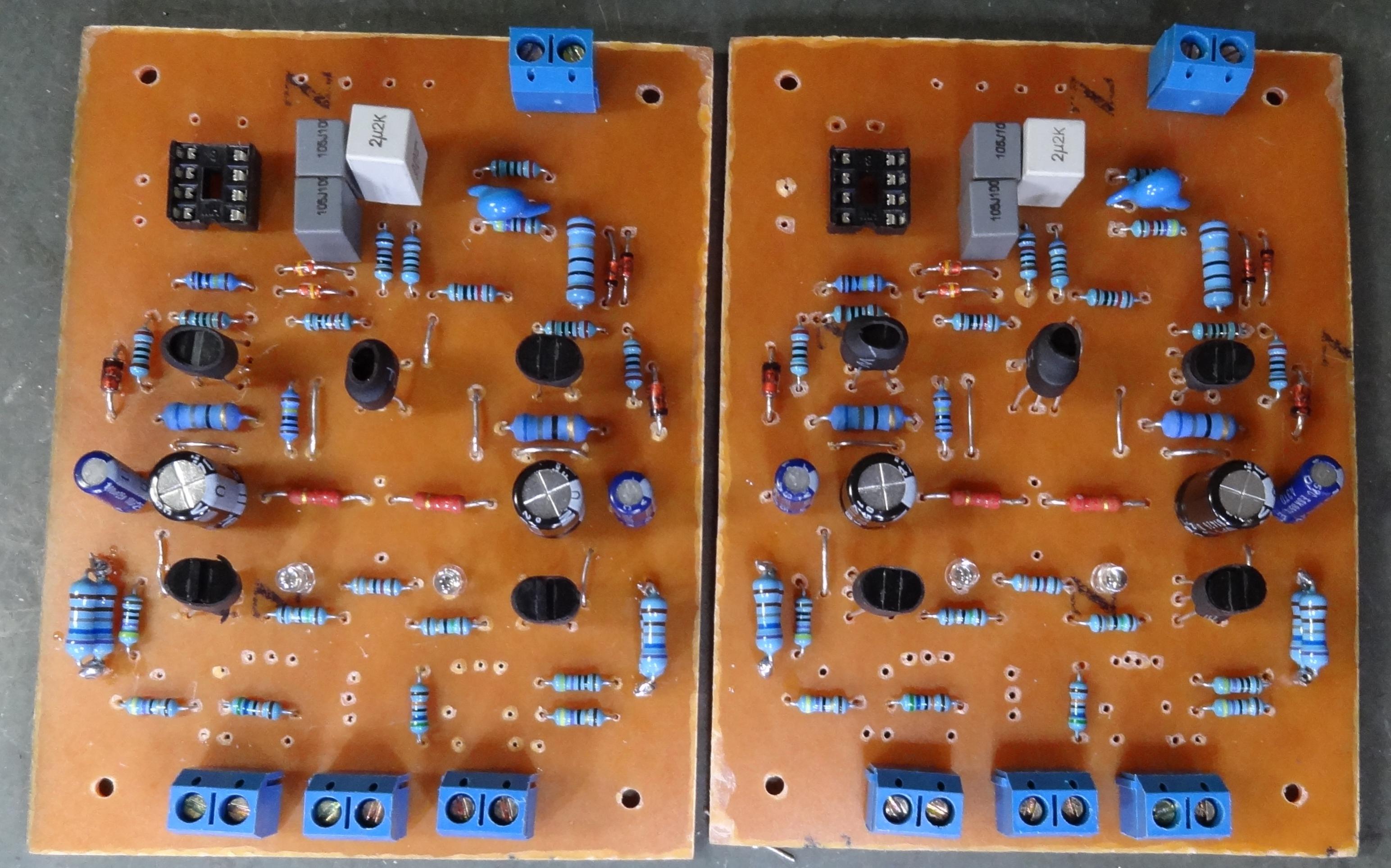

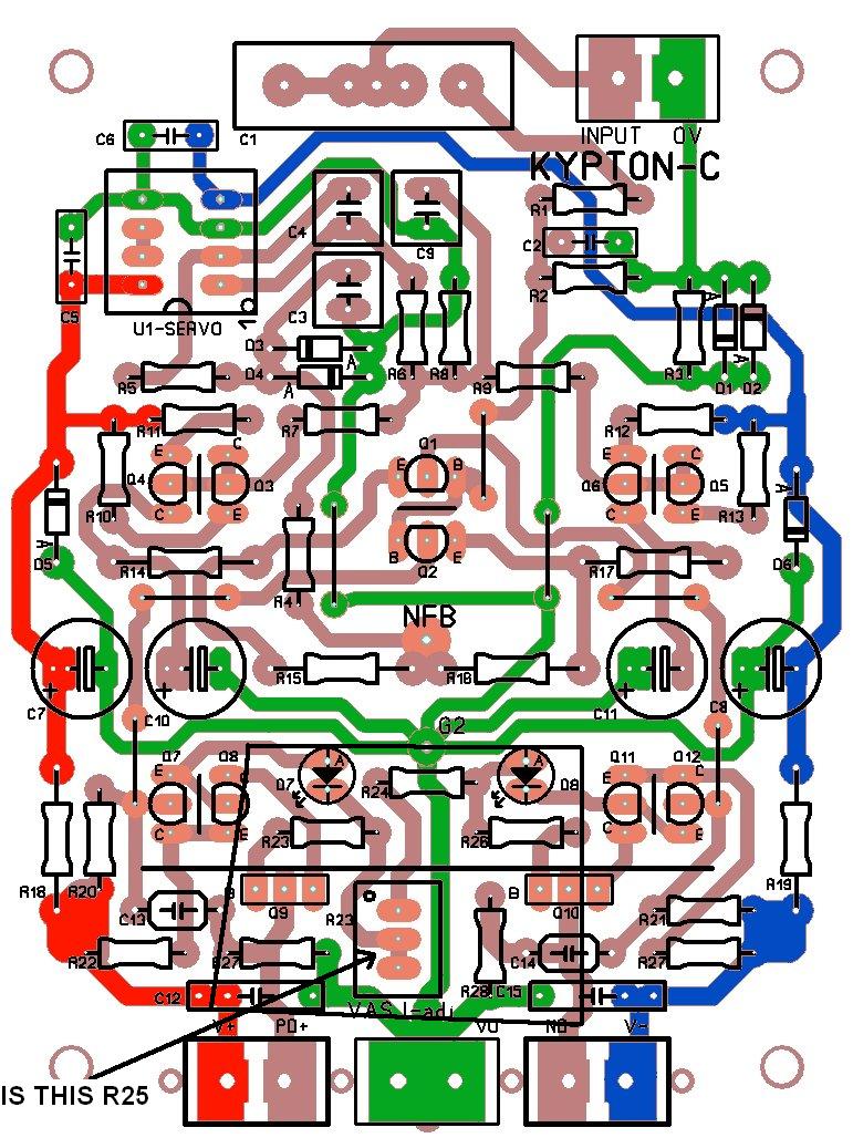

I'm confused a little.Are this Kypton-C the final version for testing 😕Posted below - the toner "works" ( I found the "bugs").
Toner image is the big .BMP image 300dpi/ 76 X 102mm.
OS

Green/blue/ white/uv (2.6v or above) 3.2v or above is best -blue/uv .... wow !! Terry - beat Thimios - we were all taking
bets around here 😀 .
OS
OS
90 deg phase margin at UG is extremely conservative, generally the 'safe'
phase margin is required at 30dB OLG, or whatever the closed loop gain of
the amp is.
Having said that, I am sure you will have great stability with around 90 deg
at unity OLG - and it may pay sonic benefits. Was it Pass that said the
further away from instability an amp is, usually subjectively the better?
I'm going to have a really good play with all these compensation schemes
and see how they affect the sonics.
T
