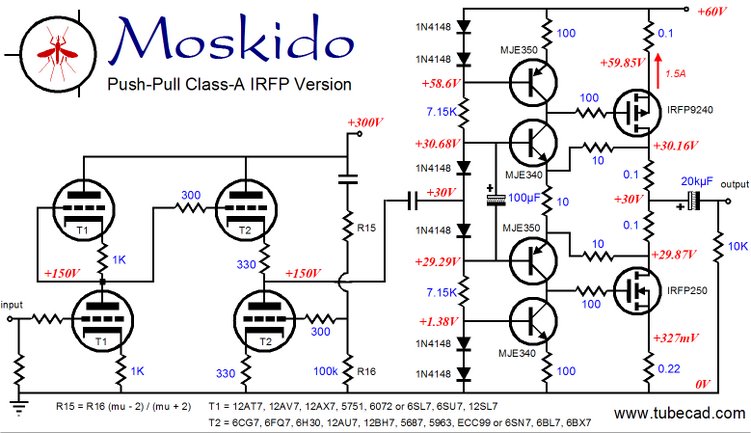

I will "expand" into the Class A OPS realm.
http://www.diyaudio.com/forums/pass-labs/104961-moskido-hybrid-tube-mosfet-amplifier.html
The Moskido seems to be the ticket.
PPM IPS's with MOSFET power followers ... very interesting. 😀

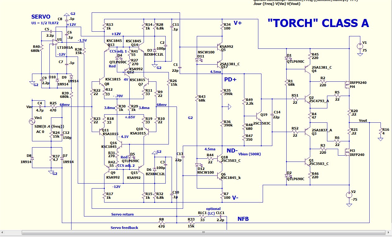

The "Moskido" becomes the "Torch"....
Killer !!!
I took the skido... (below 1) ,
Added a Vbe (below 2 - full schema) ..
And got the "spook" running on my "torch" OP stage.
The single Vbe will stabilize the IRFP's (mosfets).
I've yet to refine the idle adjustment for the class A ...
either the OP's CCS's will adjust this (or the Vbe).

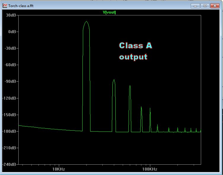

performance is awesome .. 5ppm thd20 and
just low order harmonics in the FFT (below 3).

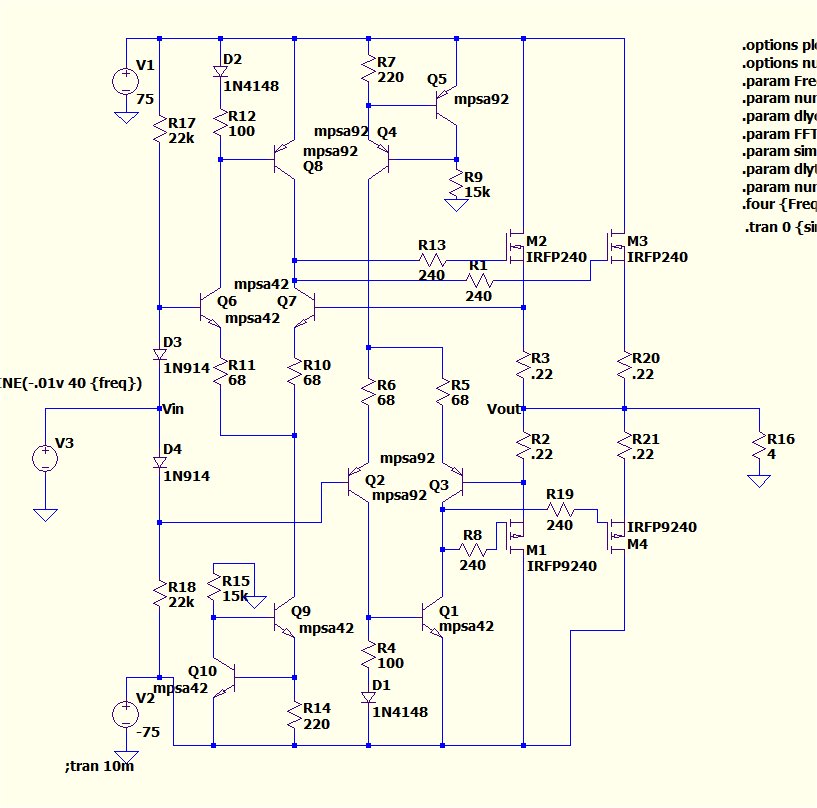

Source is feedback to the driver stage .
the "skido" seems to be a simpler (current FB) version of the "Genesis" class A stage (below),
which uses local voltage FB to a pair of differentials.
A lot more FB , I could never get the genesis to be really stable ???
Maybe understanding the "skido" will unlock the genesis.
When it is behaving , the genesis is the "holy grail" (super linear /0 distortion). 😕
I'll get it !!

That would be a easy as porting the IPS/VAS to 18-24V rails.
(below 1) is the "spook" with a few resistors changed .. running an EF2
class A OP into a 250R load.
The slewmaster IPS's can easily be ported to preamp/headphone OR
a larger power class A stage. NO mods needed (beside value changes).
If someone would give me a few ideas for a push-pull class A op?? .... 😎

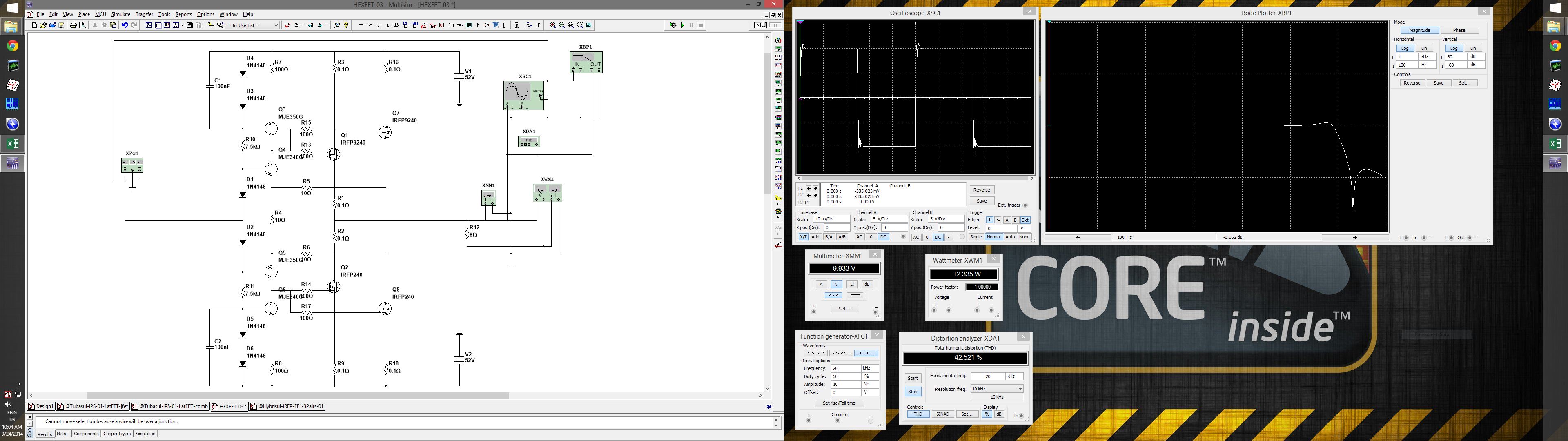

Hi All,
Another contribution to front-ends collection. Still a little bit under construction - no prototype yet. This is a revised version of my initial hybrid. I was working on it, mostly focusing on keeping the balance during start-up, when OS inspired me by super-pair VAS. So, this is what I came up with in the end.
THD20 is not measurable by Multisim even at 40V RMS output swing, low TIM by design, nice clipping. Much better behavior at start-up, thanks to a-la-Sansui symmetric mirrored LTP approach.
This is the next one I will prototype - working on PCB...
Comments are welcome 😉

The moskido thread was killed after a bit of a go around between the OP and moderation. I built a lateral fet output version...sounds nice.
Evan
