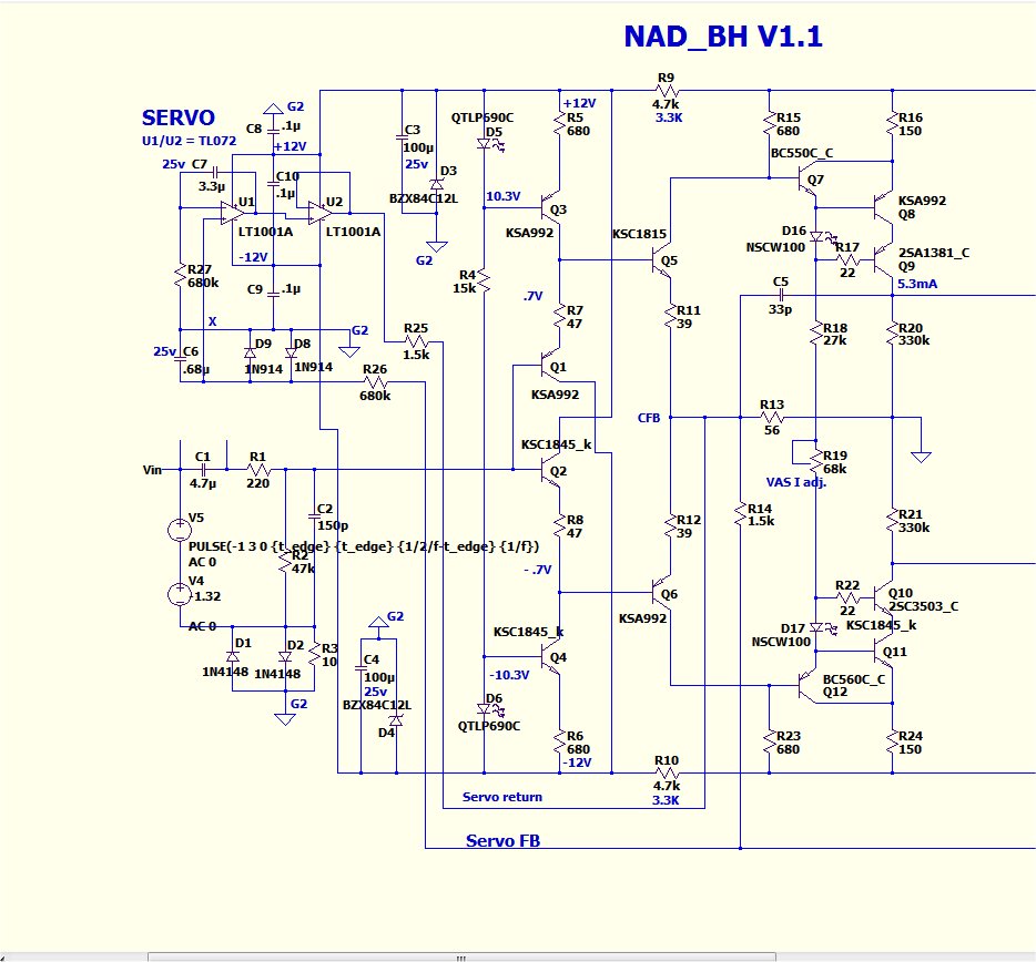

First , is the final design I will do for a CFA based amp.
I had the CFA-x or Nad (gonad) topologies to choose from....
I chose the 3 stage IPS (NAD).
I did so (even as the diamond input has been denigrated ) ...
because -
1.- It can be servo'ed
2.- input V/I is separate from the current feedback.
3.- I know more now 😀 .
SOME did not like the 3 stage CFA .... because -
1.- was not simple enough (give me a break) !! 😕
2.- Diamond buffer was unstable / scary ??
3.- 2'nd stage (CFB) gets too hot. This is an issue with both
CFA's as the CF stage HAS to provide that "current on demand"
to have fast slew and to satisfy a saturated VAS during overload.
I mulled over BV's enhancements (TMC , including the input in the
compensation loop, and the common ground for DC blockers.
Thimios said the original CFA-X sounded better anyways.
What exactly are we looking for ??
A.- reliability (free from magic smoke)- cool running ?
B. - sound quality 🙂🙂 .

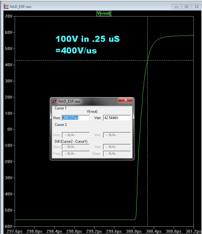

C. - SPEED !! the almighty "slew" ....

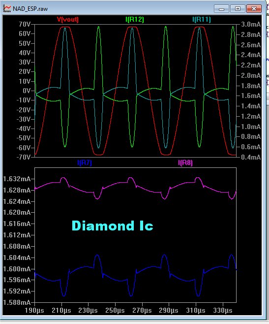

(attachment 1) is my answer to "C" (400V/us EASY) !!
"A" is why I am a "VFA guy" .... the Baxandall/Hawksford VAS
takes care of that. OVER load creates just 3mA in the CF stage
and does not affect the diamond at all. (attachment 2- top/bottom plots)
-Clipping is textbook.
"B" will surely follow. 🙂😀
The final circuit (attachment 3) addresses most of the bugs I have seen
in all the CFA builds , give 5ppm @ <10K and 10-12ppm THD20.
Most of the original nad is the same ....
Except -
1.- CCS's Re's are fixed , DC is handled by servo ... final VAS current
is adjusted by R19 (super-pair gain).
2.- R13/14 can be changed for more/less gain with no effect on other
parameters.
3.- Q7/12 should be low Vce (BCxxx) ... all else should run cool
enough to not even need heatsinks. 😎
BTW - Unity gain is 1.6mhz and this NAD will simulate with no comp. at all !!
.... surprising , considering the "unstable" diamond + a Baxandall.

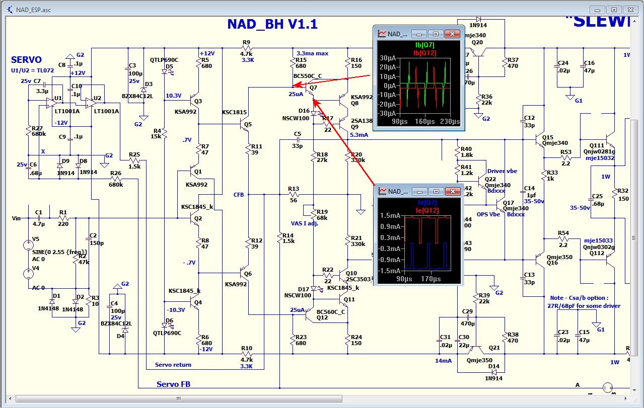

Excellent investigations, D... post 426 , I tried all those.
The "enhanced" is the Hawksford that most of the "slew" IPS's use
(successfully).
The last one " dimitri enhanced" has the Baxandall as a enhanced cascode.
Your Q1 would still saturate ?? .... but the cascode itself would not.
As far as my statement the diamond is a V/I and the 2'nd stage is definitely
I/I (CF).
The VFA equivalent would be the "H" bridge amp- with 2 true V/I's.
The CFA- X (vssa ...) uses just the first stage to do the same thing.
More current , less control .... poor little "stressed out" input pair.
I DID try the CFA-x with this VAS .... the input pair was still "stressed" ,
at 8+ mA - But it did work.

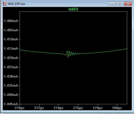

My VAS is the reverse of yours , with the Baxandall replacing the
single active device in the standard hawksford. NO saturation .. NONE!
(Attachment 1)
The current stage sees a symmetrical beta enhanced VAS and
the saturation clamp is within the FB loop of the Hawksford.
I probed the VAS , it has a peak at 10-12mhz .... I was even able
to make it oscillate at this freq. - the 22R base-stoppers (vzaichenko)
tame this nicely 😀 .
(attachment 2) no VAS cascode stoppers , no compensation
whatsoever on the IPS. All I can get is 10+mhz "glitches" 😎 ...
with the cascode stoppers , all is gone.
I would still use 33-39pf (C5). :2c:
Oh ... .asc below.
This is WAY better than any former CFA I've designed ! (stable as hell).
I maxed out at 65V in .1uS (650V/us) ...just a little overshoot.

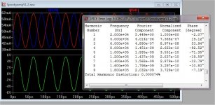

Ostripper ,any thoughts on designing a cfa or spooky based preamplifier?
That would be a easy as porting the IPS/VAS to 18-24V rails.
(below 1) is the "spook" with a few resistors changed .. running an EF2
class A OP into a 250R load.
The slewmaster IPS's can easily be ported to preamp/headphone OR
a larger power class A stage. NO mods needed (beside value changes).
If someone would give me a few ideas for a push-pull class A op?? .... 😎
Parts per billion territory for your headphones 😀 .
OS
