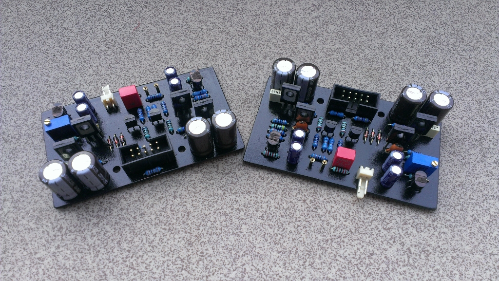

I've been waiting for this front-end to progress a little more. I've never played with tubes. Looking forward to trying it out.Hi All,
Another contribution to front-ends collection. Still a little bit under construction - no prototype yet. This is a revised version of my initial hybrid. I was working on it, mostly focusing on keeping the balance during start-up, when OS inspired me by super-pair VAS. So, this is what I came up with in the end.
THD20 is not measurable by Multisim even at 40V RMS output swing, low TIM by design, nice clipping. Much better behavior at start-up, thanks to a-la-Sansui symmetric mirrored LTP approach.
This is the next one I will prototype - working on PCB...
Comments are welcome 😉
Valery

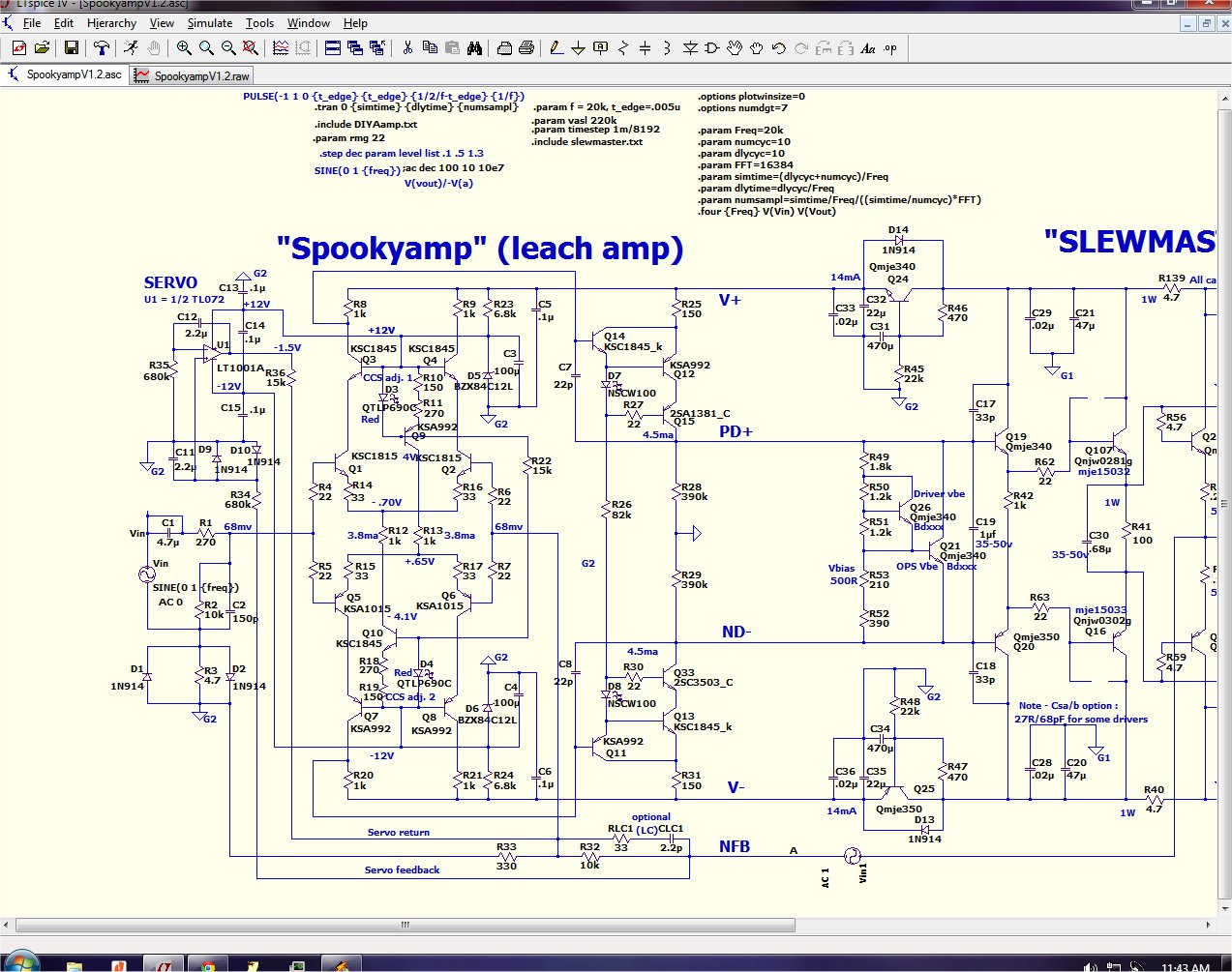

Hi All,
Valery

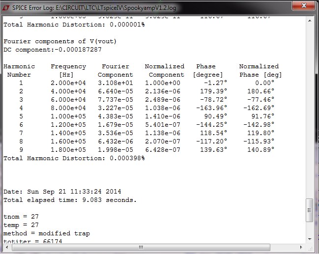

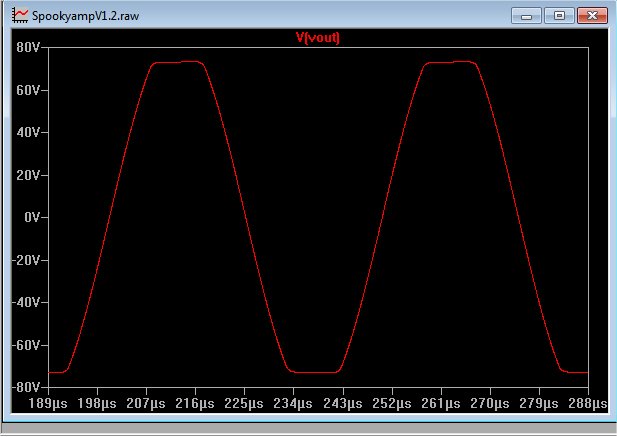

More inspiration .... 😀
Looks like the Scandinavian "ampliwire " topology (below)
minus the tubes and
the current sourcing of the second stages.
PS - I note your VAS design ... using the Baxandall as the cascode reference.
Quite a hybrid ! Would this be a true "super Hawksford" ??

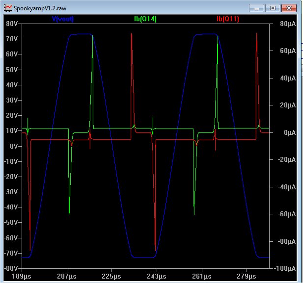

Biggest issue with the NAD/CFA-X was the excessive current demands on the
stages feeding the VAS ... especially during an overload condition.
CFA... "current on demand" could supply this current , but the devices could
be brought close to max Ic , as well.
With the "super Hawksford", Vas Ib is in the uA range (below) .... preceding
stages are " unaware" of any abuse (clipping).
There was one good BV mod (looping comp. back to first IP stage).
Combine this new VAS with that mod = perfection !!
OS

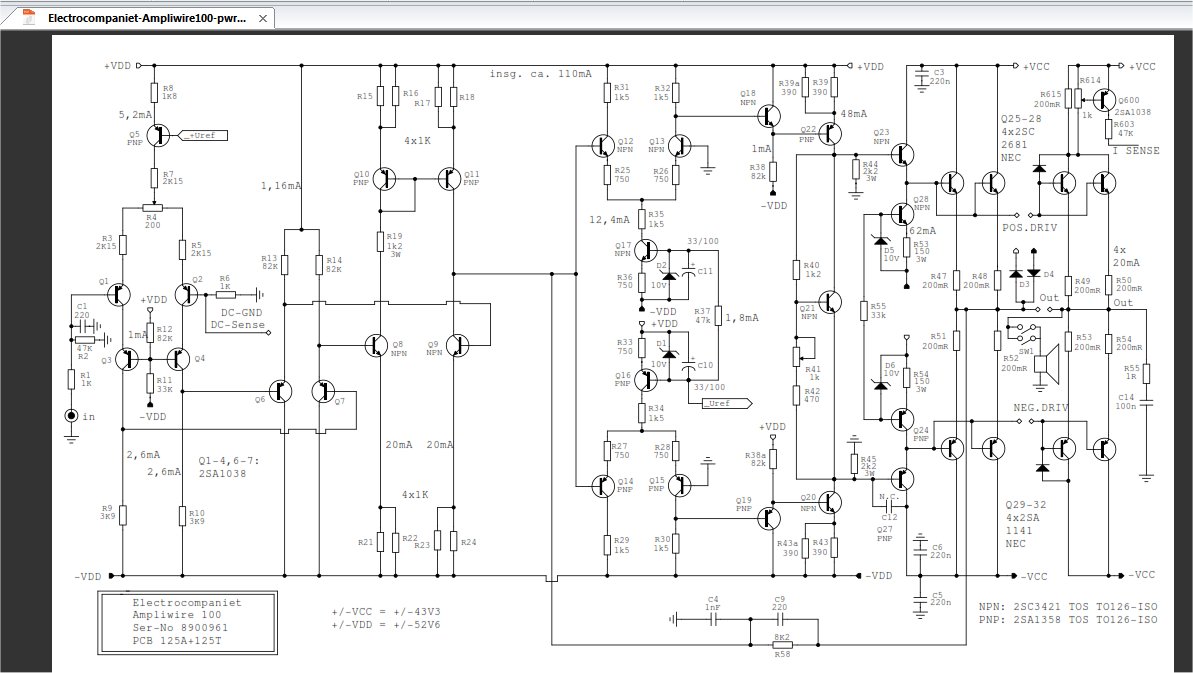

minus the tubes and
I'm pretty much familiar with Electrocompaniet topology, however in my case interface between first tube LTP and second pair of LTPs is very important - it needs to be as balanced as possible even when anode voltages go up and down (simultaneously)...
"Super Hawksford" - came out as a rather cool, combined "building block". I started, just adding a normal Hawksford to a super-pair, then I just saw I can arrange the same reference for level shifter (LED), tying it to the "first" emitter, rather than the "second" one. Also saving one resistor 🙂 Seems to be stable enough, with all the benefits of super-pair and cascoded VAS. This is where Mr. Baxandall and Mr. Hawksford met each other 😉
I was frustrated ... my first attempt was an oscillator (1mhz+).
Much !! more stable with a low Vce first Baxandall device AND the
main cascode base-stoppers. 🙂
I am sure we really have quite the VAS here ... all my IPS's
are in single digit PPM territory with no loading - perfect clip .... using
this "abomination" 😀 .
OS
