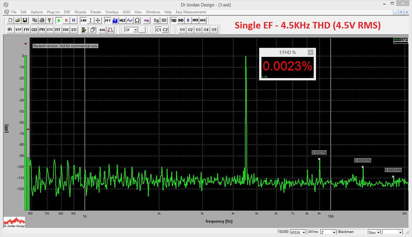

There is one more consideration - in favor of MOSFET. OPS, consisting of 3 stages (like EF3) always introduces additional pole at around 1-5MHz. In many cases it influences stability and has to be addressed.
With MOSFETs we can easily use 2 stages topology without compromising low influence on VAS, and additional unwanted pole is not there. More stability.
Also, though - BV is right - MOSFET OPS is less linear, THD difference is less than one order with strong dominance of the 2-nd harmonic (I can see it with live measurements). 3-rd harmonic and all the above ones are comparable. Assuming, all the designs we are talking about here, utilize rather deep global NFB (at least 60db loop gain), lower linearity is no problem in fact. Attached picture shows the live measurement of MOSFET option at 4.5KHz (at 1 KHz there's nothing interesting as all components are below 100db).
