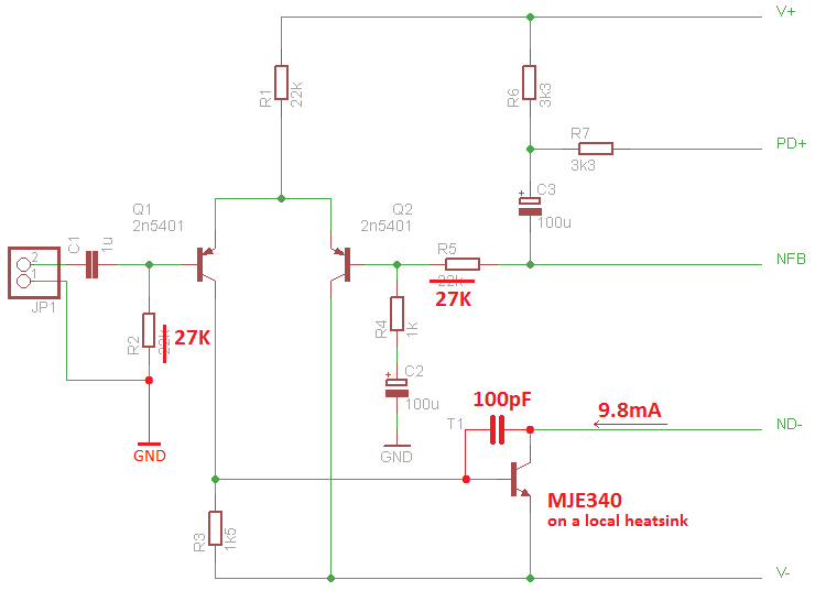

My own humble submission:
Hi Ranchu,
This is going to be fun!
May I suggest couple of things.
R5 (and R2 respectively) - 27K will make overall gain closer to the "standard" 29db.
Miller cap is a must here, otherwise it's going be a "screaming oscillator" 🙂
OPS will require re-biasing, comparing to most IPSs we use here, because of the higher VAS current. VAS is going to run pretty hot, but still acceptable (with a local heatsink).
I ran a couple of simple simulations (with SlewMonster OPS attached) - it shows 0.029% THD @ 1KHz and 0.76% THD @ 20 KHz.
It's funny THD does not change in a wide range of OPS quiescent currents - meaning, OPS's portion of distortion is negligible here 🙂
It will be very interesting to hear how different it will be, sonic-wise.
I think I'm also going to test it 😉
Maybe, if the VAS doesn't already have enough Cob. Sometimes Cob is actually MORE than you need, so the HF THD is limited not by the miller cap, but by the VAS transistor you use.
Yes, the THD comes from a stage before the OPS, the Early effect and Cob of the VAS, and thus is a load-independent signal distortion - as if you had a harmonic effect in front of the amp but after the volume control. The OPS distortion is still present, just swamped by the enormous VAS distortion.It's funny THD does not change in a wide range of OPS quiescent currents - meaning, OPS's portion of distortion is negligible here 🙂
In simulation it oscillated violently - phase responce is very bad with no miller.
Yep, that's what I mean )
And that's exactly what we need to prove we can hear the difference... or we can't 😀 I hope we can 😛
Valery
Argh! I forgot the miller cap, that's what happens when trying to knock together this schematic in 5 mins flat! I have had very good results with the KSC3503 in the VAS position, and with this topology and VAS transistor we can safely drop down to 68p.

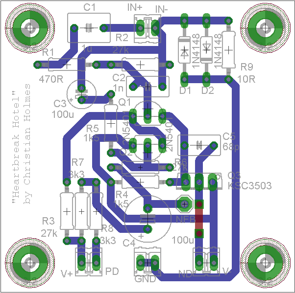

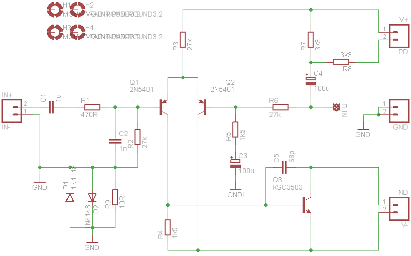

Heartbreak Hotel
Hi guys, I bring you "Heartbreak Hotel", named after the popular Elvis song recorded the same year Harry C. Lin devised the topology this design is based upon.
I've laid this out with all through-hole parts, single-sided, in case anyone cares to build it.
I note that OStripper's input stages all feature a ground lift, so I've followed suit in case noisy grounding implementations put this one at a disadvantage... 😉
Valery, if you still have this in Spice, and have the inclination, perhaps you could calculate the currents in the LTP collectors so we can optimise R4.
Yes, in fact the optimal value for R4 is 510R. LTP is the most balanced in this case.
But in this case, THD20 is reduced to 0.042%, making the distortion much less distinguishable... It becomes too good 😀
One more thing - let's turn Q3 90 degrees CCW, making more space for a heatsink 😉
