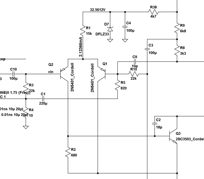

This is my version. It have good THD profile 😎
The full schematic looks funny - a tiny IPS with a massive power section 🙂
Yes, pretty good distortion-wise.
Back to the roots 😉

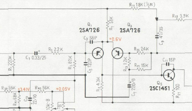

Just remembered I saw this classic approach in some rather expensive (at that time) heavy amplifier... Looked into my archives and - Bingo!
Pioneer SA-8800. Second half of the previous century 😛 1980...
Looks familiar, huh? Has got some VAS degeneration, by the way...

I remember that amp. Did its predecessor (ie: SA-9500) have the same IPS? I believe they had BJT drivers but that's about all I can recall. These go pretty cheap on Ebay, anyone know if they can economically be reworked with a CFA circuit?
The degeneration is most useful when the load is very high impedance or your OPS has very high input impedance. In this circuit it could have been there just to limit the VAS current on negative overload.

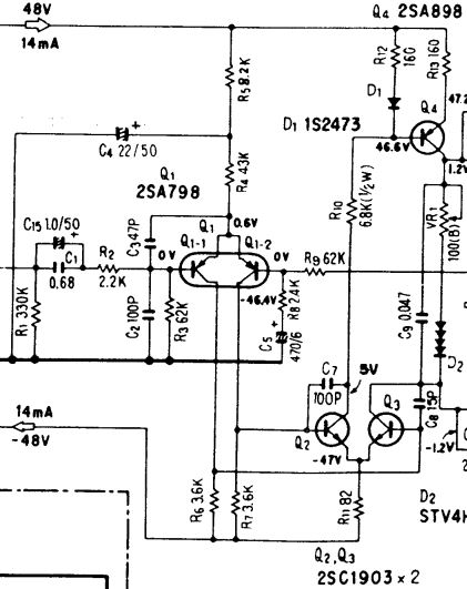

in the post 3972: the circuit corresponds to the receiver Pioneer SX-737.
GEirin
GEirin
Sorry vzaichenko
GEirin
OK, I understand where confusion comes from.
There was another SA-8800, manufactured earlier (1975) for internal market only. The power section there is unified with SX-737.
Here is some info on this "other" SA-8800:
SA-8800 for Japan
"International" version of it is called SA-8500 (1976). Same schematic.
The picture in my earlier post is actually for the latter international version of SA-8800...
