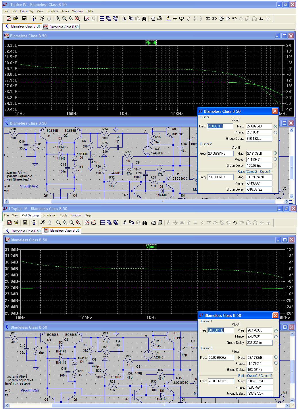

It seem obvious that we want to have the open loop bandwidth of any audio amp flat in all the audio range. It means still flat at 20Khz.
This will lead to a constant feedback ratio in the band, and no, or minimal phase shift, once looped.
Unfortunately, and even with the fastest devices we can find for each stage, it is very difficult to achieve.
It is very simple to achieve (attachment,local NFB via R37, C20 around Q15, cascoded VAS) and the only "advantage" is increased distortion at lower frequencies (lower LG), nothing real gained at HF. In simulation with C20 connected (upper part of picture) is OLG flat to 30kHz. And as low NFB network impedance as we want-and power stage alllow (to supress influence of nonlinear parasitic capacitancies) we can use with VFA the same way as with CFA, too. No problem, only slight DC imbalance.
