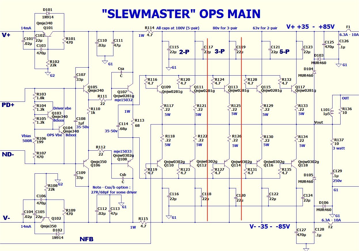

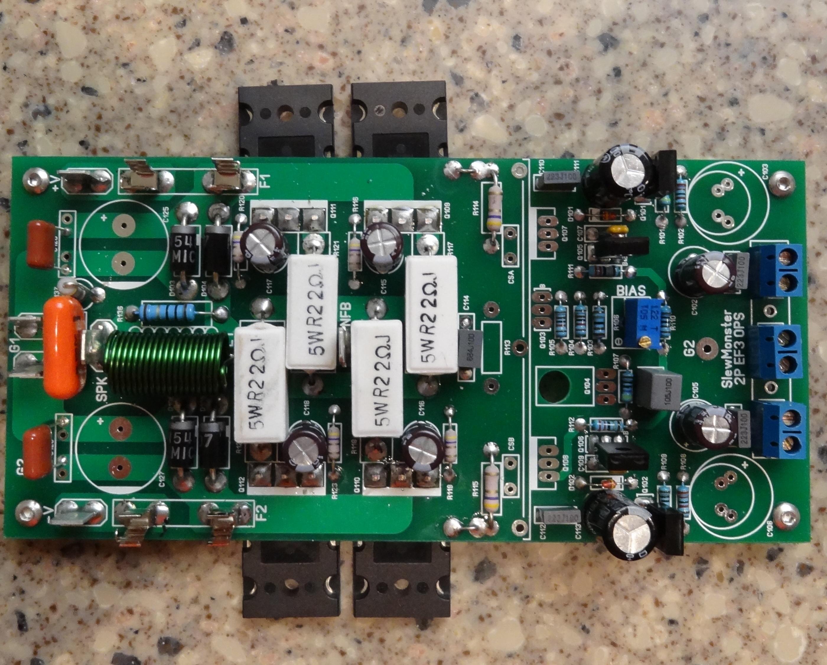

Hi Guys,
I am building a pair of the SlewBaby OPS boards. They are like the Slewmaster OPS except they have only 2 pair outputs and the drivers are TO-220 devices.
My question is should the current be different through the TO-220 devices than the TO-247 devices? Should I use a higher value for R113?
I'm planning to use 2SC3423-Y/A1360-Y for the predrivers and cap mutiplier, BD139 for the VBE multiliers, MJE15032/33 for the drivers and MJL4281/4302 for the outputs. It will most likely be run with +-56v rails. Does anyone see any problems with my device choices? Do you see any other components that need to be changed in the attached schematic?
Thanks, Terry
Hi Terry, I don't see any problems. No stability issues expected.
Power dissipation of TO-220 drivers will not exceed 1.6W in normal operation (with R113 = 68R quiescent current = 20mA, Pd = 1.12W). It may raise up to 5.5W in case you run a square wave at full power, but a) it is still acceptable assuming a decent heatsink b) it's a very rude way of using an audio amplifier 😉 Anyway, the output devices will already feel much more stressed at that time.
Valery
