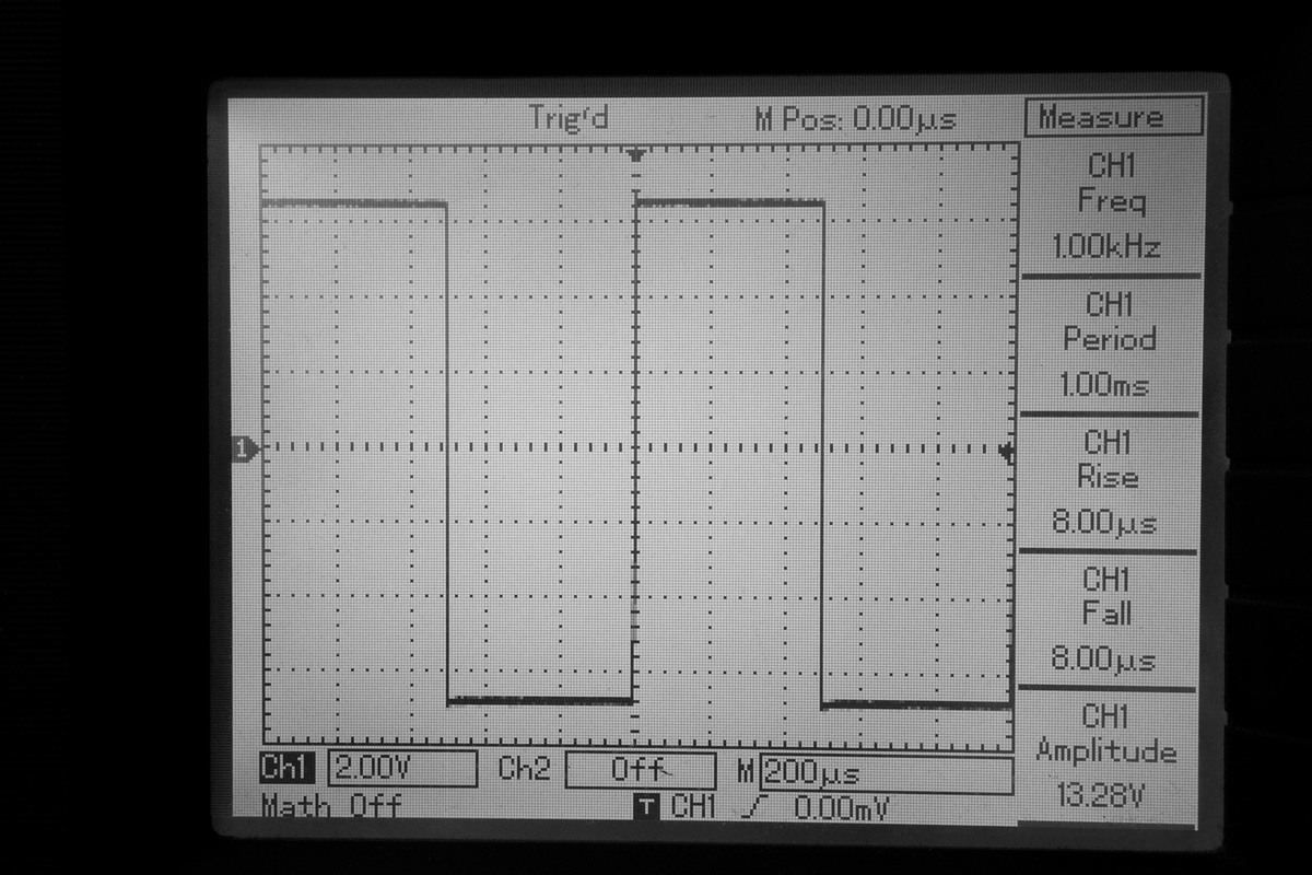

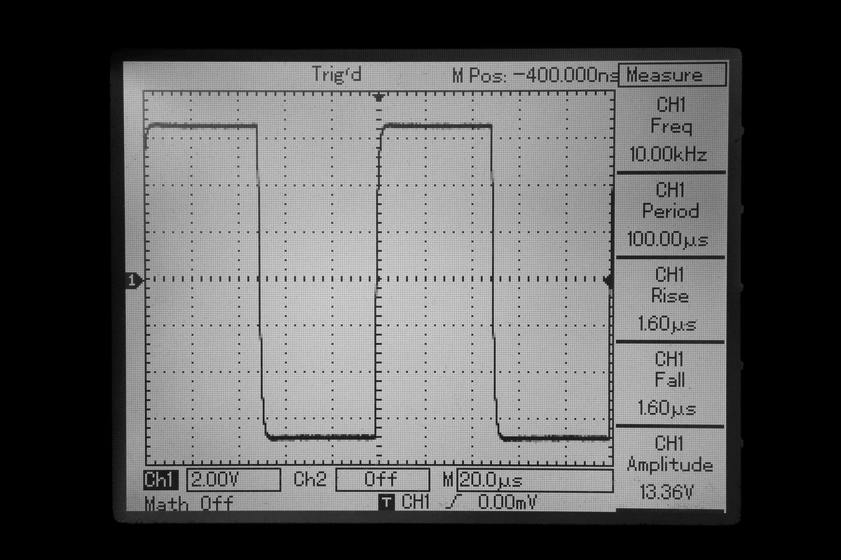

Test #1

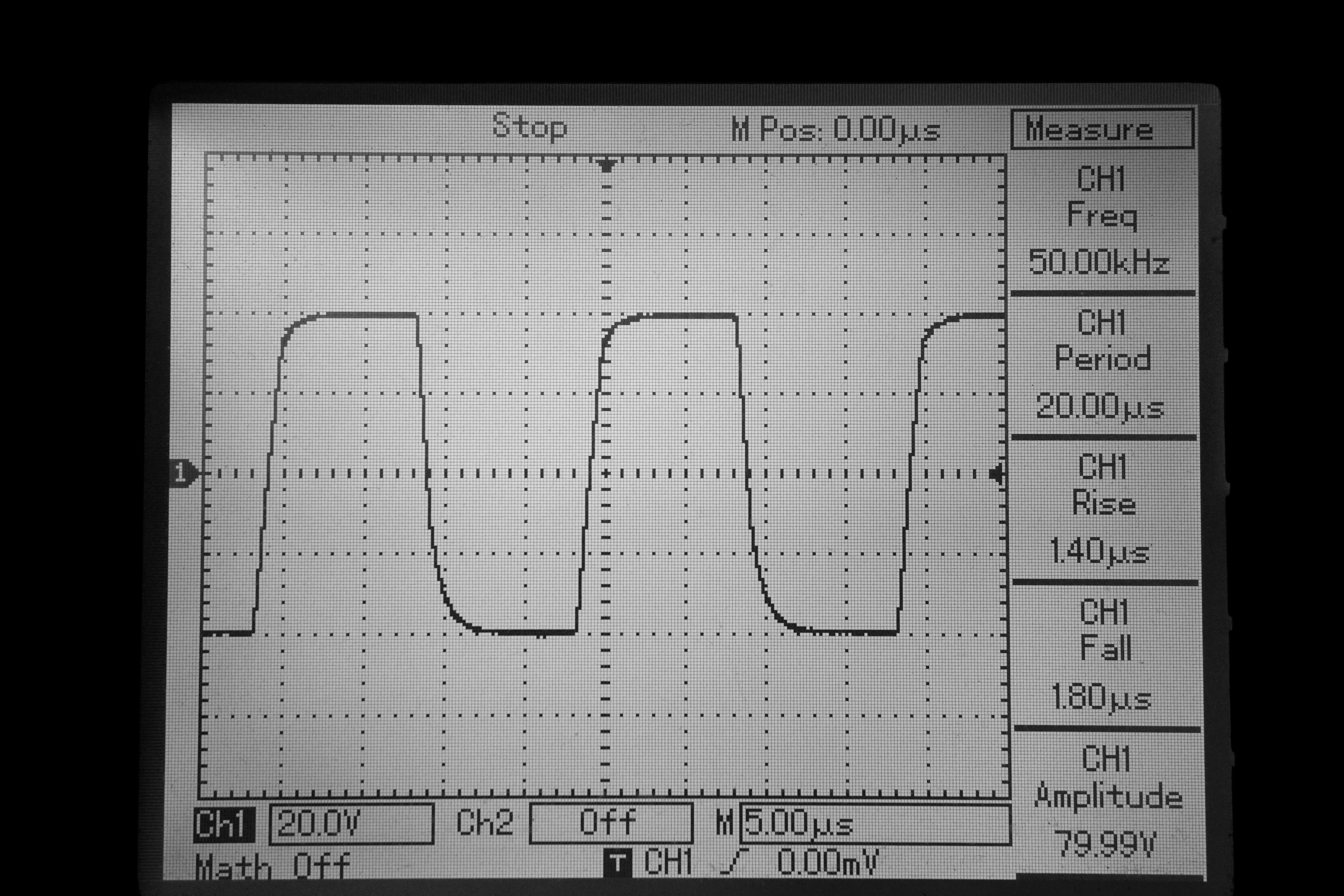

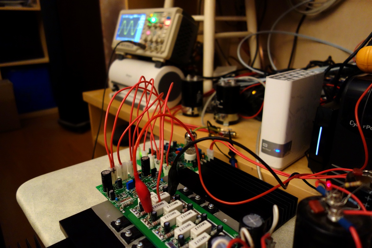

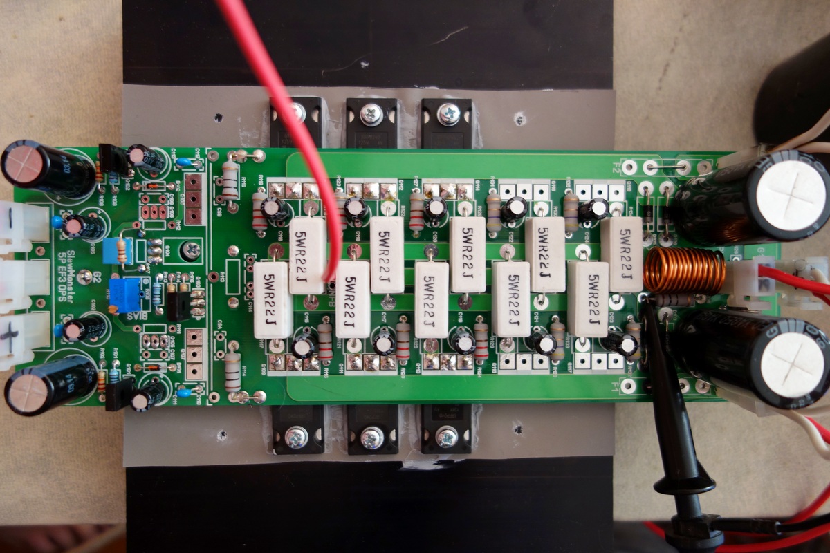

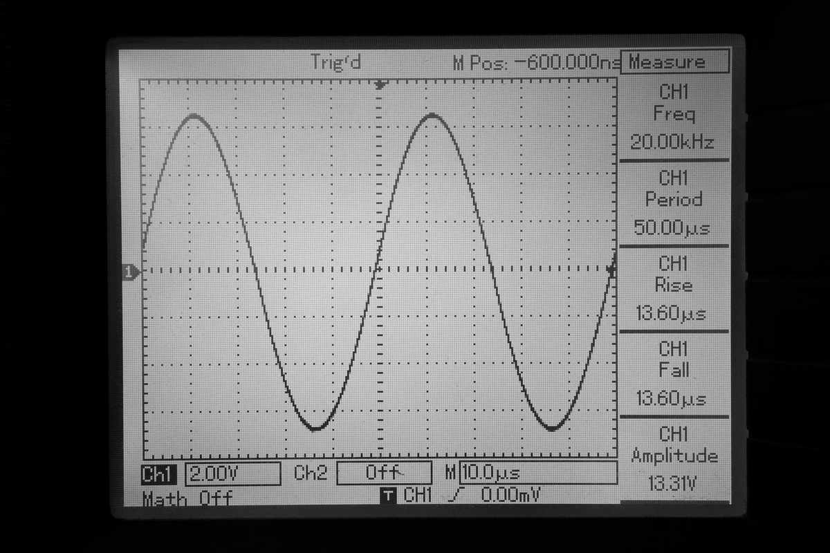

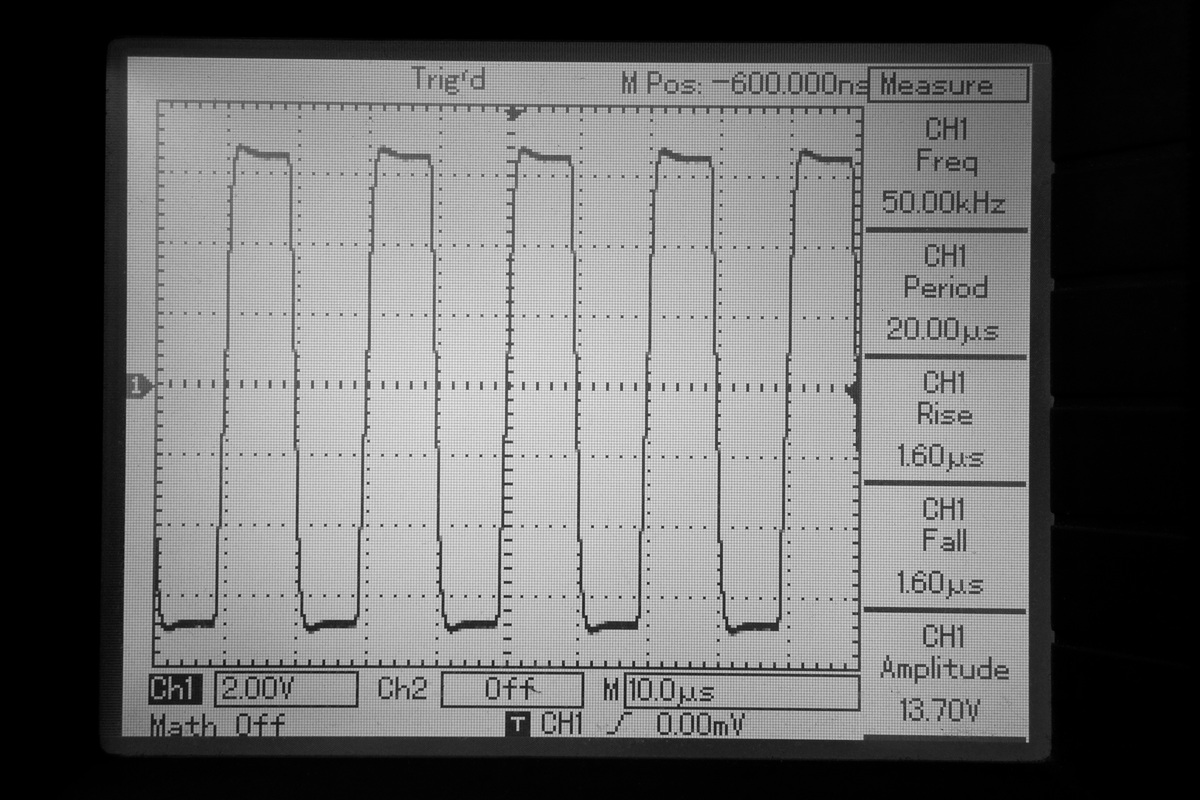

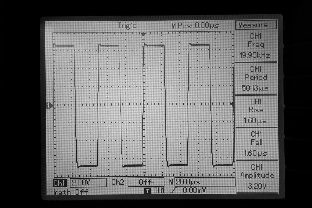

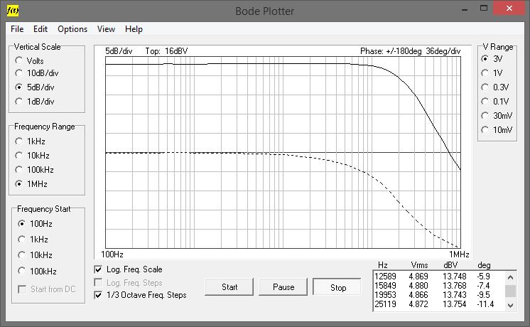

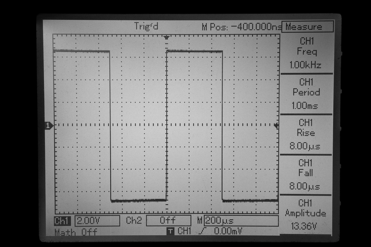

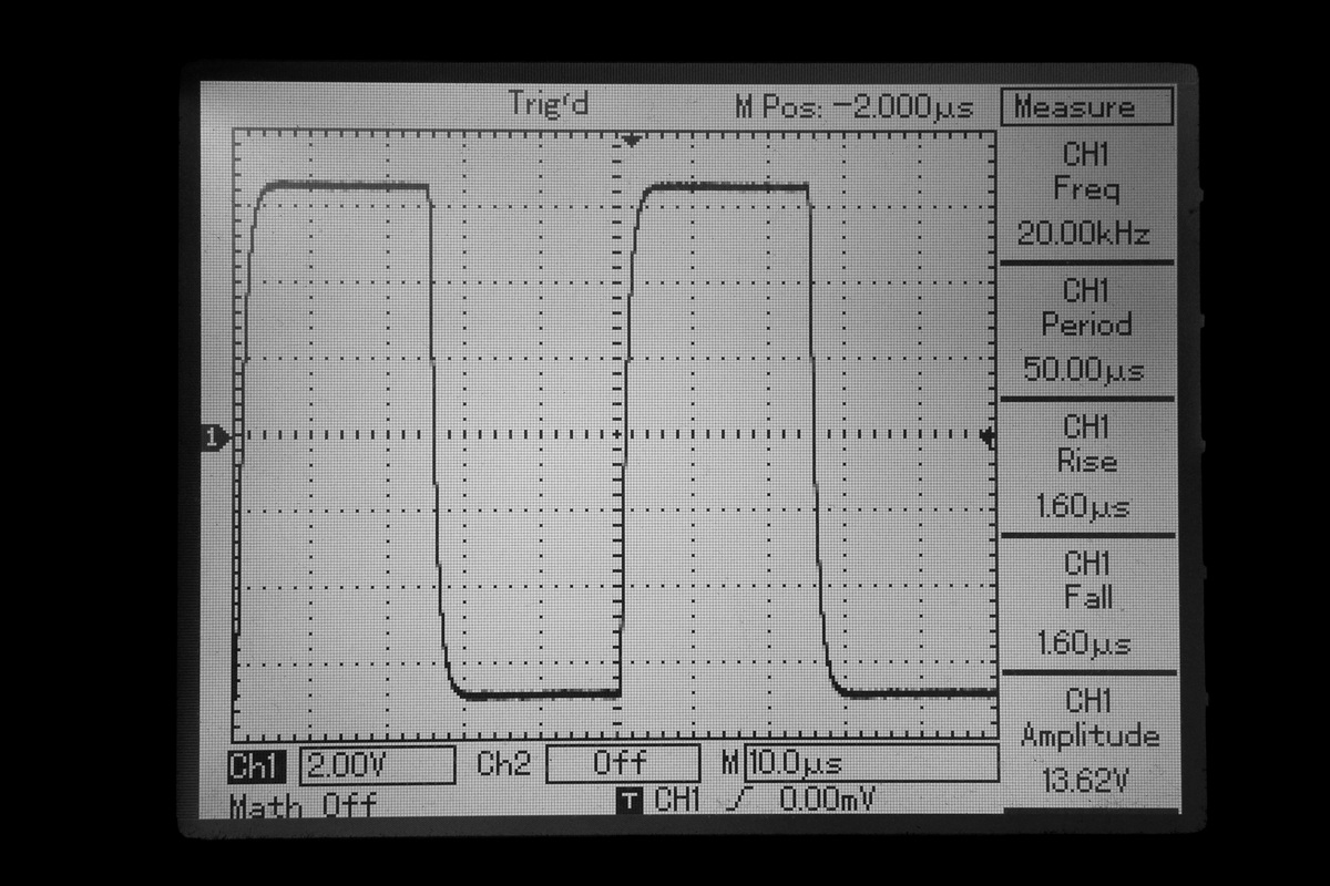

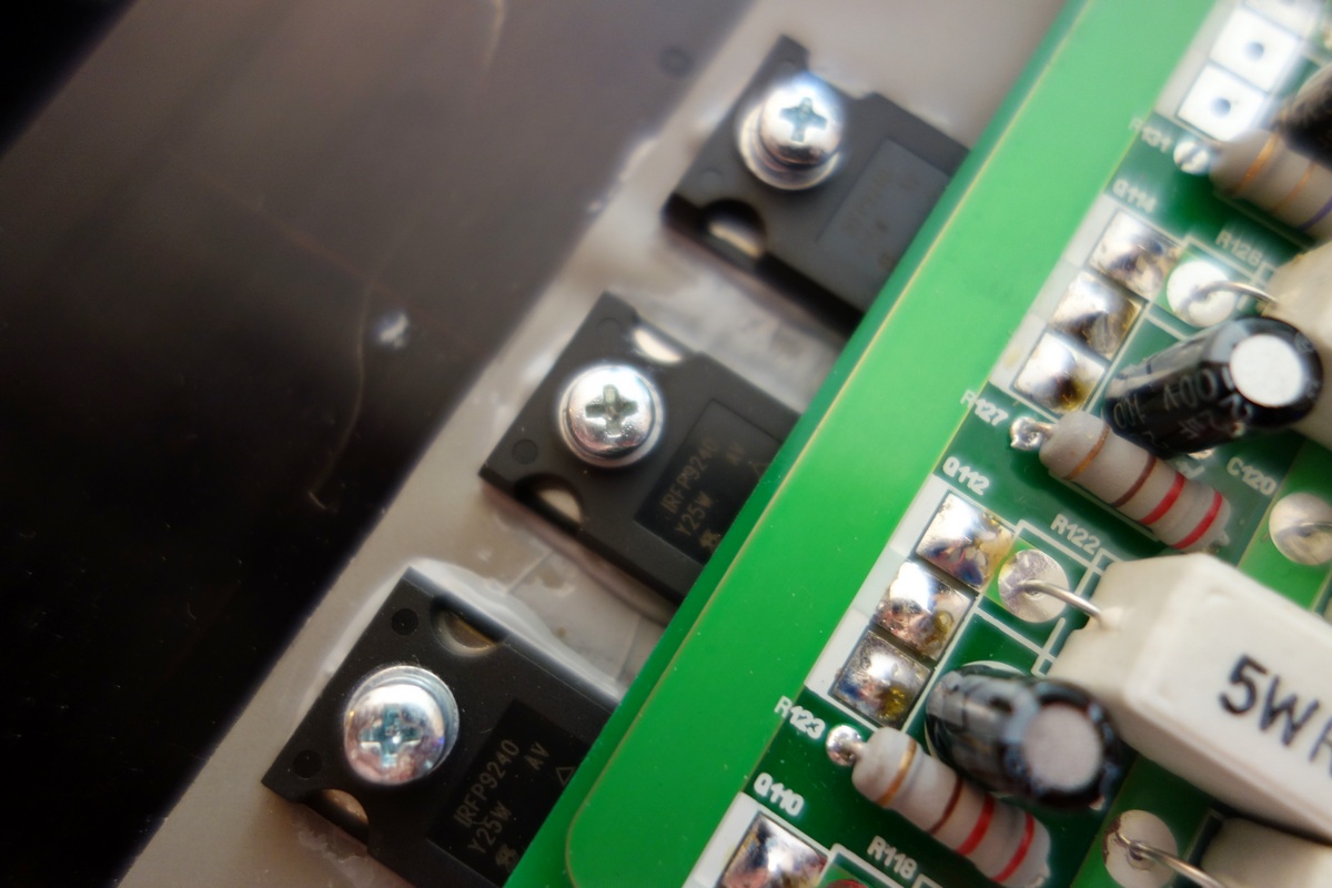

OK, guys, here is the first configuration. No buffers - 3 pairs of MOSFETs are connected directly to the front-end (cascoded VAS, running at 4.7 mA). No additional compensation. Only 3 pairs of MOSFETS and a spreader (plus 2 Zeners to protect the FETS).

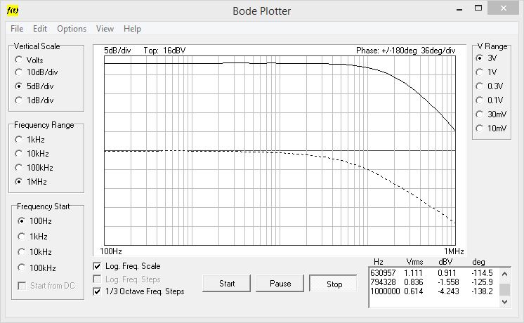

70mA per pair idle current. See some curves (Bode, 1KHz, 10KHz, 20KHz, 50 KHz squares, etc.). Rise/fall times are limited by the front-end compensation (I did not touch it since I used it with the previous setup - SleaMaster with BJTs).
Unfortunately, I can't see the spectrums - something happened to my soundcard's outputs - they stopped working. Spent 2 hours trying to figure out what happened, but looks like a hardware failure 🙁
Sounds very good - maybe a bit warmer that BJT version. Need more listening to say something more specific.
The good thing - it works flawlessly.
Anyway, I'll try the second configuration - with single EF buffer running at 10-11mA - today in the evening.

You work super fast Valery!
I'm amazed that you can drive three pairs directly from the VAS. How much VAS current are you running? Seems to be stable with just gate stoppers and no gate-drain zobels - I'm impressed.
Great work 🙂
Thank you 🙂 Really interesting theme 😉

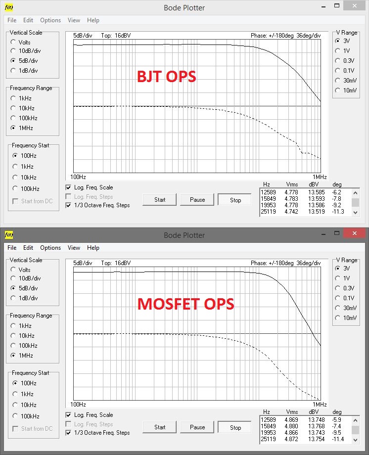

VAS (and therefore cascode) runs at 4.7 mA. My initial simulation showed no problem at, let say, 1 KHz, but certain THD increase closer to 20KHz. That's actually why I am going to test an option with additional EF buffer in front of MOSFETs. Unfortunately I can't measure THD now because my sound-card got broken, but looking at the Bode plots, I see that MOSFETs definitely give additional load to cascode at HF (see the picture attached).
And yes, I really like it works with no additional caps. Gate stoppers are 220 ohm (rather usual value)...

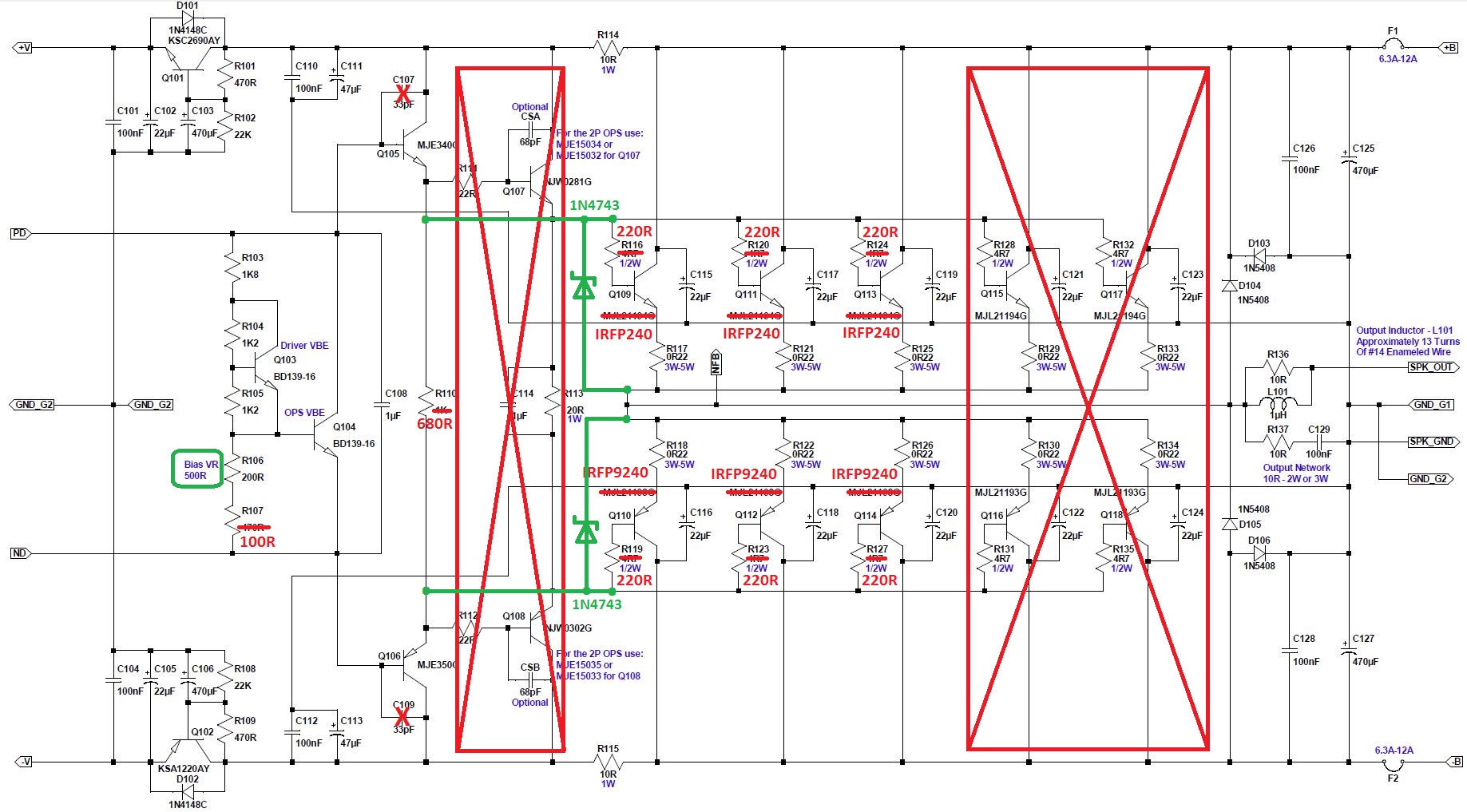

This is pretty cool though. Same board with minor changes in values and you have a MOSFET OPS. This wasn't by design, but a happy accident.
Are you using a MOSFET in the bias spreader on the main heat sink?
Yes, this is a very cool option 🙂
I use the spreader exactly as it is in the original design, the only difference - I use MJE340 transistors (just have got lots of them), and changed R107 to 100 ohm for shifting the bias range to higher values.

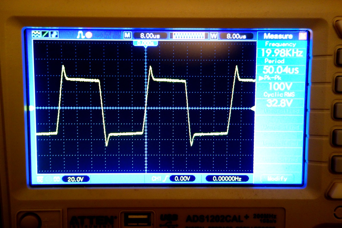

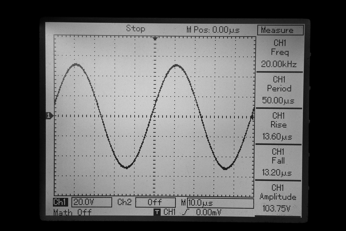

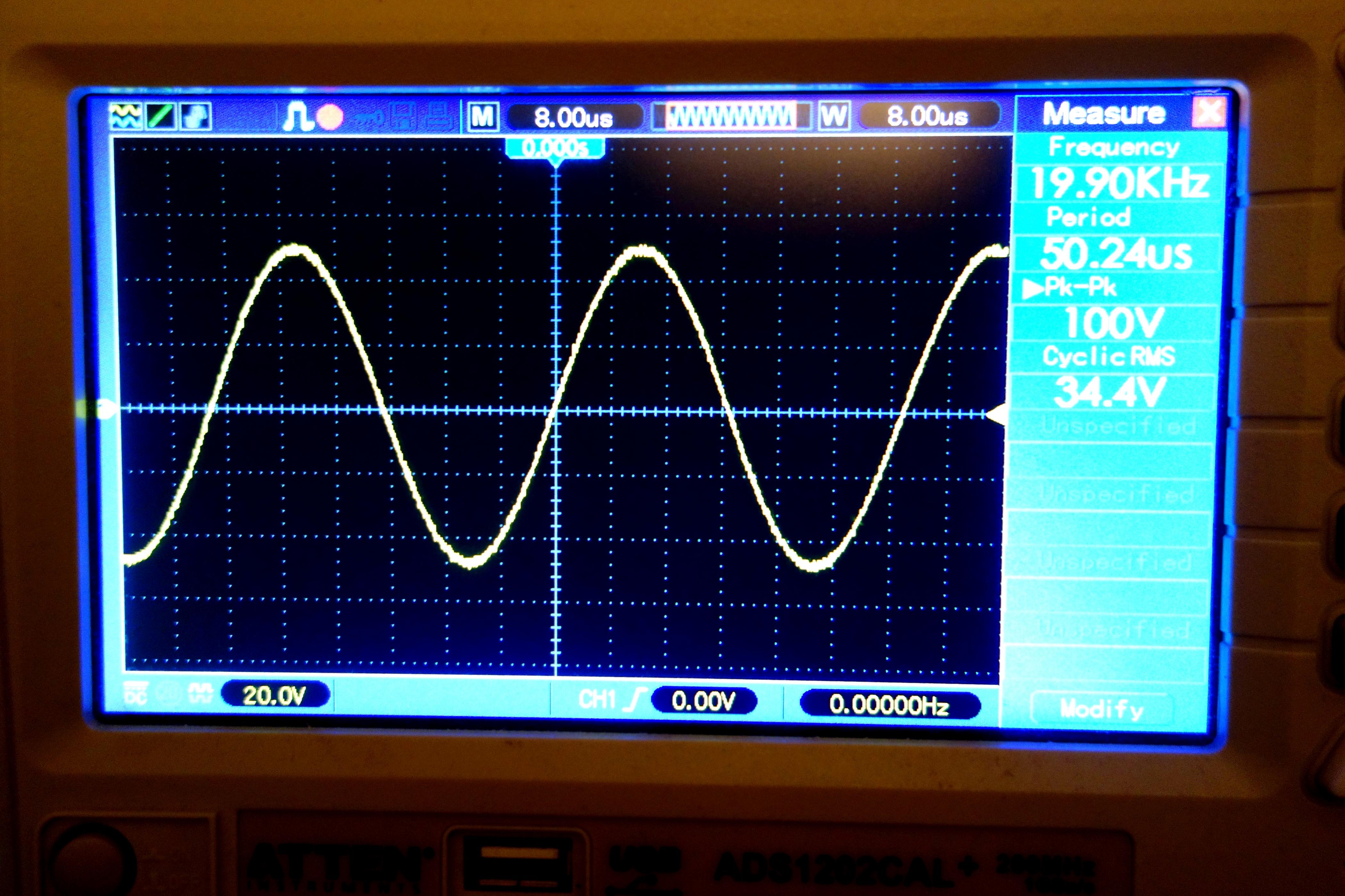

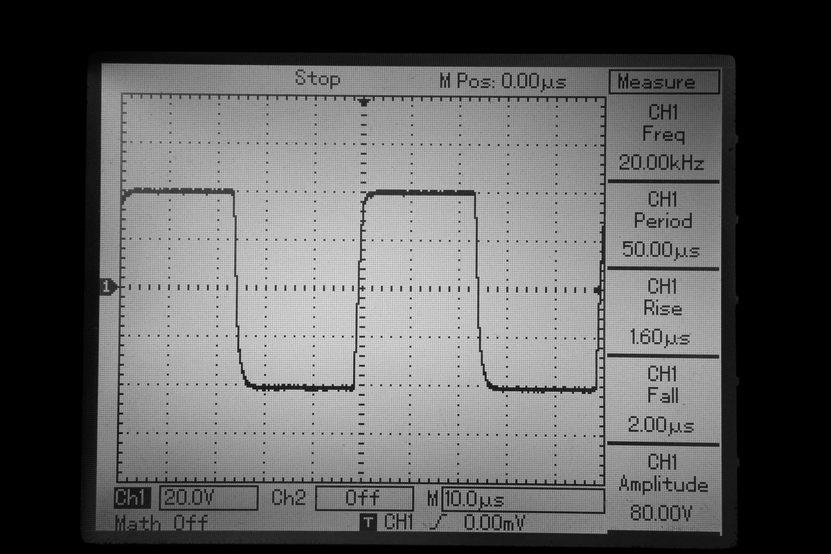

The idea to drive 3 pairs of MOSFETs directly from VAS is definitely not a good one. I would like to see full-swing 20kHz sine and full-swing rise and fall edges of the square. We might see more, then.
Pawel, I did it mostly for general "proof of concept", comparison and simulation confirmation purposes. I will though publish the full swing curves later today, but with some higher load (my 8 ohm load resistor will explode at 120V p-to-p, same as OPS itself at a relatively small test bench heatsink)...
Valery
100V p-to-p
Here are the pictures. Clear overshoot at high amplitudes, but it was predictable - this is why I will add a EF buffer now and see how it goes at higher current...

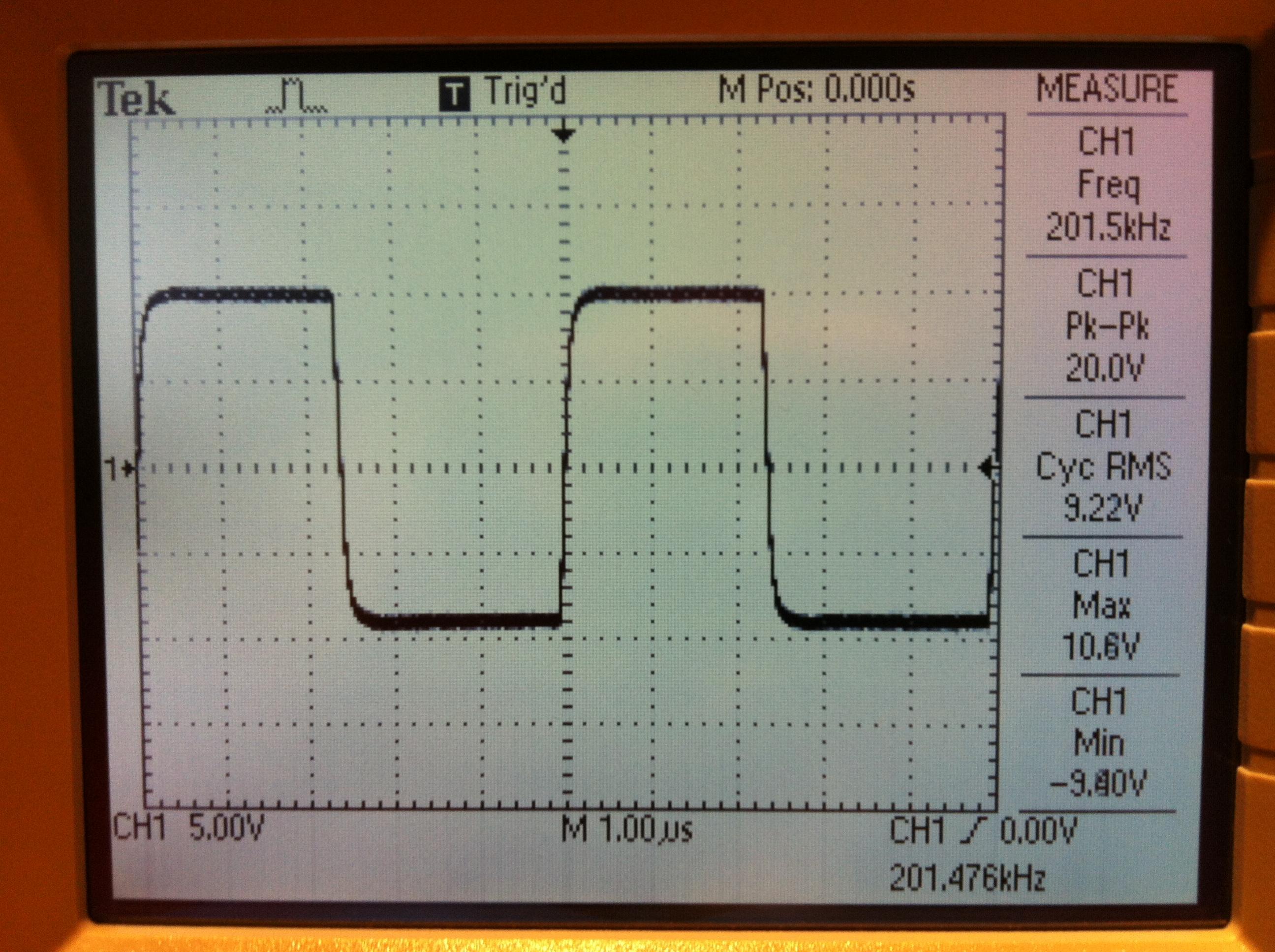

Now with EF buffer in front of MOSFETs

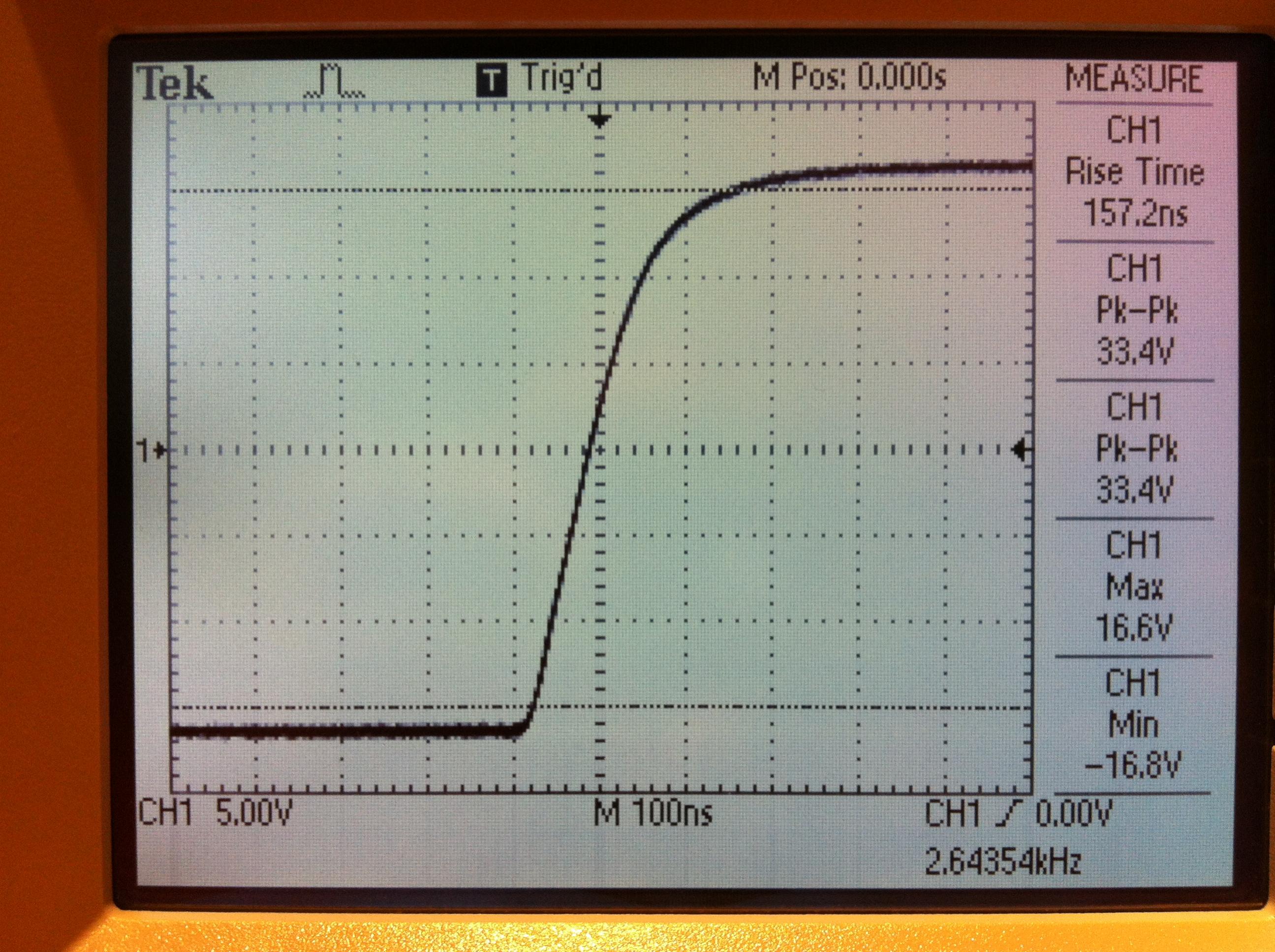

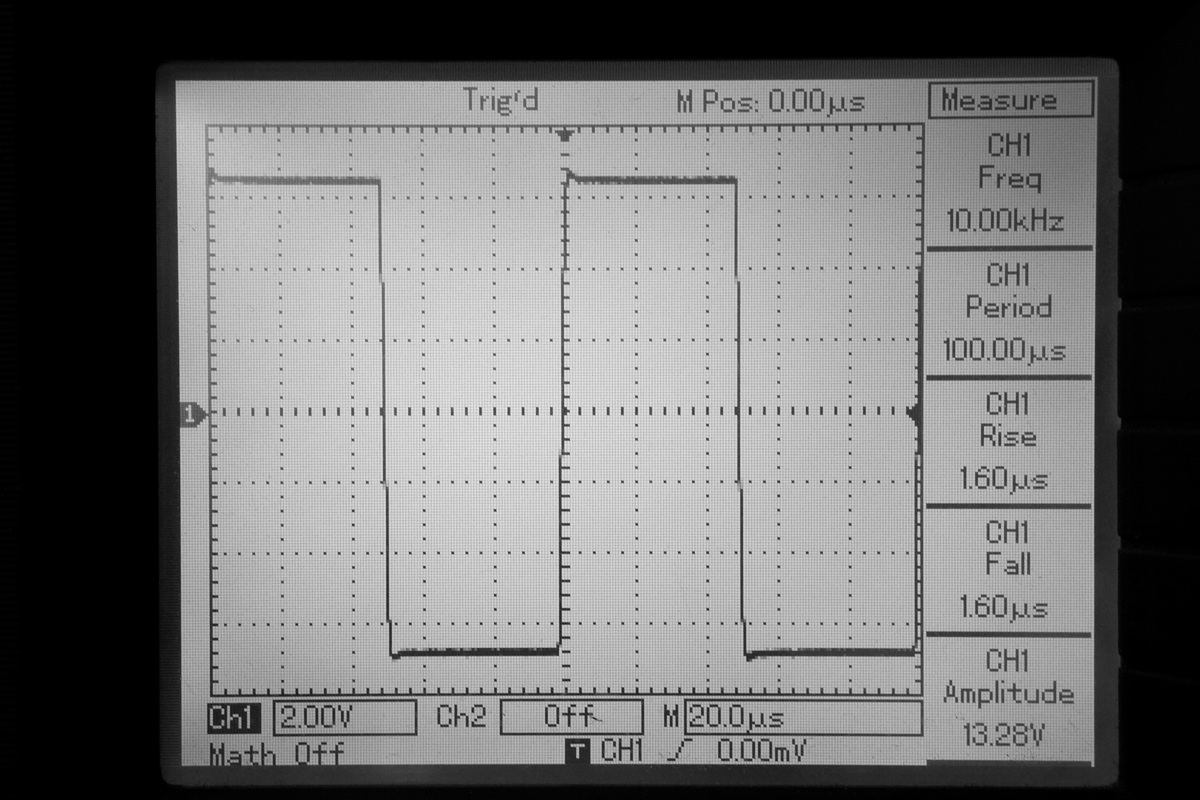

OK. The one with the follower. This one is excellent. EF works at 10mA. Drives 3 pairs of MOSFETs very well. You can see the Bode plot is somewhat flatter on the right (it actually copies the plot taken from the front-end with no OPS). Square waves are much better - no overshoot. Lower voltage ones are taken with 8 ohm load, higher voltage ones (80-100V p-to-p) - with 23 ohm (otherwise the load started burning). Again - everything looks close to simulation. THD20 is definitely lower than the one with no EF.

See the schematic - changes are minimal. I use small aluminium heatsinks on MJE340/350 follower transistors - they are moderately warm at 10mA.

Valery, waiting intently for your results with the buffer stage...
If you get the time, would you kindly sim the results with a single pair of FETs hung off the VAS at, say, 20kHz 22Vrms?
Ranchu, I ran the sim with these parameters - even one pair loads the cascode (at 4.7mA) too much - THD20 grows 5 times (though at 1 KHz it's no problem)... Together with EF it's coming back to normal. So... either increase the VAS / cascode current (possible with lower rails, mine are +/-70V now) or use the follower 😉
