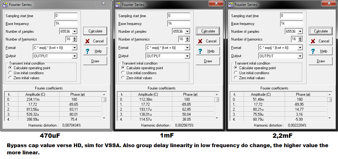

Ok, let's go back to OPS stability with different output devices for a minute.
I did some simulations, actually confirming what's been said above.
Analyzed circuit is my tube-hybrid IPS together with SlewMonster OPS.
OPS creates additional pole on overall frequency response curve.
Picture 1 - with faster NJW3281/1302 transistors this pole is around 4.6 MHz and 5.5 db below the unity gain level. Acceptable - we cross unity gain with 20 db/decade slope.
Picture 2 - with slower MJL21193/21194 the pole is located at 3.2 MHz and actually lays on the edge - roughly at the unity gain. This is a problem - frequency response slope changes from 20 db/decade to 40 db/decade here and we don't want 40 db/decade to be located at the unity gain level.
Picture 3 - this is how we can solve it - increase the value of C107, C109 (pre-drivers shunts) from 33pF to, let say, 150pF. The pole stays at 3.2 MHz, but moves down to -6 db - and we are fine again.
Anyway, the faster devices are the better. SC2922/SA1216 Sankens would be a good choice here as well, with Ft = 50 MHz and Cob = 250 pF (half of any of the above).
Hope this helps.
Valery
