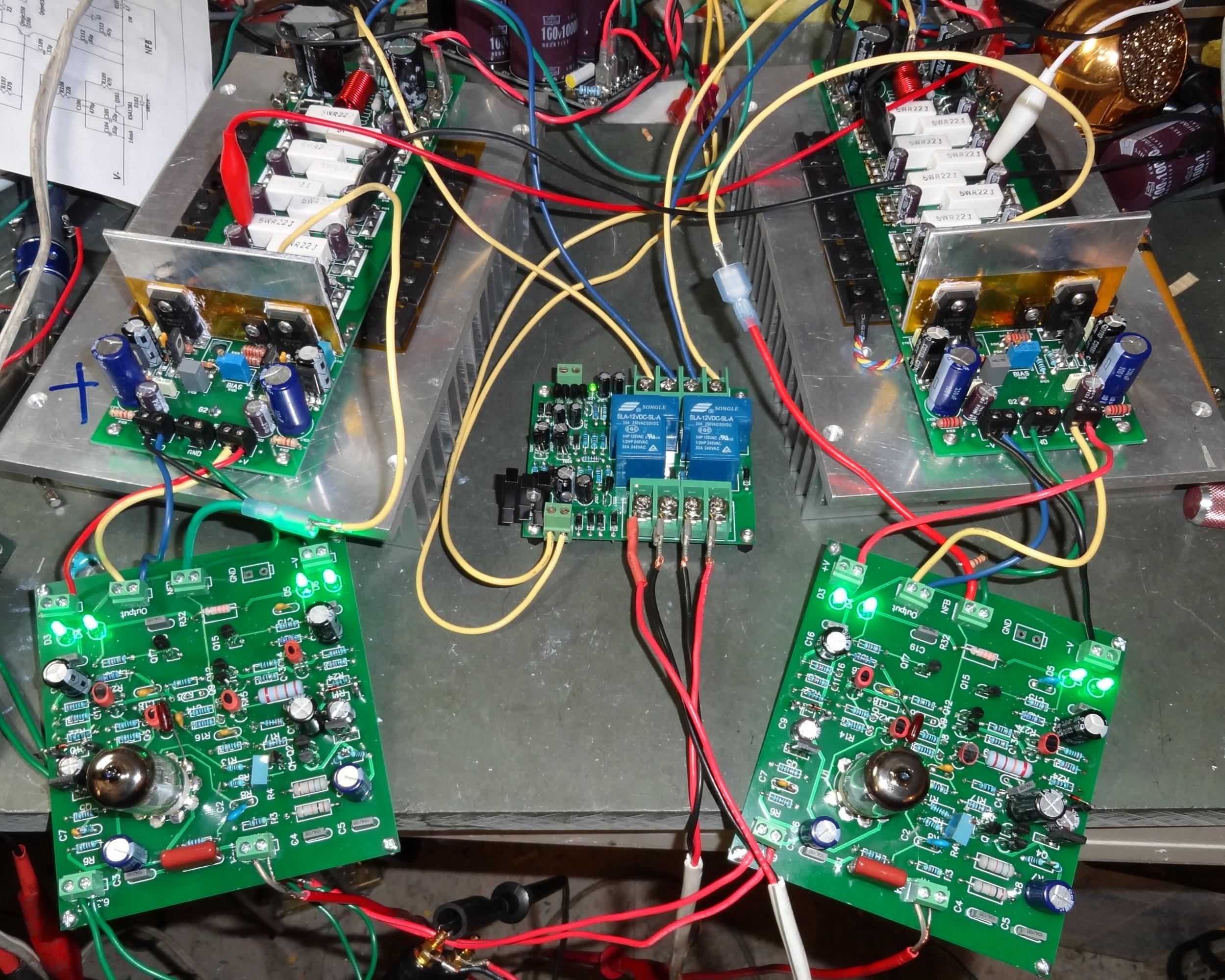

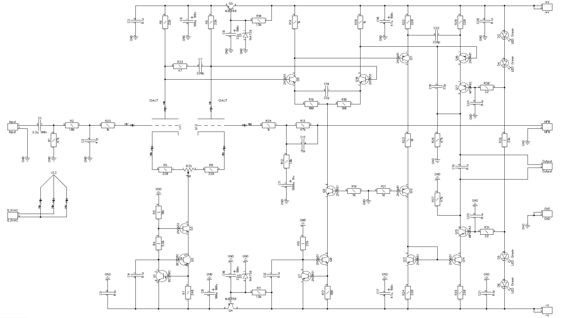

The Low TIM hybrid is playing. Sounds very nice but one channel is noticeabely louder. I can see it on the bias too. I tried swapping tubes and there is no change. Must be something else. Maybe I missed changing one of the resistors. With so many changes it is sure possible I missed something. I'm attaching a photo of it playing. Pardon the rats nest.

I found the issue. For some reason, I had 100k in the feedback resistor. Should be 47K. Now all is good.

Terry, great to hear it, congratulations!
Thanks. I feel like a load has been lifted. There is a lot more to getting the hybrid working with needing the heater transformer and needing the delay for the speaker protection. It does sound very nice.

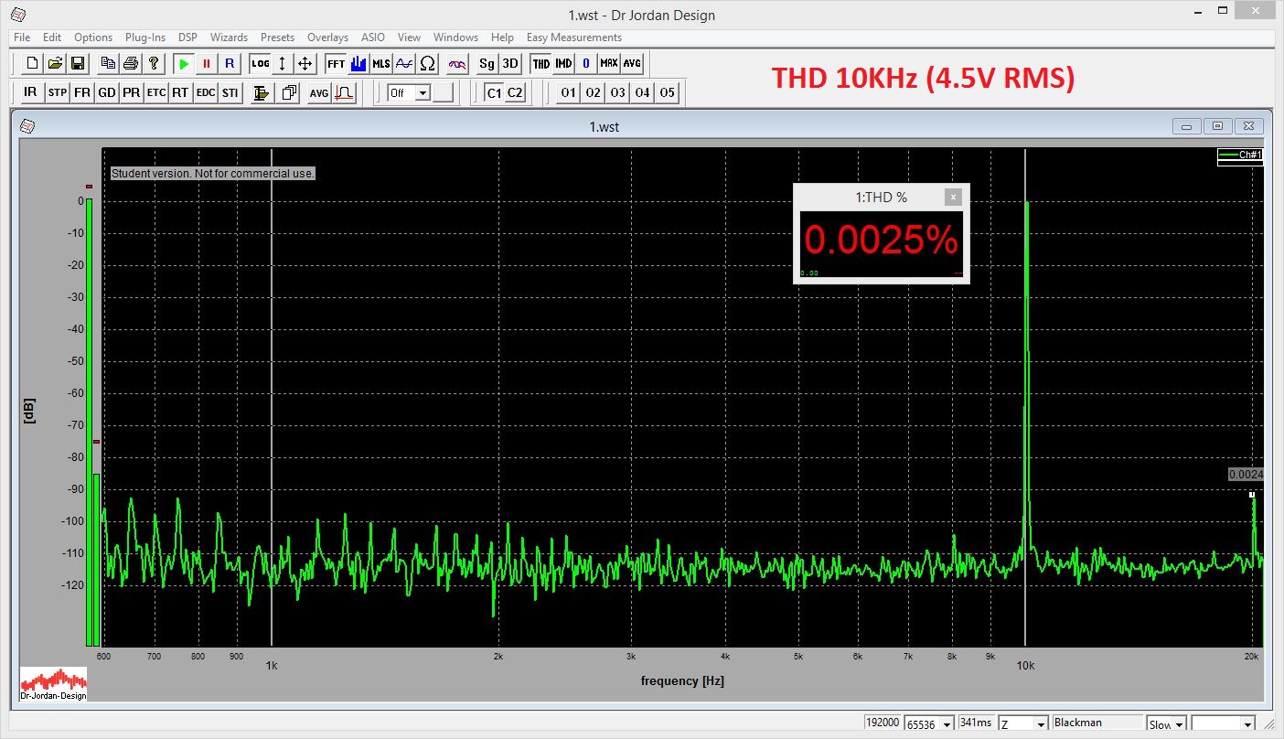

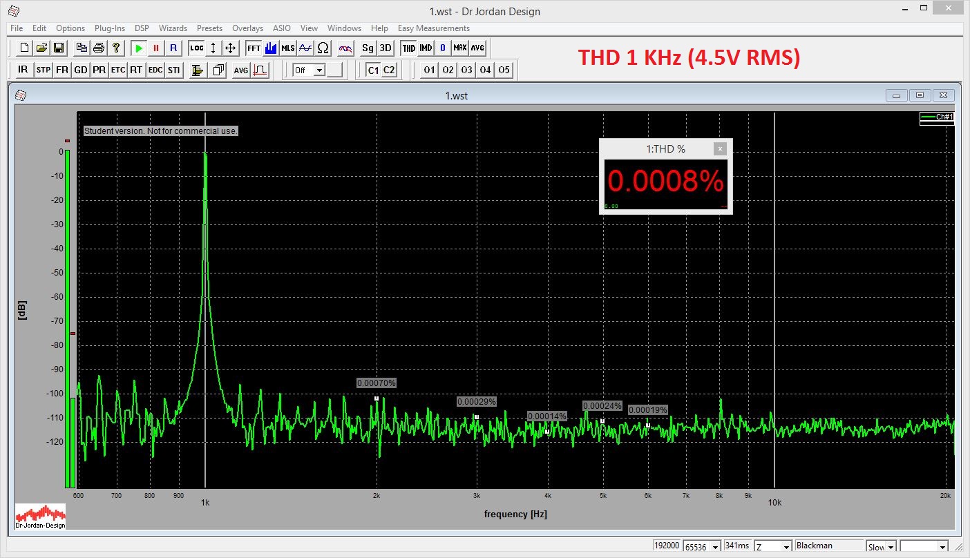

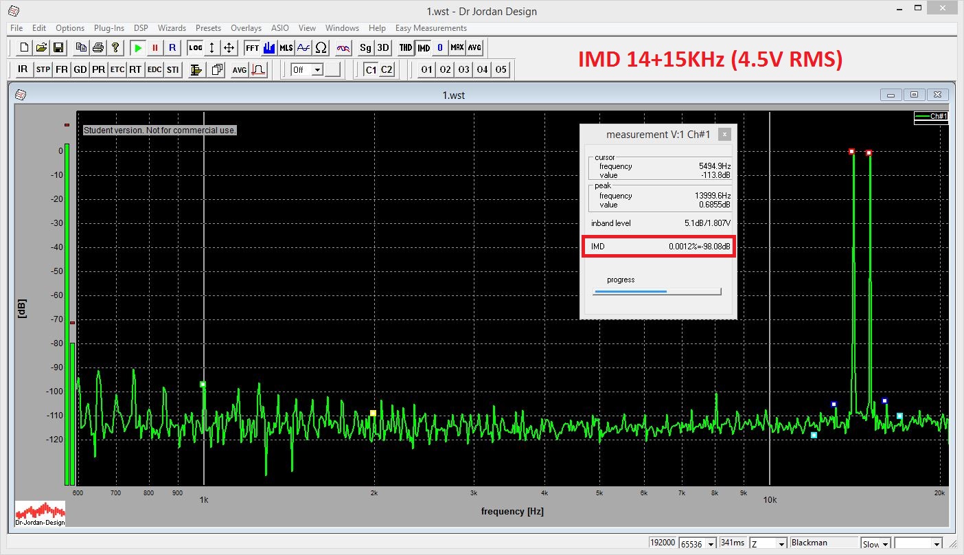

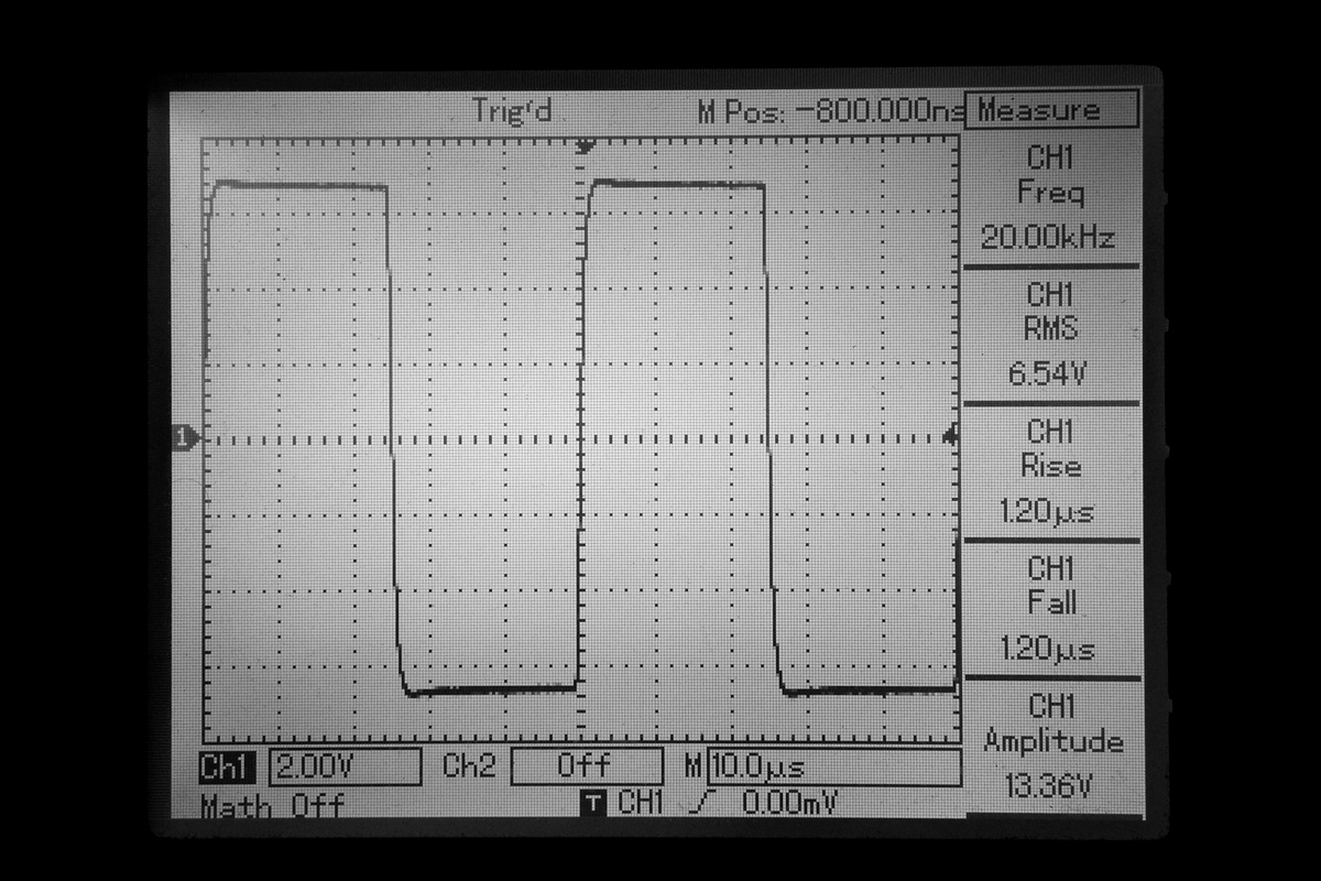

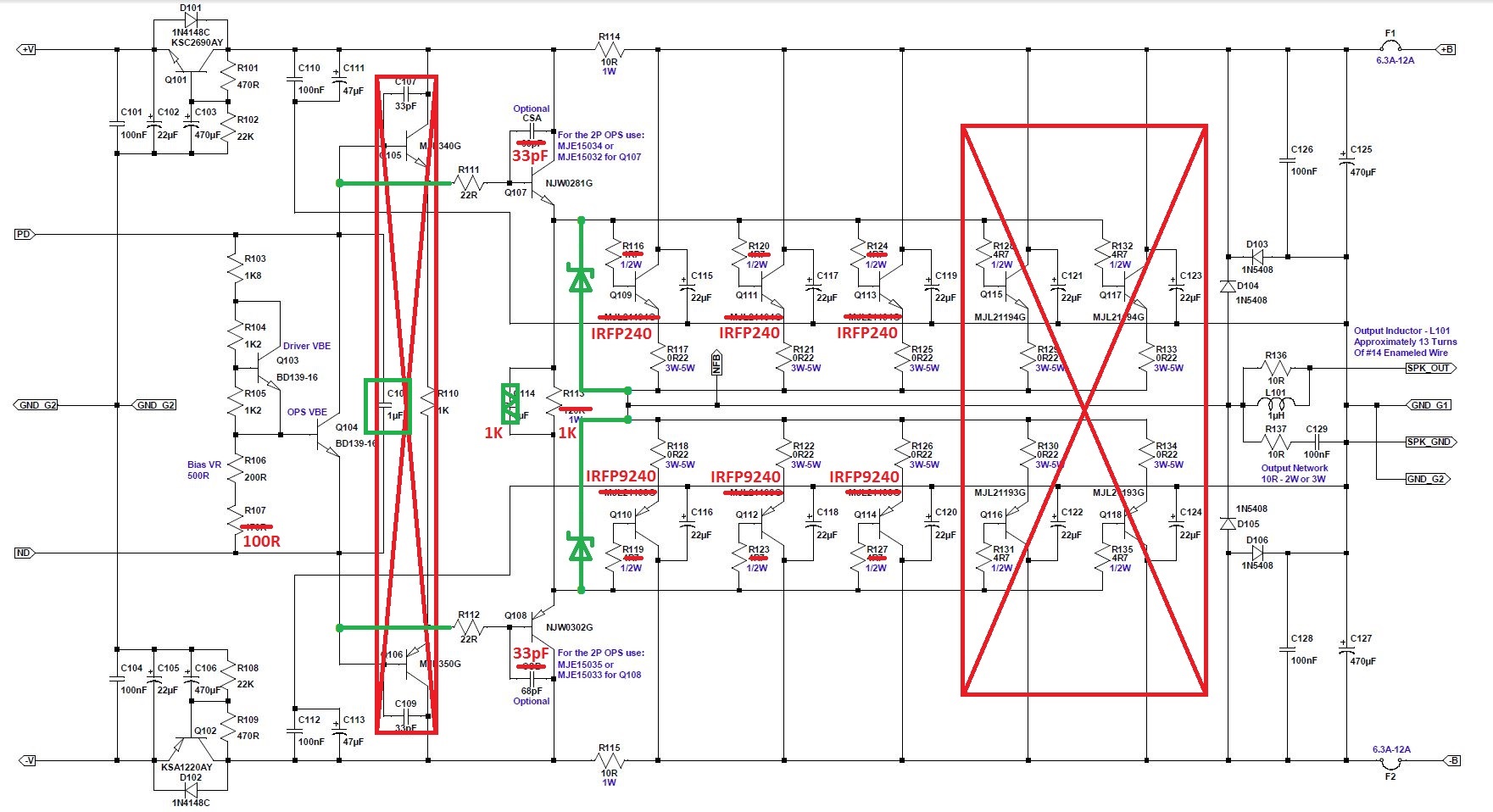

Final schematic as built (single EF - 2-nd option)
Here we go. That's the one I like the best.

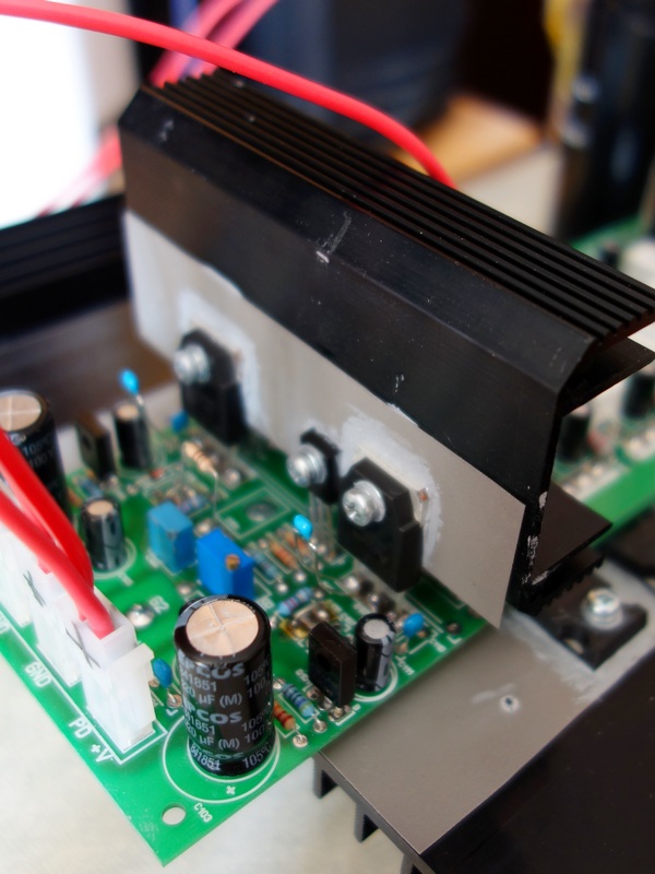

Single EF, but built on the "second" pair (NJW0281/0302), working at 15 mA, sitting on a local heatsink with Q103 driver Vbe transistor, as designed originally. C108 is still in place (it was just difficult to draw the red box without touching it). R113 is two 1K resistors in parallel (we need 500 ohm here). I have put CSA and CSB 33pF caps "just in case" - it actually runs fine without them, but I feel safer with them in place 🙂
I think, having these drivers, it will run with 5 output pairs smoothly - I just don't have enough space at my test heatsink for 2 extra pairs.
VAS (at the front-end) runs at 5.6 mA.
Key measurements are good enough, sound is excellent. Same strong clean bass, highest level of micro-details. I also attach the hybrid front-end schematic as used with this OPS now (measurements are done for this combination, though the front-end's contribution in overall distortion is negligible).
I'm not keen to try the FET drivers at this time - they will require higher VAS current, Vbe spreader redesign and will "eat" some output swing headroom. I'm rather happy with what I've got at the moment. Enjoying the listening and soldering the second channel 🙂
Let me know if you have questions 😉
Valery
P.S. Added a picture of what the front side of OPS looks like...
Hi Valery, please post a schematic diagram from your last configuration, like post#3712
Valery
