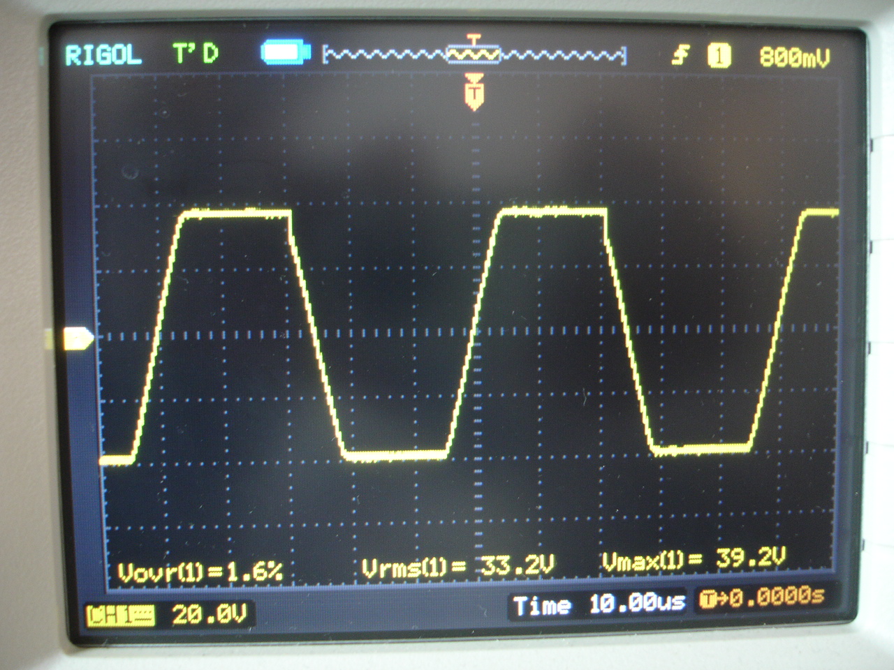

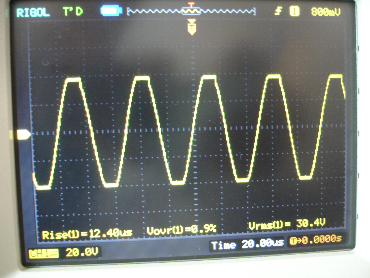

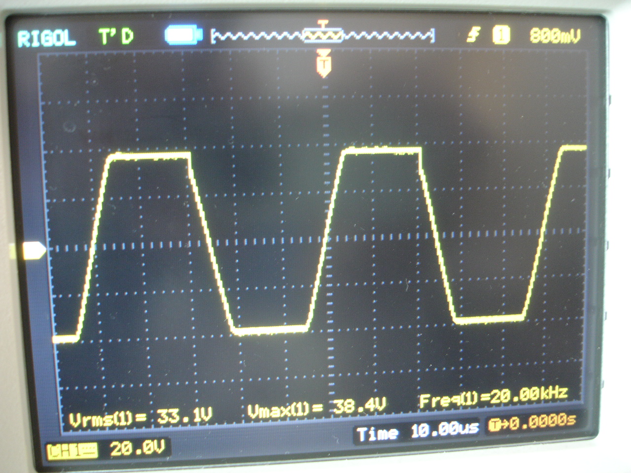

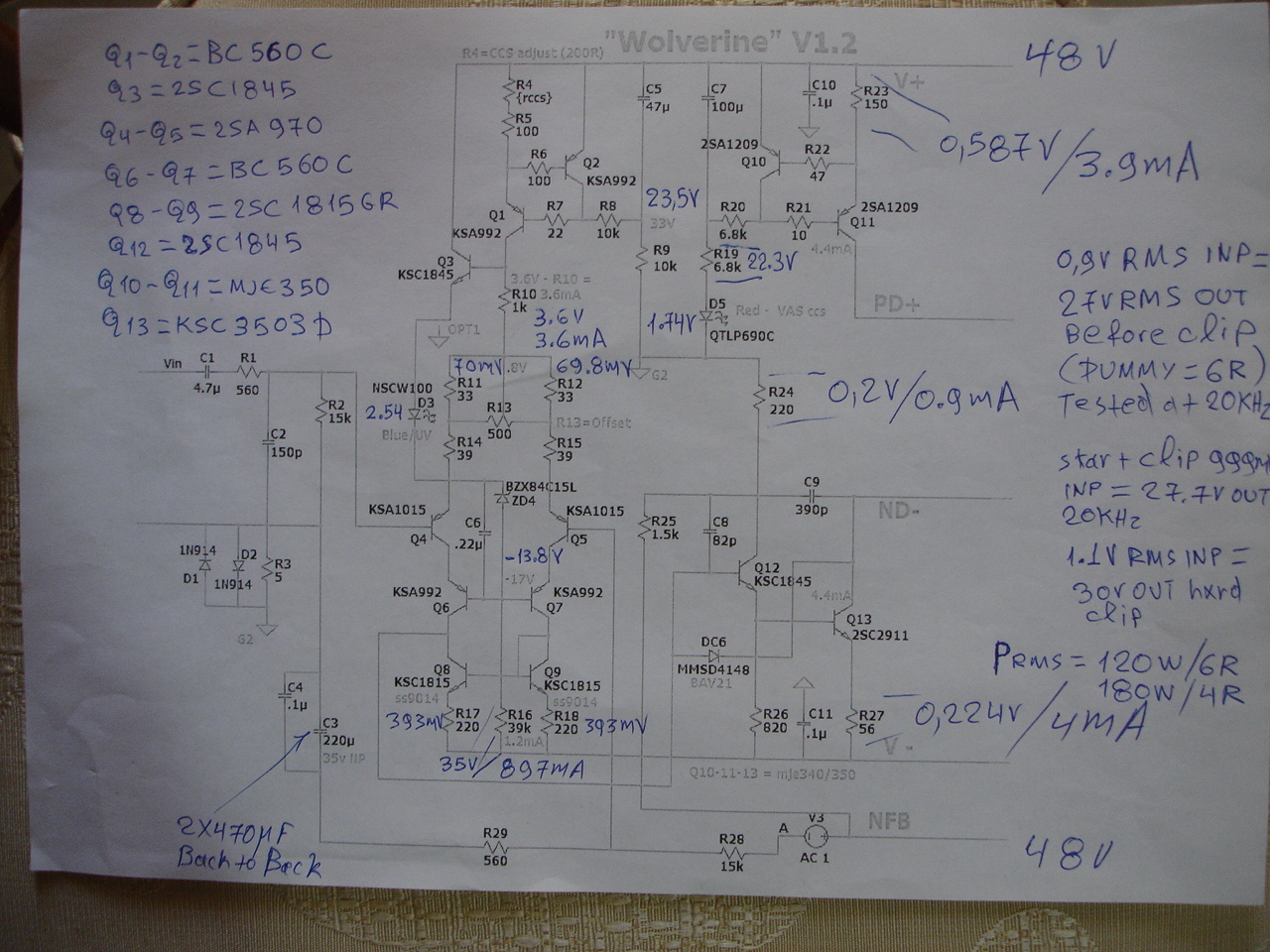

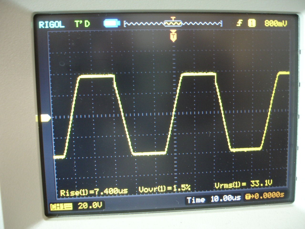

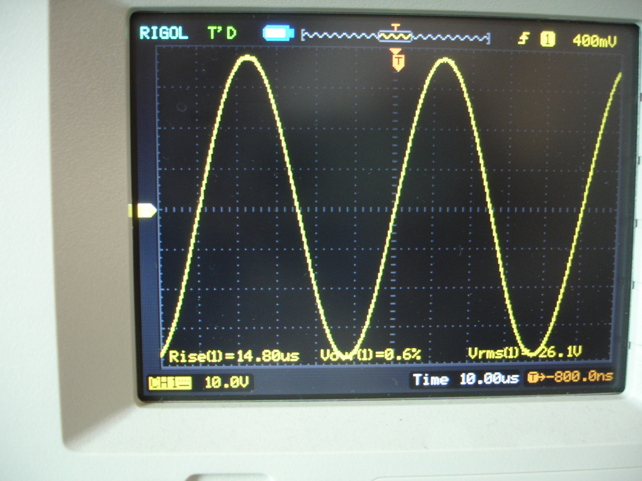

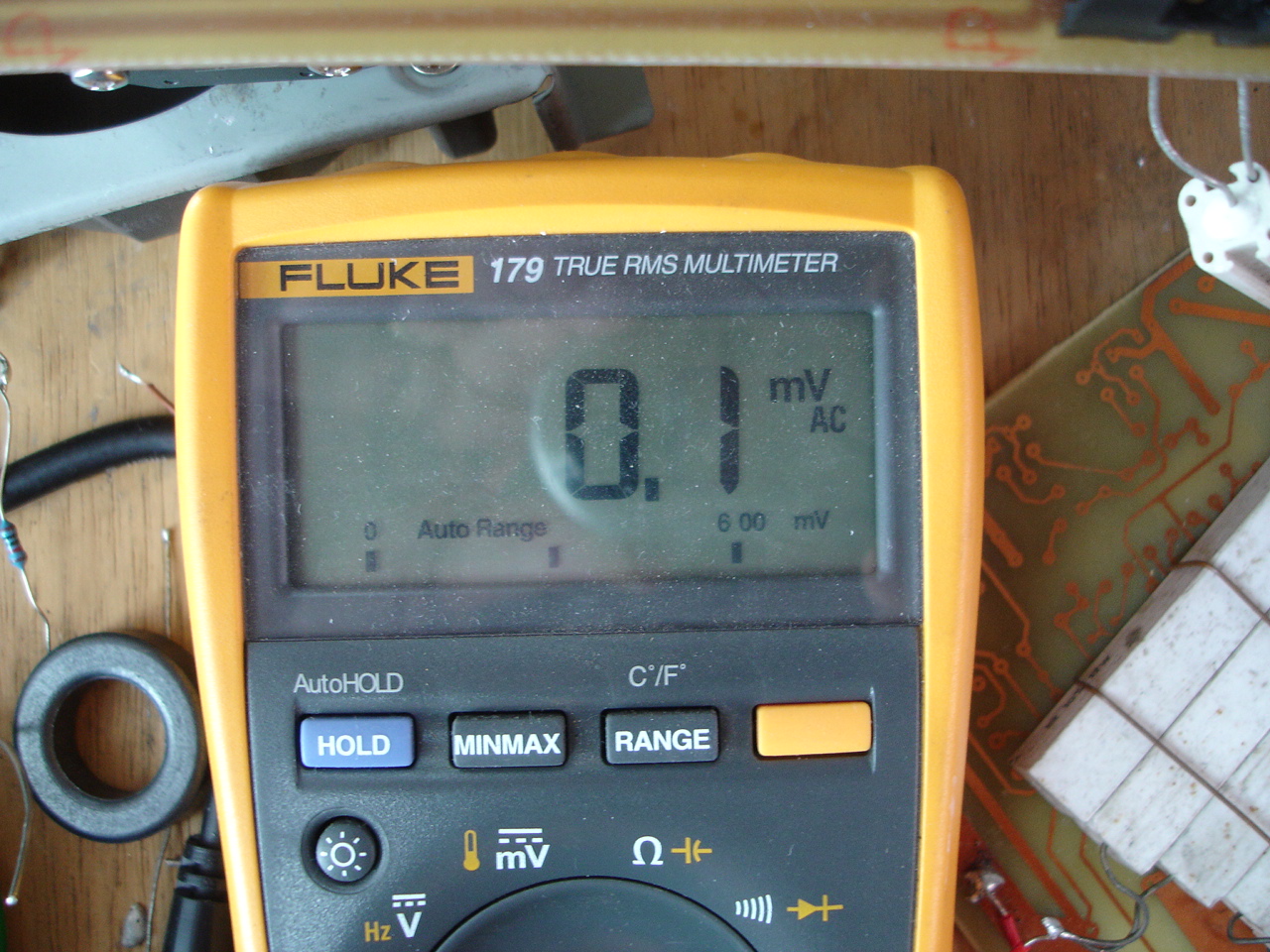

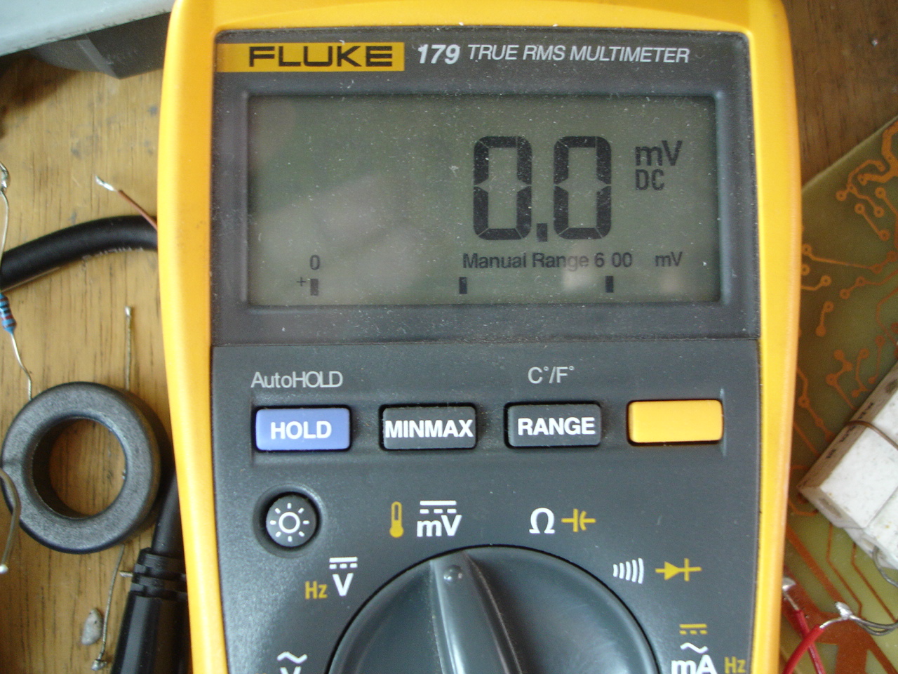

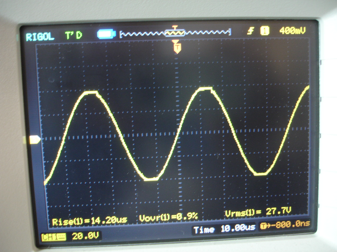

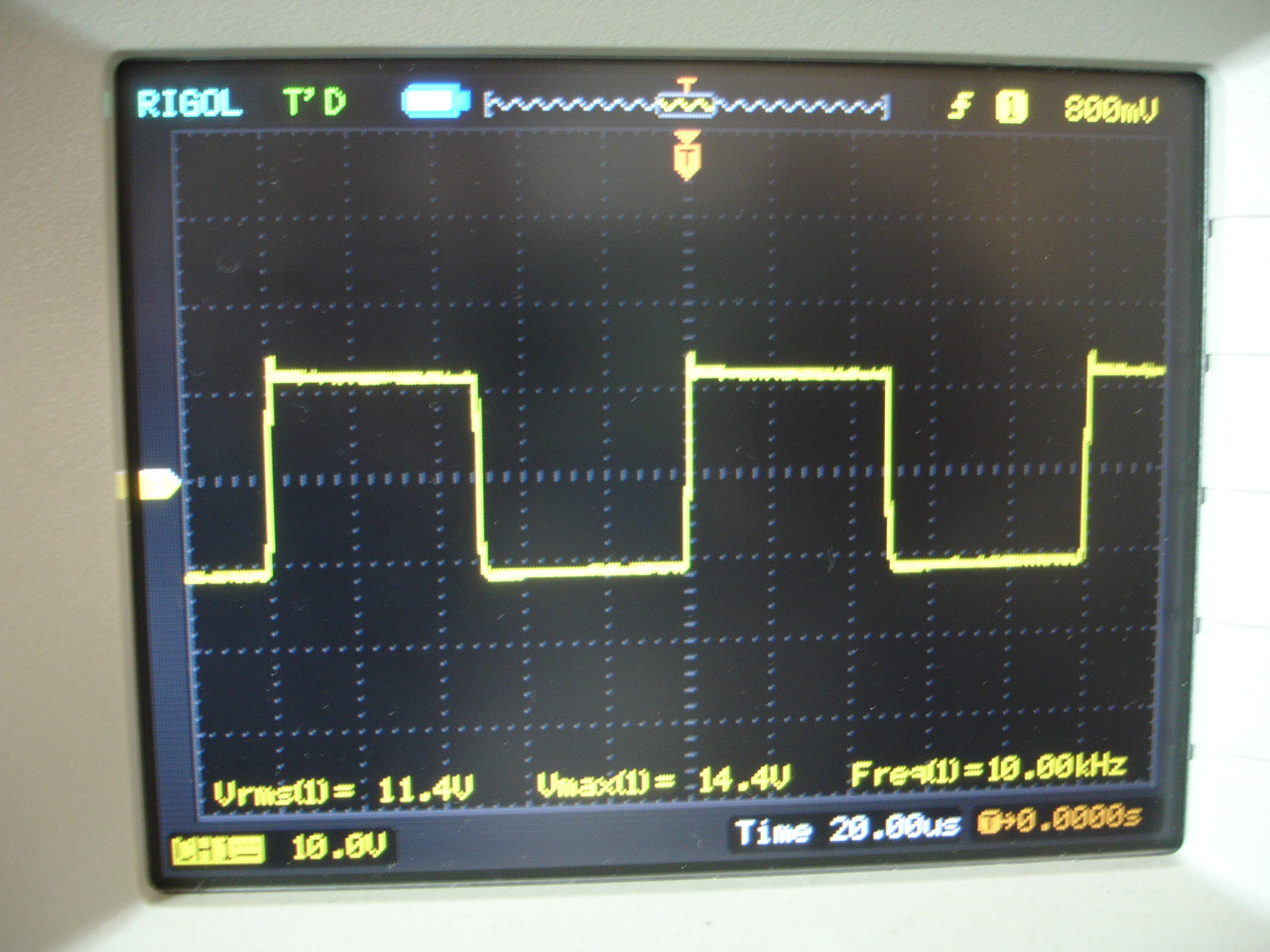

Some first measurments.Wolverine is something was absent from my collection.
Now it's here.!
Up to now i have test only bandwidth from this amplifier.
3.6Hz up to 411Khz (-3db) tested at 5vRMS OUT/6R dummy load.
Seems that is necessary to make some improvements.
Ι have built this INP using what i have on hand at this moment.
First picture ,A.C volt out(NO LOAD) when input is shorted.
Second picture.D.C offset.
All other pictures as explained on last picture.
Please comments ....
