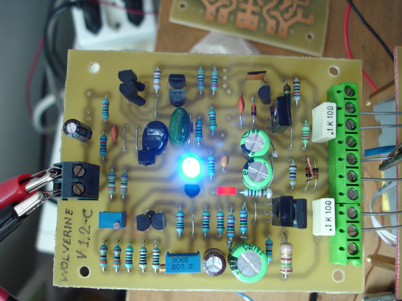

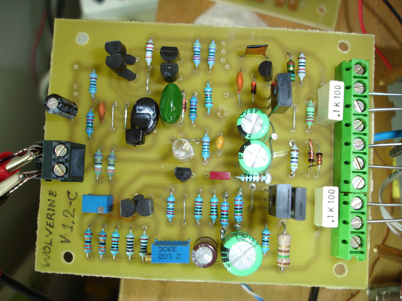

Wolverine 1.2-C
Wolverine is something was absent from my collection.
Now it's here.!
Up to now i have test only bandwidth from this amplifier.
3.6Hz up to 411Khz (-3db) tested at 5vRMS OUT/6R dummy load.
