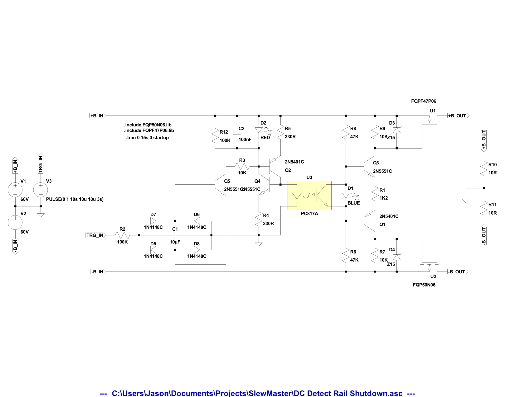

Trying to move forward... Ideas for PSU features
OS had previously mentioned wanting to incorporate rail shutdown facilities into a 'SlewMaster' PSU. This has been something of interest to me as well. Attached is a proposed DC detect / rail shutdown design.
Alternative ideas or constructive comments welcome. The parts used in simulation aren't necessarily what is being suggested, just the general concept.

Jason, looks good. I would also add a current overload shutdown feature, sensing the current either via the OPS emitter resistors or at the rails directly (will require a small value resistor in series though)...
Assuming rather high triggering current, may be implemented pretty easily with an opto-pair device as well.
What do you think?

I don't see the need for opto-coupler here, it could be done with small bjts as it use the same power supply.

I'm not sure about the over-current shutdown myself. Isn't that why we install fuses? I'd assume if a massive current were flowing there would also likely be a DC fault; unless, like you suggest, the limit is very high so if the amplifier were driving a near short circuit (and assuming the amplifier itself would survive such a load) it would become active.
That said, the amplifier might be the place to install a limiter as is usually suggested. With robust multiple pairs of outputs a single slope limiter can be set quite close to the SOA so as to not be active on any valid signal / load combination.
Now, other reasons to kill the rails might include HF detection so if a significant oscillation were to occur the amplifier is shut down or over-temperature detection... Thoughts?

The SlewMaster OPS has capacitance multipliers to feed the IPS. I'm not sure if feeding the power section via a CM is really needed. I wanted to ultimately select smaller devices and just use them as switches. A CM would require a device with a more capability in its linear (ohmic) region.

Any relatively low Rds ON device that is rated to withstand at least a full rail, ideally the sum of the rails and the required current. There aren't too many higher voltage devices, say 200V or greater, with 100mΩ or less Rds ON. The specific device itself isn't critical since we would be using it as a switch.
Short circuit protection is valuable, at some time you'll get someone that shorts together the speaker wires. Fuses are slow.
The latch can, and perhaps should, be run from a lower voltage rail. That way the optocoupler LED can be run harder without undue dissipation in the latch. I just showed it in its simplest form running off the positive main rail.
Why the objection to a simple optocoupler? We aren't talking the photovoltaic type, just the plain vanilla transistor output. They are cheap, readily available, and known to be quite reliable. It allows me to leave my current source to float (no, it doesn't have to) and still short out its bias source with a circuit referenced to ground.

Yes, fuses are slow. Of course the components that are usually used in a linear supply are capable of withstanding short term gross overload, and so a fuse will provide protection.
The need for rapid action relates to saving output devices from a dangerous loading. Do we need / want to detect that at the PSU? To really protect the OPS we need more information about what it is subject to than just 'current X has been exceeded, shut it down'. A proper SOA limiter seems the better choice for adverse loading of the output to me.
I think power supply with shutdown triggered by SOA protection, DC offset protection, temperature protection, etc can be made optional. If someone want it, he can add the components. We must define the interface of this OPS to the power supply.
