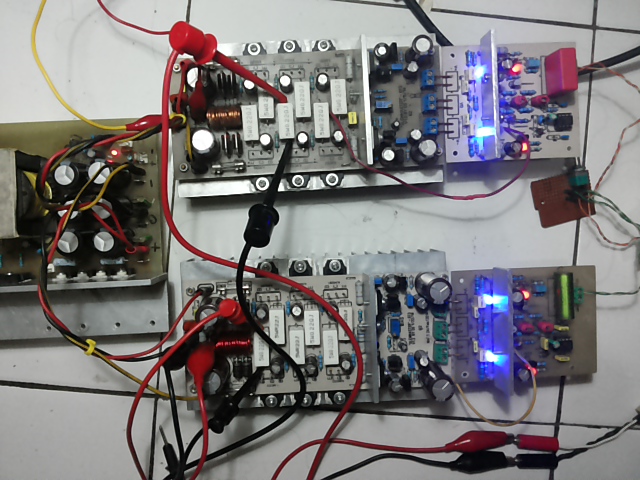

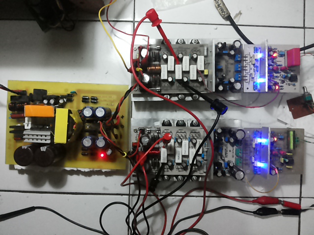

Very nice boulding !My stereo build of Slewmaster
Thanks uncle Os.. it'st rock 🙂
Regard Alcroner

My CFA-XH + Slewmaster OPS is nearly complete with pictures to come.
Would be intersting to develop an output board based on Bob Cordell's error correcting design. An EF3 with latfet outputs.
I need to get my second PSU completed so I can do a solid all Slewmaster A/B comp setup. I have 4, 5 pair OPS mounted on two huge heatsinks and two identical 55-0-55vac transformers. I only have one filter bank for it. Now that I have a break from building IPS boards I should concentrate on getting another filter bank built. Then my dual test setup can be completed. Hopefully just in time for OS's return. He claims he has a bunch of new IPS designs.

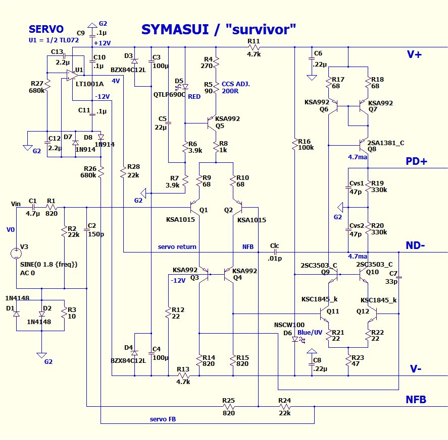

Got a Symasui board stuffed today for QC check. Looks good so far, just need to get an appropriate op-amp for the servo tomorrow.

My boards should arrive today. I have a question about the 2.2u caps C1 and C13. Can those be electro and if so, which way should the polarity face?
Thanks, Terry
Hi Terry
Potential across those caps can have either polarity, so nonpolarity caps only should be used here. The same with C12.

Sorry, I meant C12 and C13. Thanks for the answer. I will wait for the film caps.
It is not simpler (better) to ommit whole servo circuit and instead this put simple capacity (electrolytics, AC voltage across cap few mV, no distortion) about 220uF in series with R25? You get 100% DC NFB, and output ofset will be in mV region (caused only by h21 unbalace Q1,Q2,), no servo needed. Now is here DC bias resistor unbalance R25//R24 vs R2, and resulting input ofset voltage is amplified by amp gain, than corrected by servo..A bit strange and complicated.
Hi Terry use 2x1uf film for eatch position.Hi Jason,

You can use 1uf and then you must change R26,27=1MThat'll work. Thanks
