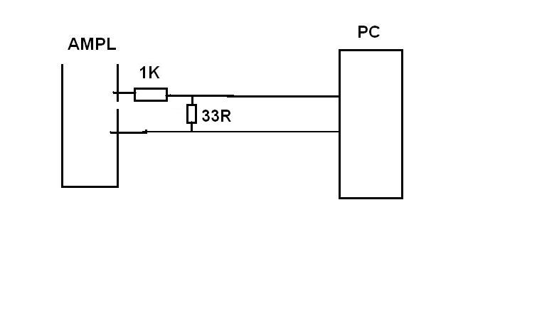

The sound card has an input impedance of 10k, so I'm using that as part of the attenuator. All I've done is put enough series resistance on the output of the amplifier to protect the sound card/reduce the signal level appropriately.
Worst thing you can do for distortion measurement.. Any input (soundcard, amplifier..) should be driven from lowest possible impedance, because any amp (discrete, operational amplifier..) have voltage dependent input capacity (nonlinear), and driving impedance in both inputs (inverting, noniverting) of such amp should be the same, if possible (or keep it as low as you can). If you use high impedance source (series resistor for driving input of soudcard), it will create frequency dependent and nonlinear divider with this nonlinear input impedance , what means.. increasing distortion with frequency. Try to search something about "common mode distortion" . And high impedance is more prone to be affected by disturbing signals, as mains hum and so (increased distortion at low frequencies? ),and noise is also higher.
Use for measurement low impedance divider (it is no problem for power amp to drive 1k load ), something like 1K/2W+33R, or even lower. Sound card input will "see" this 33R as source impedance. And I suppose, you will get exact copy of soundcard loopback.
Interesting BV I will see if that makes a difference. Needless to say the results however do seem to be dominated by the amplifier as can be seen in the comparisons I've made all when done at the same signal levels. If the resistor divider was dominating something surely the results wouldn't change. Either way the proof is in the pudding and I'll give it a go and see what happens.

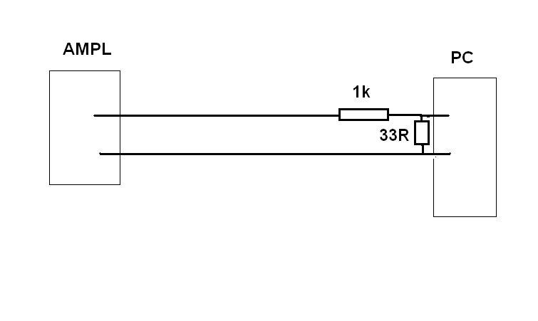

what is the recommended setup?
1 OR 2?

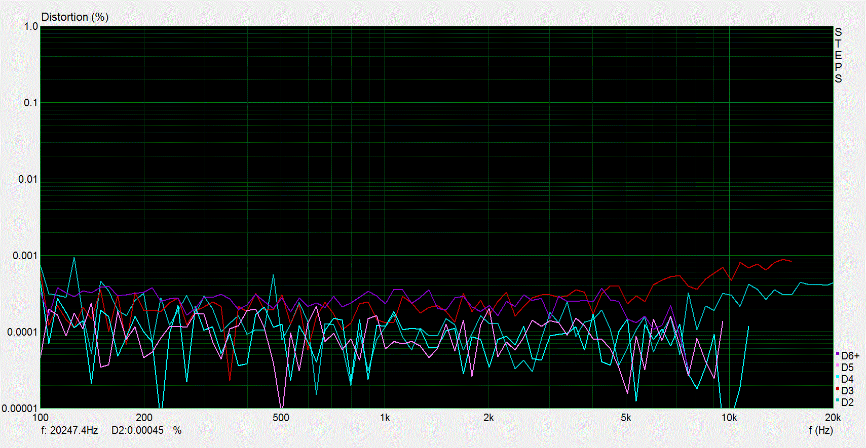

I do apologise for the images. If you attach a large-ish image file (useful if you want to see things in detail) DIYaudio will rescale them to fit on the page, but it appears that you do have to refresh the page for it to do so. I do not know why, it would be nice if they could fix that in the code, so that it does it right away.
I should mention that I've tried BVs lower impedance resistor divider and it didn't really do much at all. Things seem a little bit more consistent, but it's by no means a night and day difference and the previous set up was perfectly acceptable for troubleshooting problems.
One thing I will say though is that this is probably dependent on the hardware you are using. I've read a little about common mode stuff before and it never sticks, I guess I need to read more 😀 But I would assume that the degree to which the different impedances affect the hardware will depend heavily on what the hardware actually is.

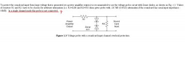

can anybody answer this?
thimios, you must always protect sound card input from excessive voltge, if here is any chance for this.
