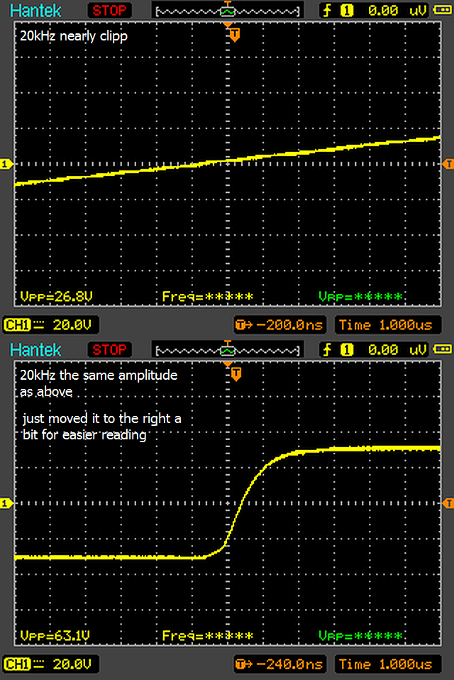

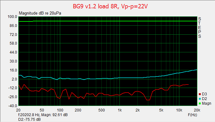

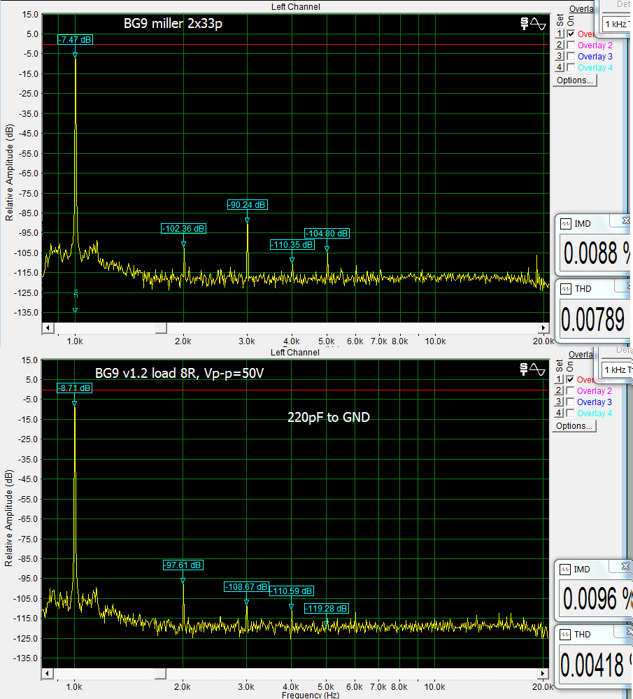

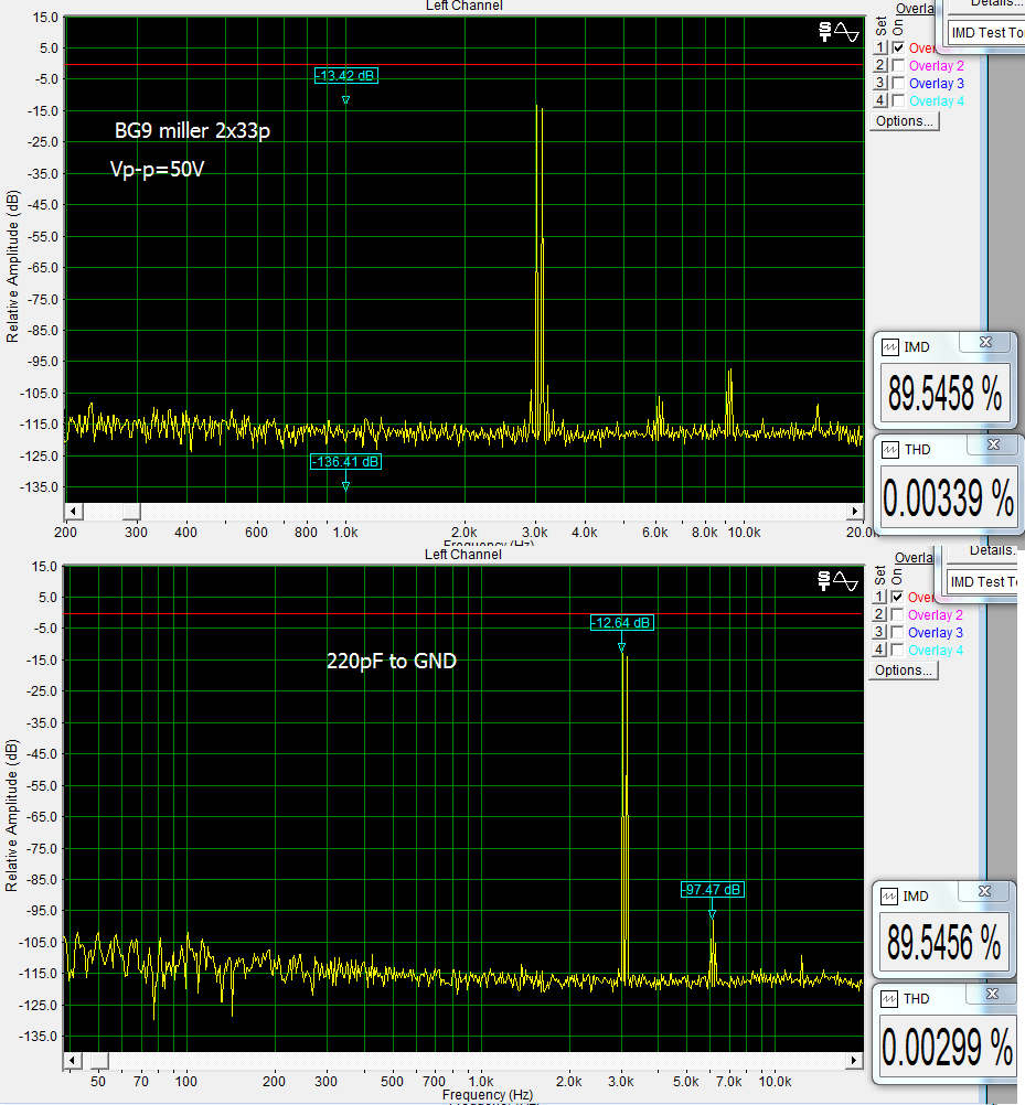

My experience with measurement vs listening is giving me some of the goal for an good sounding amp. Bellow example - very similar to CFA-X but with diamond input.
The thd numbers are not so very important bellow some level. I think the ratio between all the harmonicss and the imd products are important (maybe I am wrong ?).
Look at the few pics bellow and forgot a moment about the numbers, the harmonics spectrum is very similar to the other distortion producs so it must in some % describe the sound character of the amp. The is not playing sine waves but bit complex voltage curves.
Found also that good sounding amp should have the same THD character threw all audio band (without spikes and rising/lowering slopes, just smooth curves) and this is giving me the most of the problems, mostly at higher power levels.
The speed - is it a critical parameter ?? hmm........

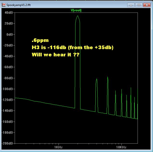

harmonic spectrum ??
I like that BG9 H2/3 balance !
I can't seem to get that with either CFA/VFA symmetrical's. So ...
try to eliminate both (below .6ppm/ 240v p-p). If you can get the H3 near -120db
does the ratio even matter anymore ?
The asymmetrical's (symasui/wolverine) already have the right ratio.
- they cancel odd harmonics.
Also , if this IS a factor (SQ wise) , going for single digit (or sub) PPM
might be a good idea for all these IPS's.
