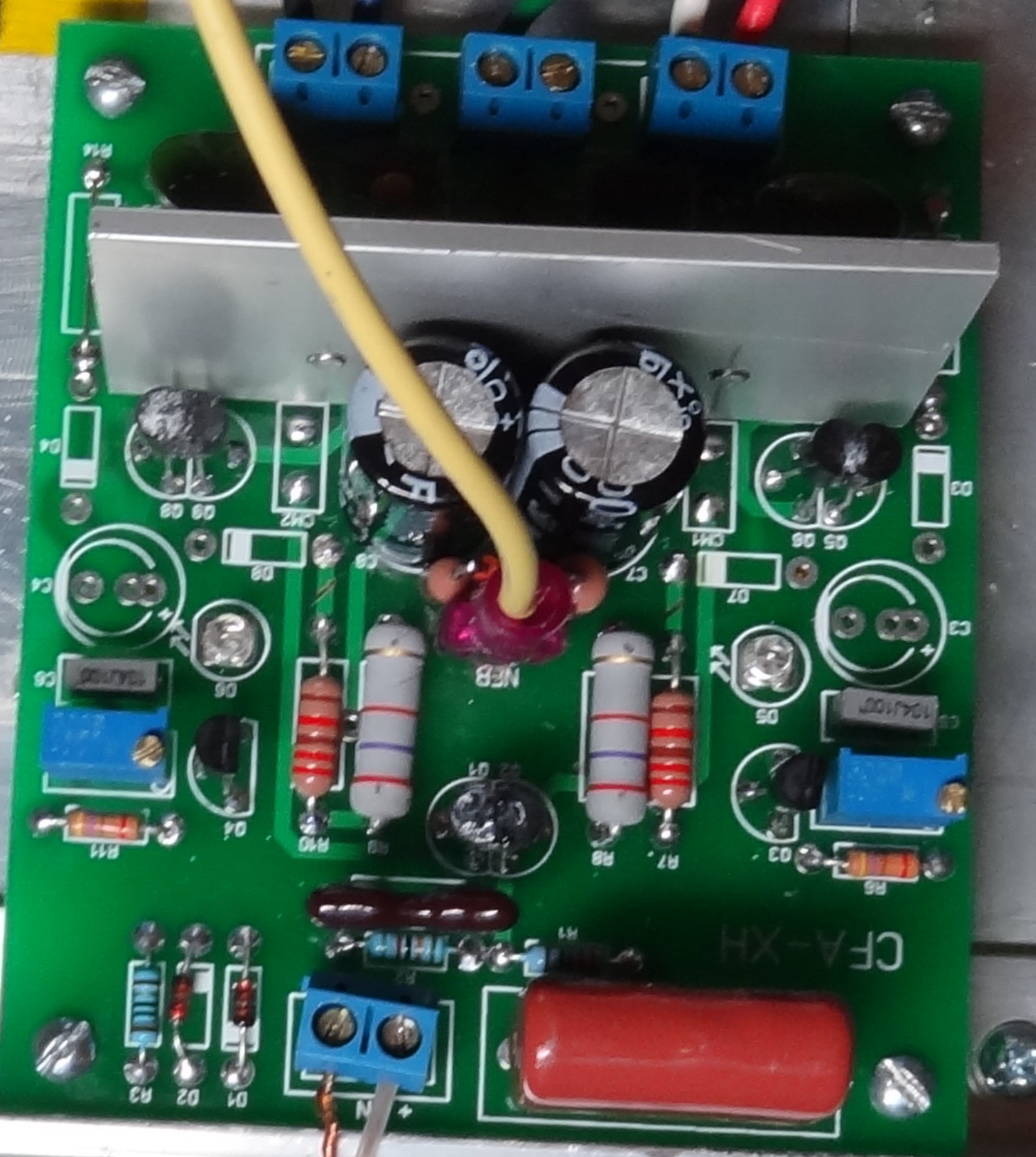

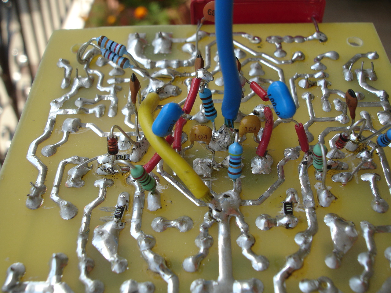

Terry,After last modification, my board looks like bombarded but is absolutely functionable.
I can post some photos tomorrow.

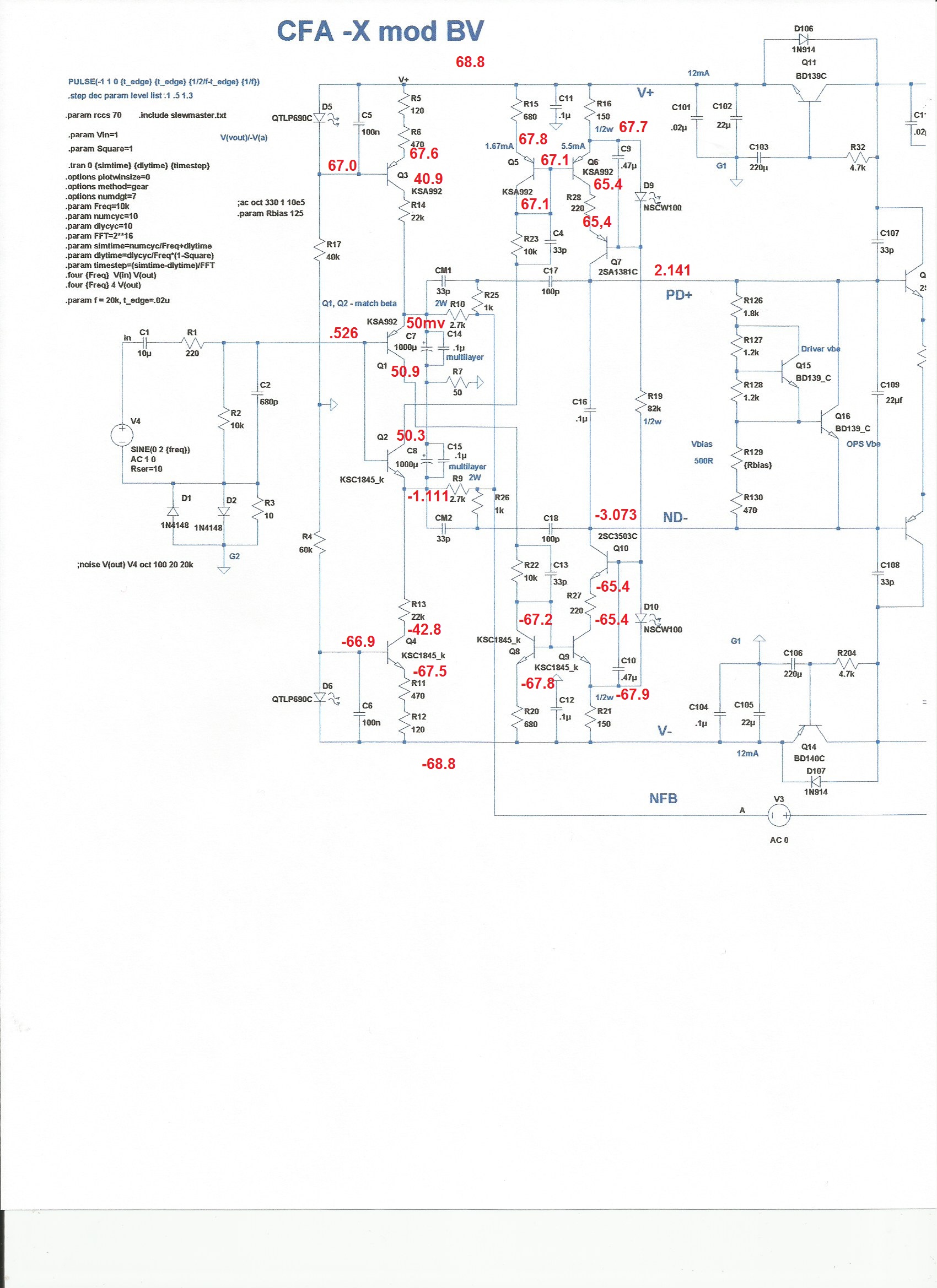

I have been chasing my tail all day with this new modded CFA. Checked everything I can think of. I had matched hFe on all transistors except for Q3/4 and Q7/10. I have about a .5V offset. I was able to dial it out with the pots but it took a lot of adjustment after which the bias on the VAS seems quite high. Square waves look good and it plays music but there is something still not right. I'm posting a schematic with voltages in hopes that another set of eyes might help find the issue. Your success have given me hope so I have not given up.q I did change out Q3/4 with hfe matched devices with no change.
Blessings, Terry
Something wrong just at input. Voltage at Q1,Q23 base +0,526, voltage at Q2 emitor -1,111, so Ube Q2 is 1,63V- faulty Q2
R14 current shold be about 1,8mA (40V/22k), but voltage at emitor Q1 is 50mV , so Q1 must by closed-shorted C7, C14?? And voltage difference across R28, R27 is 0V, so no VAS current?

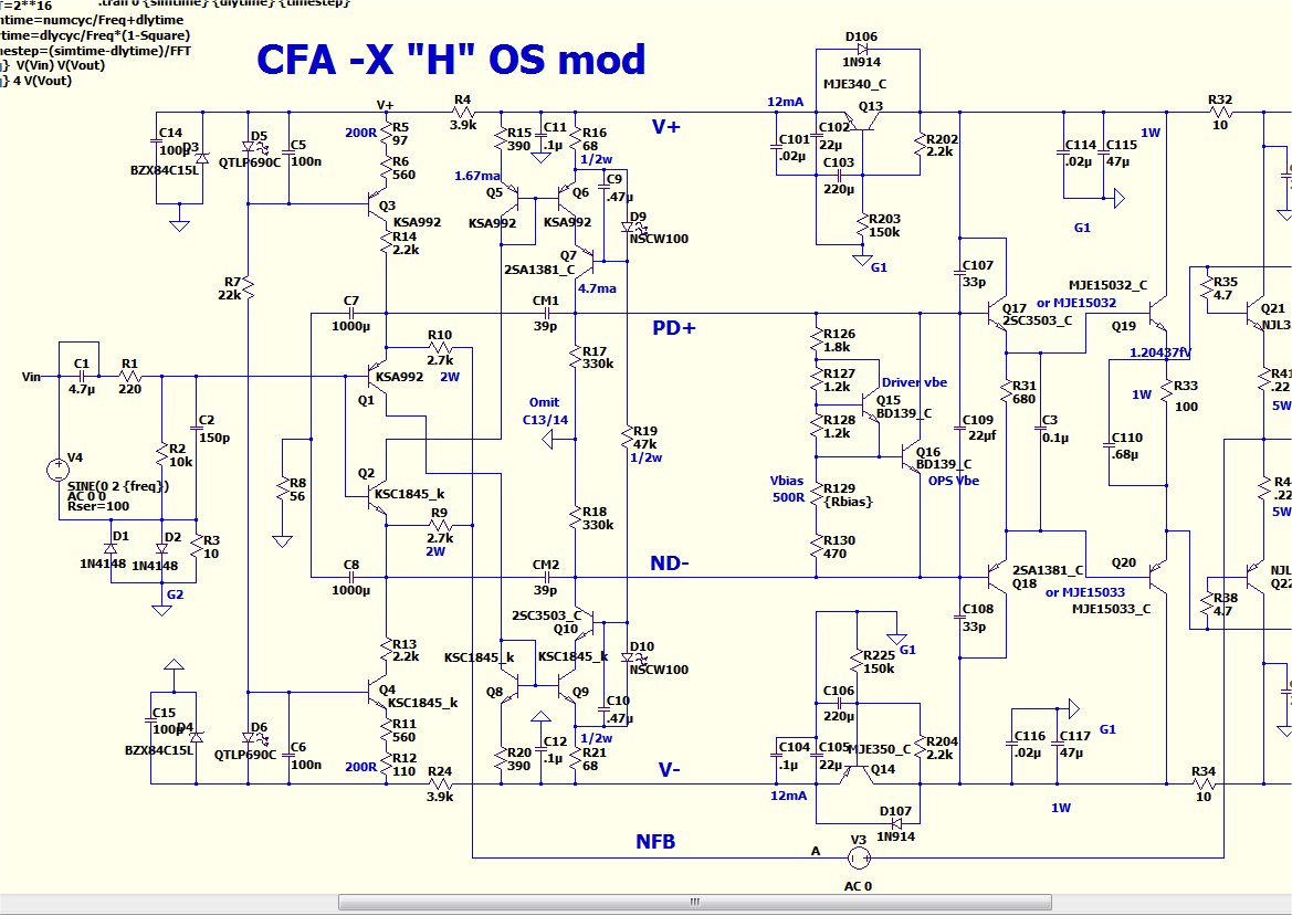

OK , some mods "bring something to the table" (some do not).
(in reference to BELOW)
C7/C8 +R8 = the major part of the PSRR gain. (OPS R114/115 @ 10R adds 3db)
CM1/2 fed back to Q1/2 emitters = 1/4 thd , THD stays <10ppm right
up to clipping - Dual MIC is gut 🙂 .
Extra resistors (R13/14) , if too high ... reduce the CCS's ability to trim
the offset - 2.2k seems to work well (no THD rise).
Original 12-15V zener low voltage CCS's add a whole 6db PSRR (I added them
again) ... also no THD rise. Edit- red led Vf stays much more constant w/ a regulated supply.
I raised the gain of the hawksford/CM to push me into single digit PPM (R15/16- 20/21) ... CLG rise.
Could see no benefit to resistors between input pair and Hawksford/CM (10K's) ????
So , I now have 8-10ppm at high levels , clips good , awesome pssr ...
and it is only 2 cut traces from the original. It also offsets like the original ,
CCS trimmers are very responsive (10-20R = many 10's of mv offset).
Slew is master (...ful - 220V/us+) 😎
Had a lot of trouble even getting the full modded sim to mv level.
Feel free to mod either way - this would be my way. 🙄

Hi BV,Something wrong just at input. Voltage at Q1,Q23 base +0,526, voltage at Q2 emitor -1,111, so Ube Q2 is 1,63V- faulty Q2
You made me curious about Q1 & Q2 so I just went out and measured them Both have .578 vbe so I think they are ok. It is 11:20PM here so I am done for the day. I will take new measurements in the morning. When I took those measurement above the IPS was not attached to the OPS. It is now and I just checked a few things and noticed that the - rail is pulled down to something like -64V while the + rail is at +70V. Pot R5 has been adjusted to make the output 0 and I believe that is what is pulling the -rail low. Should I take measurements with the output at nil or should I take them with the pots equalized? I will also measure the vbe of each transistor and get the ma of each resistor.

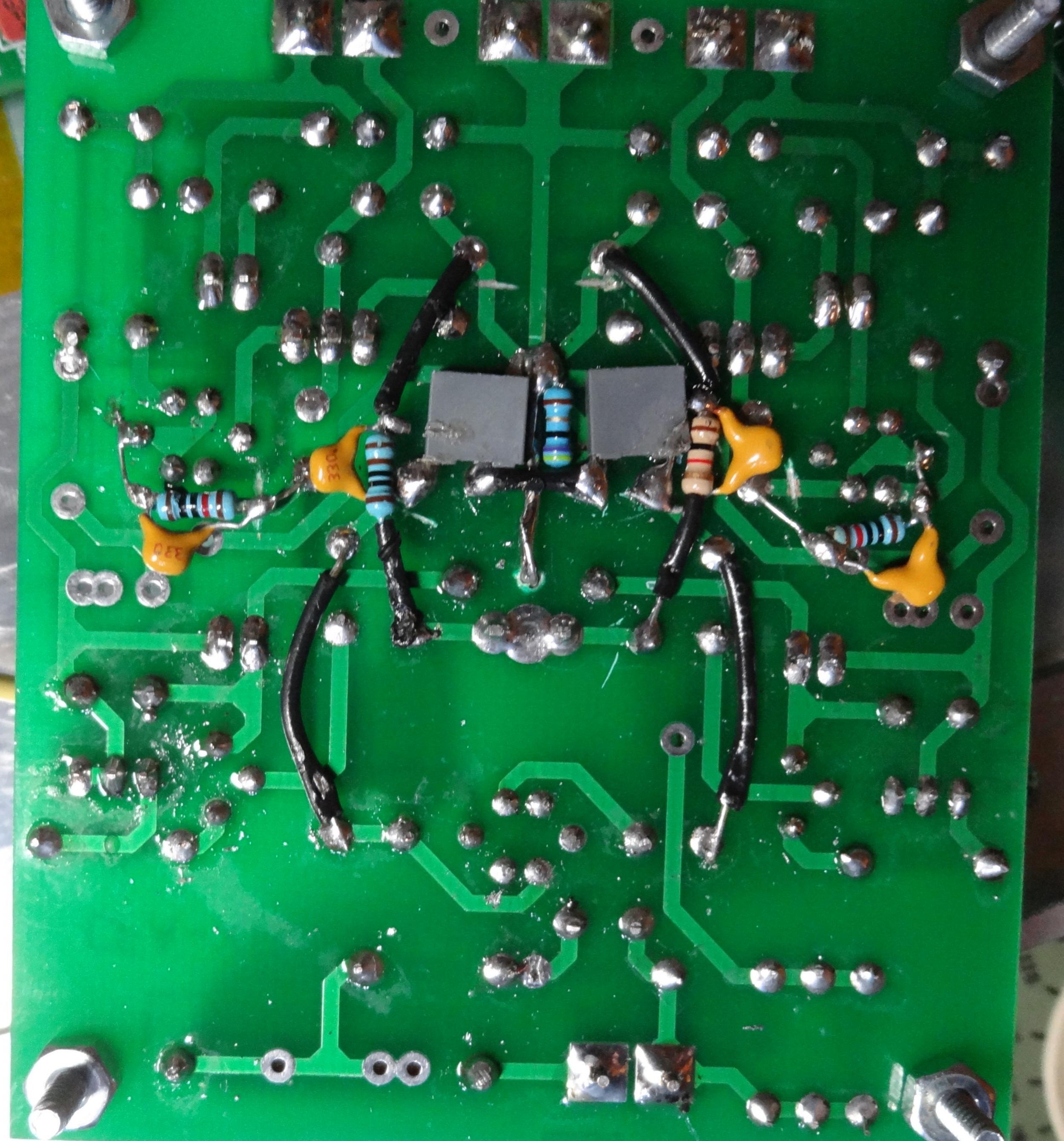

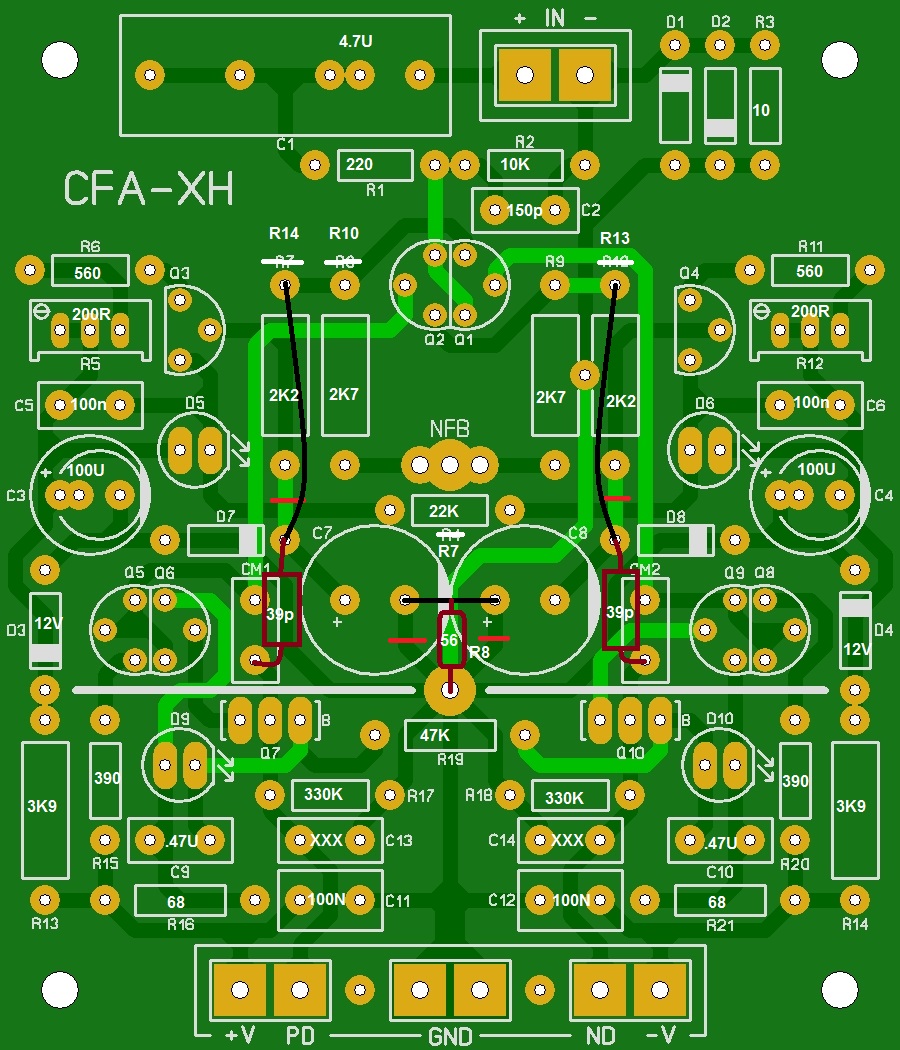

OS, I see minimum of 4 trace cuts. See attached.

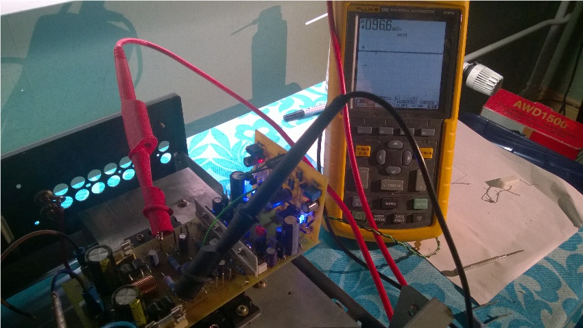

Bias current adjustment in progress..

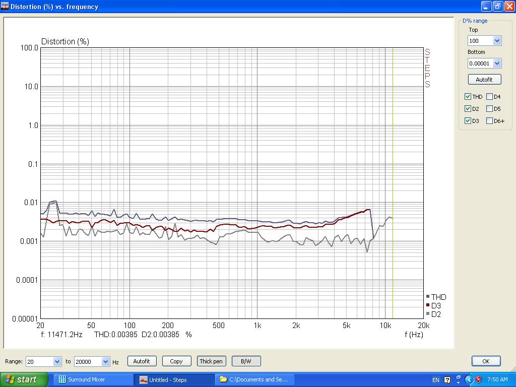

How looks card loopback? It seems as card limit..
