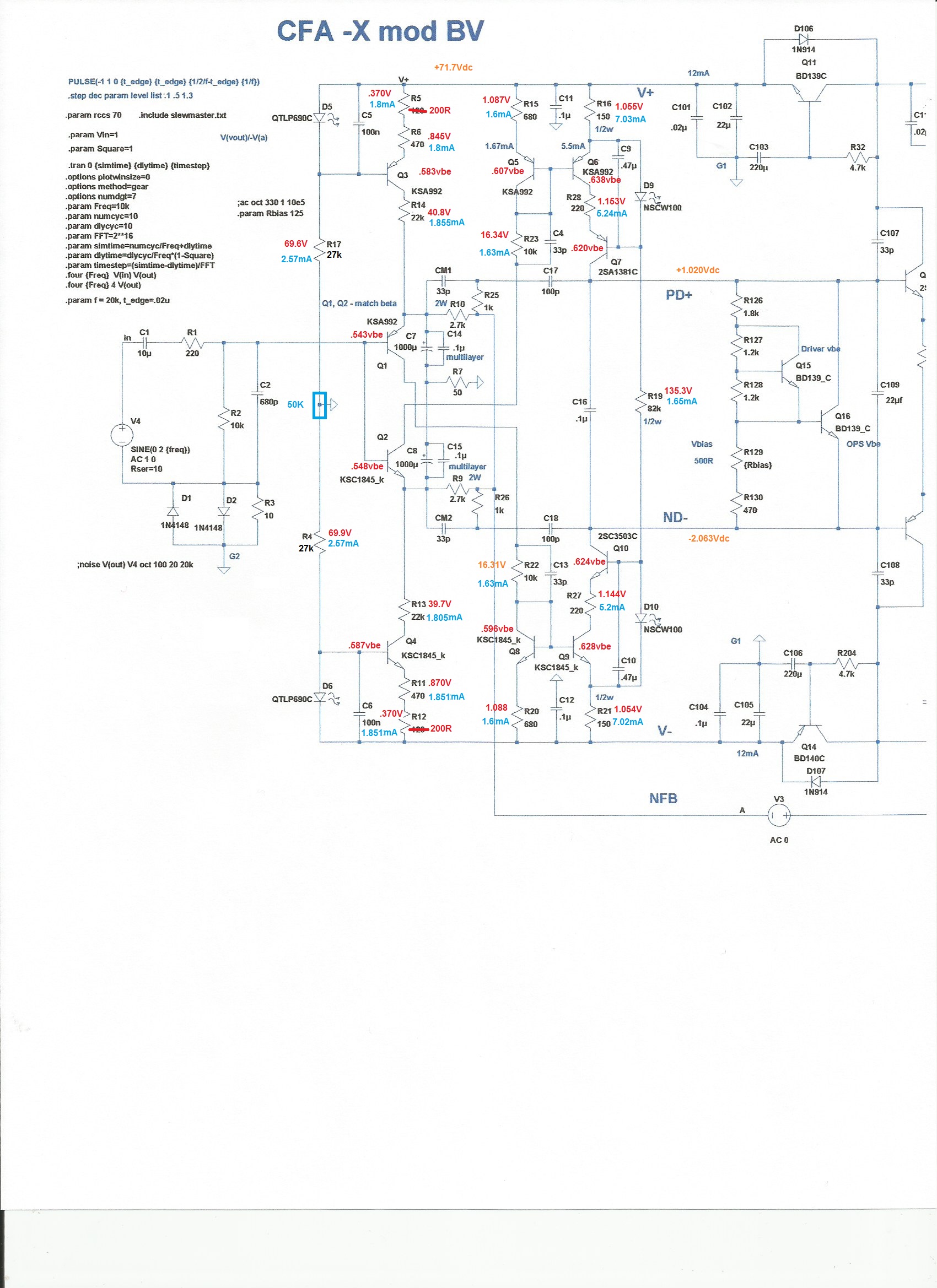

OK I was just taking some more measurements and I noticed that there are two 220R resistors added between Q6-Q7 and Q9-Q10. That may explain why the VAS seems to be running so hot and the output is so high. I guess no one is looking over the board pics I have been posting. I will try to add those and see how things look.
+PD=1,02V, -PD=-2,06 and output (NFB) =? What voltage is at bases Q1,Q2 referenced to G2? Is R3 really 10R? Voltage acros R3?
Correct on PD and ND output voltages. NFB to ground is -.450V, Bases of Q1,Q2, both .5V base to ground. R3 is 10R and has only a couple mV across it.
.489V across R8 and R9. Via is good beneath R10. Solid ground from star to R3. D1, D2.
If I adjust the pot to get 0 offset the NFB changes to 30mv and 1.02V on the NFB resistors.
Maybe I need to try and match the VAS transistors.
+0.5V to ground? Check 10k resistor (bases Q1, Q2 to analog GND). Try to measure beta for Q1,Q2. Here is problem.Q1,Q2, both .5V base to ground
OK I made the cuts and installed the 220R resistors. Still have a large offset. I am attaching a schematic with resistor drop voltages and vbe of each transistors. Please take a look.
Thanks, Terry
Terry, please check Q3 too, looks like collector current is higher than emitter current.
Hi BV,,
I checked R2, it is 10k. I did notice that during start up it goes from zero drop and gradually ramps up to about .489mv after about ten seconds. I don't know how to measure for beta. I did match hFE on Q1/Q2.
Yeah, I just replaced Q3 and Q4 with matched units thinking it might help. No change. I think the small variances in amps is due to resistor tolerances. I didn't measure the current. I measured voltage and then used ohms law based on the resistor value. It was meant more to be a visual aid.
