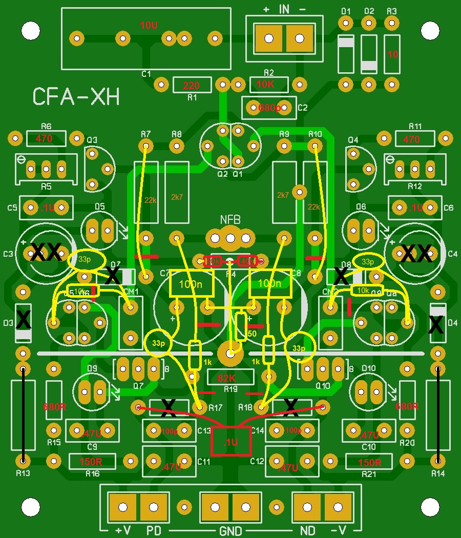

I have tried the first modification,post #2922 .BV had two different approaches to the modifications if I understood correctly. So far Terry has mastered the first modification, has anyone really looked at the second method and would there be again a better implementation using the second modification?
I'm absolutely sure that is a big difference from unmodified ver.
I'm not sure that i like the second mod.with more flying parts.
The second modification looks like the more interesting of the two and is the one I'm currently interested in trying. What's slowing me down is the prospect of it changing again
So I figured I'd wait a little just to see if any refinements are made. Also, as people currently have IPS boards they can chop up and modify, it would be nice to see something in action before I go ahead and etc/make a board.
Having seen Terry get the first mod working properly without too much difficulty, it would seem that the second mod should also work fairly well.

I have the last BV mod built and am trouble shooting it right now. Should have it working by tonight. I have to go and deliver a wedding cake so it will be couple of hours before I can get back to it. It is working but I have a .5V offset. Hunting down the problem. I do have a question for BV.
Why are R4 and R17 different? It causes the - rail to run higher. Not questioning your design, just trying to learn.
I am attaching the mods I did to the stock board. I'll let you know if anything has to be changed.

Having just altered my preliminary CFA-XH design into the CFA-XHmod2 from BV, I can say that it does change a reasonable amount. Not so much as to be impossible to mod, but you are going to end up with a fair few cut traces and the like.
Jason it sound like Terry will have something preliminary by tonight. It does look like with all the cutting and jumpers and deletion of parts that a new layout would be in-order if it is a significant improvement. I think the final arbitrator will be a listening comparison with an earlier unmodified board with a good set of speakers. If we can't here a difference then things just become an academic exercise and then why keep chasing our tails?
