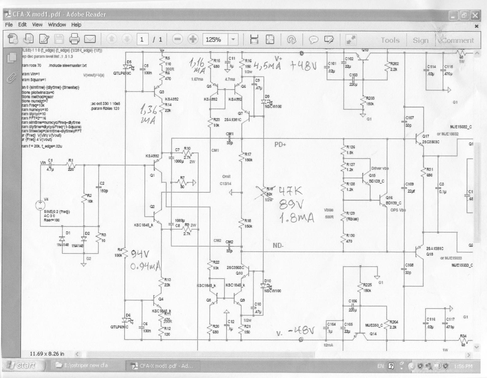

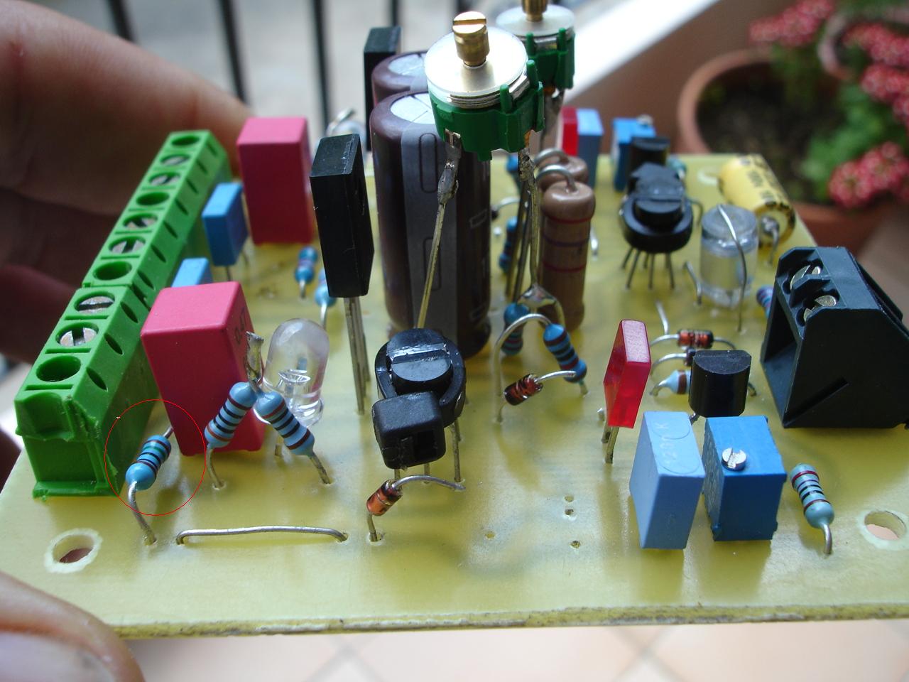

Tried to fire up the CFA-x"h" that OS released long time ago.
OPS is the baby.
However when I connected the combo to my PS both 150r resistors on the ips cascode smoked.
I do not have a proper bench supply to slowly rise the operating voltage so I am not properly able to measure the voltages over these resistors.
Could someone give me a hint where to start the troubleshooting?

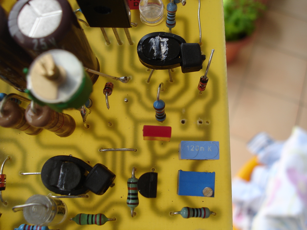

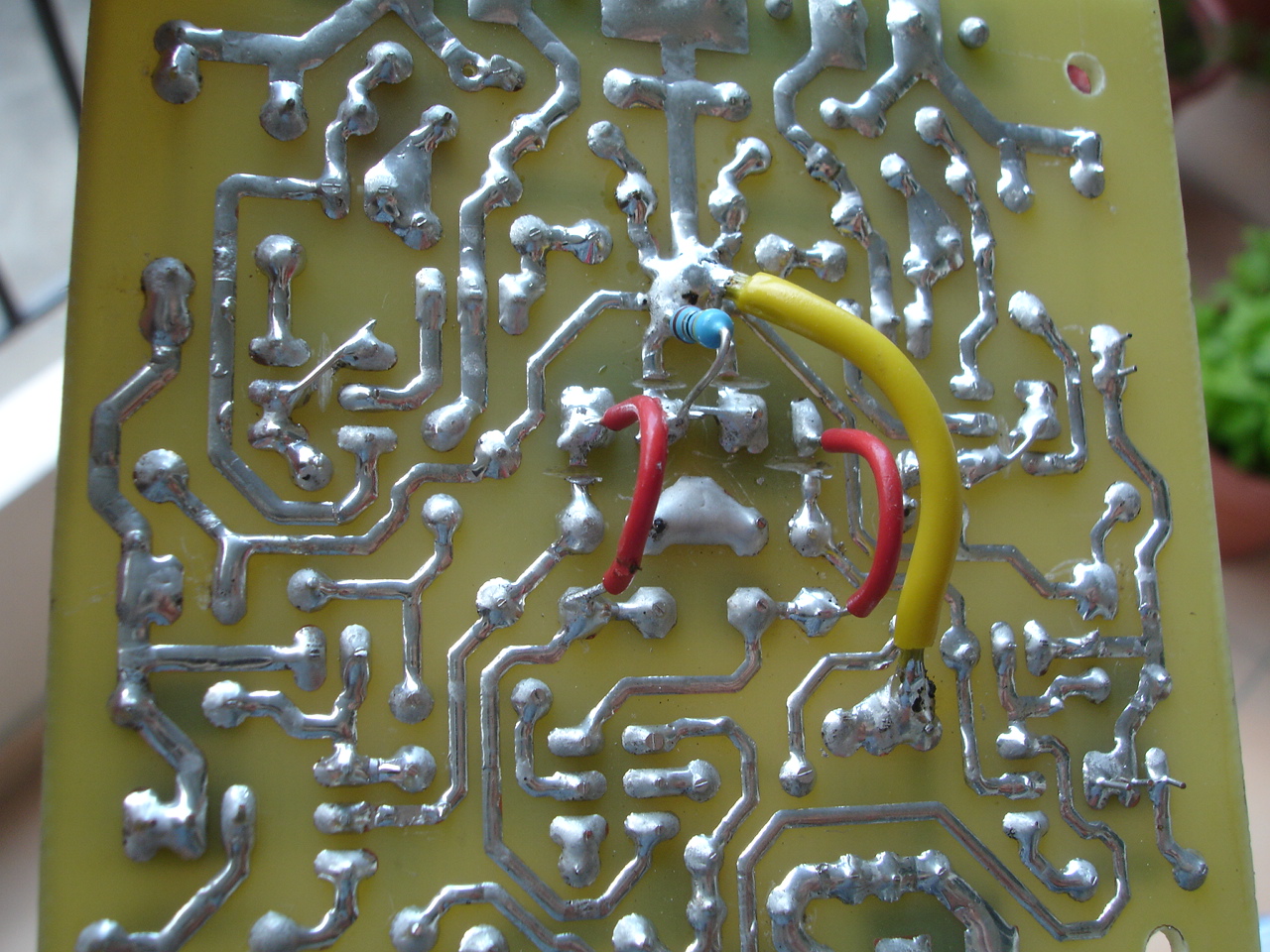

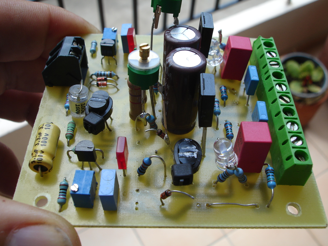

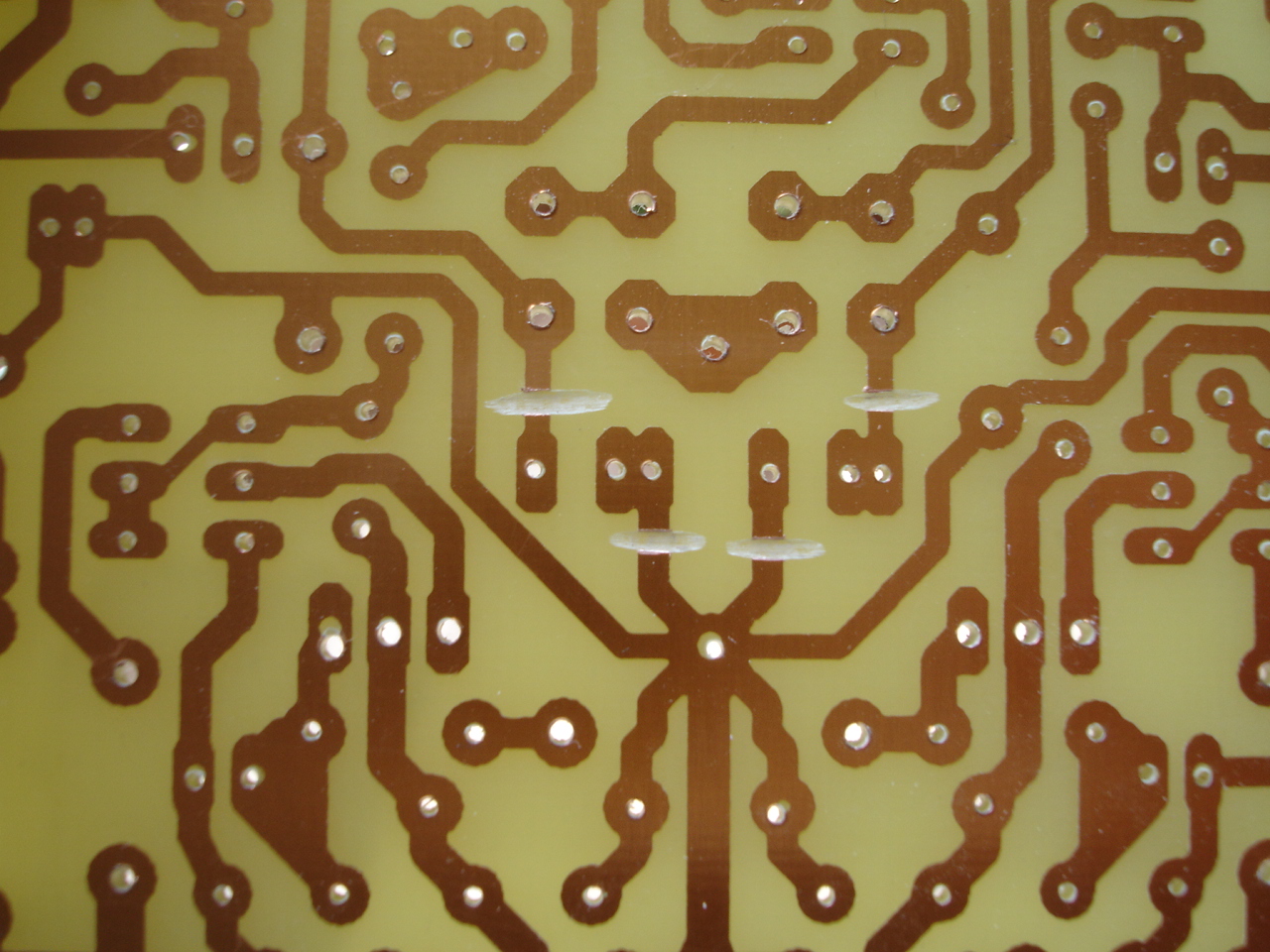

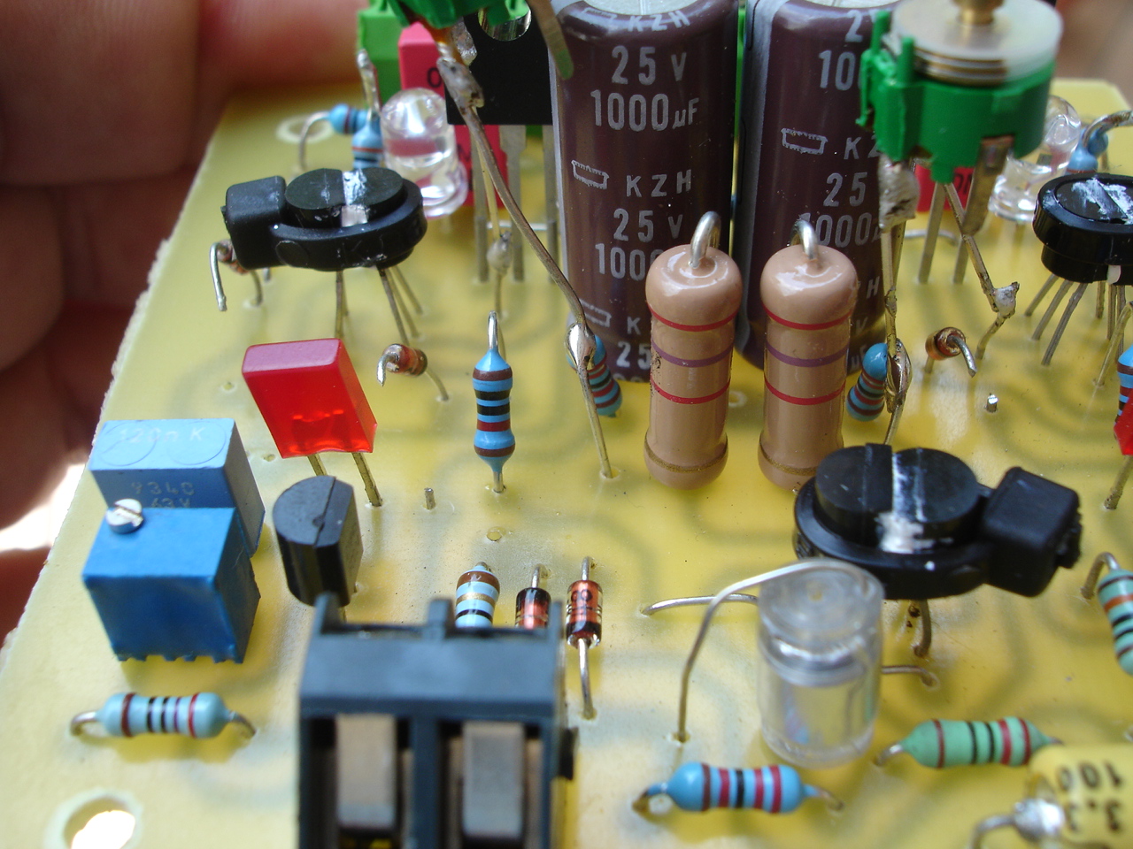

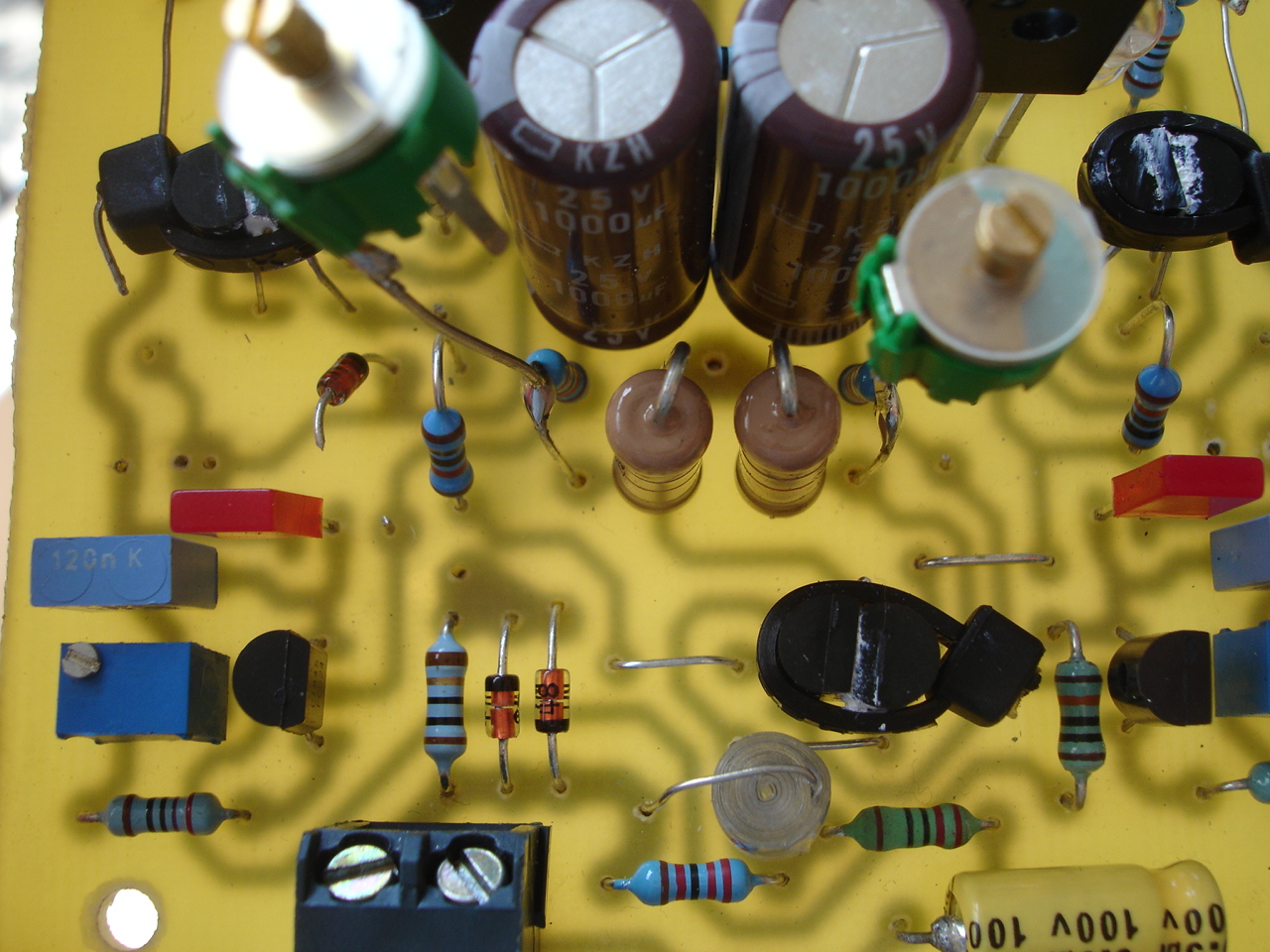

Some photos for easy modification.
Used 22R /10W instead of fuses!With just one pair OUT installed you must read approx 1.5v on 22R.Use a lamp on the transformer primary side.Tried to fire up the CFA-x"h" that OS released long time ago.

What is your power supply voltage?
Mine is +/- 50V and mine 150R are 1/4W without any problem(750mV) P=0.75*0.75/150=0.00375W
Check transistors position!
Hello Thimios,
I too use 22r 5w instead of fuses. When powered the voltage drop over safety resistors is about 5v. This is way too high reading.
The rails are 50V on my test psu.
My first suspect are the cascode transistors, I need to desolder them and check that they are oriented correctly. It is just too bad that I glued those togehter!
The OPS work perfectly as standalone.

I try to remember to mark the top of one of the transistors before I glue them together and write down which one I marked. Been there, done that. If you plan to do a lot of diy audio, I highly recommend watching for a good deal on a variac. And,build yourself a lightbulb test circuit. I can't tell you how many times those two things have saved my butt. I never, ever start up a new circuit without them.

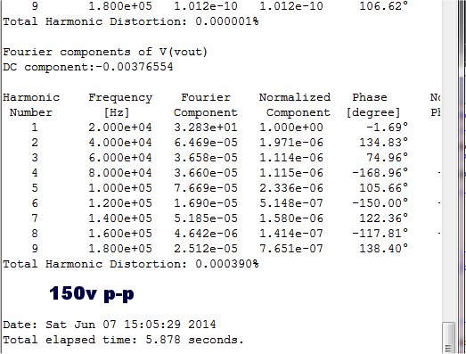

Strange ... THD wise , the spook holds on to low double digit PPM to nearly
full power 😕 ...
(spook and sym are best in this metric) - 120v p-p+ with high rails.

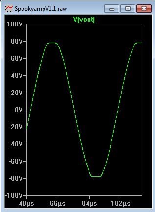

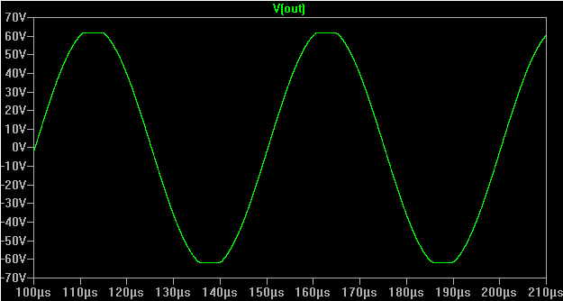

Amplitude change 0,1V p-p, distortion rise one order. Clipping picture attached.

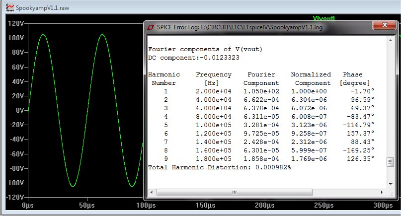

A contest ? Trying to trick me to show V2 "spook" w/ 5ppm at these levels.
how about 230v p-p @ 22ppm ? 😀
It looks like the "rumble" is between spook - CFA-Xh 🙂 .
This is the "limit", 15V cascode + 120v to-92's (130V rails) !!
33 ppm <250v p-p)
OS

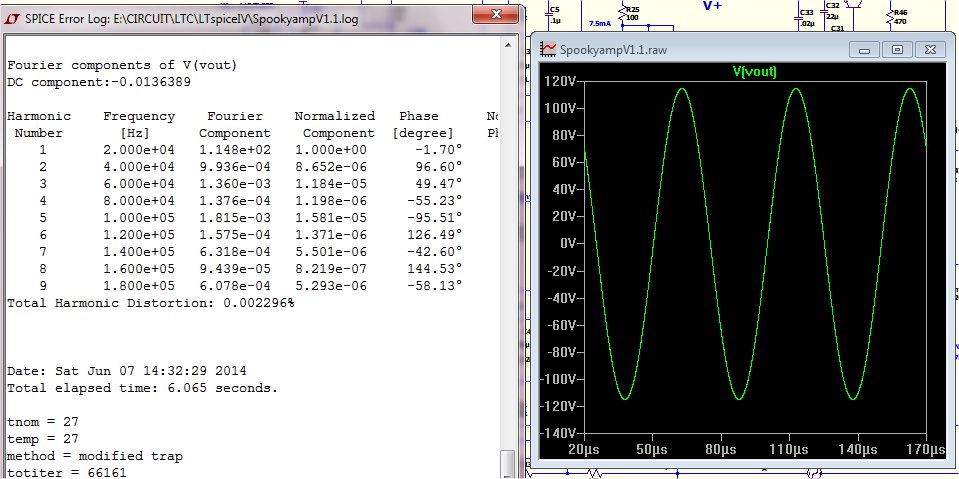

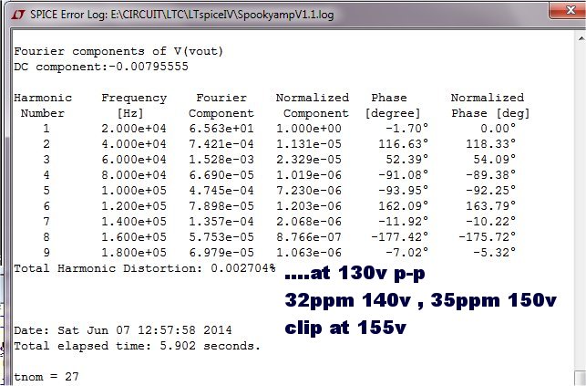

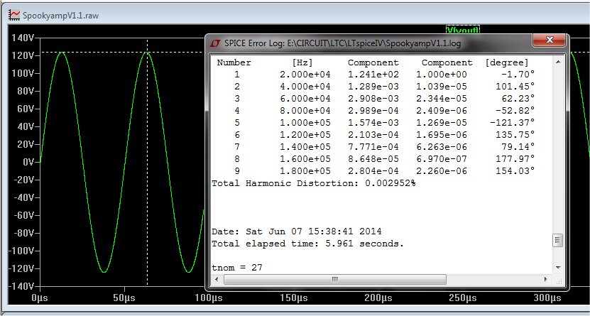

Bias too low on high level sim.
Only 35ma before at 22ppm.
Here's @ 220V p-p 20k with 77ma Ef bias.
😱 .... ha ! (the VFA bomb).
Edit - with limited CLG , tmc only gives a 4X thd reduction on the spook.
Higher CLG wolverine ... 10X +
OS

have no interest on contest, no with simulation, reality is what counts. You wrote
What is "nearly"? 1V, 5V 10V under clipinng? Or 0.1V ? That is what i mean with "far below"..to nearly full power
I'm sure ,you have this VFA bomb.Only 35ma before at 22ppm.
OS
Spooky is the light ver. of this.
Hi Juan go ahead and make a PCB for CFA with all recommended by BV modifications.OS have the problems now,he is under great pressure
3V (below 29ppm 250V p-p) ,
254V = 60ppm ...
clip is 255v.
Both hawksfords should react the same near the "threshold".
Still , more than adequate performance - layout will determine the final result.
I was joking about "contests" ... you know.
There ... mine is longer 😀 .
