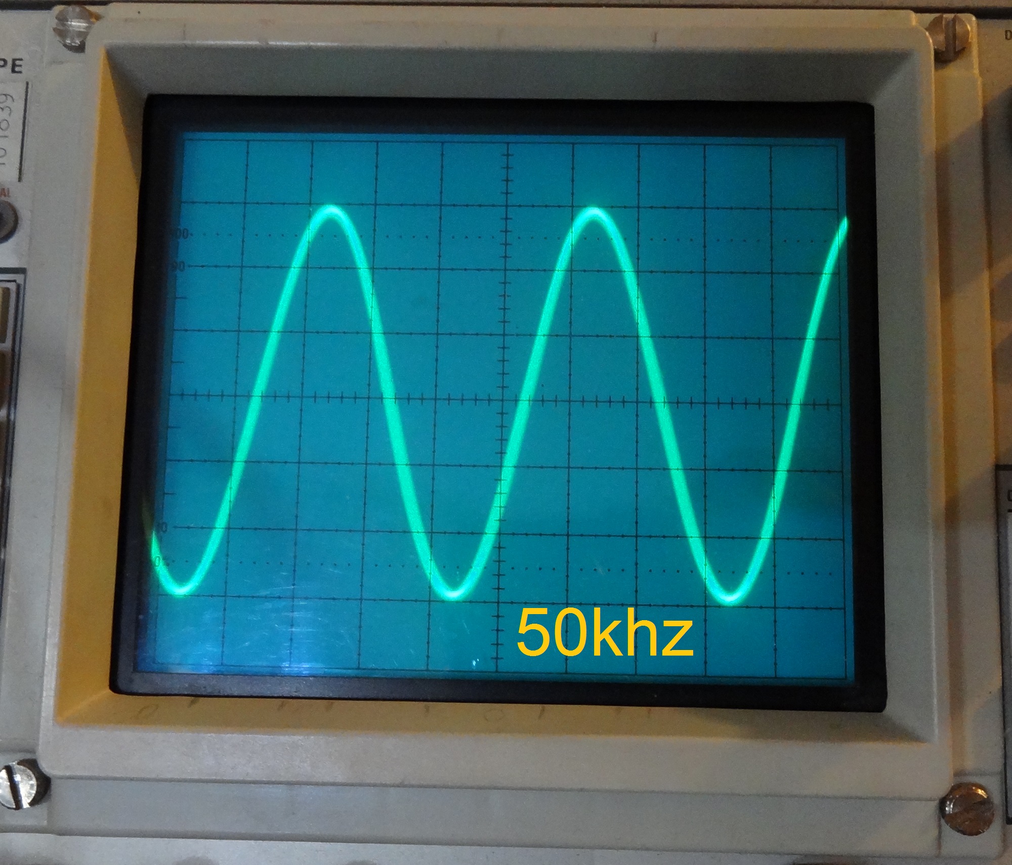

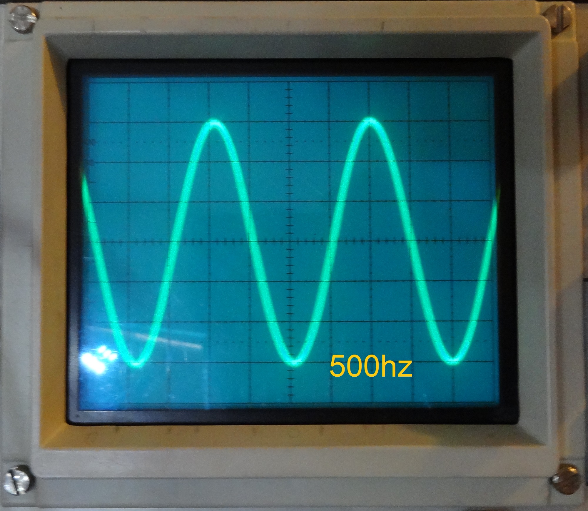

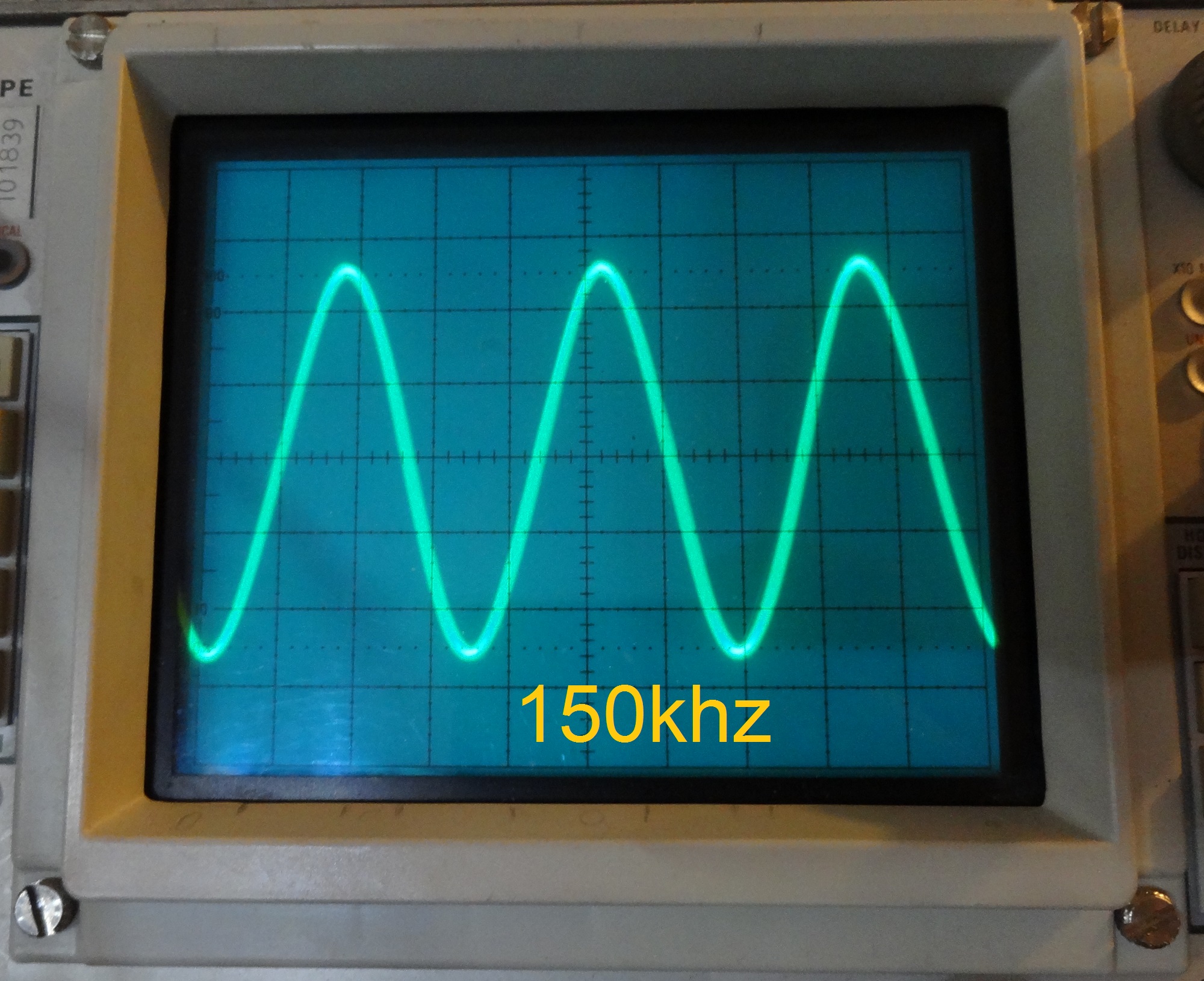

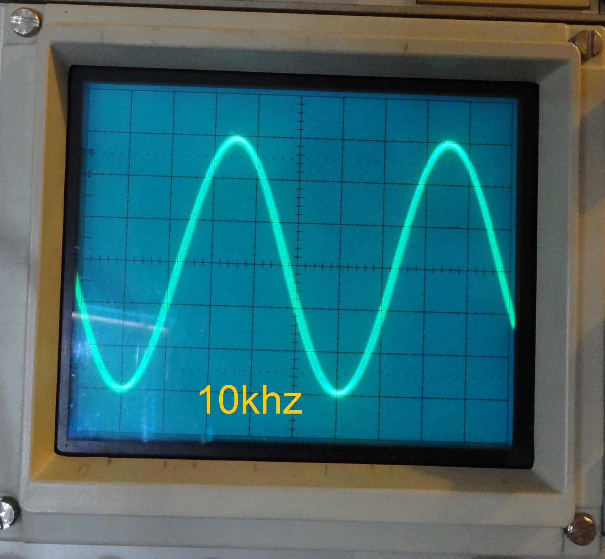

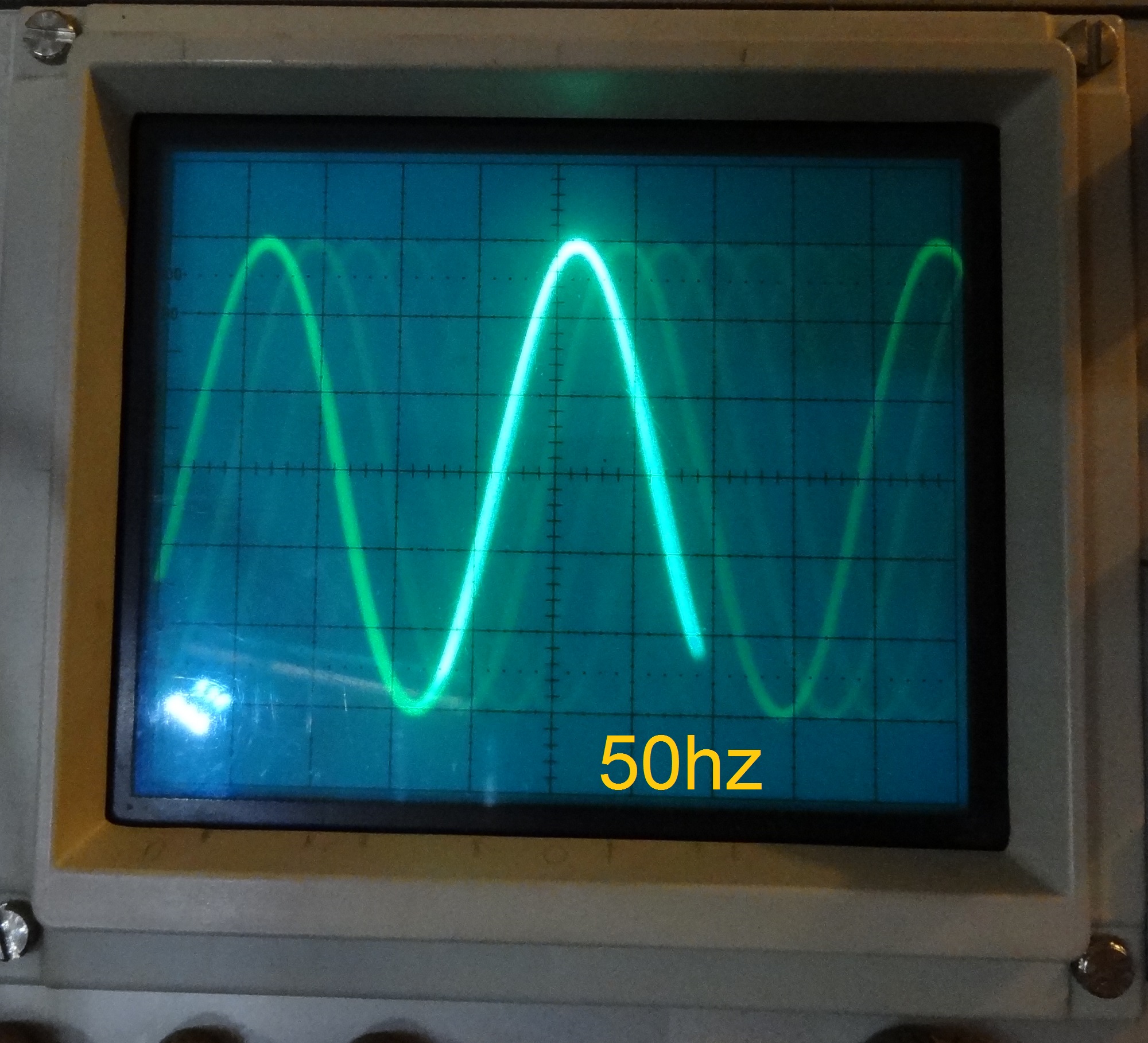

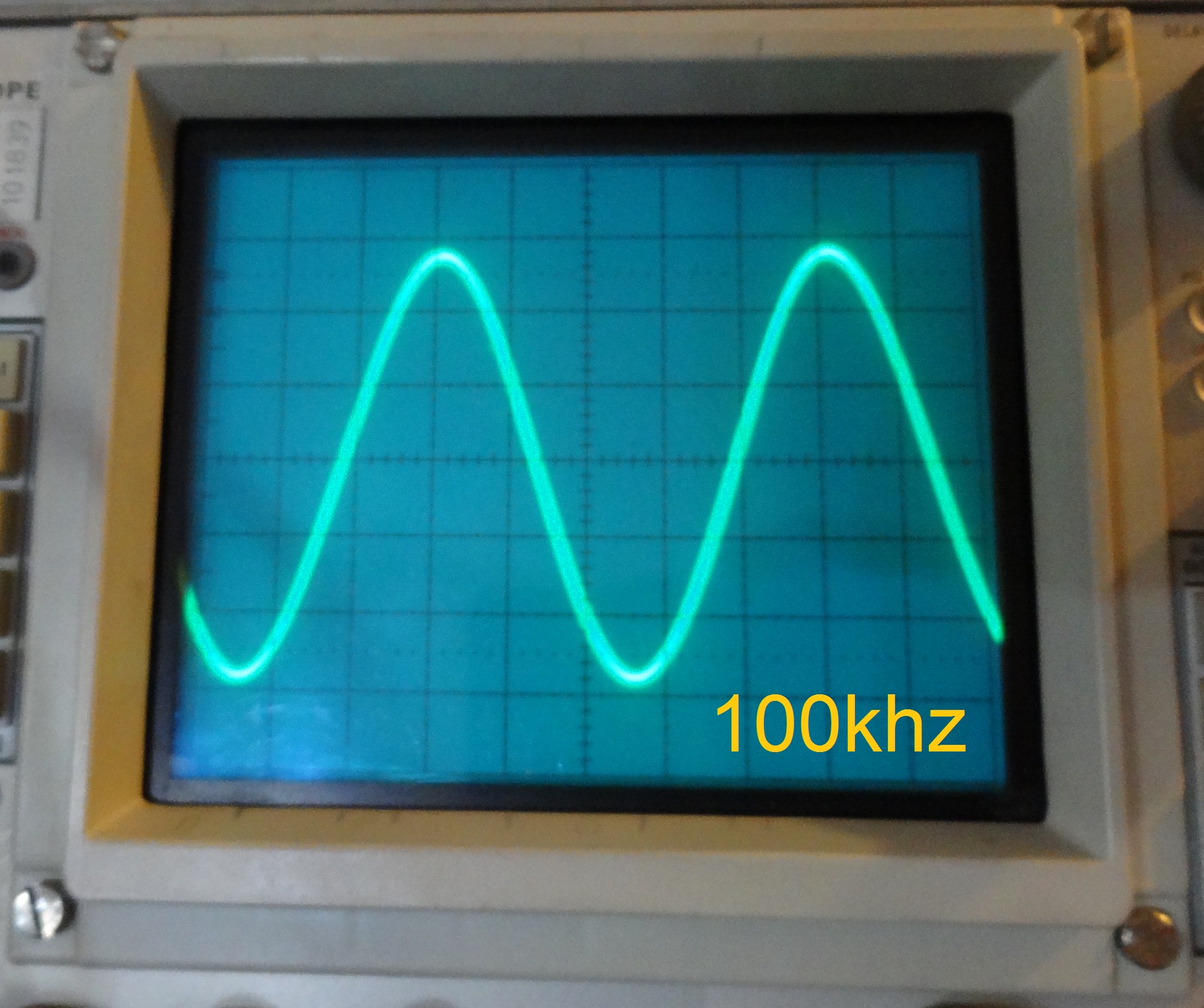

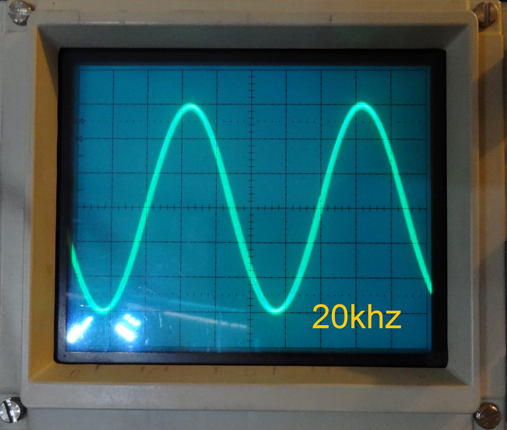

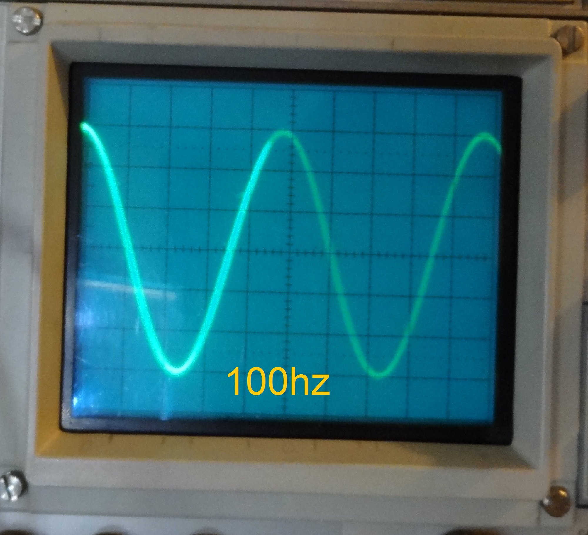

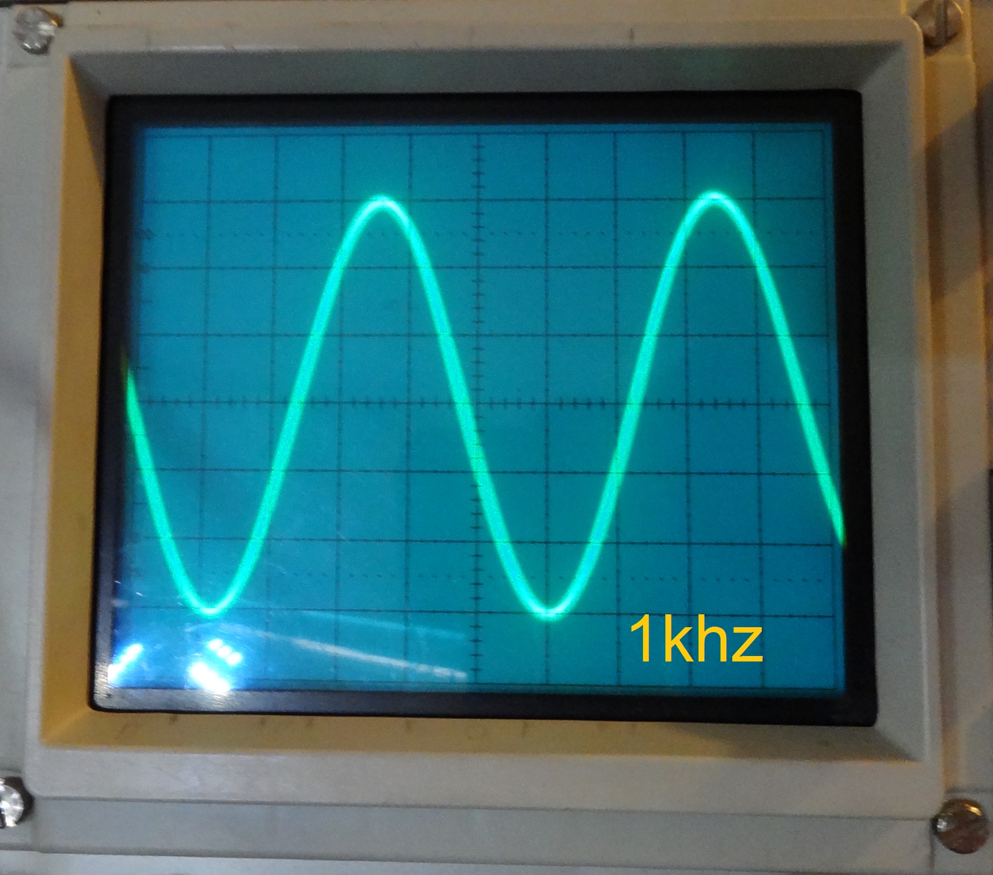

OK, here are some screen shots of sine waves. I set the generator so that I had a little over 10Vac at 1khz and left the level there for all frequencies.

Yes Terry but people wanted to see you do 10Hz 5Hz etc to see what the low end roll off is like 🙂
This is what I was responding to. I'll see if my equipment will do what you are asking for.
EDIT; Can't do. My Sine wave generator only goes to 20hz, no lower.
Terry, they actually look very good, confirming rock solid stability and good bandwidth of the circuit at the higher end.
Tilted tops at lower frequencies may be an indication of certain bandwidth limitation at the lower end (caused by not enough value of coupling capacitor at the amp's input, for example).
Can you do a simple experiment - see the p-to-p amplitude of the sine waves on the scope screen for, let say, 1KHz, 50Hz, 20Hz and 10Hz, with the same amplitude range setting at the scope?
Drop the pictures here and we'll see if this is the case...

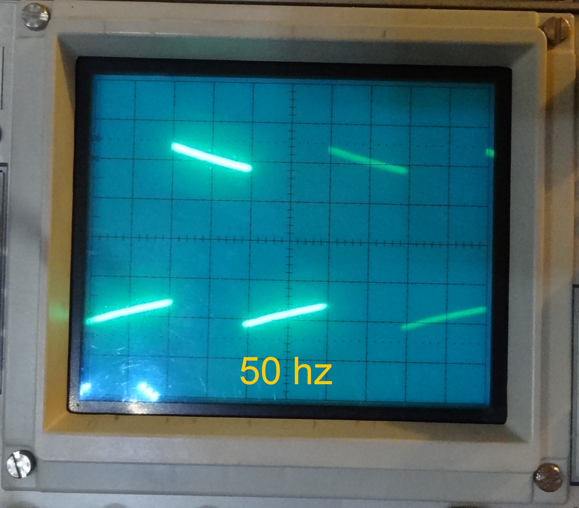

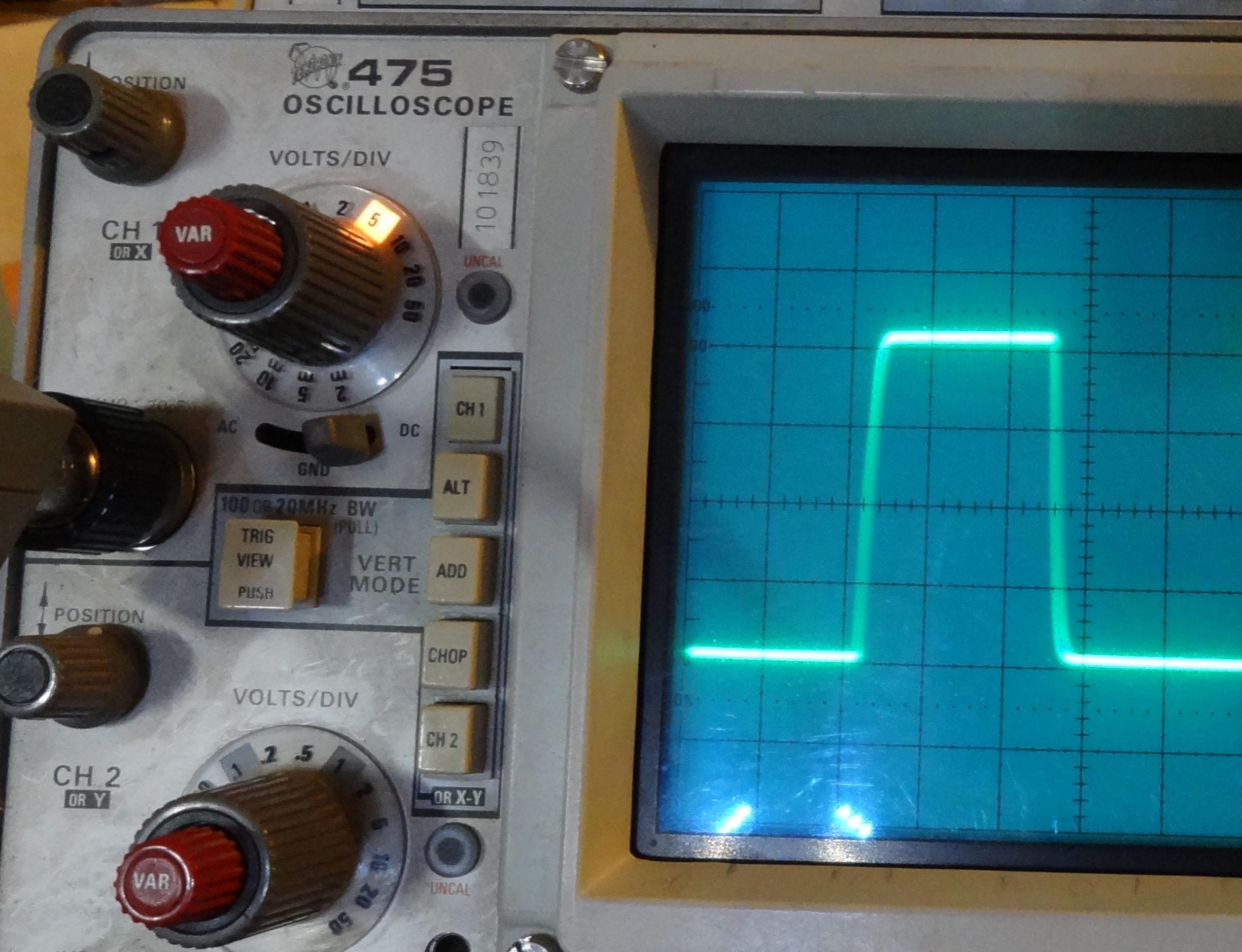

I can read it from 50Hz square that Terry had posted. F(-3dB) is about 5Hz.
Well like others have said, the low end roll off isn't any issue and is entirely normal. Adding in a highpass always creates a sloping top and bottom on a square wave. Usually one chooses a corner frequency some 10x lower than the lowest frequency you expect the amplifier or equipment to produce. So in this case 2Hz. The usual 47u + 10k input impedance lands you pretty close to this.

Terry, at least up to 20Hz at the lower end it looks perfectly fine - no sign of amplitude drop, so never mind. It is a very good performance in all aspects. Simple calculation - Fc=1/(2*pi*R*C) - with 10uF cap and roughly 20kOhm input impedance shows the low-cut frequency at around 0.8Hz, so no problem at all.

47uF + 10k makes 0.338 Hz/-3dB

Terry -
just one question. Do you use AC or DC input mode coupling with your oscilloscope, for a measuring channel?
Especially for square wave measurements.

Very nice sines up to 150kHz 🙂
