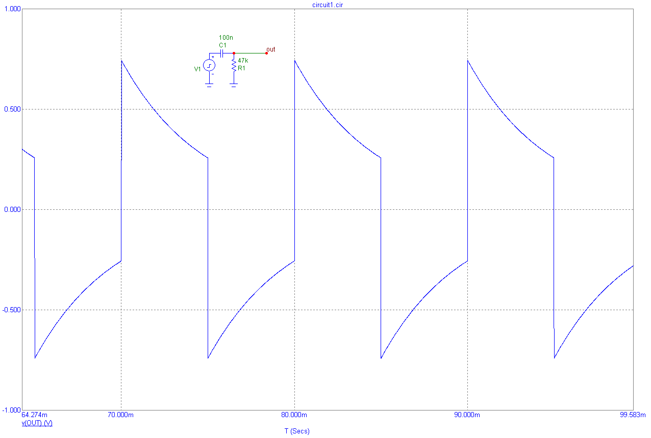

What is the explanation for the tilt of the tops of the square waves at the low frequencies? I understand the rounding of the leading edges of the high frequency scope readings but not what I am seeing on the low end.

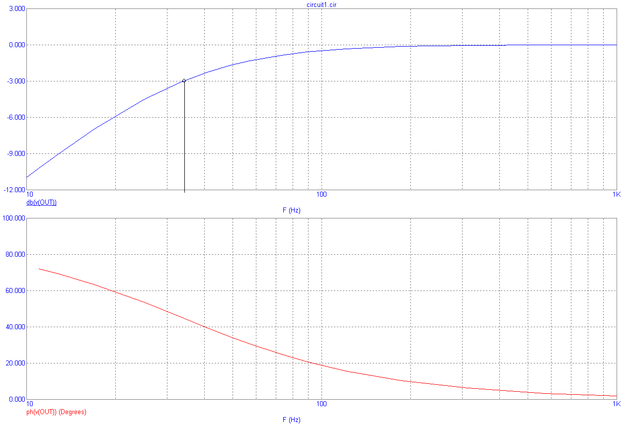

LF roll off. Pls check the images attached. Capacitor charged by resistor, voltage drop across capacitor. Time constant RC.
Exactly
The bigger capacitor is -> the higher time constant is -> the lower low-cut frequency is -> the smaller tilt at a given frequency is
Low frequency roll-off at some 5Hz (-3dB) is no problem. All I wanted to show is that any LF roll-off makes exponential decay at step response with RC time constant. The lower square wave frequency, the more you will see it. Guys, this belongs to absolute basics of analog circuits and understanding is necessary for ANY diyer.

Thank you Pavel. For me anyway everything is new so I am still learning all the basics. The resistor in the capacitor resistor equation sets the time constant, the larger the resistor the slower the time constant? Or increase the capacitance with the same resistor and the same effect?
Yes, time constant (and thus low-cut frequency) depends on both coupling capacitor value and input impedance. For a given low-cut frequency, the higher input impedance is - the lower cap value is required. F = 1 / (2 * π * R * C)
Yes the RC time constant is the product of the R and C, R*C=TC. You can calculate the cut-off frequency if you like:
Fc=1/(2*pi*R*C), where R is in Ohms and C is in Farads and the result, Fc, is in Hz.
For example, using some values I generally like to use: Input C is 10µF and input R is 10kΩ.
Fc=1/(2*pi*R*C)=1/(2*3.14*10000Ω*0.00001F)=1/0.628=1.6Hz
Raising either or both increases the time constant. There is no issue with the sloped tops when viewing low frequency squares, that is just the 'high pass' filter response you are seeing created by the input coupling capacitor and the input impedance of the amplifier itself.
So long as the -3dB point is sufficiently low there will be no issue with bass response even though you may see a slope on the square wave testing. The low frequency cut-off is fine in the neighbourhood of 2Hz-5Hz. I like to keep my high and low frequency cut-off points to be about a factor of 10 outside the audio band, so my 1.6Hz input section values as above satisfiy that requirement.
