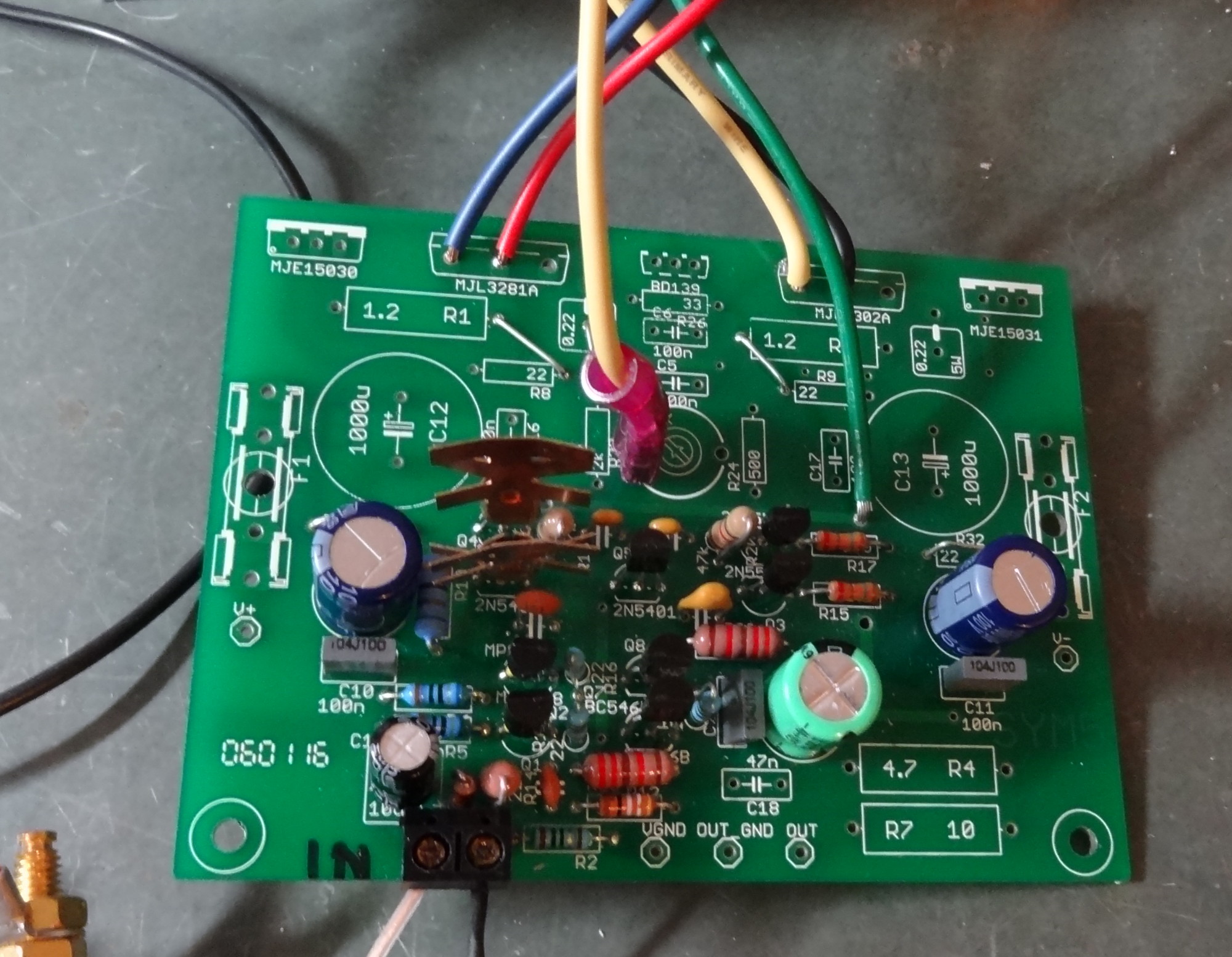

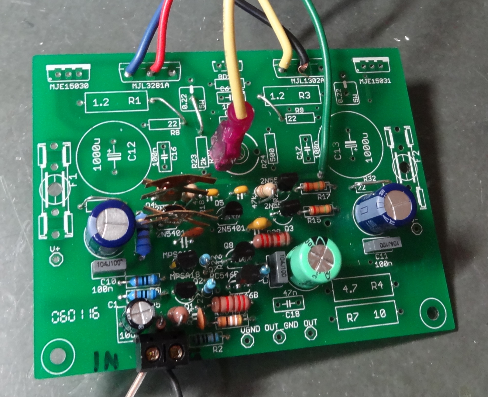

I have the Symasym IPS populated and want to test it before I hook it up to the OPS. Will the circuit I have attached work for testing? Can I measure across the "Load resistors" to attain the VAS current?

Start on the high side (less current - 470R?) for the current source.
This will underbias the VAS , making it "short" on total current.
This , in turn ... will underbias the OPS (safe !!). Slowly lower the CCS
resistor value, (a 500R trimmer) ...to get into an optimum range for the OPS (4.5-5.5ma).
The "sym's" CCS is the main player in determining the VAS current (same
as my "symasui").

Could you please clarify a little for me? Which resistor is the CCS? Are you saying to replace it with a 500R pot? Will a pot take the current OK?
OK, I tested the boards and as Jason said, the current doesn't change a lot as the voltage goes up. I installed the 470R load resistors. I read 1.8V across the load resistors so if I'm right I have 3.6mA output. I know that is lower than the 4.5-5mA but I thought I would try it anyway. Seems to work just fine so I want to ask how the lower current affects things so I can learn something here. The little VAS transistor do get a little hot but certainly not boiling. I suppose that may be because the lower bias. I put some heatsinks on them anyway. The IPS is running on +-74V. OPS rails are at +-77V. The offset is < 5mV. That is the lowest I have seen to date on an amp that doesn't have an offset pot. Pretty impressive. Oh, did I mention this amp sounds lovely. I have changed my mind about offering my extra OPS boards. A few of these are going to become complete amps. Just too nice!

R11 on your schema is the resistor , Q7/8 are the CCS. These devices
regulate current to the input differential.
With the pot , you could adjust VAS current from 2-7ma . No need to switch
other resistors - preserve the symasym sound 😀 .

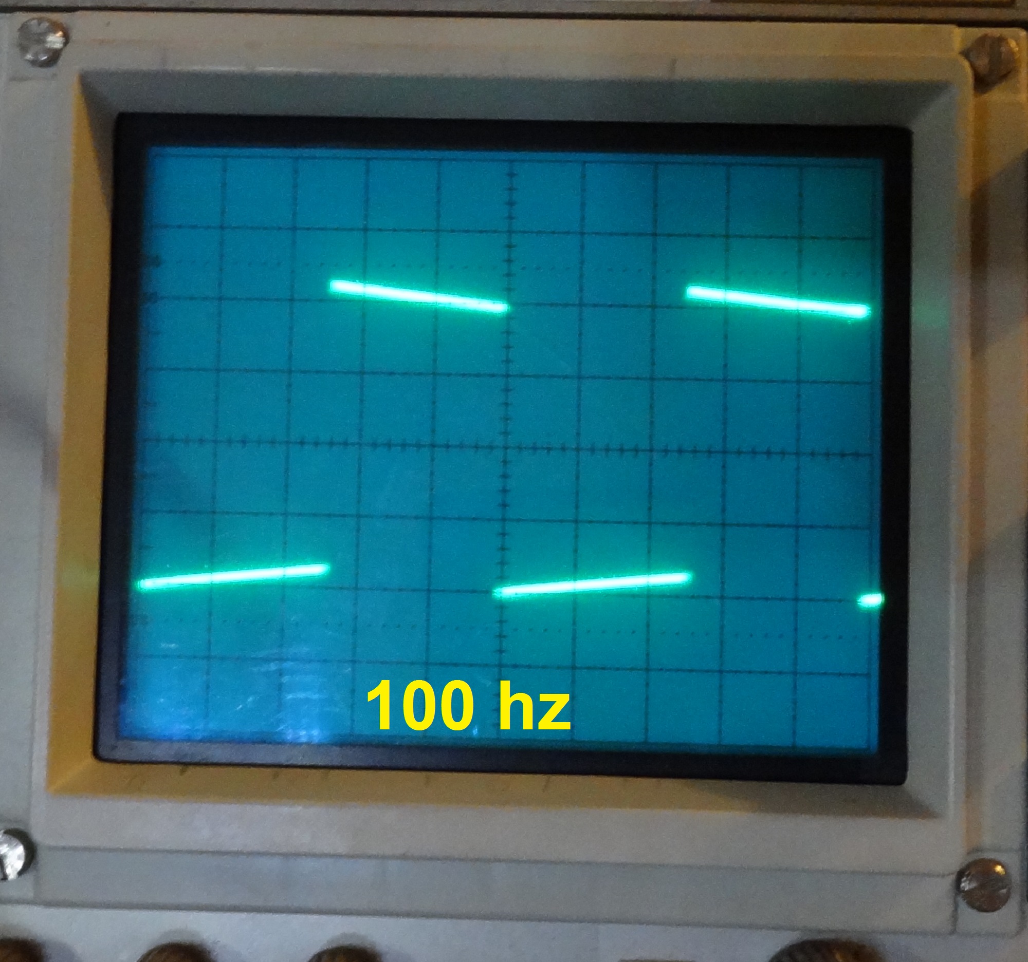

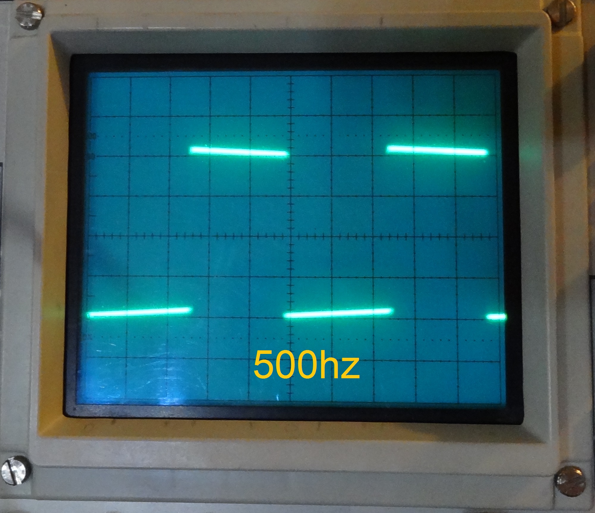

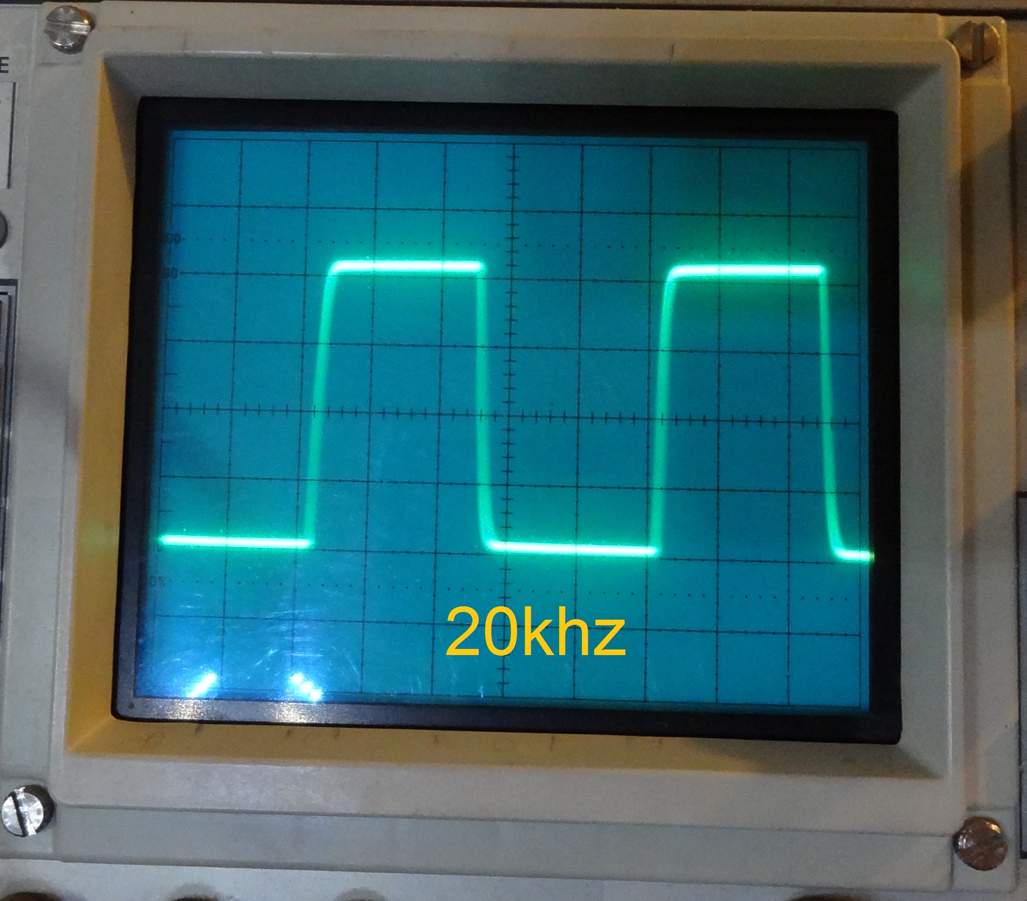

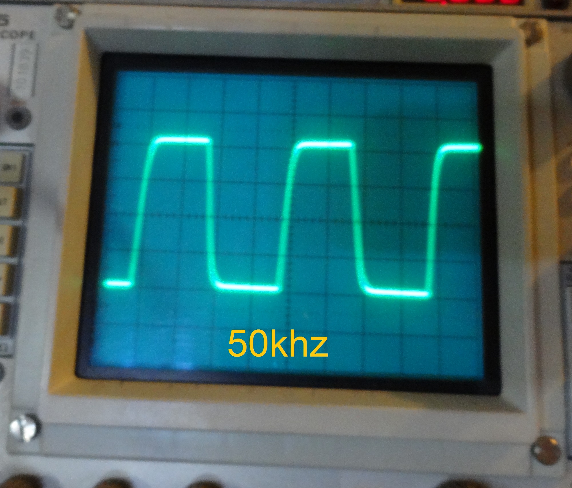

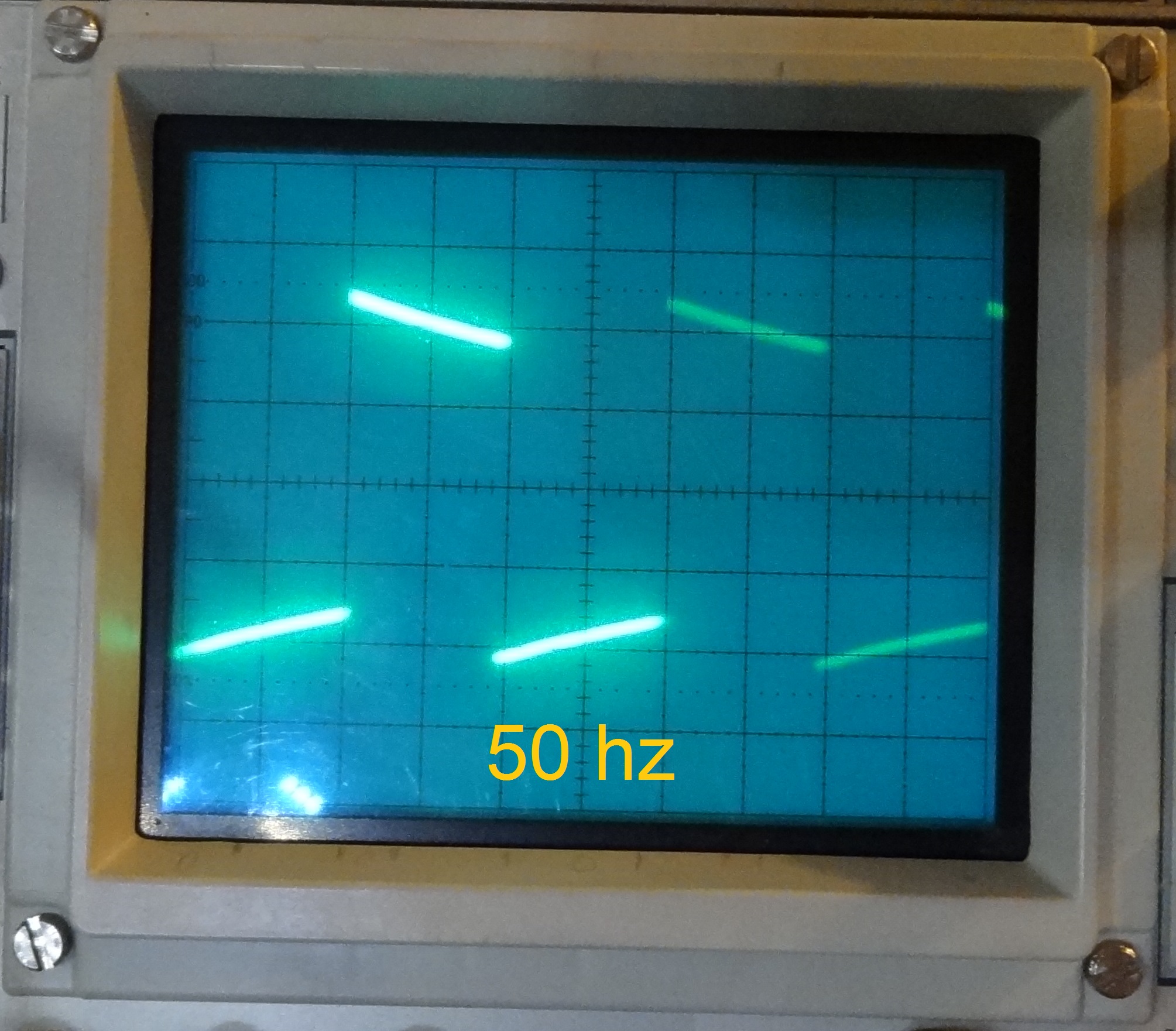

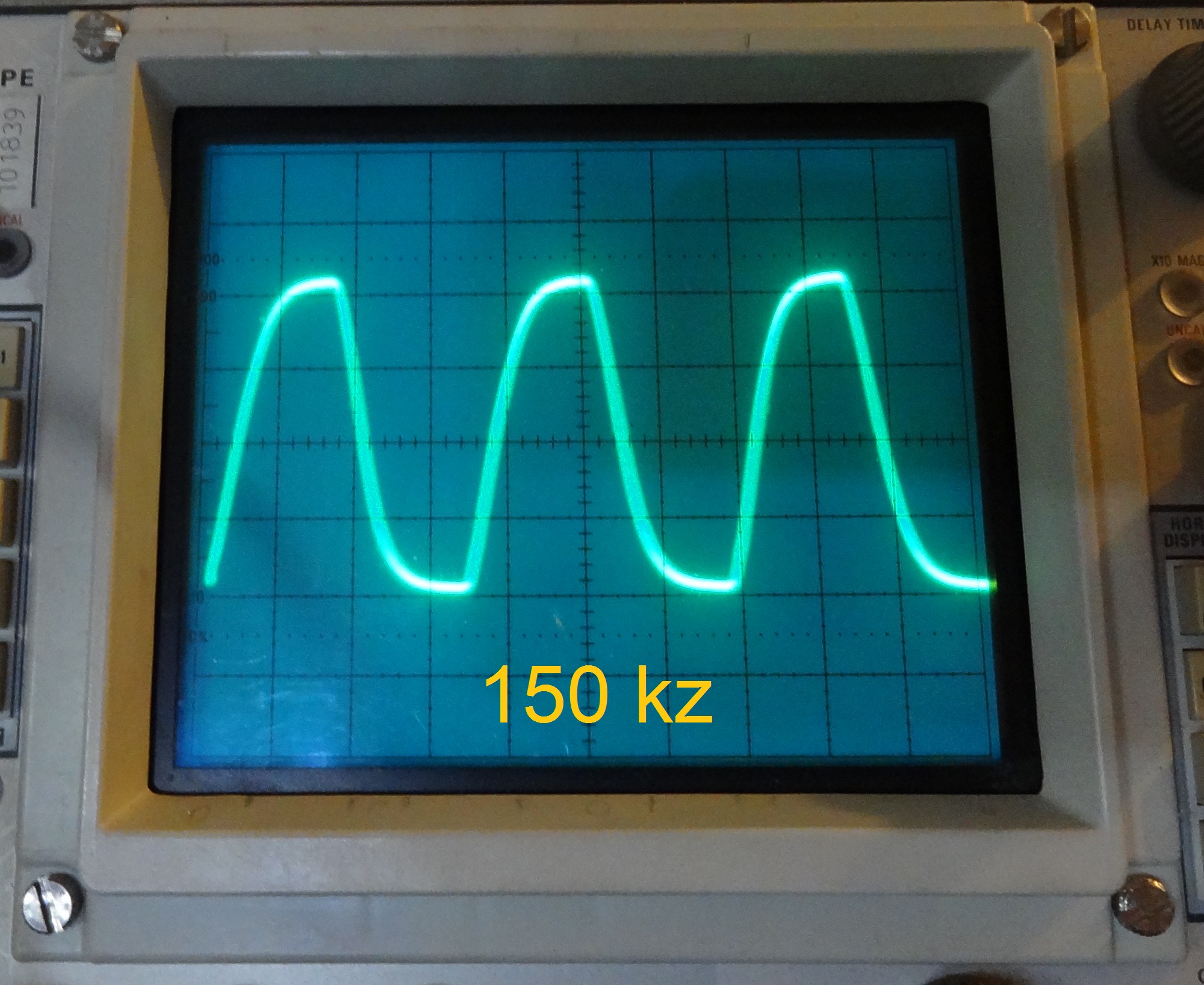

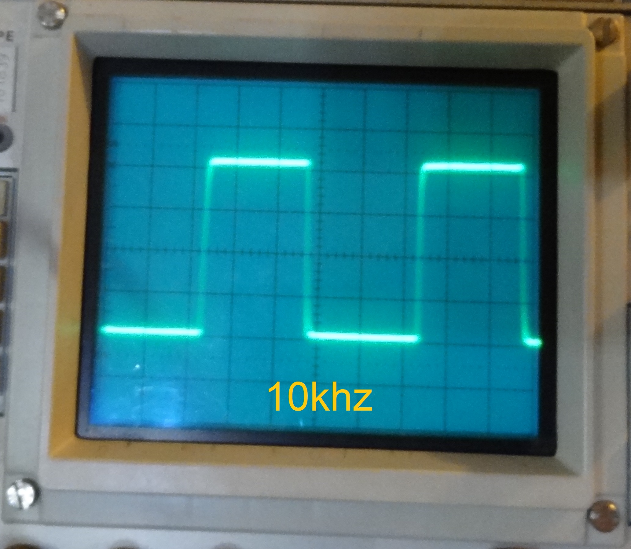

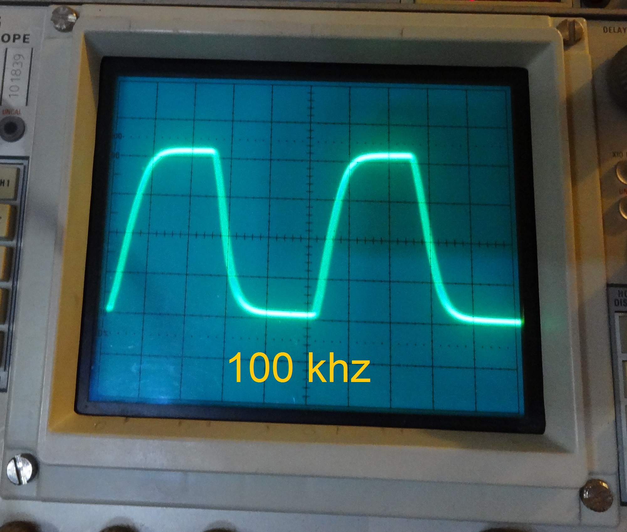

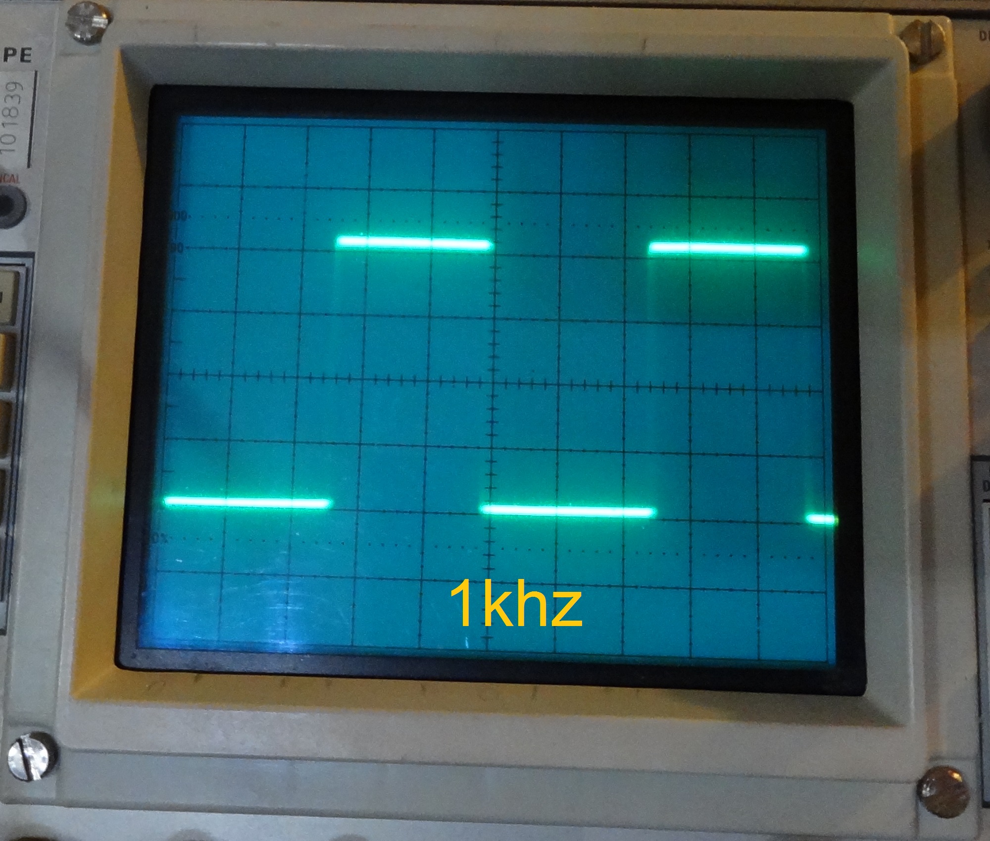

I sat down and and hooked up the scope and generator. I played some square waves set to 10Vac into an 8 ohm dummy load. I am attaching the pics.

What is the explanation for the tilt of the tops of the square waves at the low frequencies? I understand the rounding of the leading edges of the high frequency scope readings but not what I am seeing on the low end.

Terry, they actually look very good, confirming rock solid stability and good bandwidth of the circuit at the higher end.
Tilted tops at lower frequencies may be an indication of certain bandwidth limitation at the lower end (caused by not enough value of coupling capacitor at the amp's input, for example).
Can you do a simple experiment - see the p-to-p amplitude of the sine waves on the scope screen for, let say, 1KHz, 50Hz, 20Hz and 10Hz, with the same amplitude range setting at the scope?
Drop the pictures here and we'll see if this is the case...
Those readings were done with the same amplitude. I set the generator so that I read 10vac output at the speaker jack with a 1k signal. Then I simply changed frequencies and switched the dial on the scope to keep approximately three waves visible on the screen. I didn't touch the amplitude again during the test. If you look at the screen shots you will see that they are at the same amplitude.
As for the input cap, I just used a small 10uf, 100v, polarized, electrolytic. I'm sure the measurements could be improved with a better cap though I'm not sure if you could hear it. On the CFA IPS, the HF waves looked similar to these until I bypassed the input cap.then they became very square. The sound was the same so I'm still not convinced that 100khz square wave shapes have much bearing on how an amp sounds.

Right, we just need to see the sine amplitudes at the low frequencies - then we can clearly see if the cap value is enough
Sorry I didn't notice you said sine wave. I will post those up in the morning. The amp has very strong bass response. It is actually pretty impressive.
