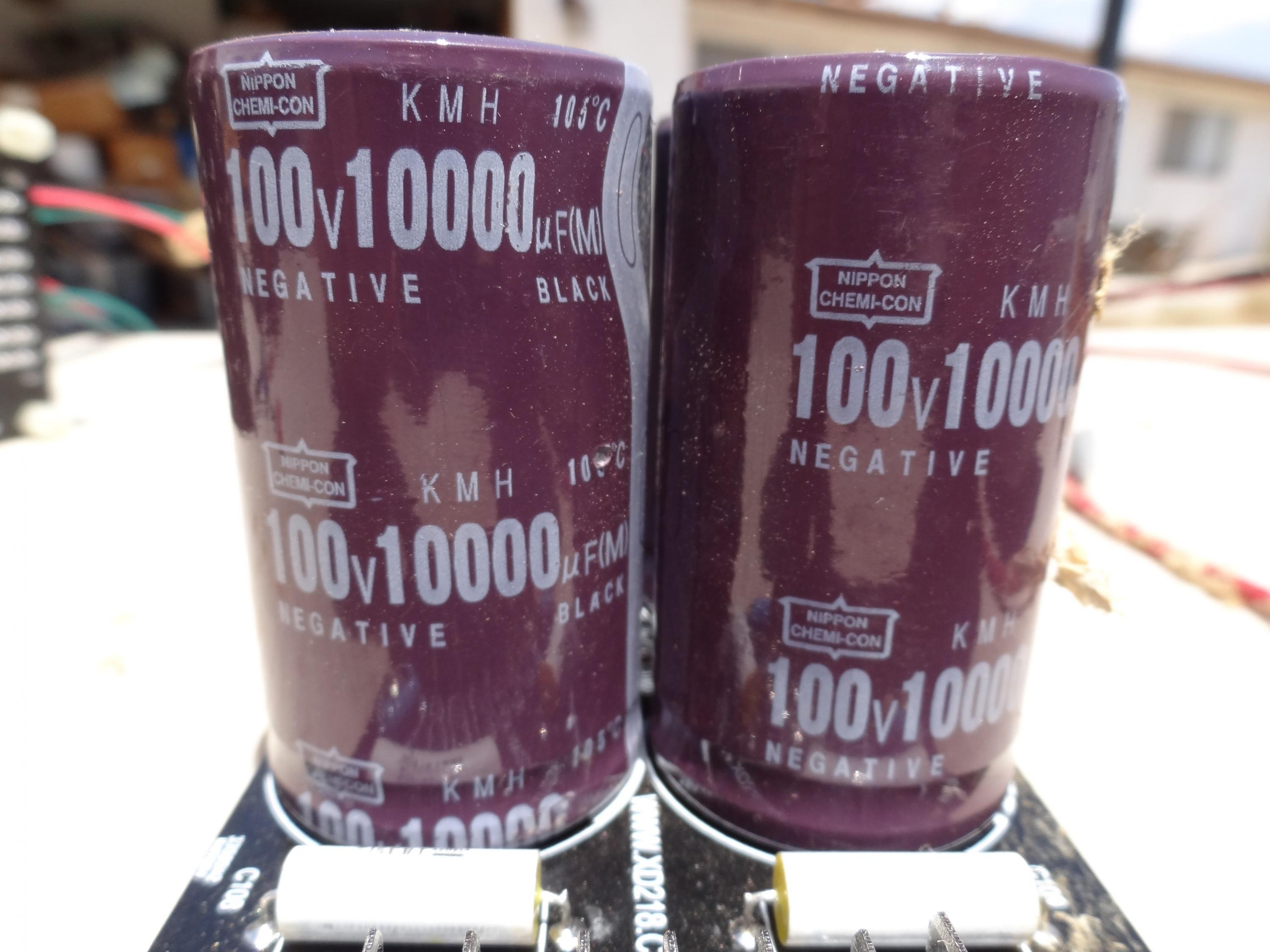

Thought I would share my experience this morning. I ordered a couple PSU units from ebay so I could make two identical power supplies for the A/B Slewmaster setup I trying to put together.
4 10000uF 100V High End Power Amplifier Board | eBay
Received them yesterday so I hooked them up one at a time to test them. I hooked them using my light bulb tester just in case. On one of the units the light continued to burn dimly so I felt the caps and one of them was warm. I figured it may need to be reformed so I hooked up a separate bridge and used a 27K resistor and let it charge over night. This morning, I checked it again and the resistor was still discharging about 6V. I tried hooking up the PSU normally and the cap still got warm so I shut it down and discharged it. Then I hooked up the second unit and turned it on. I kept feeling the caps and they were all cool so I decided to let it run for a while and see how it did. Well after about 5 or 10 minutes one of the caps exploded. Fortunately I was a few feet away. I hate to think what might have happened if I was standing right there staring at it. I am attaching some pics for your enjoyment.

Here is a close up of the caps. These are 1-3/8 X 2-1/2"

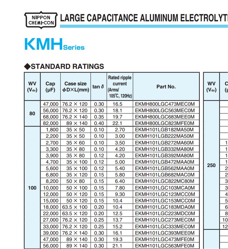

The "KMH" (105C) product line just goes to 35mm X 58mm (2.25") for
100v/4700uF. Then goes to 40mm for >5600uf....
They actually do make a "smh" 100v@ 10kuf that is 35 X 65mm.
Your vendor most likely took some 80-100v "rejects" and re-wrapped them ,
But even a non-reject SMH rated at 100v would not explode !!
They just don't make a (present stock or catalog) "KMH" with that value/voltage/size. 😕
PS - you even have a second one that is "warping" .... not just a random defect !!

Show this to ebay !!
Below / and link http://www.chemi-con.co.jp/e/catalog/pdf/al-e/al-all-e1001n-140101.pdf
Your cap should be 50 X 100mm !!
OS

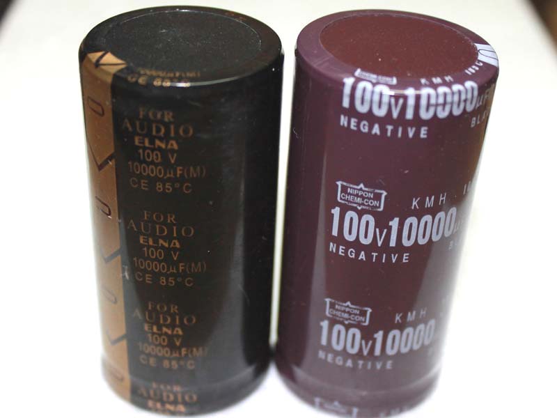

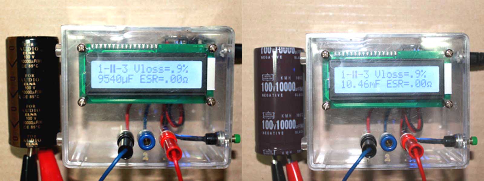

Hi Terry thank you help me 🙂 ...Here is a close up of the caps. These are 1-3/8 X 2-1/2"
I have exactly same caps ... bouhgt it here(in Bali) $2/pc 😀
What voltage did you apply before it is explode so I don't did it like that 😉
I have another one maybe that one also a fake.
I measured them like the pict 🙂

It been a long time since I disassembled any amps that had big filter caps. I probably would have been leery of those anyway. I knew I was taking a chance on these. For the price I didn't expect them to be top notch caps but I did expect them to manage the voltage they were rated at. Sorry I derailed the thread. I just wanted to warn folks about these caps. I'm a little bummed about it to be honest. I liked the whole idea of these little units. I thought they would make nice little supplies for my dual amp setup.
John Bali,
The cap popped at 88Vdc. The first unit had a cap heat up at 77Vdc with a light bulb in the circuit. I can't say what voltage would be safe. Three of the caps on each unit seemed OK but I can't say if they would have lasted either. The one that exploded didn't show any signs of trouble until I walked away from it.
