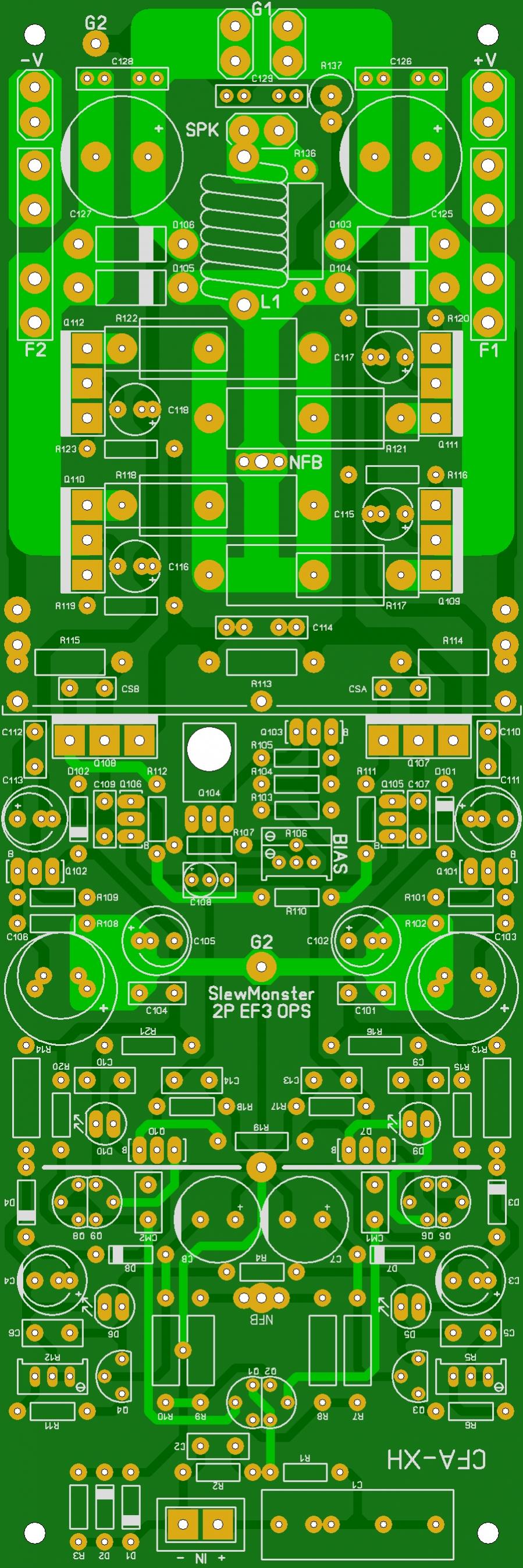

Well I just got my board populated and after a bit of trouble shooting powered on. I only installed one pair of outputs but nothing exploded and now I've got two very bright LEDs dazzling me (the red and blue do look rather neat 😀). I can set the bias correctly and null the DC on the output down to zero.
I didn't play around with it any more than that, but all things considered a very successful first pass.
Now i just need to drill/tap the heatsink and install the little heatsink that tracks the drivers.
I have to say though that the LEDs are a touch too bright for easy trouble shooting, they kind of blind you if you're wanting to look near them on the PCB. I went for the cheapest that mouser carried in both blue and red and these happened to be some super bright things. So a word of warning to anyone building these - don't go for very bright LEDs if you don't want to be dazzled. It will be nice when I have them illuminating the inside of the case though.

What boards did you build? Mine don't have LEDs.
Here is my confusion. He said one pair of outputs and then spoke of LEDs. So I guess he's talking about IPS and OPS. So which IPS?

The PCB is my own design though, I posted a picture over a week ago after the board was etched. It's a double sided 2oz copper board with SMD parts for all the small signal/lower power stuff.
The input stage is the wolverine followed by a 2 output pair version of the slewmaster. I only installed one pair however for the first power up 😀 OS uses two LEDs in the input stage, one blue, one red. I think he said you can substitute these for something else (zeners?), so they are not essential.
Jason,
I think that is exactly what I have been looking to do. What is the total length?
Same dimensions as the SM 5P OPS is on its own, 3" wide by 9" long.
