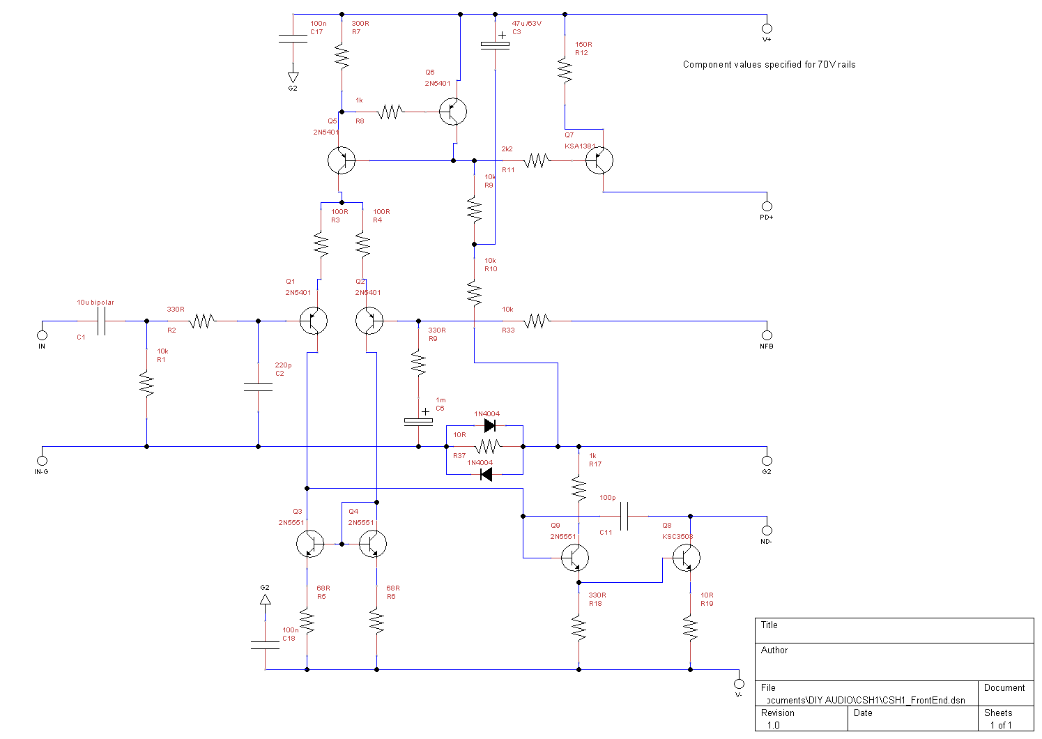

I made this IPS from a Blameless schematic posted in another thread. Can one of you take a look at it and let me know if you think it would be suitable for the Slewmaster? When I run it it seems to have about 6mA output so something probably needs to be changed to lower it. Anyway, please take a look and give me your thoughts.
Blessings, Terry

Hi Terry
There are a number of things about that schematic that don't look quite right to me. For example the inverse parallel diodes (D2 & D3) at the LTP collectors seem to serve no purpose except to equalise these junctions when there is a large imbalance > the diode VB drop. D1 and R33 serve no useful purpose, and the components around the VAS are a mess (bottom right corner).

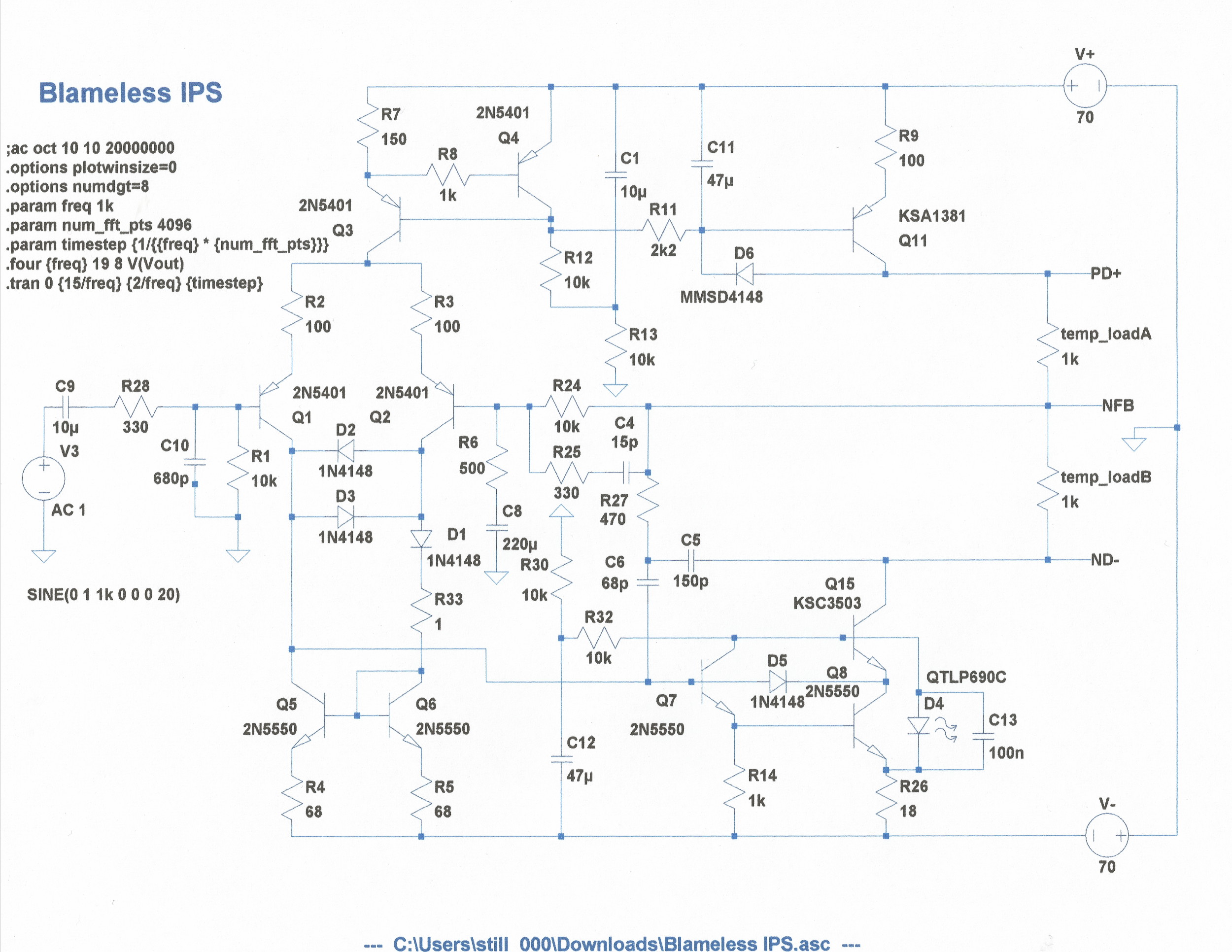

Instead, may I present for your consideration the Blameless design from my thread here: http://www.diyaudio.com/forums/solid-state/253215-my-blameless.html
This represents the 'as built' design with the output stage, bias generator and other miscellaneous components stripped in order to interface with the SlewMaster board. I've adjusted R7 to supply approx. 2mA current to the LTP and adjusted R12 to optimise the current through the VAS.
Of course OStripper's Wolverine IPS in this same thread is another Blameless, with more parts and complexity, and no doubt with OStripper's design expertise, it also holds the promise of better sonics.
With that said I lent my amplifier to a friend and fellow forum member who undertook some critical listening and comparison with his favorite amplifier and this "Blameless" performed very well in his opinion.
I have spent a lot of time experimenting with the P3A, building Carlos' designs and one of Bigun's. One of the things that these very good amps all have in common is a bootstrapped VAS. I think I will play with this design further, substitute a bootstrap capacitor for the CCS and eliminate the VAS driver transistor. Terry, let me know if you are interested in seeing what I have in mind.

Hi Terry, as usual, adjustment of LTP's long tail current will at the same time proportionally influence the VAS quiescent current. Coming from 6mA to 4.5mA requires slight increase of R7. You can see it, running a simulation of your model.

🙂, D2,D3 serve to limit VAS current during overdrive and limitation conditions, without unstability , sticking (so ensuring fast recovery)and local oscilations like with usally used transistor driven from VAS emiter resistor. This is obsolete in your schematic, suplemented with simple current limiting 1k (R17) resistor in colector of VAS enhancer. This is maybe a simple , but a bit "suboptimal" solution..D1, R33 serve to set without input signal zero DC across D2, D3 , so during normal working conditions D2, D3 have no influnce on circuit. Try both solutions in simulation.There are a number of things about that schematic that don't look quite right to me. For example the inverse parallel diodes (D2 & D3) at the LTP collectors seem to serve no purpose except to equalise these junctions when there is a large imbalance > the diode VB drop. D1 and R33 serve no useful purpose, and the components around the VAS are a mess (bottom right corner).

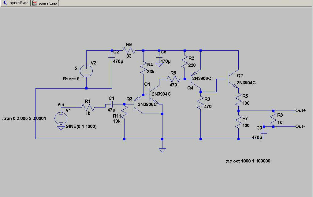

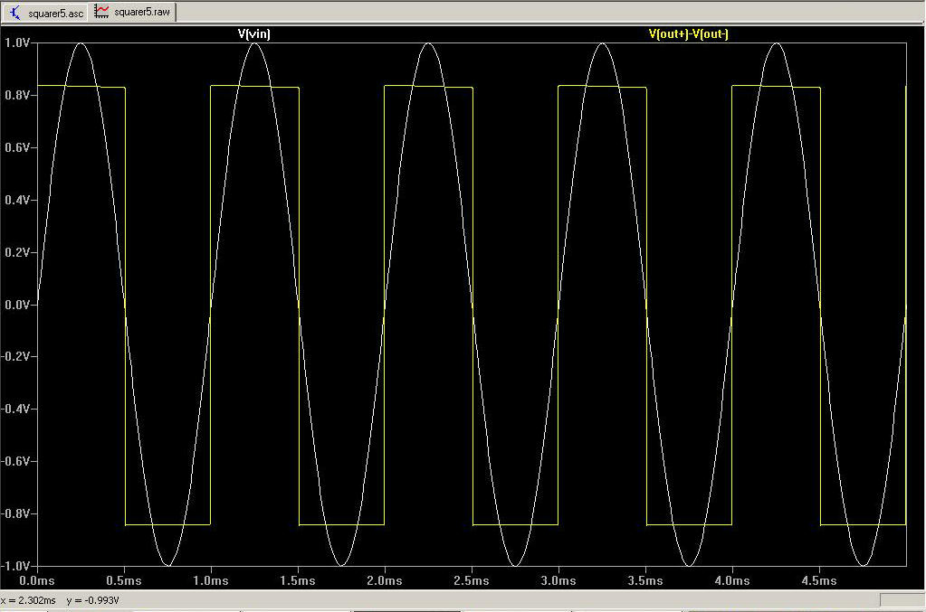

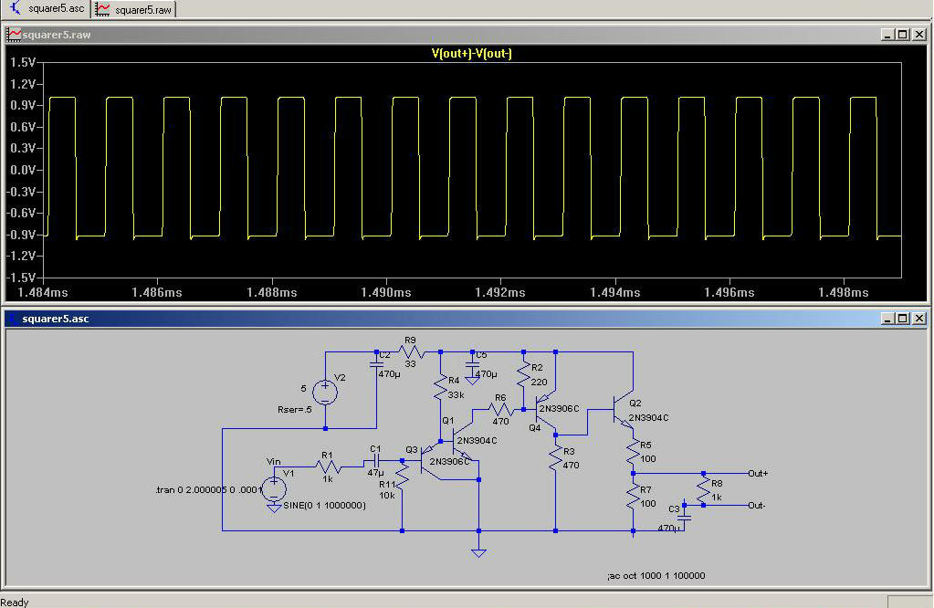

This is what I made to get a square wave out of my laptop.R11 can be a 20k pot if you want to get a close 50-50 duty cycle. Rise and fall times are better than my 10 MHz scope can measure. The 5V is from an old cell phone charger.
( schematic, 1k output, 1MHZ output)

R9 is what controls the amount of current the VAS current source supplies, so simply increasing that will adjust the VAS current to a lower value.
Once you learn to recognize the CCSs in the design for the input stage (LTP tail current source) and voltage amplifier (VAS current source) you just have to remember that altering the resistance in the emitter circuit of the CCS transistor alters the current through it.
You're right - sorry, did not notice VAS is not current-mirrored, but CCS-ed at a first quick glance. Of course, R9 is the right one.

That has a similar parts count to the "wolverine".
If you are building "from scratch" , the actual wolverine is the best bet.
It's dual independent CCS's and diode/semi options for saturation conditions
make it as "tame" as the CFA's in this category.
Also . it is the "next generation" badger ... which when combined with a
true EF3 ... should be deep in PPM territory - (VERY low THD).
