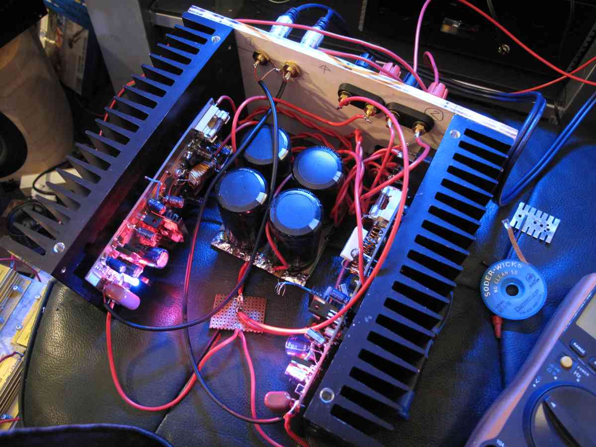

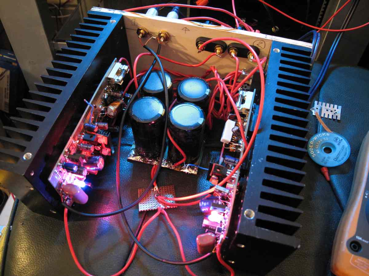

After the first board was a success I've now etched and put together a second board, so now I get stereo 😀
A case in point (no pun intended) about the 2 pair version, is that it fits inside a relatively compact case. The heat sinks here are 10x20x4cm and although the transformer sits in another box, it all fits comfortable in the small form factor.
I still need to build the DC/delay turn on protection board with MOSFET relays, but there's plenty of room at the front of what will be the case for that.

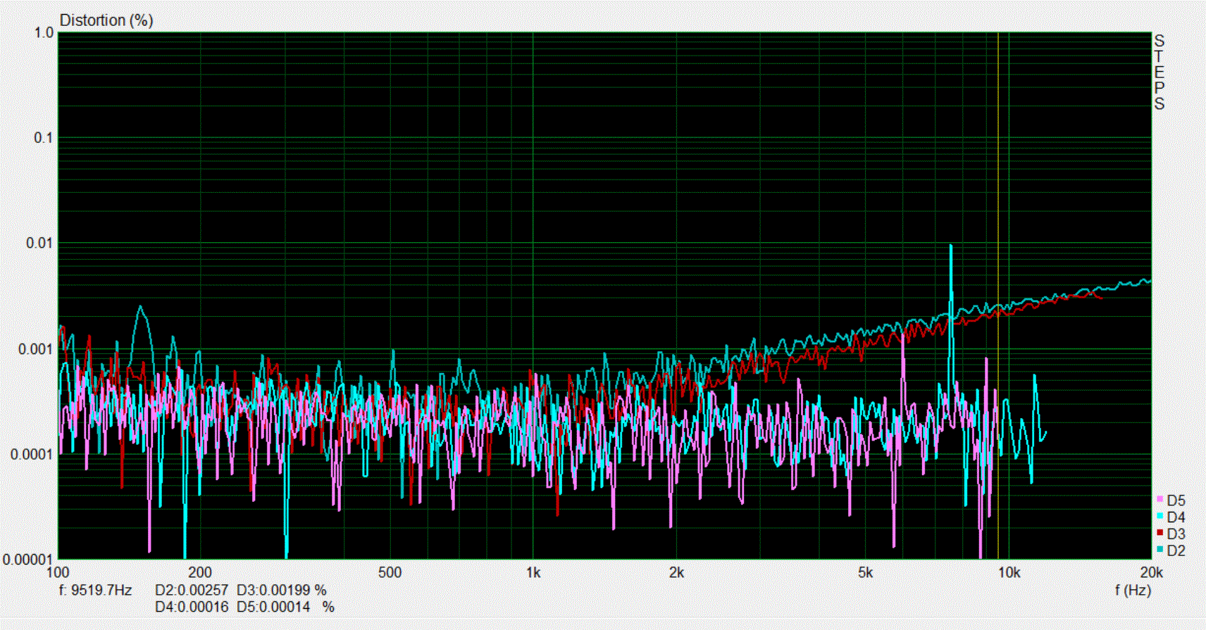

I've changed the RE resistors down to 0R2, and biased them a little hotter than the 107mA per device as would be optimal for 0R22 RE resistors. This should give me a little bit more than the 0.7 watts in class A as calculated before. Running a distortion sweep at 2.83vRMS into my 9.4 ohm load indicates that the amp could quite possibly be in class A for this. In my previous forays into class A going from an optimally biased class AB, to class A doesn't really affect the level of HD2 and HD3, but it does pretty much remove any higher order harmonics from the equation.
Here's the distortion sweep, where you can see the only thing that's really measurable is the HD2 and HD3 above ~1khz. The rest is just sitting comfortably in the noise. (Ignore the two spikes in the HD4 and 5 as they are measurement artefacts.)

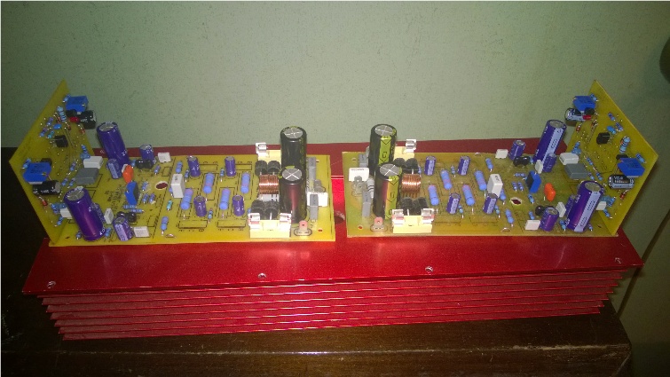

Nice work!Hello,
due to the availability of certain transistors I created my own layot for the IPS.
CFA-X with bc-series for to-92 transistors attached to Baby ops.
I´ll try to keep the smoke in on weekend.

Can you tell us which software used for measurements?

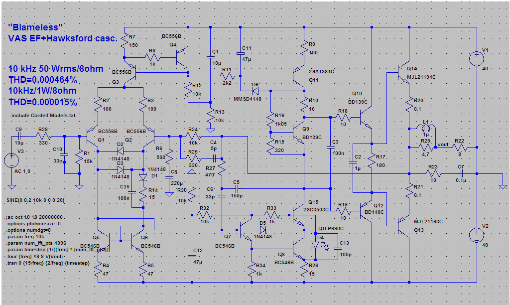

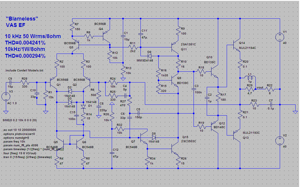

Missing conection from R2,C3 junction to GND.Maybe one of you can find the problem.
Also no connection to the anode of D4, the wire stops just short of making a connection.
I don't have the same components in my library, so I have to change components to make it run. You might want to put the device models you use into a separate text file and include that with your .asc files.
Thimios.
Yeah it's the SMD version, I don't really work with through hole parts nowadays unless it's absolutely necessary. SMD tends to be more compact and you don't have to drill holes/bend and snip leads for the parts either 😀
The software is STEPS, which is a part of the ARTA package of software. The difficult part though is getting hardware good enough to give you 0.000x% results. There are a few decent sound cards that will, none are particularly cheap, but they aren't madly expensive either.
Thanks Jason and BV, it works now.
