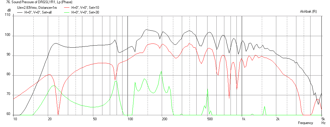

I haven't heard back from anyone if they think the frequency response curve from the dual cx10 Karlsonator approach is good and something I should pursue. I know Freddi prefers the Karlsonator, but that goes without saying. 🙂 My concern is the wider 20 in cabinet. Is that an issue for people wanting something to compete with the Pendragon. I think that the cabinet being 60 in tall I not an issue as I will flip it so that the drivers are mounted high and slightly tilted down to listening position. The tweeter can be done using a CD
mounted in one of the cx10 coax threads but modified using a K tube attached to where the usual tiny built in horn for the coax is mounted. This will give matching 98 dB efficiency and excellent spatial dispersion that the K aperture provides for higher freq from the main drivers.

Here's a straight MLTL ¼ wave optimized with second harmonic nulled. Load into Leonard Audio TL software.
dagnabit... forgot to change the extension prior to loading the file DOH
I'm working on a extended version atm
Most around here would consider the Karlson a bad joke, but this is from an objective (measured response) perspective.
If you like the result then don't let that stop you from pursuing the Karlson. In the end, the only person you have to please is yourself. 😉

I don't have Leonard Audio TL software, can you please post dims and plots of frequency response, impedance, cone excursion and impulse response?
