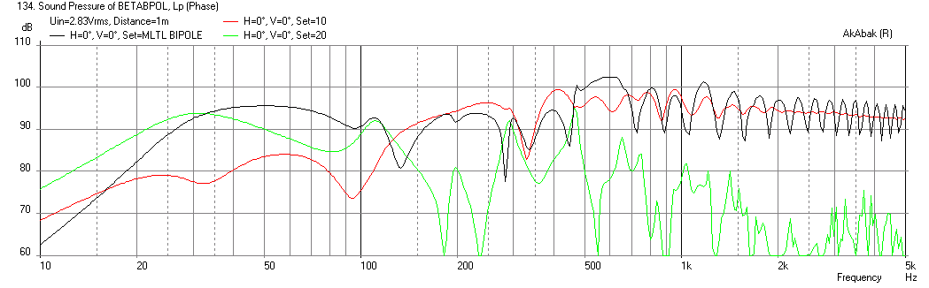

If I take the same 10.5 in wide x 22.5 in deep x 54.5 in tall cabinet but mount the drivers front and back at 18.5 in from the top in a bipole push-push configuration with a big floor-firing vent (5 in x 8 in x 3.5 in long) with a 4 in gap between the speaker and the floor, here is what I get for the frequency response. The bass at 20 Hz is now in the low-mid 80 dB range. There is a dip at about 130 Hz though and bump at 600 Hz. I will try to optimize this some more, but this is interesting.

Room interactions are important which is why my sims include the reflections from the floor and back wall and I place the speaker at the location recommend by the reviewer or manufacturer. Speakers meant to be placed next to a wall often work poorly away from a wall and vice versa. From my simulations, the speakers with the best performance away from a wall are the bipole and the Karlson K15. The K15 has the ability to efficiently throw a flat bass shelf from 50 Hz to 150 the farthest with highest SPL compared to any other design. I can use a 95 dB 8 in driver and it will have a flat 50 to 150 Hz bass shelf 5 meters away for 1 watt input even when placed 5 ft from back wall. It doesn't have deep bass but much of MUSIC can be enjoyed without HT style bass rumble in the 20 to 30 Hz range. See the Speaker that Kicks Butt in Large Spaces thread if you are interested in this.
