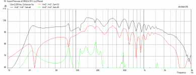

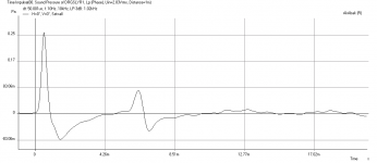

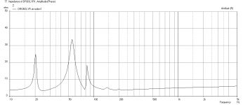

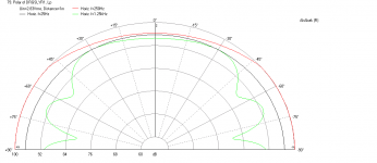

Presenting The 'Dragon Slayer
I have a design that utilizes dual Beta 10CX's in a cabinet that is a bit out of the box in aspect ratio so it won't resemble the slender tower of the Pendragon. However, I think the predicted performance is quite remarkable. Let me know what you guys think of this performance and I will reveal details of the speaker cabinet later. The design is 60 in tall x 20 in wide.
The first plot is the frequency response with the baffle placed 4 feet from a back wall with the mic at 1 meter away and with a 2.83 volt input. Notice the deep bass extension to 20 Hz (90 dB) and an average of 95 to 98 dB up through the range to the X-over point of about 1250 Hz. Although this can easily be crossed at 2500 Hz as recommended by Eminence for the Beta 10CX.
The second plot is the electrical impedance of the drivers. If you know this characteristic triple peaks, you will know what type of alignment this is.

The fourth plot is the impulse response which shows a clean secondary pulse at under 8 ms which will means that there is minimal audible group delay.
The fifth plot shows the polar directivity of this speaker for 25 Hz, 250 Hz, and 1250 Hz which is very wide angle at the upper end of the X-over to the tweeter at 1250 Hz. The sweet spot is almost 90 deg wide and lobe-free.
