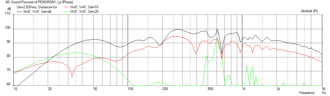

xtra-cool - Delta 10 are punchy little drivers. If the LCR "m" part network at the Zoebel center junction is omitted, does some of the D10's sharp peak creep back in the summation? what was the woofer enclosure and tuning on this project?
Woofer
Impedance EQ
Req = 5.6 ohms
Ce = 12 µF
Rm = 0.22 ohms
Cm = 1.2 mF
Lm = 5 mH
Woofer
Impedance EQ
Req = 5.6 ohms
Ce = 12 µF
Rm = 0.22 ohms
Cm = 1.2 mF
Lm = 5 mH

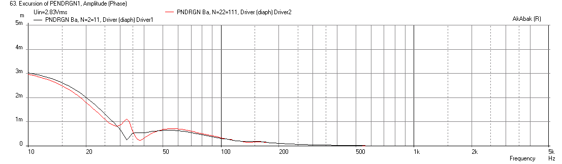

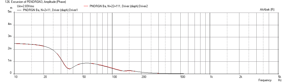

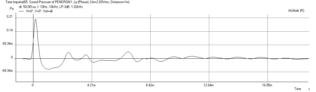

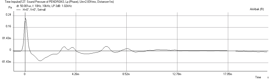

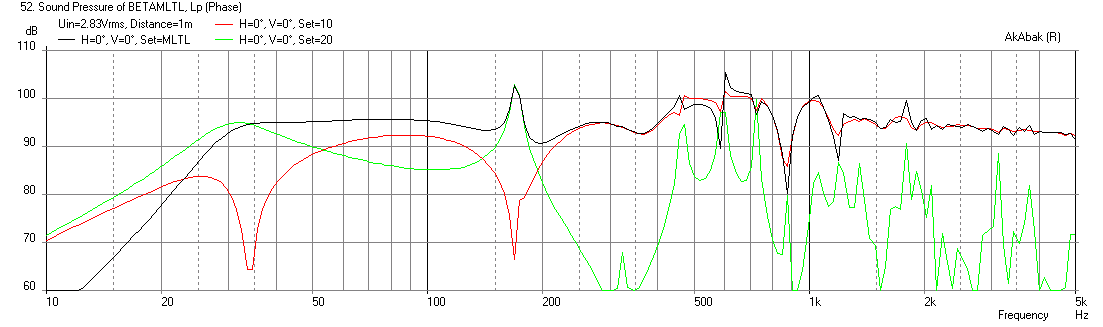

I can redo the sim with the Delta 10 but it looks like a mid bass with higher fs. Very efficient though.

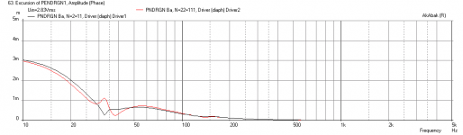

Maybe with a Dayton PA255-8?
Any idea of how this cabinet would work with a Dayton PA255-8?
Pretty similar specs, a bit more xmax, and ~ $26 less.
Thinking this might make a pretty fun HT. The saved $26 could add a bit to the tweeter and x/o budget.
(Fs)46.4 HzDC Resistance
(Re)5 ohms
(Le)1.33
(Qts)0.48
(Vas)2.08 ft.³
(Cms)0.35 mm/N
(BL)9.8 Tm
(Mms)33.6g
(Xmax)5
(Sd)346.4 cm²

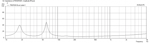

The dimensions are here http://www.diyaudio.com/forums/multi-way/224770-eminence-coaxial-towers-6.html#post3586283
12 in wide x 11 in deep x 45 in tall with 4 in dia x 5.25 in long vent. Driver at 11 in from top, vent 6 in from bottom.

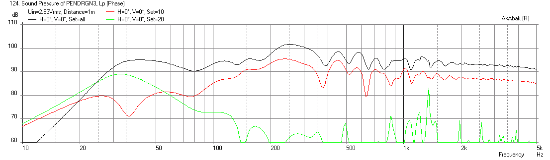

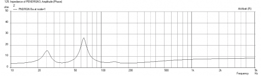

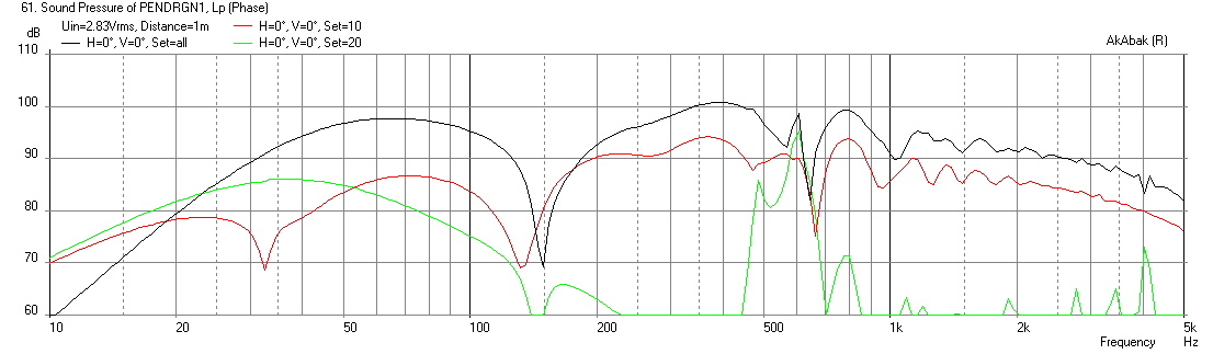

Bringing back a bit of a ressurrection here...but did the Dragon slay the Slayer or the other way 'round?! Enquiring minds and all that malarkey... Did anyone build a model?

I think the Dragon has been sleeping for a while. Is somebody waking it up? Audio Elite was looking to build this, maybe? I have since moved on to the tractrix synergy.
- Slay the (pen)Dragon?
