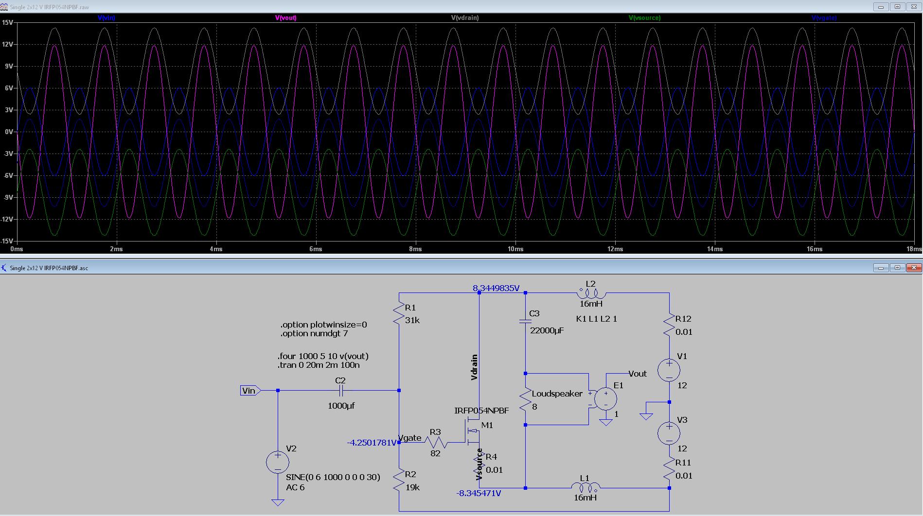

I also now get how why an input voltage that would have resulted in a lower voltage than the Vgs actually doesn't.
The difference between Vgate (dark blue) and Vsource (green) is always above Vgs in this simulation.
Should I increase Vin then there's clipping.

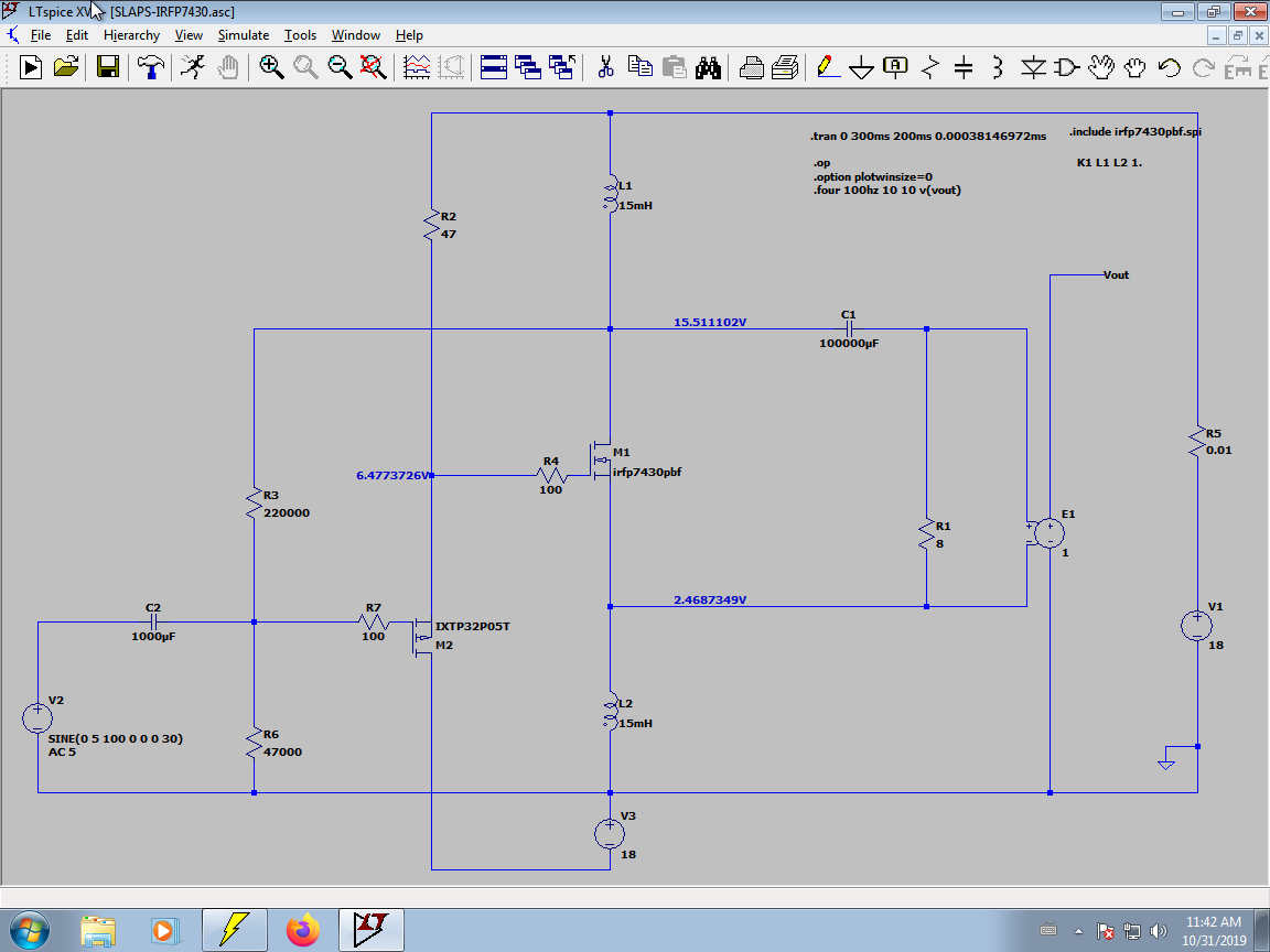

My first try on having a DC coupled input is to let the bias voltage be included in the preamplifier opamp as one of two inputs to the summer opamp.
The other input being the signal of course.
So the input capacitor is not needed and the output of the op amp can in principle be connected directly to the gate.
Any thoughts on this?

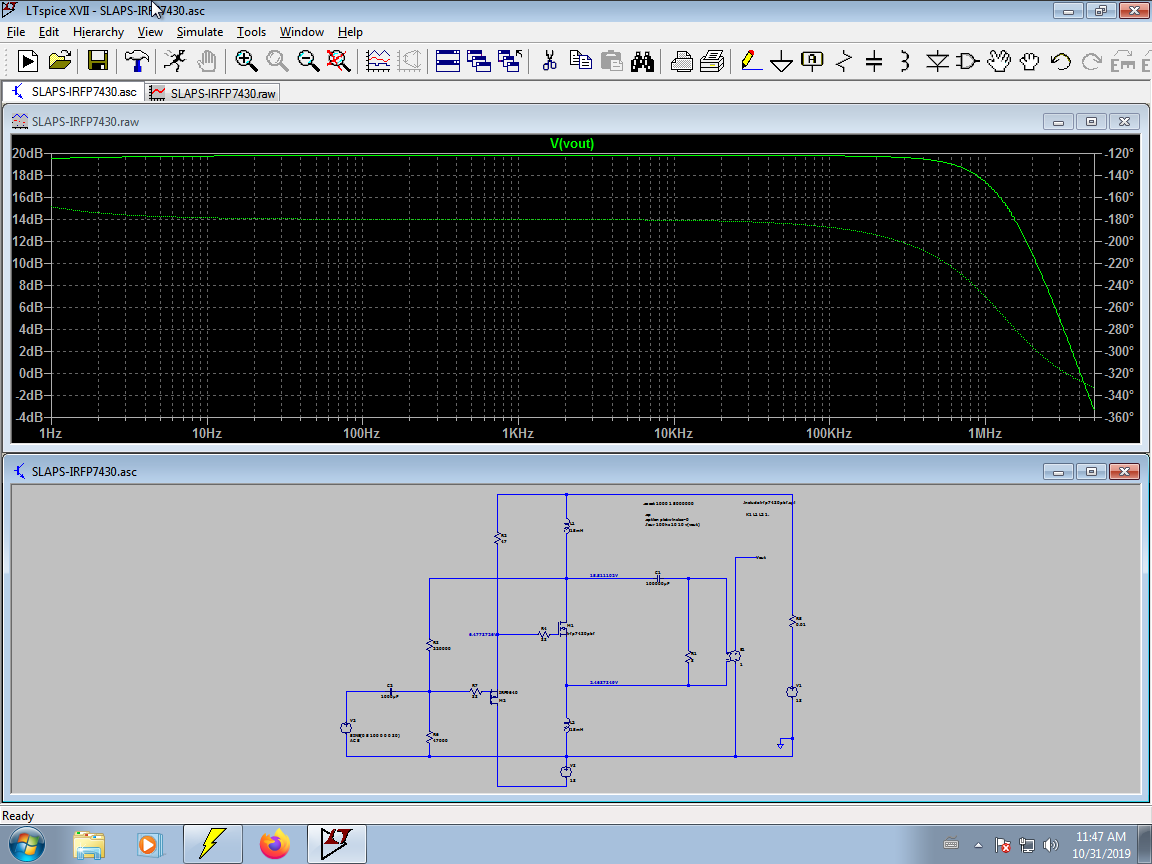

Seems fast enough. Here simulated with an IRF9640.
Great, then I'll know the target for the additional capacitor addition.

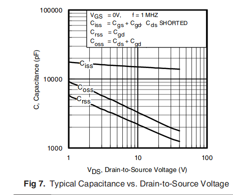

The difference being that a fixed capacitor has a given value but the gate of a MOSFET is very nonlinear. The gate capacitance is highly variable dependent on the voltages and currents trough the device.
The gate capacitance of an IRFP7430.
Aha, but for a given Vds I can then actually simulate with external capacitors.
But then again, why bother - better to actually measure with the multiple MOSFETs in place.

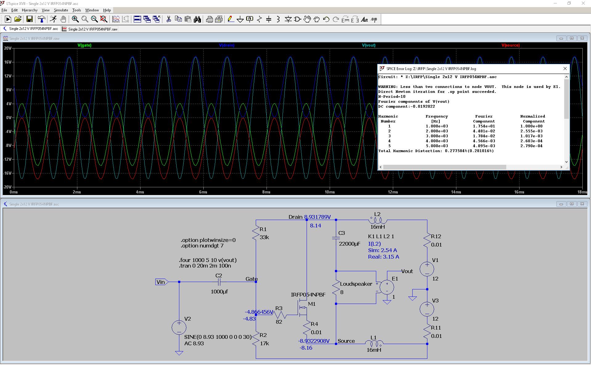

This is how the single IRFP054 simulate with an input voltage that brings the amplifier to the verge of clipping.
The DC GDS voltages are marked, both the simulated and the real.
Vpp is about 35 V, so that would mean a output power of about 19 W.
THD is rather high though.
In the real amplifier, I get clipping at an output voltage of 23 Vpp.
That is an output power of 8.3 W.
But that is due to that the pre-amplifier clips the input signal at -12 VDC as it is asymmetric around the bias at -4.83 V.
Increasing the input level even further, I get clipping at the positive at 32 Vpp output.
So it is a trade off, I can get as much as 16 W if I scrap the idea of having the bias via the op amp summer but then I need the input capacitor.
On the other hand, do I really need 16 W at a probably rather high distortion level?
Anyway, I'd say reality verifies the simulation.

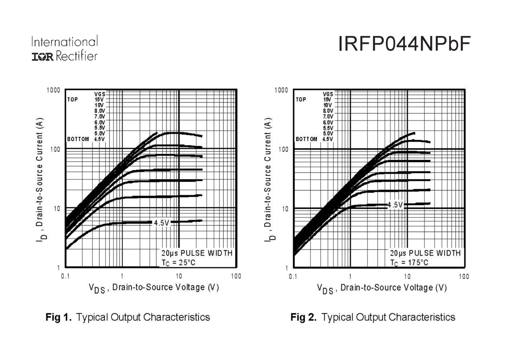

Your math is probably right, but it is a bit optimistic according to my experience.
I would not run more power through the mosfet then 30 watts of continuous dissipation for any prolonged period of time. It might take more power but it is pushing the luck a bit. If you have enough spares and don´t mind swapping out the device from time to time then you can probably run 50 watts of continuous dissipation or so.
The transconductance seems to decrease at 175 degrees C compared to 25 watts. The transfer curves does not show the area around the operating point of the device in your amp, but the general trend seems to indicate lower transconductance at very high temperatures.
If you really want to run 4 amperes of continuous current then you should parallel 2 or 3 devices with a small source resistor on each device.
