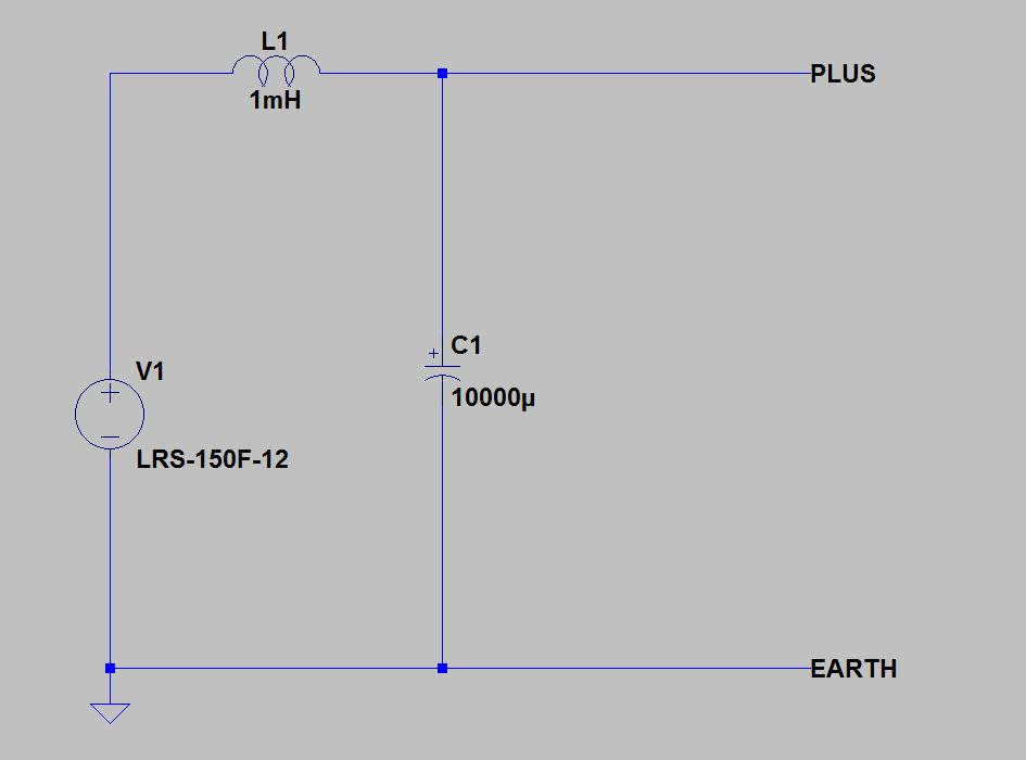

I have now tried:
- to supply the op-amp via 7812/7912,
- a direct bias voltage from the +/- 14 V rails,
- and a single 28 V SMPS.
The first two made no change, the third reduced the inter-modulation as expected but not the actual noise level itself.
Measuring with digital sound level meter as close as possible to the speaker, I get 34 dBA when the amplifier is off, and 37 dBA when it is on.
With an ordinary DMM, I get 1-2 mVrms across the speaker terminals.
It is of course not measurable at sweet-spot but still audible, or rather noticeable when I shut the amplifier off.
I reckon I will have to live with this. After all, the computer in the another room makes more noise.
A pair of these for each double supply or a single coil for single supply should minimize noise very effectively.
1 mH 0,8 mm diameter magnet wire cost 53 kr at Hifikit.

There are a couple considerations for using a swmps
1) Generally products have only one polarity, so you have to get 2 to make
a bipolar supply. When you use two supplies, you may find yourself listening
to a beat frequency noise coming out of the speakers which is at the
difference frequency of the two switchers. It wanders around in frequency.
This leads to:
2) You need to filter the rails for the noise out of the switchers, and you
usually can't just do it by sticking big capacitors on the rails - some
switchers sense the high current at low voltages and decide that there is
a short. Others will limit the current until the caps are charged. A strong
possibility is to make a follower filter with a cap multiplier which filters and
has a low current at initial turn-on, but you will give up a couple volts
doing it.

So we got a proper name for it: beat frequency.
And, the self-made coil that you suggested earlier Circlomanen of 2 times 10 m of 1.5 m2 bifilar coils between the +/- SMPS and the filter capacitors works!
Still a audible hiss close to the speaker, but not detectable beat or hiss at sweet spot.
A lot cheaper and a lot lower resistance.
And a lot bulkier too!
But as we say at work: "It's not a bug, it's a feature."

Got the remaining chokes ready and mounted. Did a quick listening and thought something wasn't right.
Then I realized that the bias must have changed when I added the chokes as the voltage drops half a volt or so at both ends.
So I re-trimmed the bias but now at a input level for 4 W out.
And I found out that the span for the bias is quite small - only a couple of hundred millivolts.
I also found that the bias is individual for each SLAPS.

Hi solhaga,
Its easy to understand your enthusiasm for the giant bifilar air-core coil in the Source and Drain legs since it directly affects the sound quality. But for the hash on the SMPS-supplied rails, wouldn't a much smaller pot core, or toroid, or even a simple coil wound on a ferrite or iron powder slug be just as effective? and have lower DCR and be a lot less susceptible to external and internal EM fields?
There's no need to be concerned about supply noise to the op amps -- they have many 10's of dB of PSRR at any frequency of interest, whereas your output stage has practically none.
However the op amp bypassing needs adjustment. Earlier you mentioned that you had 100 nF rail-to-rail, but not including ground. Instead (or in addition to), each rail should have its own cap to ground, both for stability and to provide the current it'll need to drive the highly capacitive MOSFET Gate.

I had already tried that, didn't help.
Well, there are opinions here. Maybe I misinterpreted this one.Hi solhaga,
