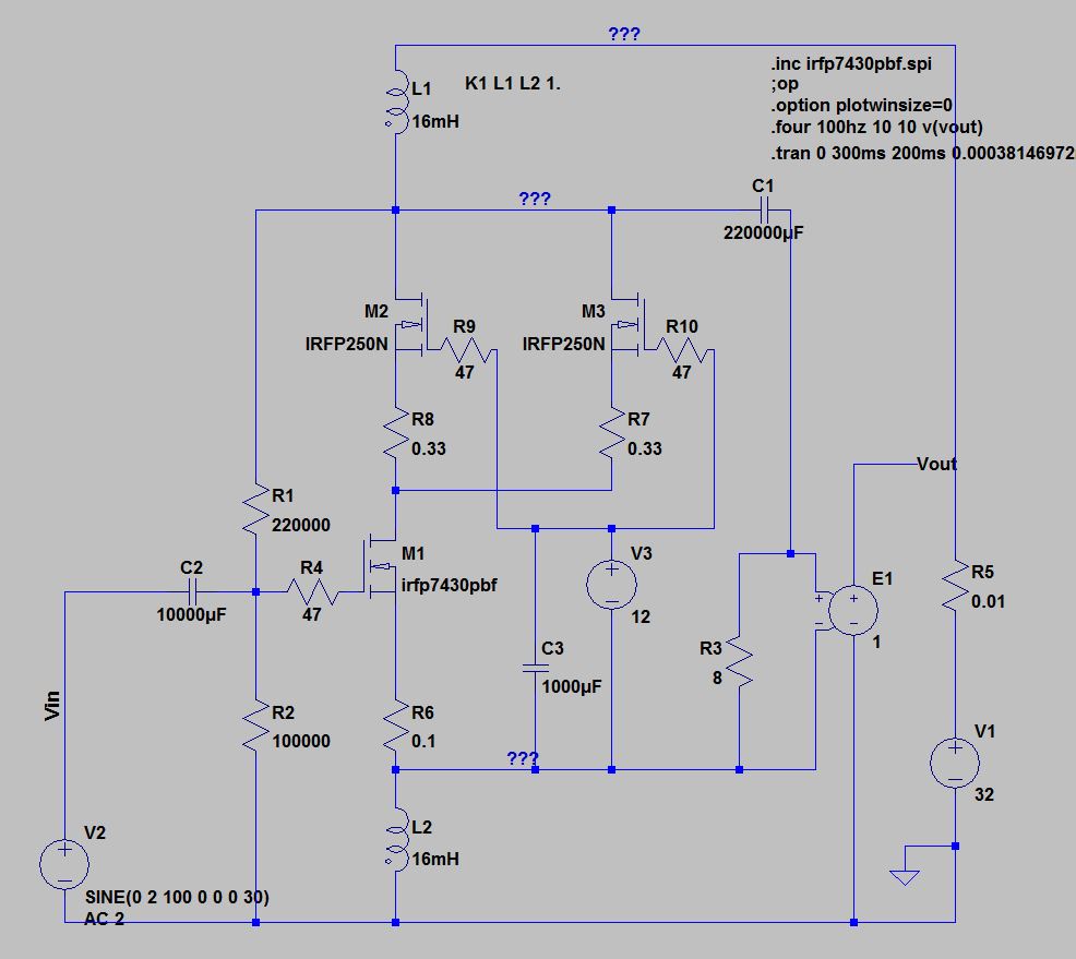

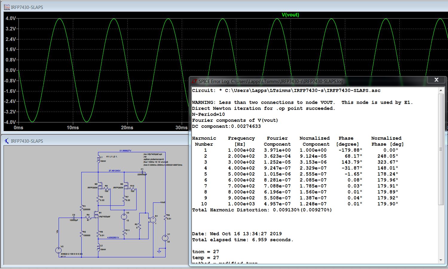

Yes, here a simple circuit I made only for you 😉
It is running in AB/C Bias and a simulated performance of ~ 0.002% THD. Easy to change to pure AB and much better THD, if required.

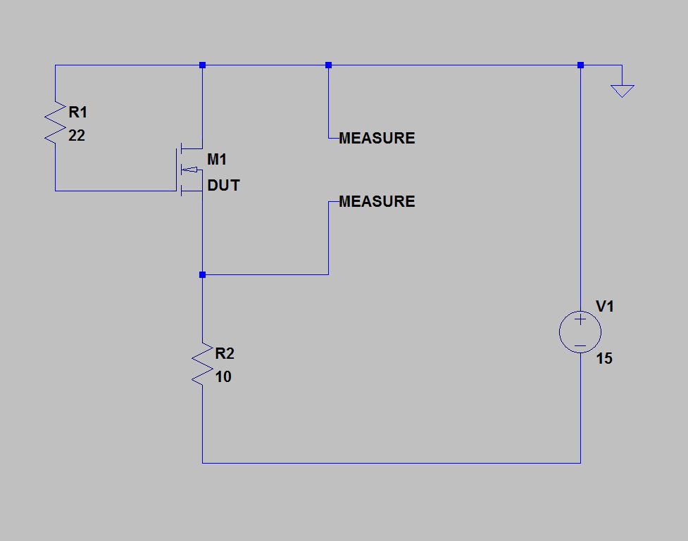

http://www.firstwatt.com/pdf/art_matching.pdf
A simple way to get a close enough matching of devices.
This is the way I measure the Device Under Test. I monitor the current draw on my lab power supply and the Voltage over Drain to Source with a multimeter.
Remember to clamp the devices to a heat sink.

I would use something like one single IRFP7430 and three matched IRFP150 per channel as a starting point. I have not built a cascoded split load phase splitter amp so it is only a guess about what should work well.
I would encourage you to build a simple single device version first to test the general idea. I believe the simple non-cascoded amp would sound very good driving your impressive high resolution AMTs and hopefully better then your previous amps.
The cascoded version is meant as a potential future way forward if you want to experiment with some wild ideas. Casoding does change the sound character quite a bit. But there are some pitfalls to. Cascoding can be prone to HF-instabilities which can be hard to detect in steady state measurements.

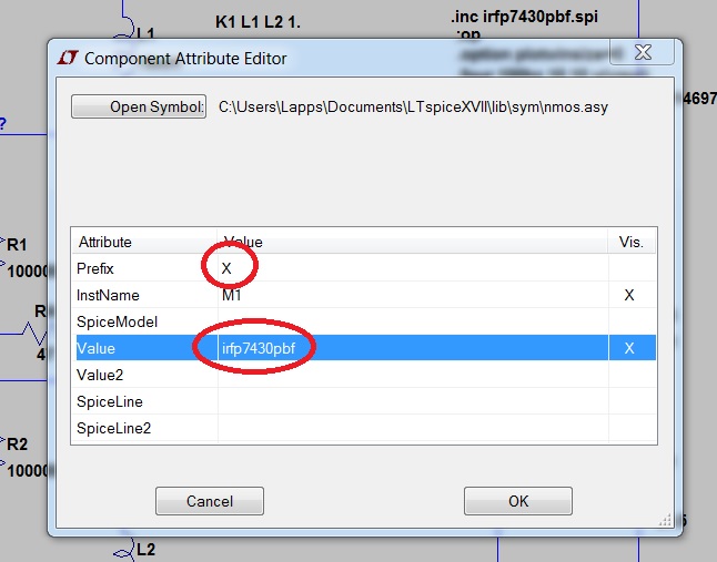

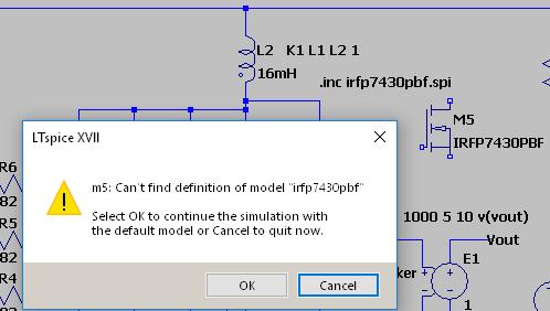

An LTSpice question.
I've downloaded the irfp7430pbf.spi file and placed in the same directory as the simulations, but LTSpice can not find it.
Any suggestions?
Any suggestions?
Yes it worked. Now I can simulate the cascode.
