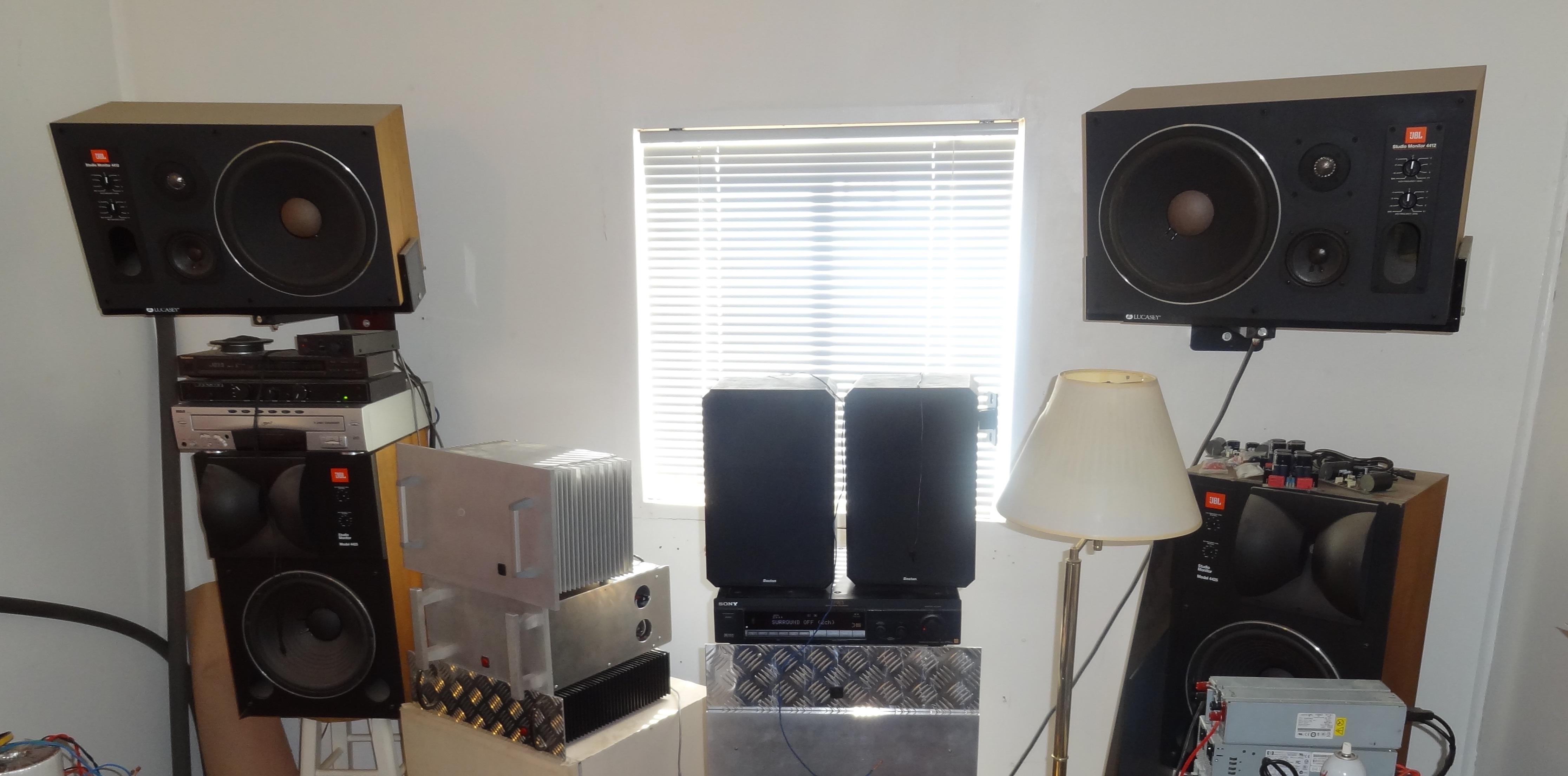

I'm sorry if I wasn't clear. I have no favorite when it comes to the sound. IMO, all of the better ones are so close to each other that any of them could be someone's favorite amp. The Slewmaster is more a format than an amp per se. It was designed as a base to test and compare different topologies, mainly CFA vs VFA, but it has become way more than that. To date I think we have something like 7 or 8 different IPS and at least 4 different OPS sections. A DIYers dream if you ask me. I'm not sure if I would recommend it to someone who only want to build one amp. It takes up more real estate that most of the other amps because of the 4 boards required. I would definitely recommend the Badger. It has great support, a nice instruction manual and will accept a wide range of parts. I think the chances for success are very good with that amp. The SKA is a little tougher to get right. Some of the input section BJTs are hard to come by and the outputs need to be matched. I built two pair of the SKA. One with all expensive caps and the other without. I would defy you to hear any difference. As for my speakers, I have a pair of JBL 4412, a pair of JBL 4425 and a pair of Event 20/20 nearfields set up in my room. Each of them have their own "color". They were each designed as studio monitors so though they are now called "vintage" the fidelity is excellent. I'm attaching a pic showing the JBL' as they are set up.

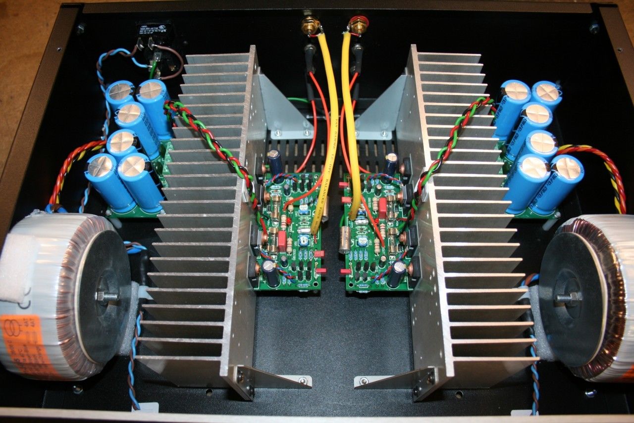

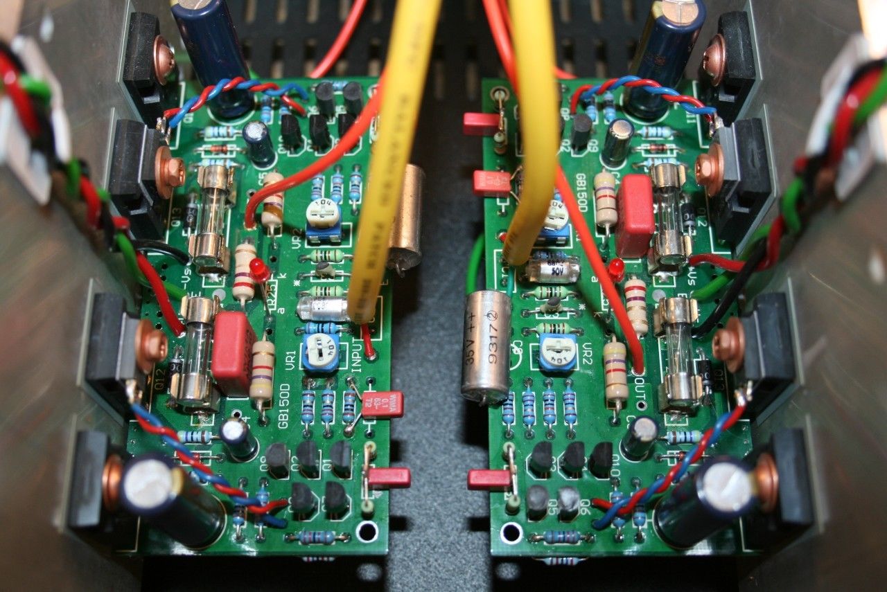

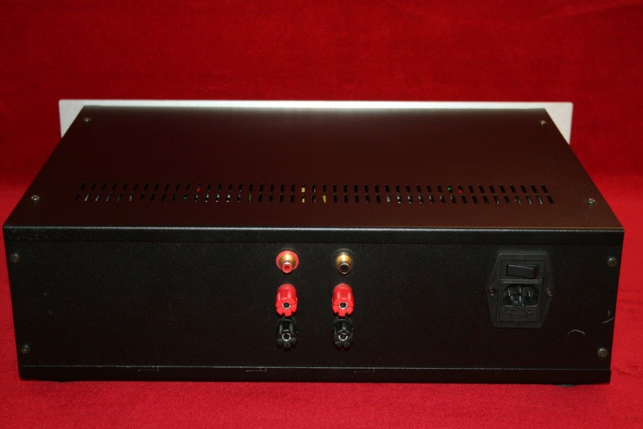

Hi
I just bought an SKA GB150d..I'm a relative novice on DIY power amps but having read some reviews I took a chance and bought this beast
Having a few probs at the moment with the left amp but will soon have it resolved
Here are some pics of the build..Would welcome your views on the final construction..Looks very clean to me
Wondering how the GB150d will cope with the Martin Logans even though Greg says it can cope well ..does anyone have any experience in driving electrostatics like the Martin Logans ..🙂
Thanks in advance

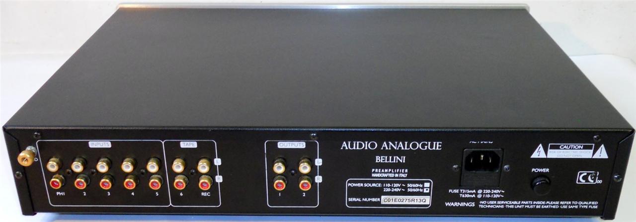

BTW My system
Pre amplifier..Audio Analogue Bellini
Power amp A&R Cambridge SA200
Martin Logan LS3 electrostatic speakers
Thorens LP deck
Marantz 6005 CD

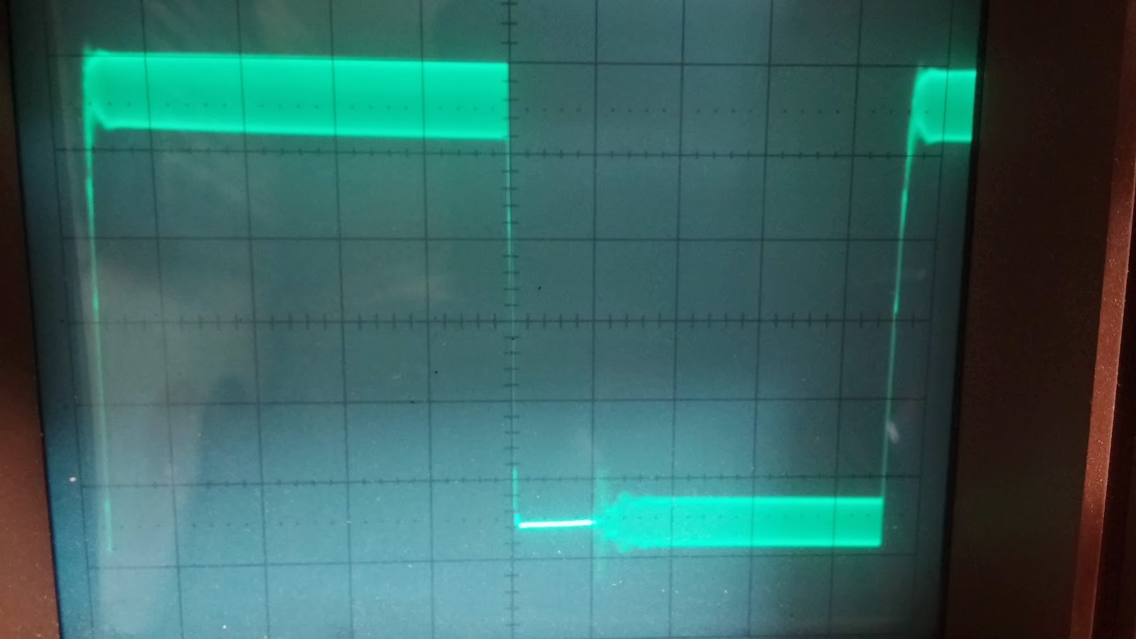

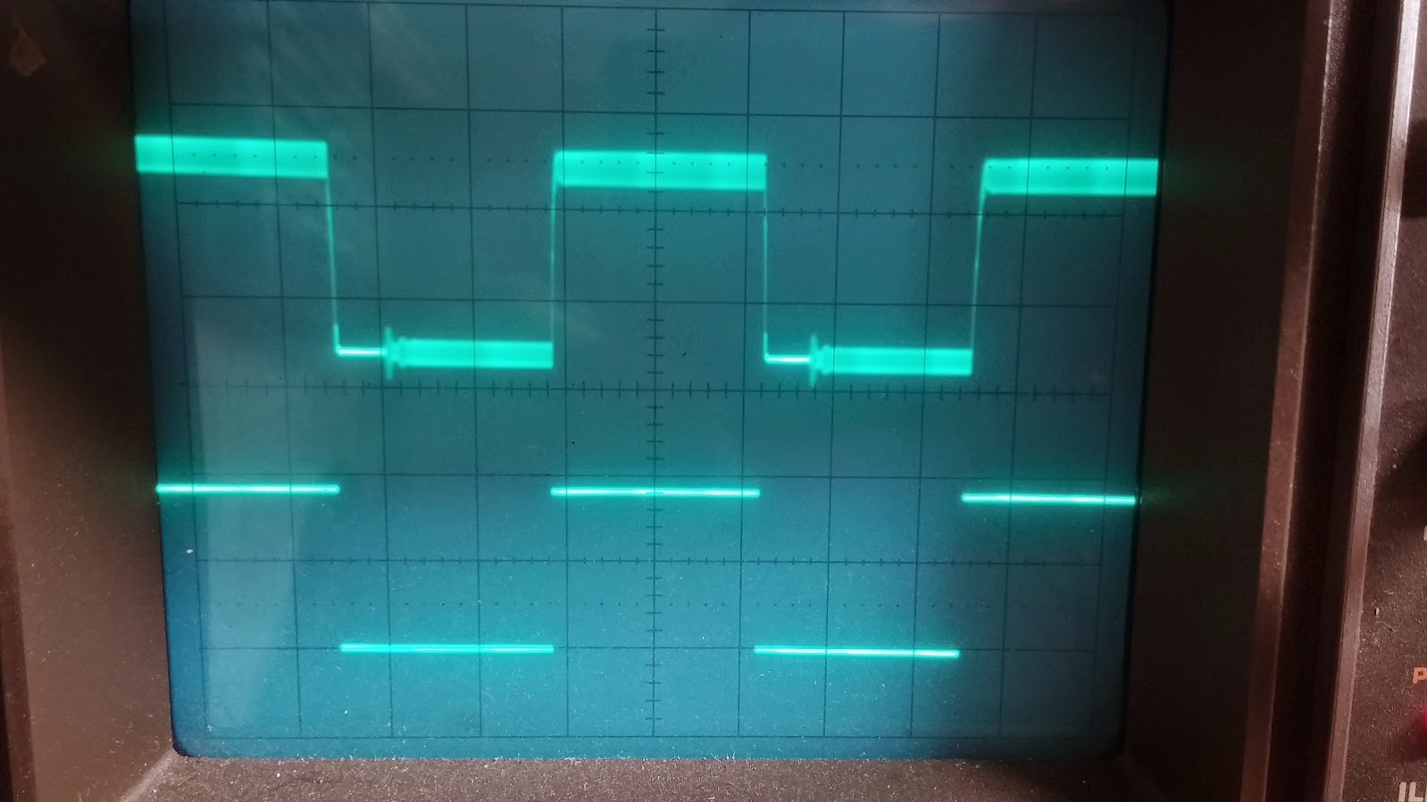

guys, I found some kind of problem on my amp... sine is perfect, but square have some kind of modulation???? any idea?? it's at 10kHz... same for both channel
