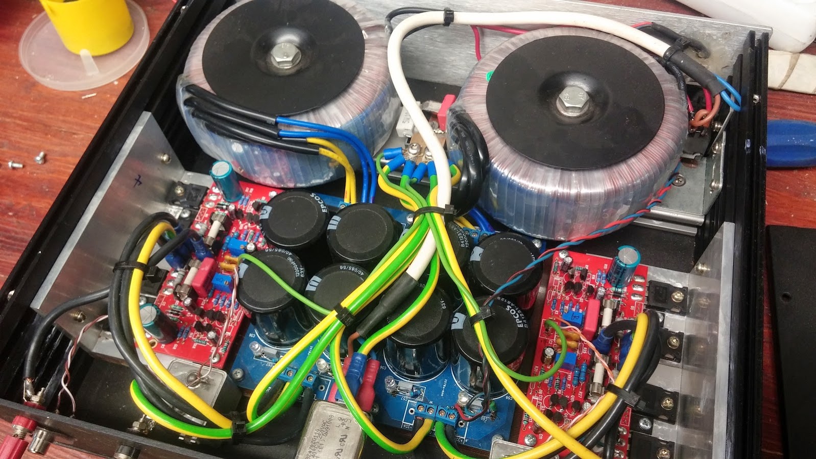

Did you run a wire from the input ground to star ground? For some reason the lifted ground causes problems with oscillation.
Indeed it does. I had to re-layout my own pcb (similar design to SKA) twice before I had a solid design.

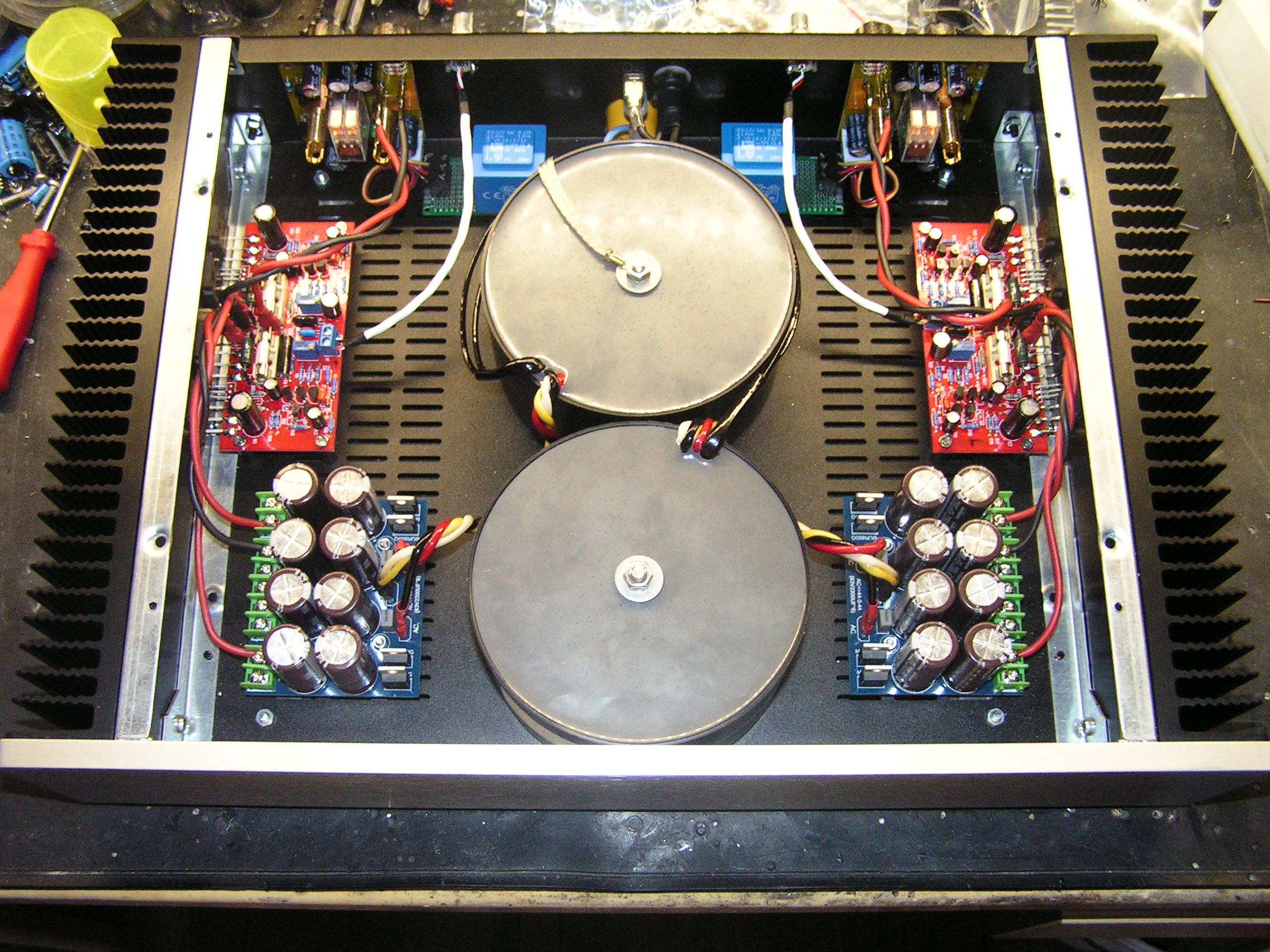

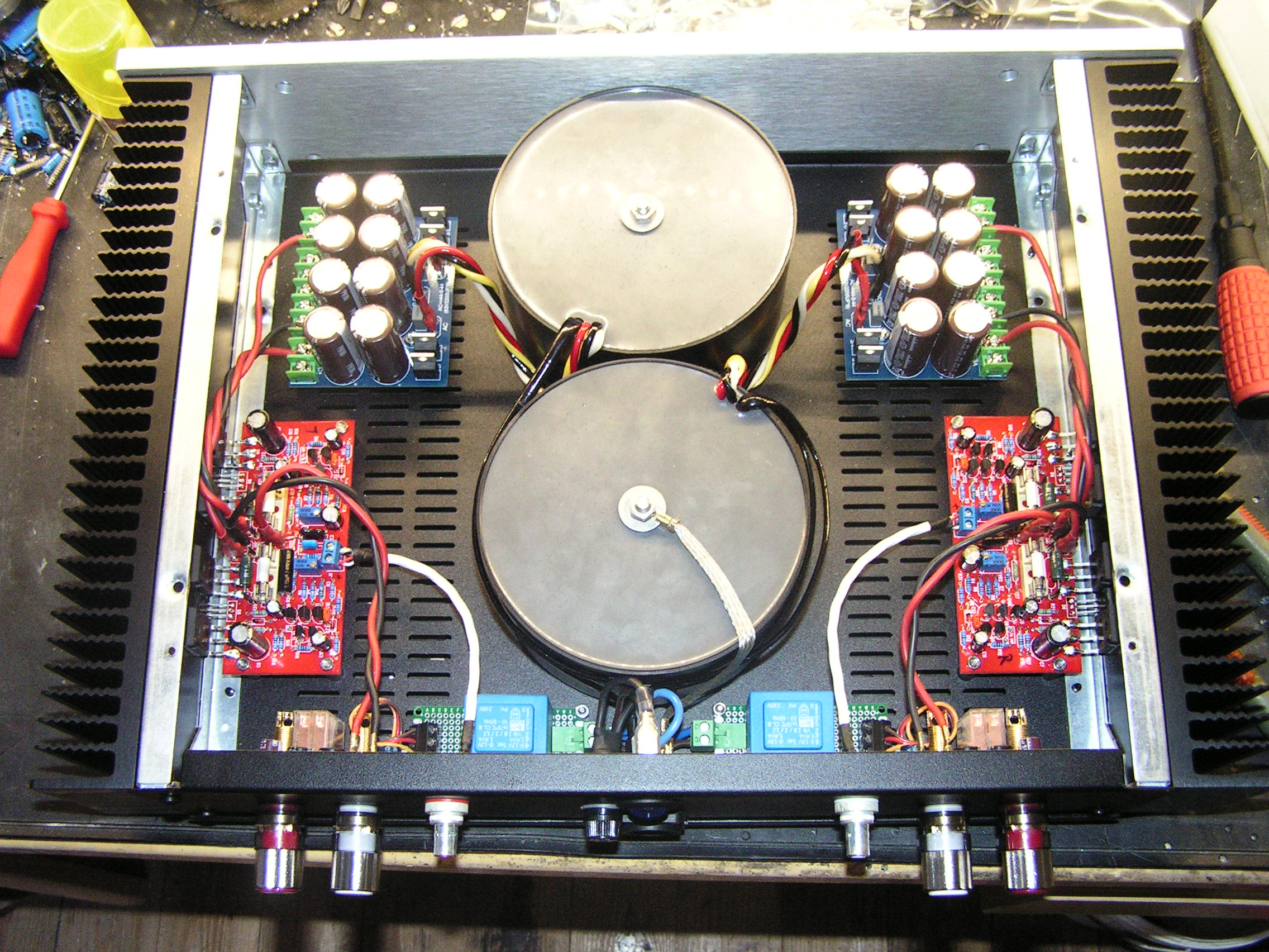

It' s finished
Works very well, Bias is about 15mV at the 0R15 resistors (0,75V at the 10R test-resistors).
Double mono built with finest components.
Sound? Incredible!
It drives my 3/5a + AB1 like no other amplifier i've ever tested...
I'm very glad and happy to built this amplifier. 😀

That's a very nice build you have there! Congratulations! 🙂
The GB150D is one of the very best amplifiers I have build/listen. I use 150mA bias (1.5V across the 10R testing resistors at the fuses). It sounds a little better to me 😉

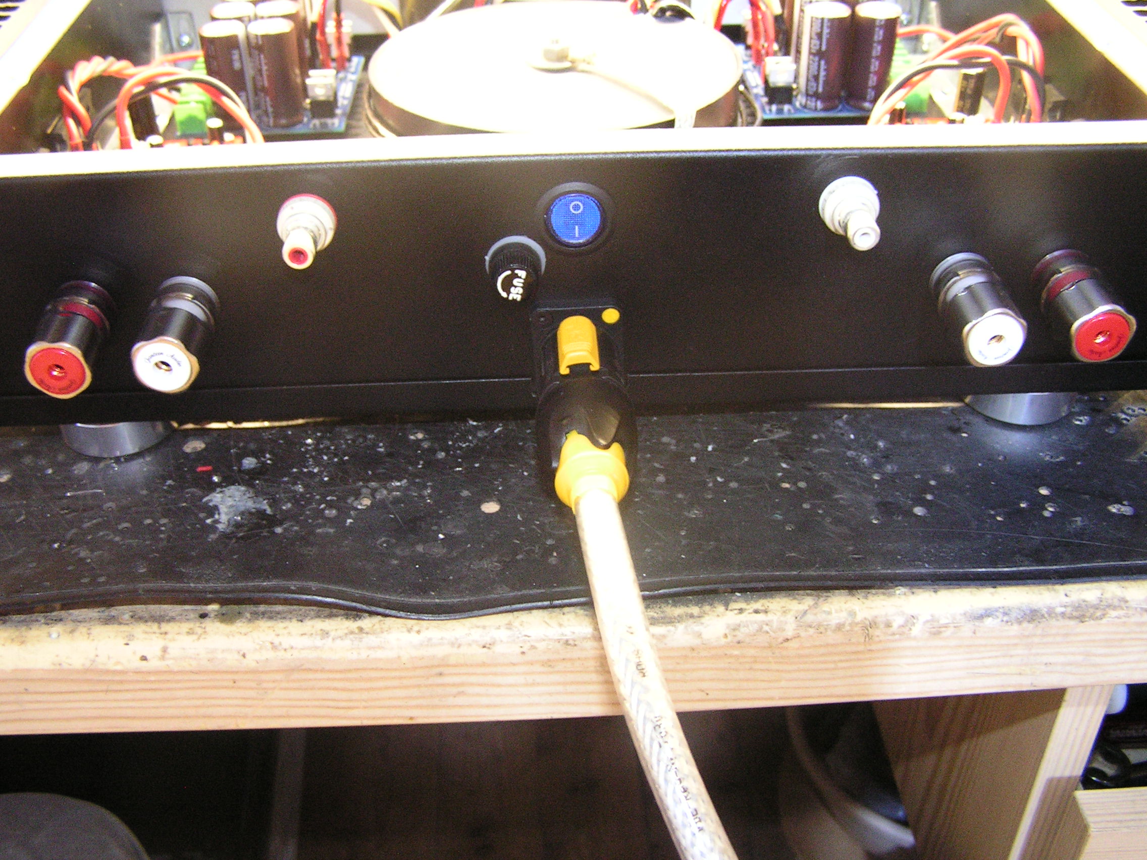

RCA= CMC 805-2.5AGWhat kind of connectors are those at the back?
binding posts = Jantzen Audio
230 VAC socket = Neutrik NAC3 powerCon
