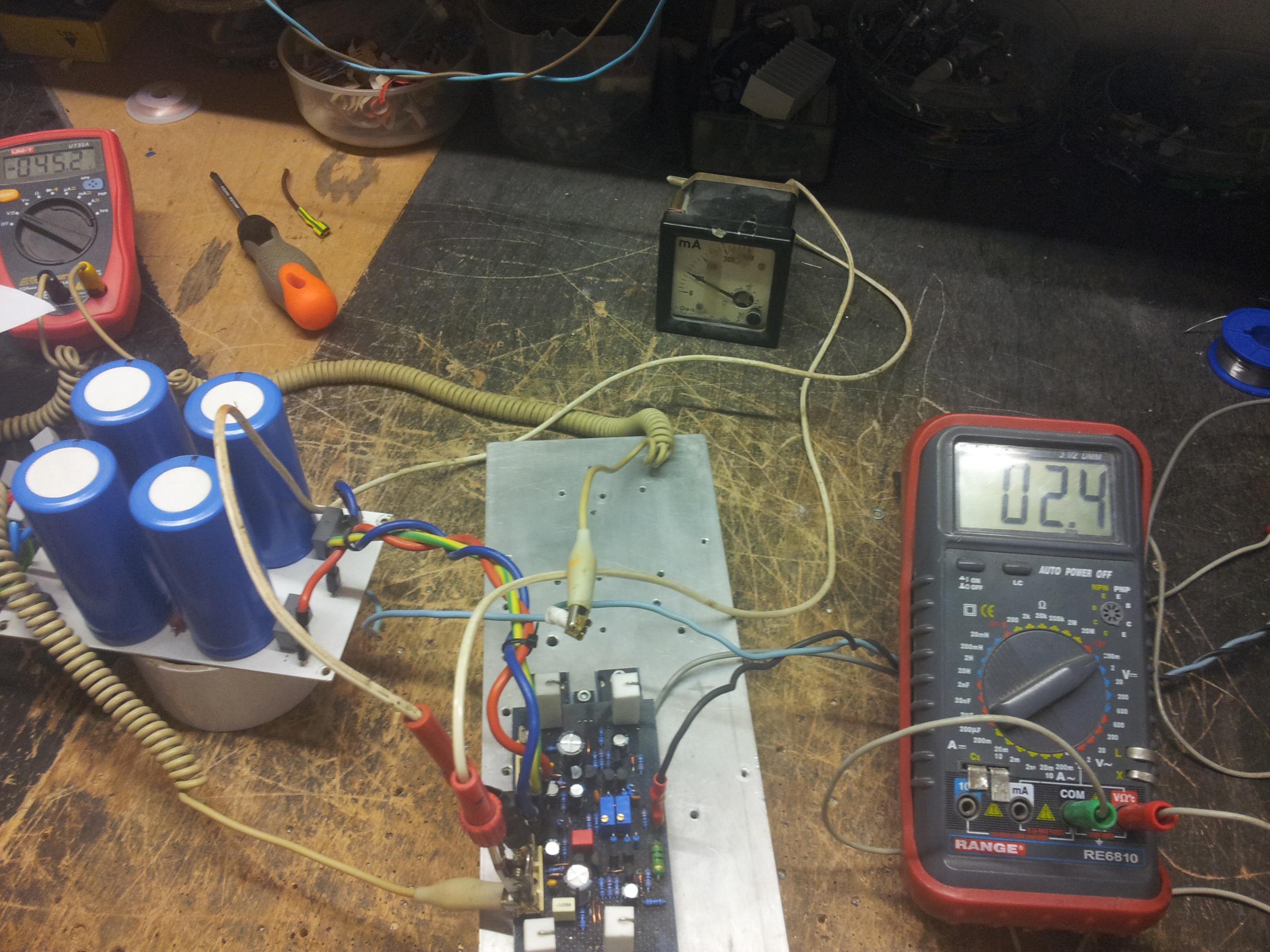

My KILLER AMP.Borys Thanks.Tomorrow sound test.

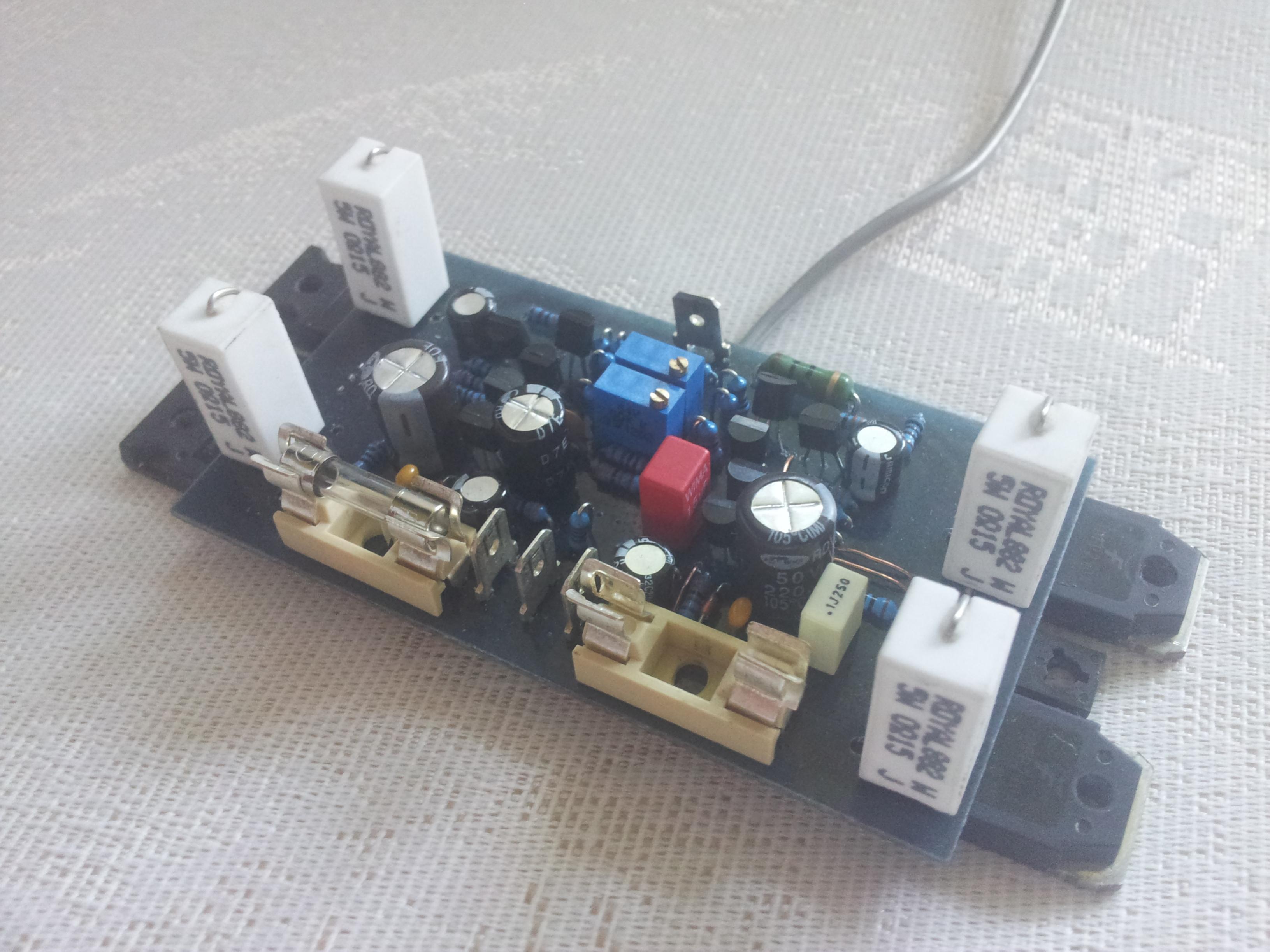

Here are the BOM and the schematics for Jim's Audio PCB.
Those who are building this amp with Jim's boards should follow this BOM because there are diferences to Greg's boards.
Please use 2SC2240BL/2SA970BL and don't forget the signal ground wire from input to main star ground. Jim forgot to place a hole on the board for this connection.
Paulo.
Forget the schematics! Too late for editing... The input pairs are wrong on the schematics. Q1,2 should be 2SC2240BL and Q3,4 2SA970BL. Everything else is correct. Please use only the BOM for parts.
Thank you platon.rado for noticing the error.
