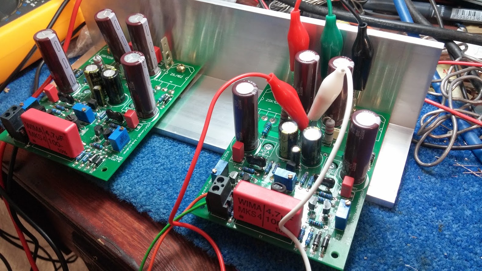

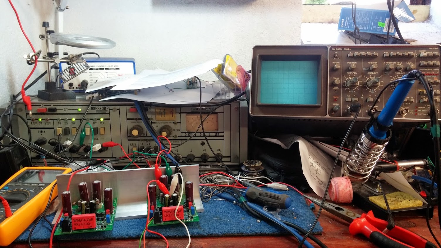

.... I checked again about disconnecting the extra ground wire and I get instant oscillation with both channels connected. So to test my theory I soldered jumpers at R14 and the oscillation is gone even without the extra ground wire. Sorry, but I'm not going to chance bypassing the NFB cap. I could probably do it in the amp that is in the case because it has a speaker protection circuit but I think I will leave well enough alone. It sounds fine like it is. Maybe if it were my only amp I would look into it, not sure.
You have just confirmed my findings about R14 ( in my case it took me a little while to figure it out...) . You should probably at least put a small value (2.7 ohms) like I did to have this ground lifted from power gnd...
I believe that an input cap has been reported more "harmful" to sound than a properly chosen NFB blocking cap...
Fab
I suppose I could try a smaller value resistor in R14 but with the 10R in there that oscillation is instant once both channels are connected to the source. Paulo's fix is to send an extra wire directly to the star so there is no lifting there.
The schematic that Paulo posted says to use a link for C1 if the source has no DC and to use 1-5uf if it is present. No where does it suggest bypassing C9. I also see that he uses R14 to lift the ground. The extra wire to star must have been a fix he came up with later. There is no mention of it on the schematic. I'm just going to do away with R14 and call it a day. I don't really like extra wires running all over the case.

The extra wire is standard by Greg Ball's instructions.
In a stereo build (not monoblock or dual mono) Greg also advises the use of a 100nF polyester capacitor across R14.
If you want to keep C9 and minimize it's influence in the sound you should also use C1 and fully AC couple the amp. Choose a value that gives a time constant sqrt(2) times greater for the NFB capacitor, so C9 sees almost no AC signal across it. Of course, with a C1 fitted now you have to worry about it's influence in the sound. A good quality polypropylen should not be a problem (Wima MKP10 for example).
