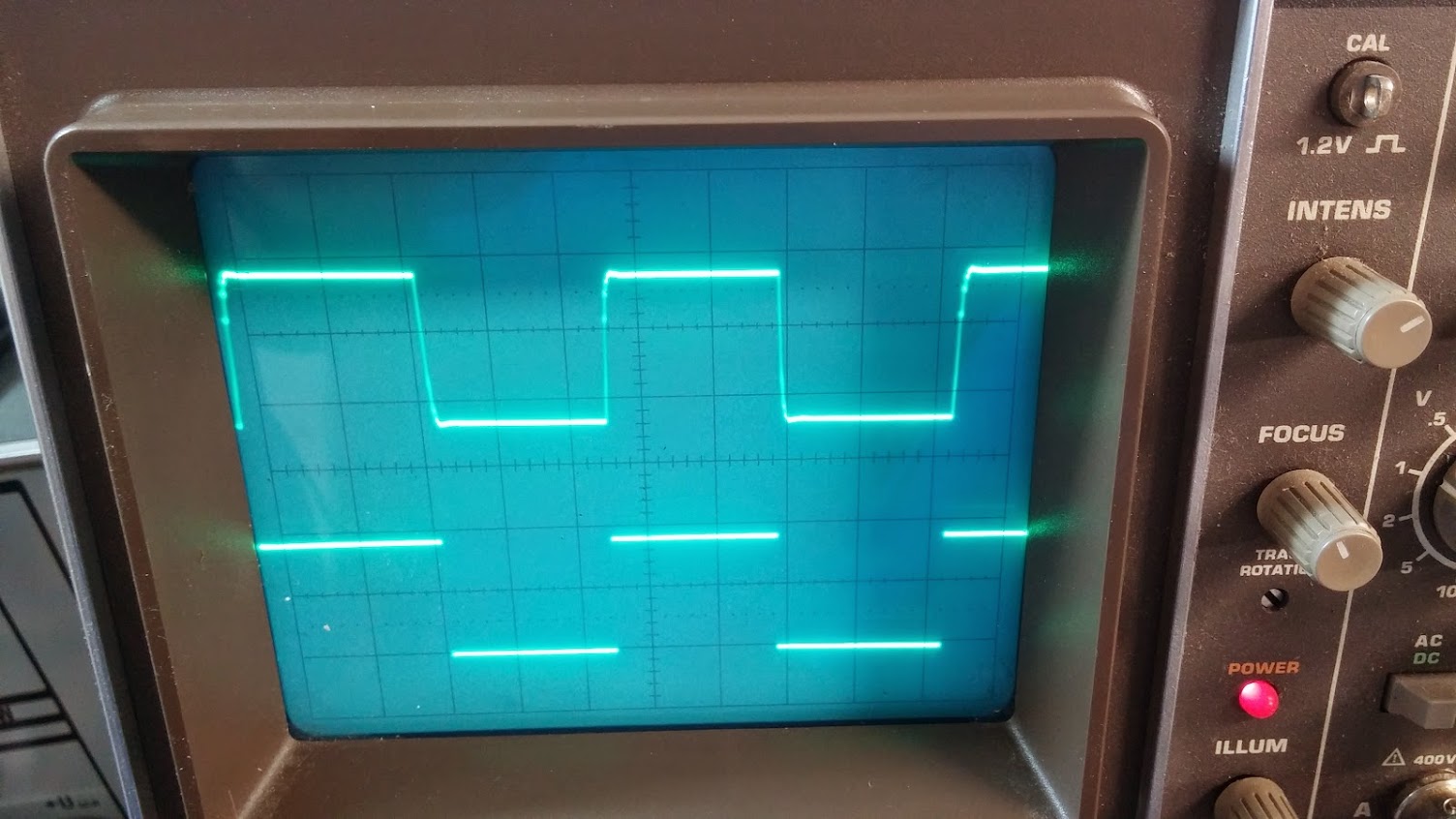

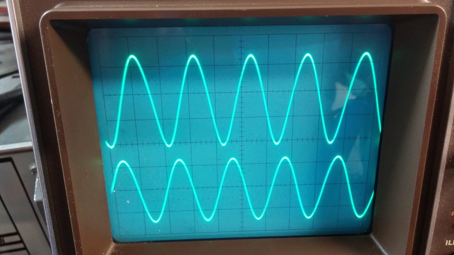

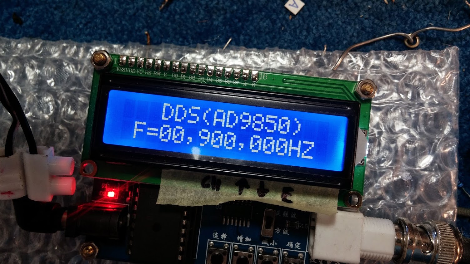

I just came in from the shop. I have two boards sitting side by side on the same heatsink, One set up exactly as Jim's audio schematic is drawn and the other with just C10 & C11 and with 100K in R11 & 13. I hooked both up to the scope and ran square and sine waves from 1k to 100K. No difference. I checked again about disconnecting the extra ground wire and I get instant oscillation with both channels connected. So to test my theory I soldered jumpers at R14 and the oscillation is gone even without the extra ground wire. Sorry, but I'm not going to chance bypassing the NFB cap. I could probably do it in the amp that is in the case because it has a speaker protection circuit but I think I will leave well enough alone. It sounds fine like it is. Maybe if it were my only amp I would look into it, not sure.

So guys, the problem has been solved. Problem was my great volume regulator. Sine 900kHz is still fine, square is on 20kHz also perfect ....
