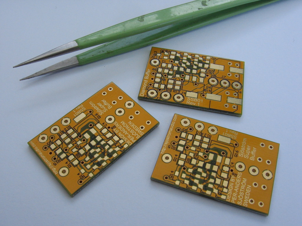

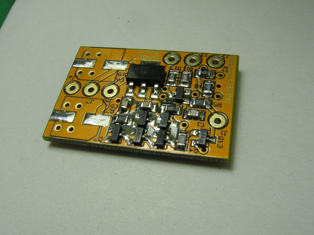

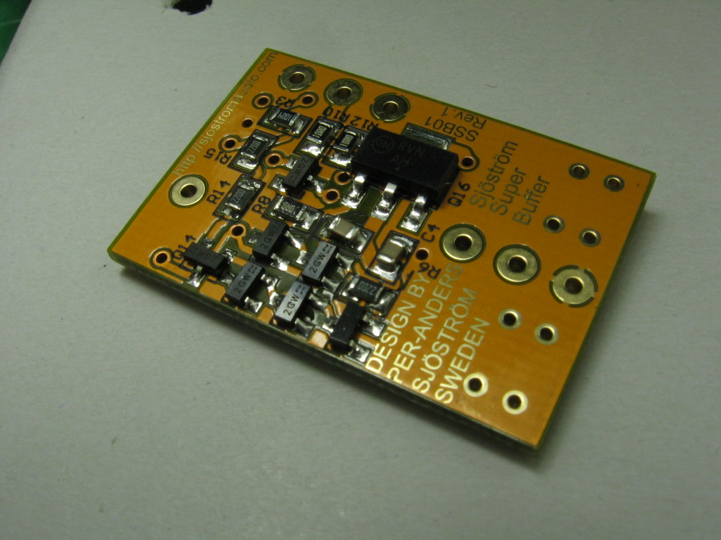

SMD is good therapy. These are very nice boards Per.
Tinitus - I have ordered slightly too large 'lytic caps for C6 and C7 it's an awkward fit. Apologies for this, I may get correct ones in the new year. I would advise soldering C7 inside pin before R7 maybe.
