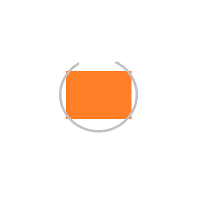

shoot, I had a closer look, and its only 22x32mm ... screw holes would make it twice as big 😀
Perhaps using C-channel?
do you mean like a tube with a piece cut away 😕
ehh, maybe use something with 'slits'
Actually, a rectangle with part of a side cut away. It would probablyh be better to use UHMW edge wear strips for conveyor belt use. You can get them with a 1/8" slit. Make them longer and you can mount by bolting through the ends. Instant standoffs! I may use this approach on my DCB1, and avoid using standoffs entirely.
ah, posted a drawing while you posted
its just ordinary PVC plumming tube
PCB corners fits into drilled holes
question is if there are any PVC tube small enough
