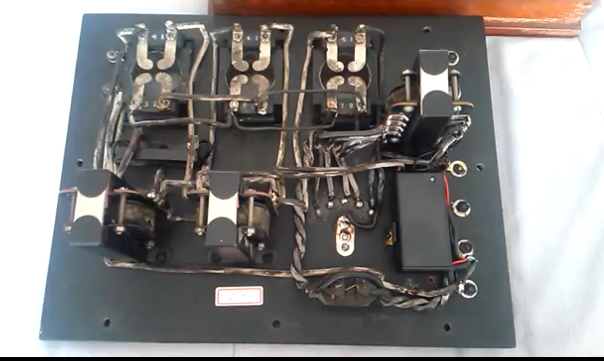

Western Electric 7A
https://www.westernelectric.com/static/library/specifications/amplifiers/7.pdf
Western Electric 7 A part 8
Westrrn Electric 7A part2

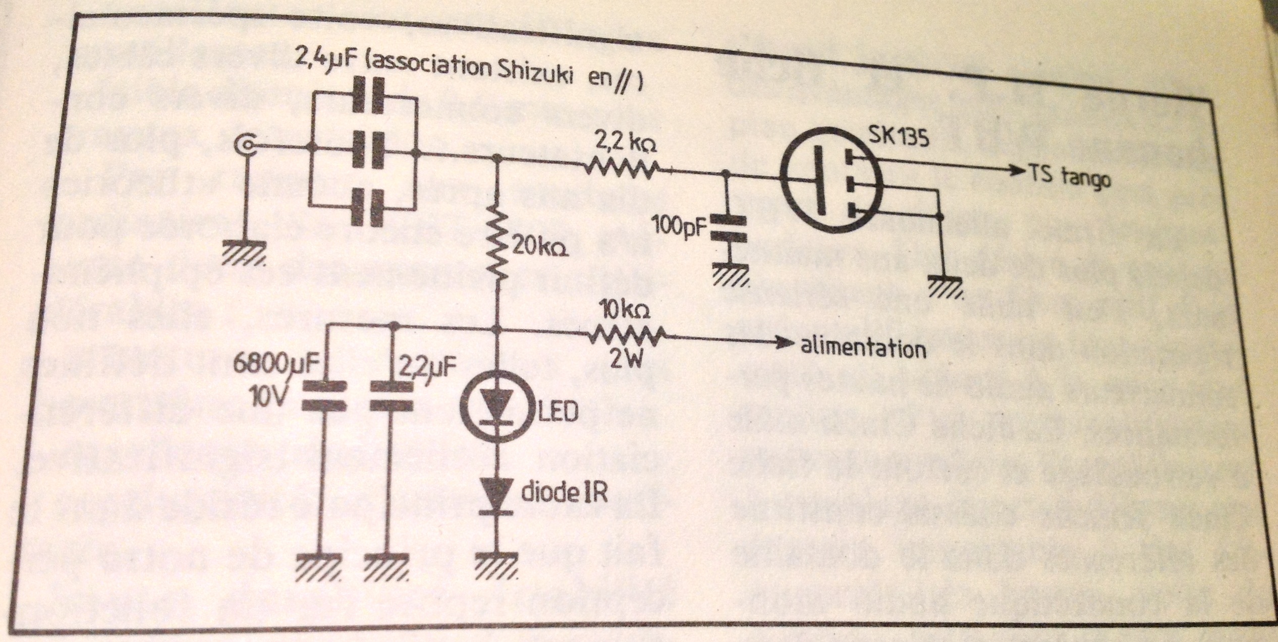

nothing very different than the papa sitnemesis, parts are
one pair of input cap grid choke instead of transformer input ( matter of taste)
a pair of Thf51S instead of the semisouth VFET
a pair of TANGO output transformer
a pair of TL431 bias power supply
a pair of CLC 100K 10MH 100K for the power supply
and that's it..

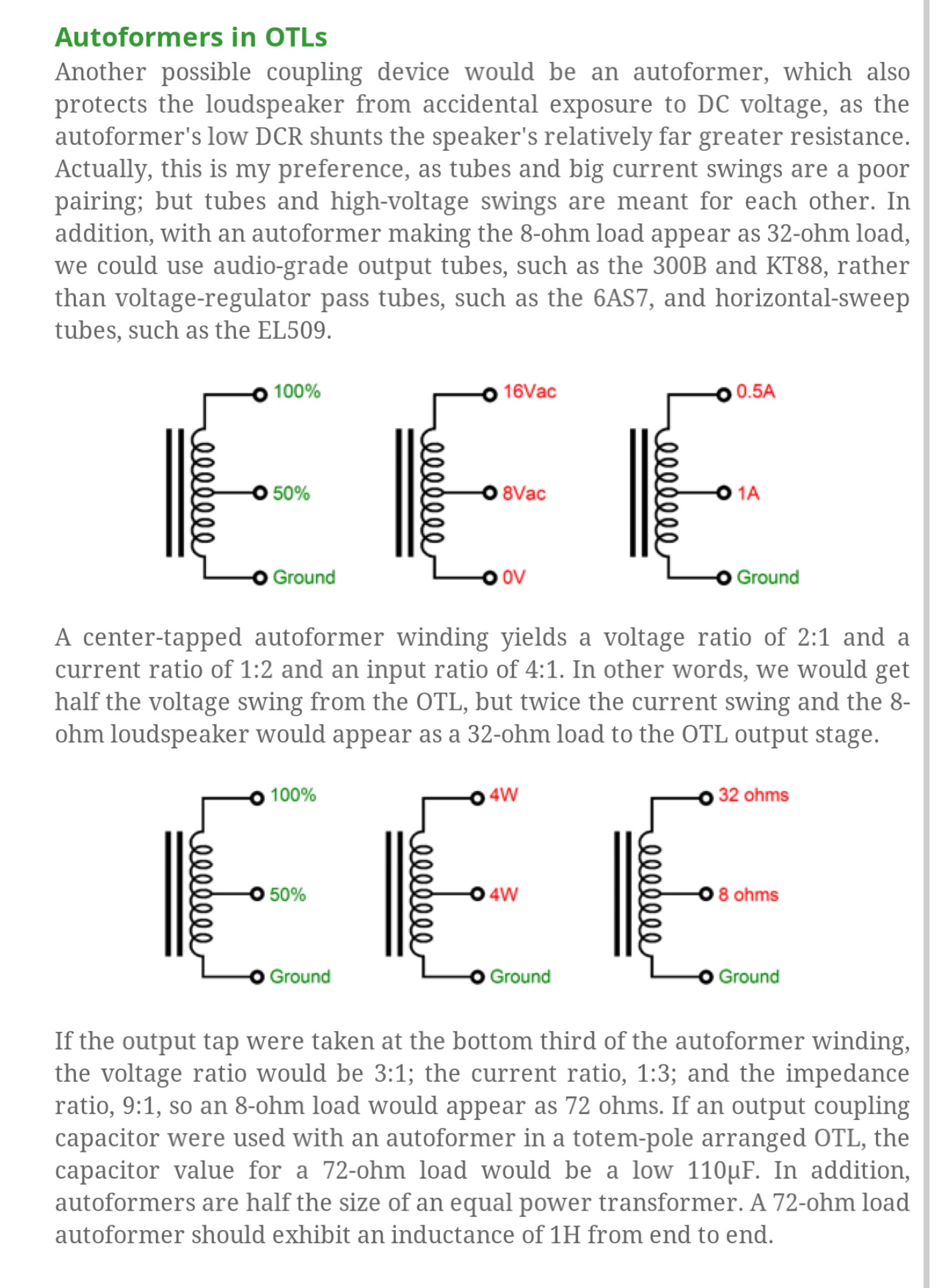

@ Jan.Didden
Yes we can rather name this "amplification stage with autoformer output".

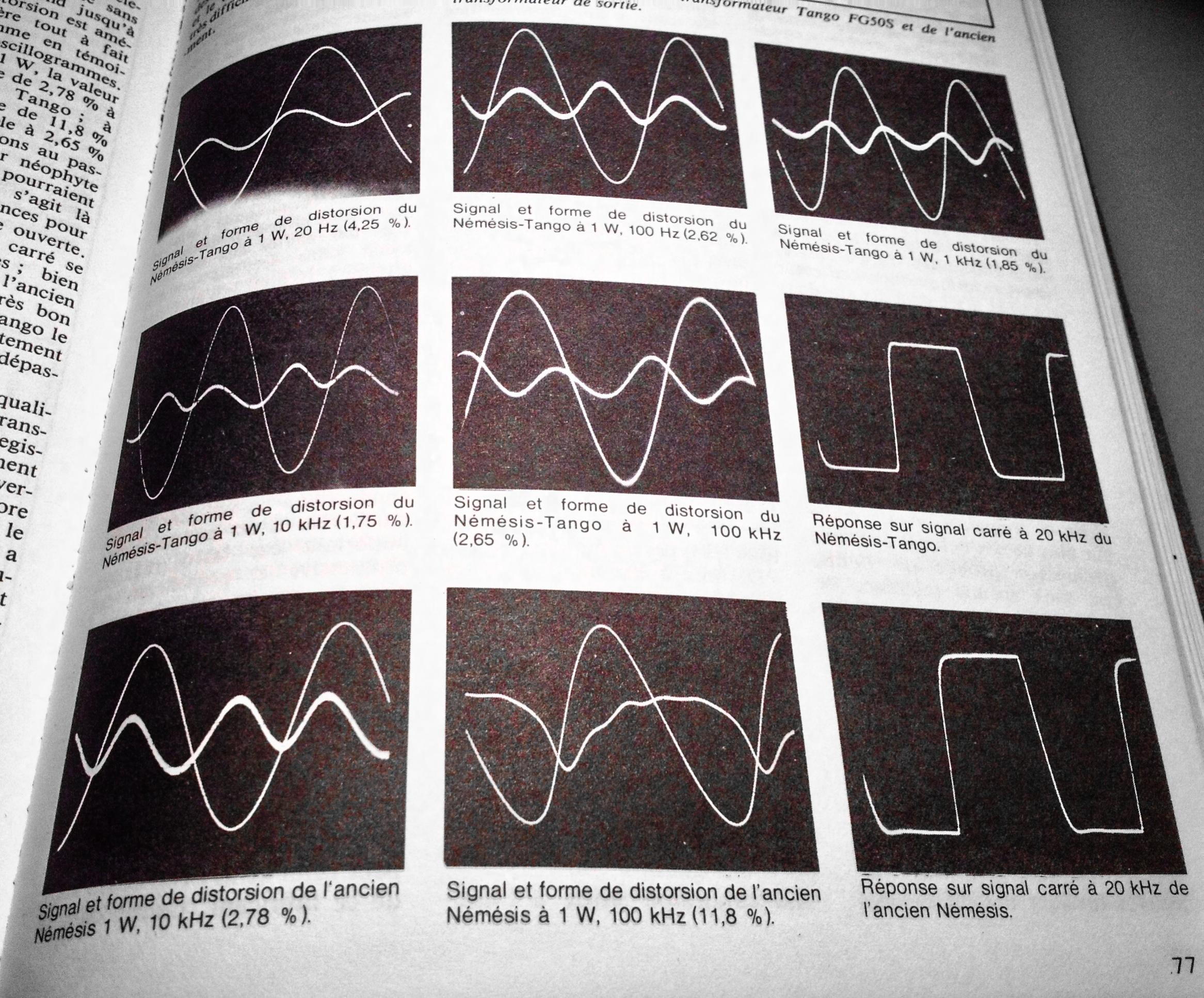

In "L'Audiophile" nr 41 edition from 1987 was Némésis show compared old (ancien) generic output transformer
performance with updated Tango FG50S version , a much better one 🙂
Mr. Hiraga says without feedback this amp is excellent for mid-highs in bi-amplified systems.
