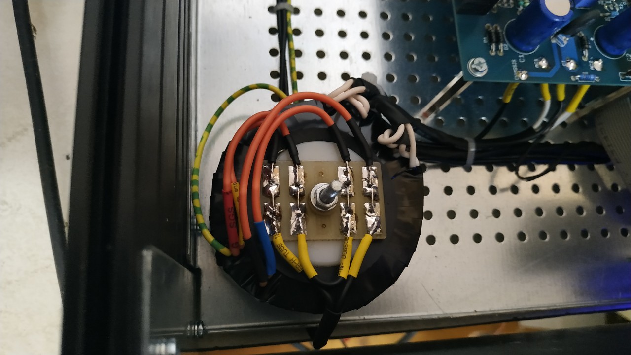

In your build, I see a full wave bridge rectifier on each secondary winding of the transformer and the common ground is formed between the power supply caps.
I see this is following the F5 schematic by NP.
I also see that the F5 Turbo (also by NP) uses a full wave bridge rectifier across both secondary windings with the transformer's center two leads going to ground between the power supply caps.
I will post both for comparison.
I am wondering what is preferred and why?

if you have center tapped secondary , with one bridge , any asymmetry between rails loading is resulting in lesser or bigger DC through secondary winding, which is not the case when you have separate secondaries , one graetz bridge per secondary and GND established after bridges
so , with funny Papa's output stage , with SIT up and mosfet down , negative rail is much more (current ) loaded than positive one , so better safe than sorry
there is (somewhere in some of threads linked in mentioned post #1) my analysis of that funny OS behavior , where SIT is practically working against Mosfet , up to the point where mosfet is gone to clipping and only then SIT is practically adding current to load
that's why I joked and named it ∀Class Amplifier

I didn’t get to correlation though. AND I wanted to repurpose a pair of F5Turbo power supply boards that have one bridge for both windings.
More work, no short cuts for this build.
