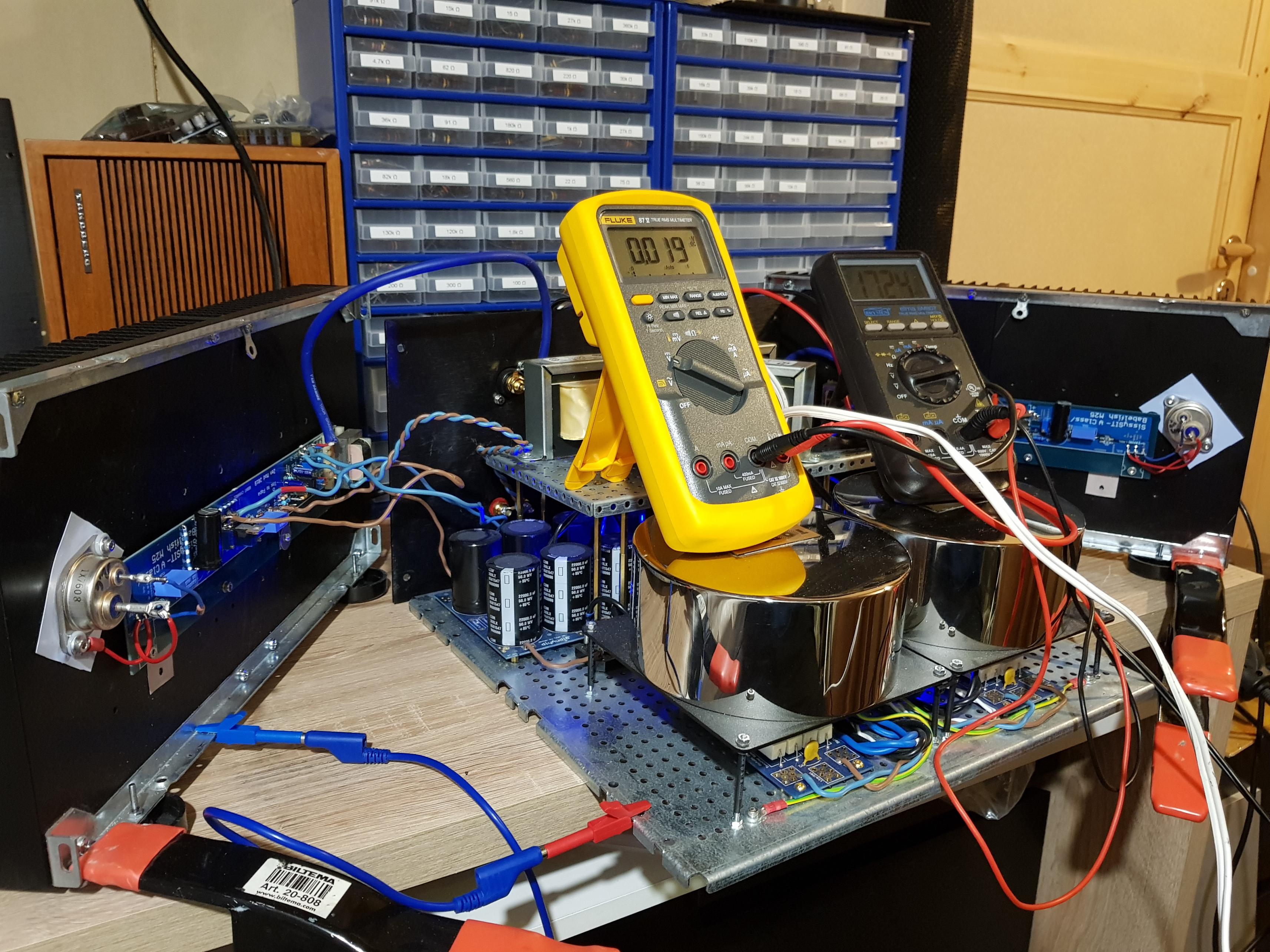

Temporary cooking instead of my F6 🙂
Should be making music soon!
Thanks Zen Mod!
Following your instructions from the build thread was a breeze. Only had trouble with a faulty 10k pot for the offset - had to go with a 5k and a somewhat larger R18. But it seems to be stable and all good!

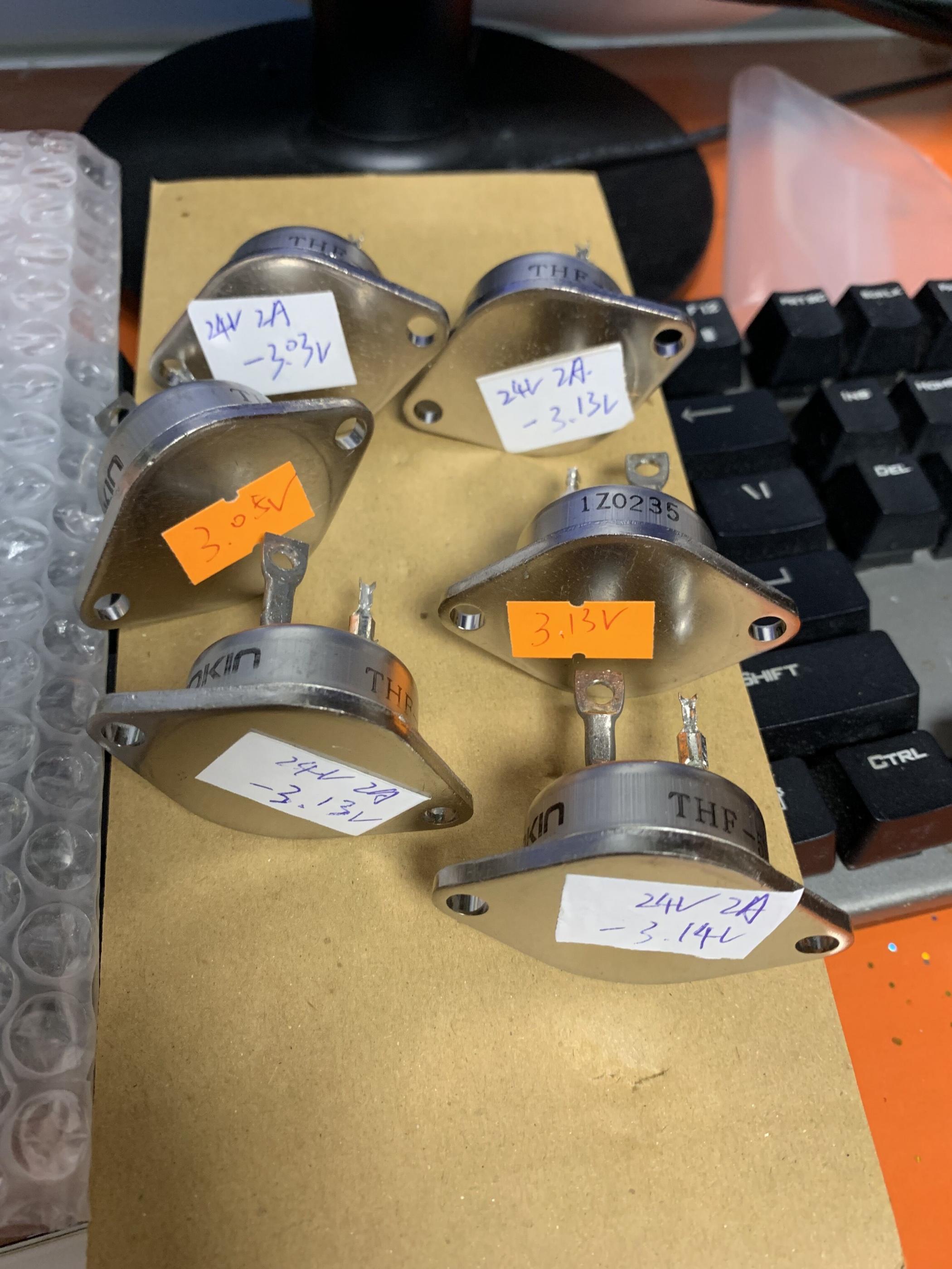

My THF51s from watanabetomoaki wasn't really matched, but it will have to do for now 😉

looking good!
common mode chokes could be better , but not really sure for SissySIT , due to uneven loading of rails - Mosfet is always doing much harder work than SIT , so load on neg rail is greater than on pos
Ugs matching of THF is not critical , as long you're able to set Iq , who cares for Ugs difference
Twst, that amp looks great !
I like the three-dimensional Meccano-style construction that enables your "significant" power supply ...
It is a pity to hide the beautiful Toroidy transformers inside the amp ...
In my build, I'm happy with 4 pieces in my PSU of the little brother of the chokes you used - 156B (1.5 mH, 5 A, 70 mOhms).
SissySIT is absolutely deadly totally silent on my 100 dB/W widebanders. 😛
I'm listening to it at the moment - it's the most transparent and informative and also explicit amp in my system so far, very nice tone, nice bite where necessary as well, not too aggressive. It's hard to do something else (like reading this forum) while listening, which in my book is a desirable quality 😀
Thanks, Zen Mod, for this amp ! 🙂

though , I have few things to complain about Twst's work:
-base plate is wrong oriented , lip better to put up , so no waste of space under it - one can place all mains cables beneath
-signal cables are too thick
-his work space is too tidy
almost forgot .......... let's just blame Pa, as always
Thanks! 😉looking good!
Chokes was just an experiemnt - I dont think they to much different than resistors - but they certainly add up weightwise giving the amp a good feel in my back when moving it..common mode chokes could be better , but not really sure for SissySIT , due to uneven loading of rails - Mosfet is always doing much harder work than SIT , so load on neg rail is greater than on pos
Yuup, seems fine - SITs reads 2V6 and 3V5 @ 23v 2A and biases up fine. Had to mess a little with the offset adjustment of the highest one, but changing R18 did the trickUgs matching of THF is not critical , as long you're able to set Iq , who cares for Ugs difference
Thanks mate! 😉Twst, that amp looks great !
I know they are in there - makes me sleep so much better 🙄It is a pity to hide the beautiful Toroidy transformers inside the amp ...
Of course you do 😀though , I have few things to complain about Twst's work:
Pfft, gives more air and room for screws to not scratch anything 😛-base plate is wrong oriented , lip better to put up , so no waste of space under it - one can place all mains cables beneath
Should 15cm cable make a difference, it the same cable all the way to my sources 🙄-signal cables are too thick
You haven't seen my other tables where I actually do the work 😀-his work space is too tidy
And for sound - this thing is unique. Especially in the top end. It is really pulling out all the details and even the details in the details. It's not sounding anything like the M2 or the other firstwatt builds of mine, that's for sure.
Feeding it directly form my Katana gives a large soundstage in my horns on top of the cornscala bass cab.
There are no noise or hum coming from this amp, and that's cool. Had some mu-metal ready for the input autoformers - but it doesn't seem necessary at all.
As for the details, it kinda seems over the top with some recordings - making it somewhat bright/fatiguing. But not the regular sibiliant kinda bright. Might settle after a while - but overall I am impressed with the involving soundstage of this thing 😉
And oh, it runs a little hotter than I expected. Its like aleph hot!
Now, back to music

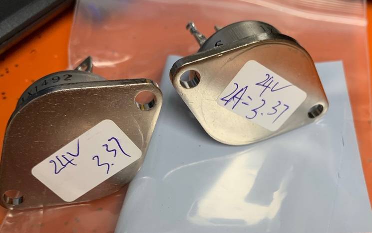

it is negative , SIT being depletion device , so normally ON
to brake it (current) one need to apply neg. voltage , same as Vacuum Tube
Pass DIY Addict
Joined 2000
Thanks, Zen. This clears up the confusion that was in my head! I just ordered two sets from Pras: one pair at 3.37v and another pair at 3.34, so I have a backup pair.
