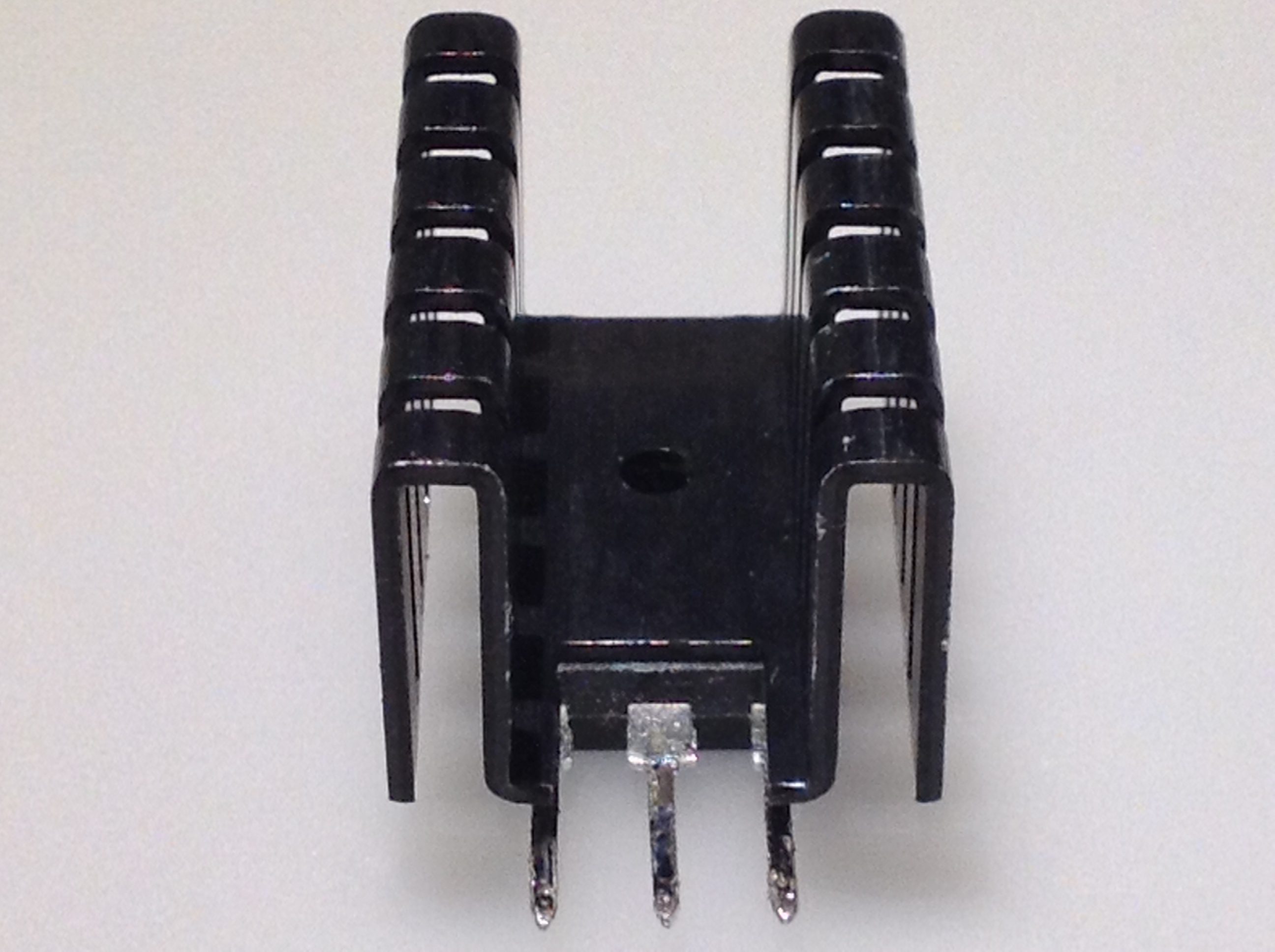

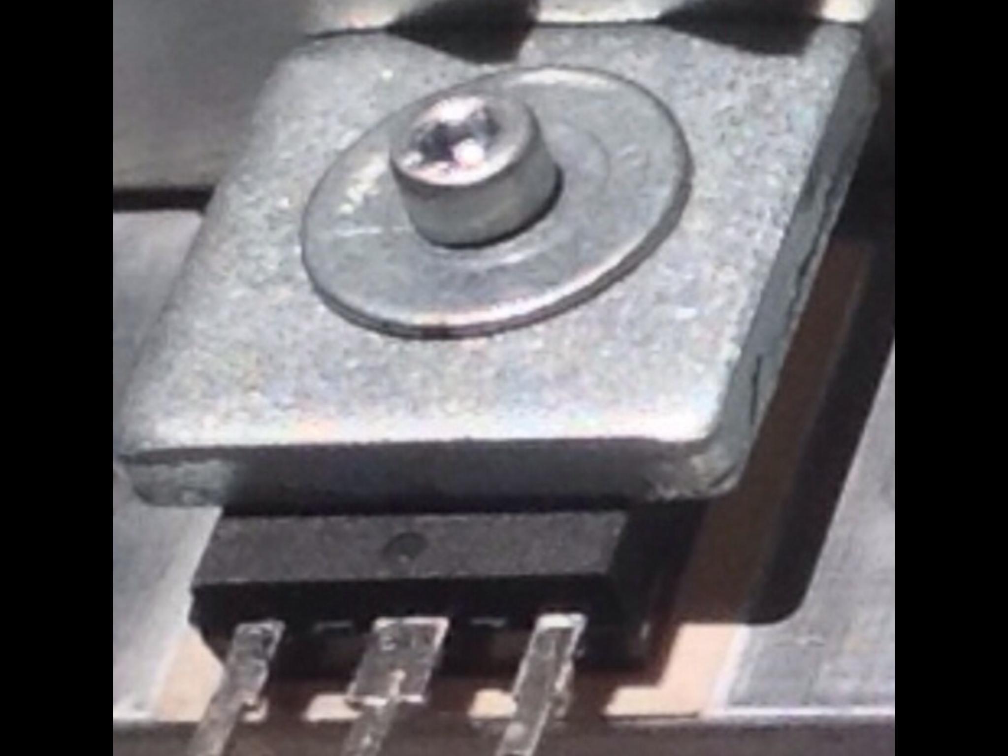

For TO-247 mosfet clamp can do case thermal extension or better solution not clamp but small heat sink on external side. This one on the right photo is TO-220 format show only for example
